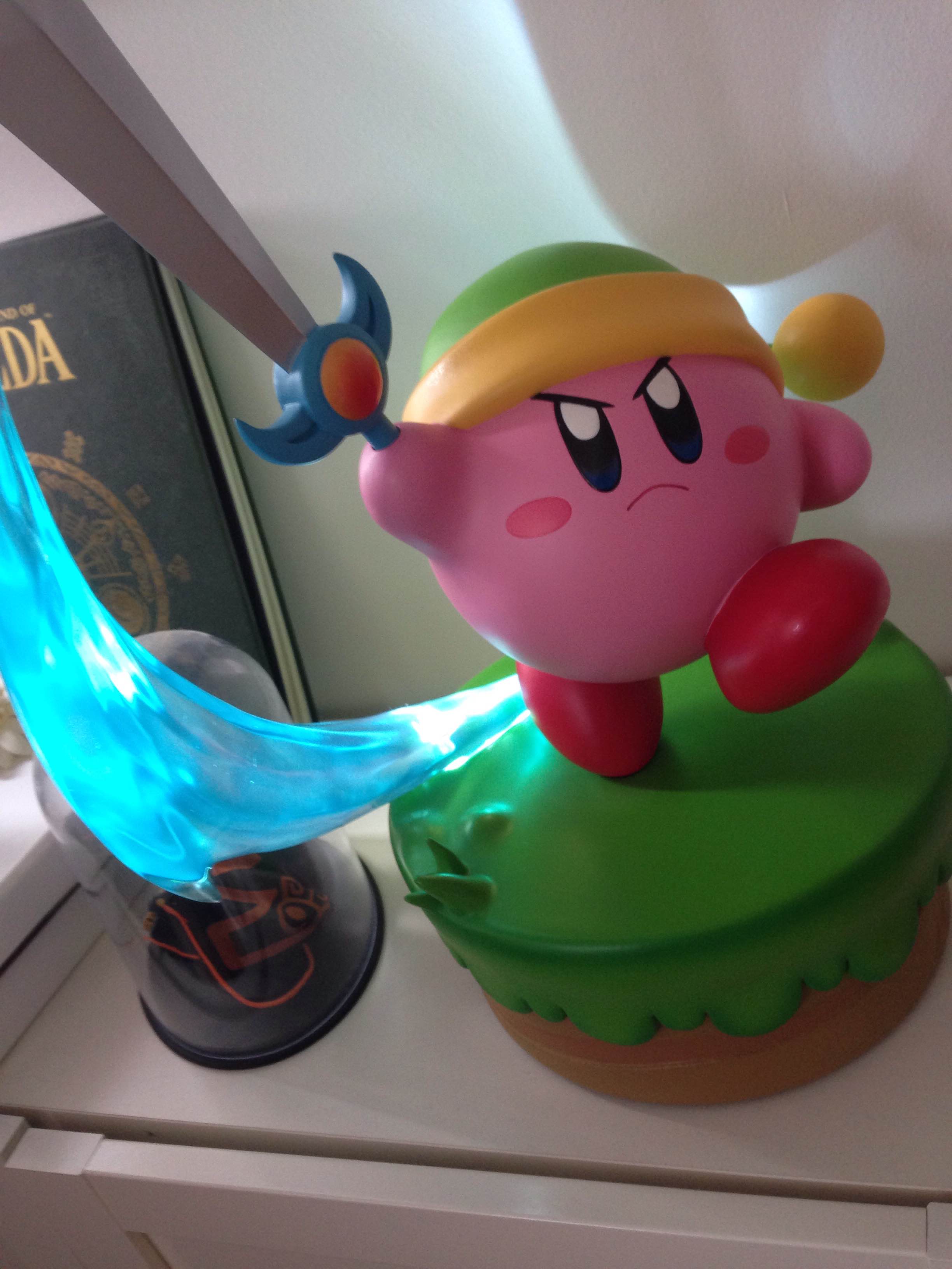

If it helps you, I've got this (attachment) Kirby statue standing on my shelf here so if you need any measurements from this sword, I'm more than happy to help you but I fear that's not the right one to begin with.
One question: How big should the sword actually be? In comparision to Kirby it's roughly twice his size.
