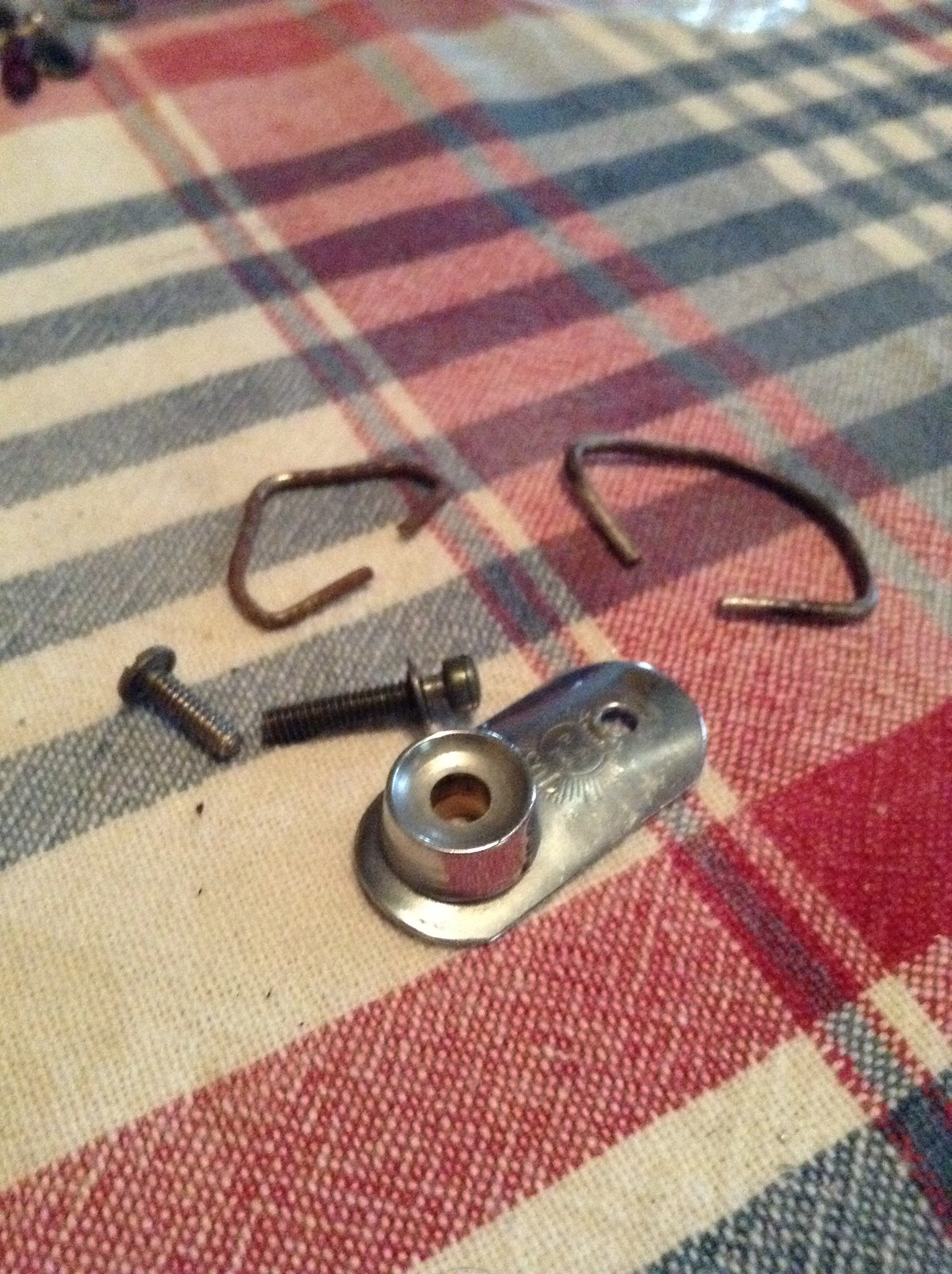

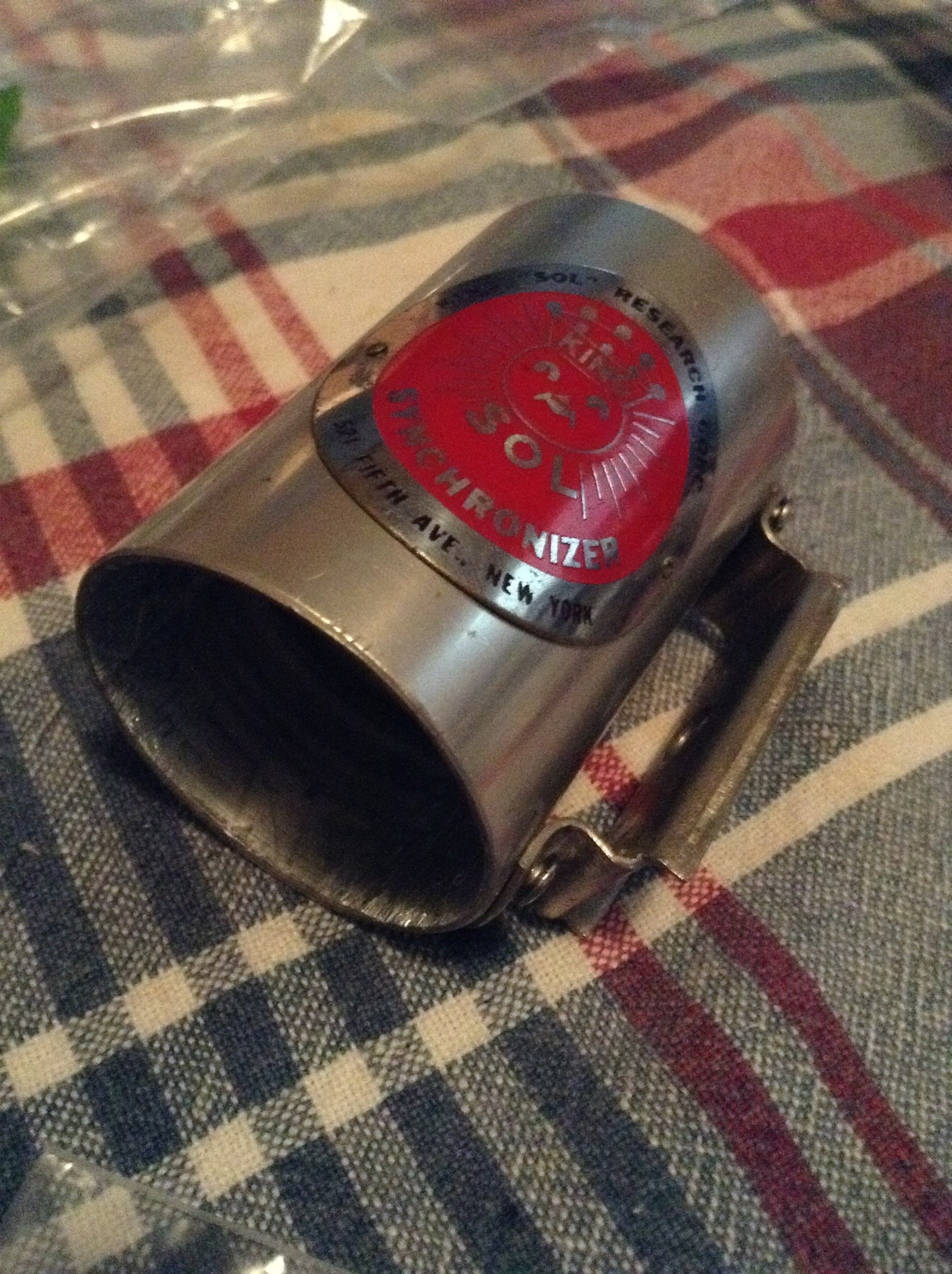

I'm up to no good again. I had a king sol lying around that was MAJORLY scratched up on the bottom. (I actually gouged a curly strip of metal out of it by accident too, see later posts) so I bought a Heiland reflector to go on top. Now..clamps....i removed the king sol bracket (none of the screws lined up, it was pretty bad work) then I decided to buy one of those metal "clamp" sections from eBay. Originally these were made in the 80s by that early replica company..can't remember the name. Anyone still have those magazines?

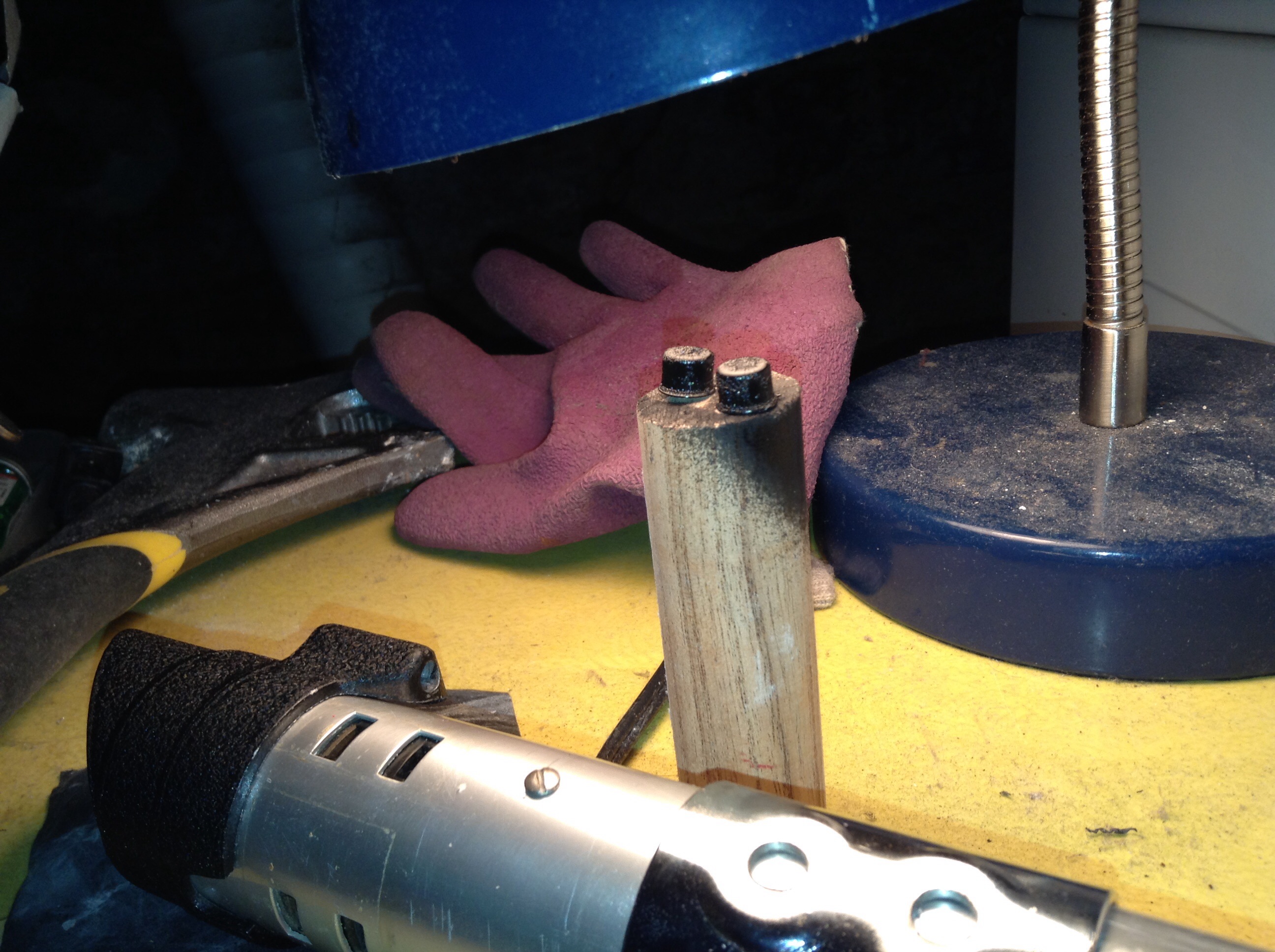

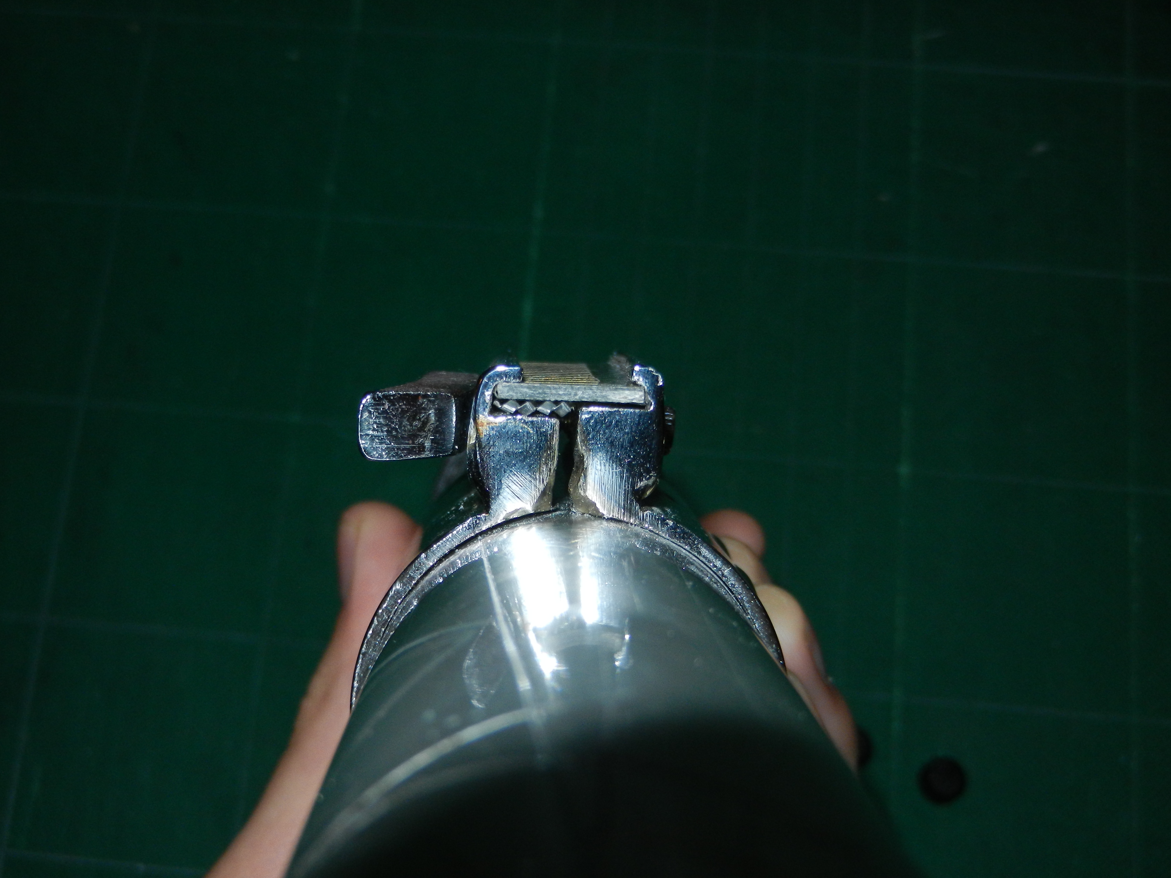

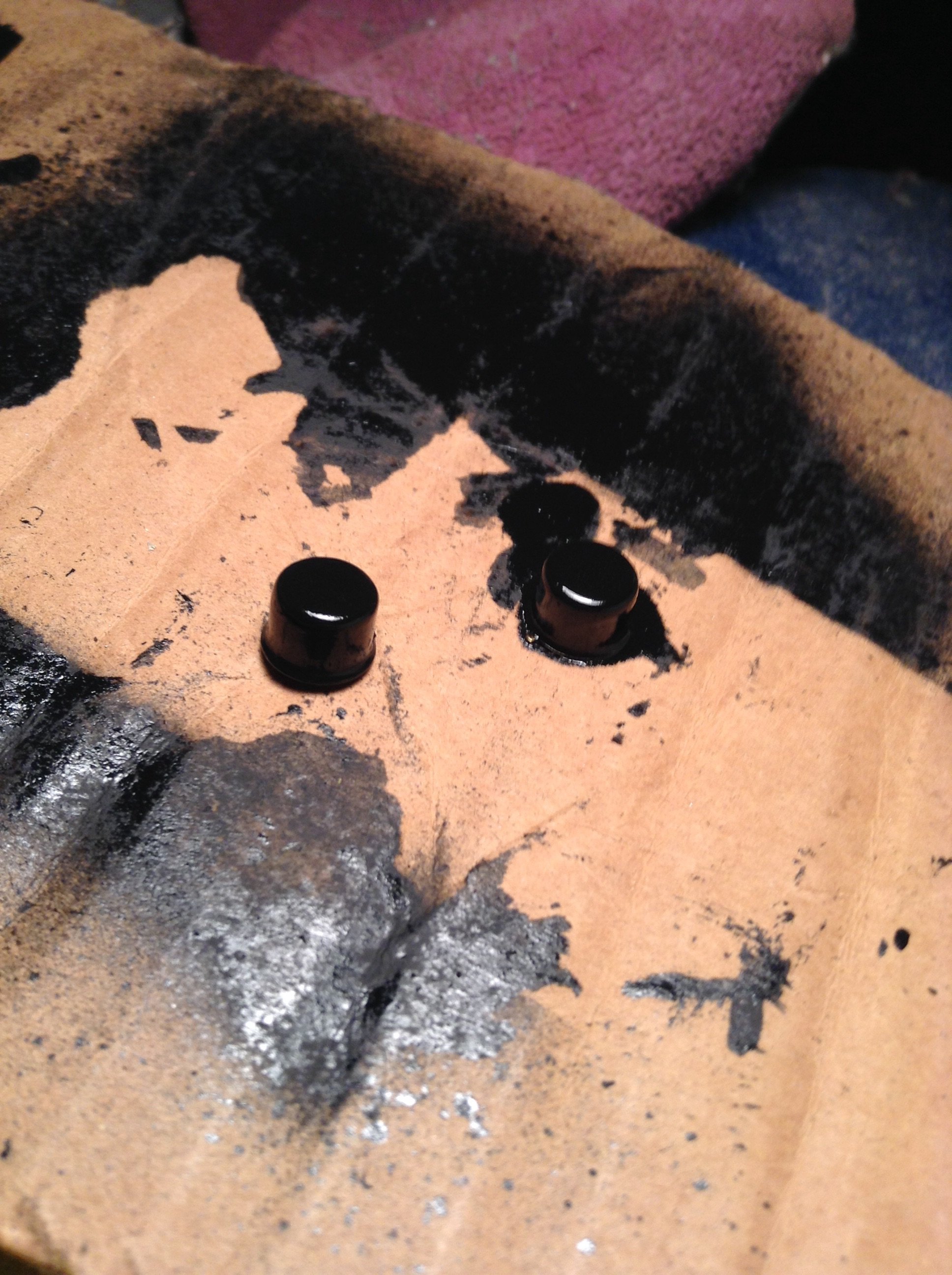

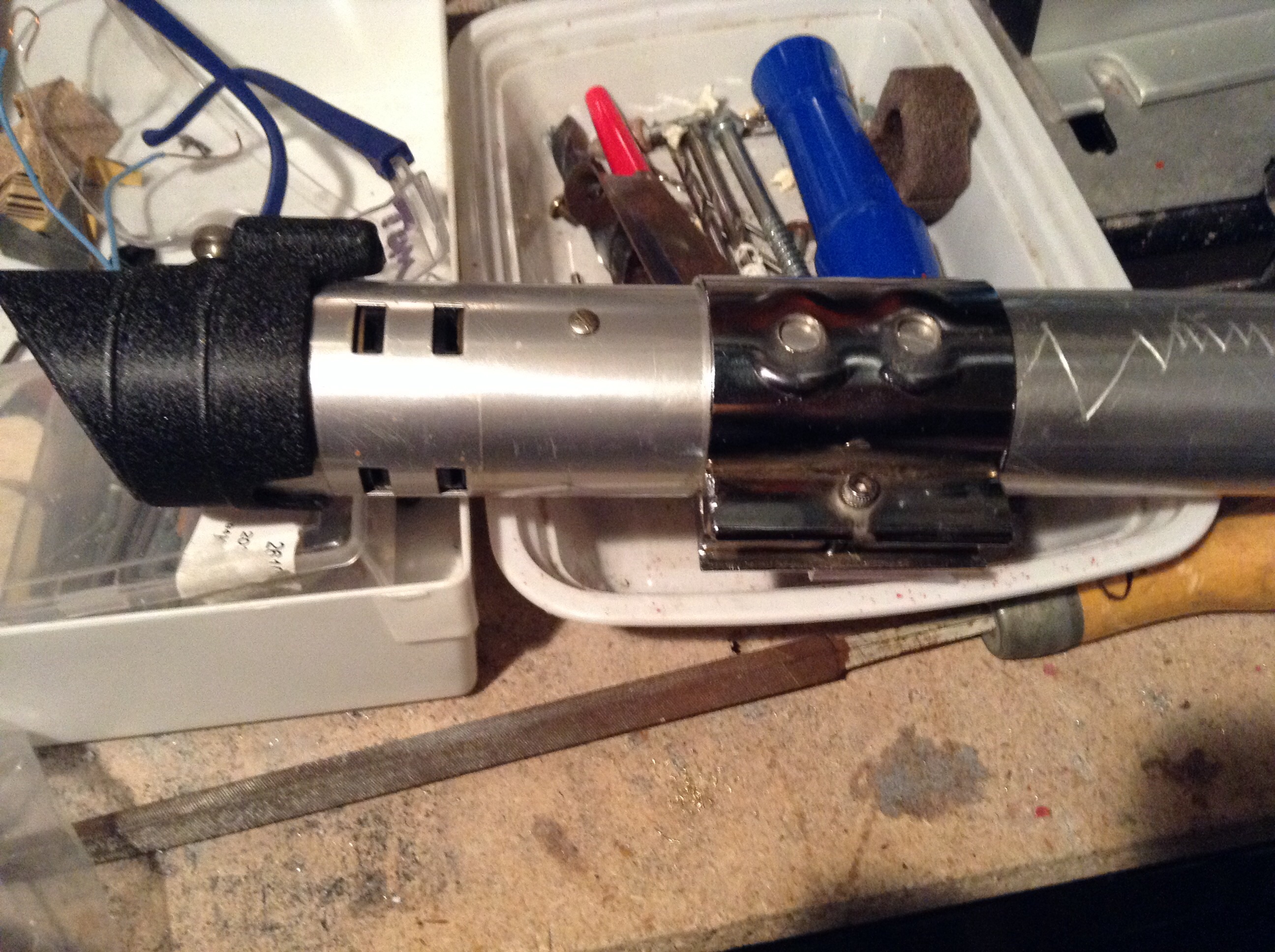

anyways this is how I basically skinned part of the flash. These clamps are cut from tubes and very rough inside. I removed it again and took a grinding wheel to the inside. I also tightened the clamp once it was in place - there's a socket head screw and this lever shaped piece on the other side.there are these raised areas for transistors I'm assuming...they look neat so I decided to play along. I took two generic transistors and hit them with wrinkle paint! The black transistor idea has been in the back of my head for years.

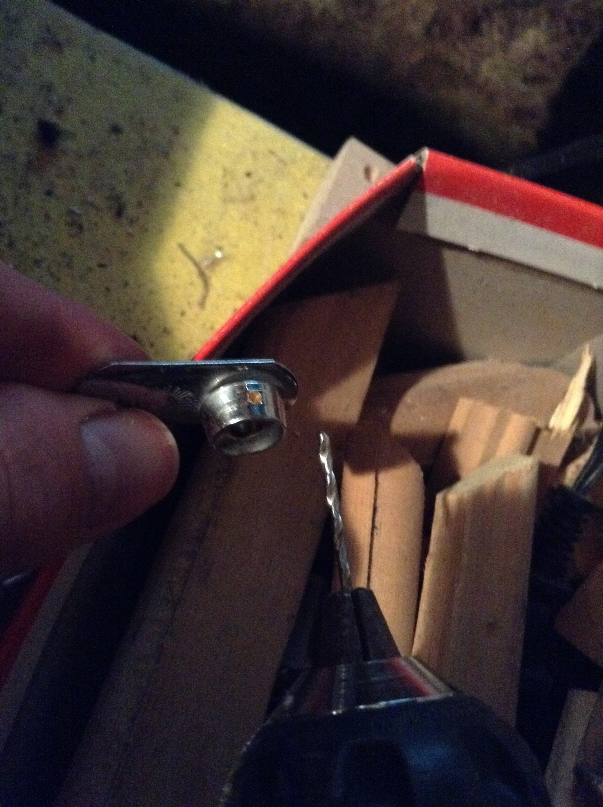

i found a little extender card at school and always wanted to use the plug on something. Now I can! What else....I actually decided to drill into the test button to hang a ring. I didn't like the look of adding anything anywhere else, the end cap is still a viable option.

Tom, tell me about this clamp lever some more.
So the clamp itself is cut from a thick chrome tube. Literally, they cut a section and then sliced it lengthwise.
Welded to the "cut" area is a metal box with "sidebars and ridges" like a graflex clamp. (I'll post pictures soon) The two sides of the clamp box area are not level, looking at the side. I had to add a layer of something to one half of the clamp area for a card to lay flat. Even with that, one end of the clamp is uneven and the back is flat.
It was probably so rough because they welded the "box" on and sliced the whole thing with heat (There are scorch marks inside) and the inside has the remnants of that slice job. I guess technically, cut, it mimics a clamp. Although it can only be pried open a tad. Before grinding out the inside, i pushed it on my flash unit. It has that matte aluminum instead of a chrome finish and a piece inside the clamp dragged a huge gouge in the body. There was a long curly sliver of metal from the gouge poking up, like using a cheese grater...yea, I'm definitely putting T track on this one.
Running through the middle is a long socket head allen screw. On the other side is basically a block of metal with a threaded hole. The metal is just cut in a 2D lever shape, sort-of, and acts like a nut for the screw. You can see the threading because one half of the clamp (the lower side) has a cut-out in the floor of the clamp for it to pass through. You can see that in the pictures above. Since the lever nut doesn't have anything to stop the threaded rod you can tighten it quite a bit, and when it's not tight it can loosely swing around.

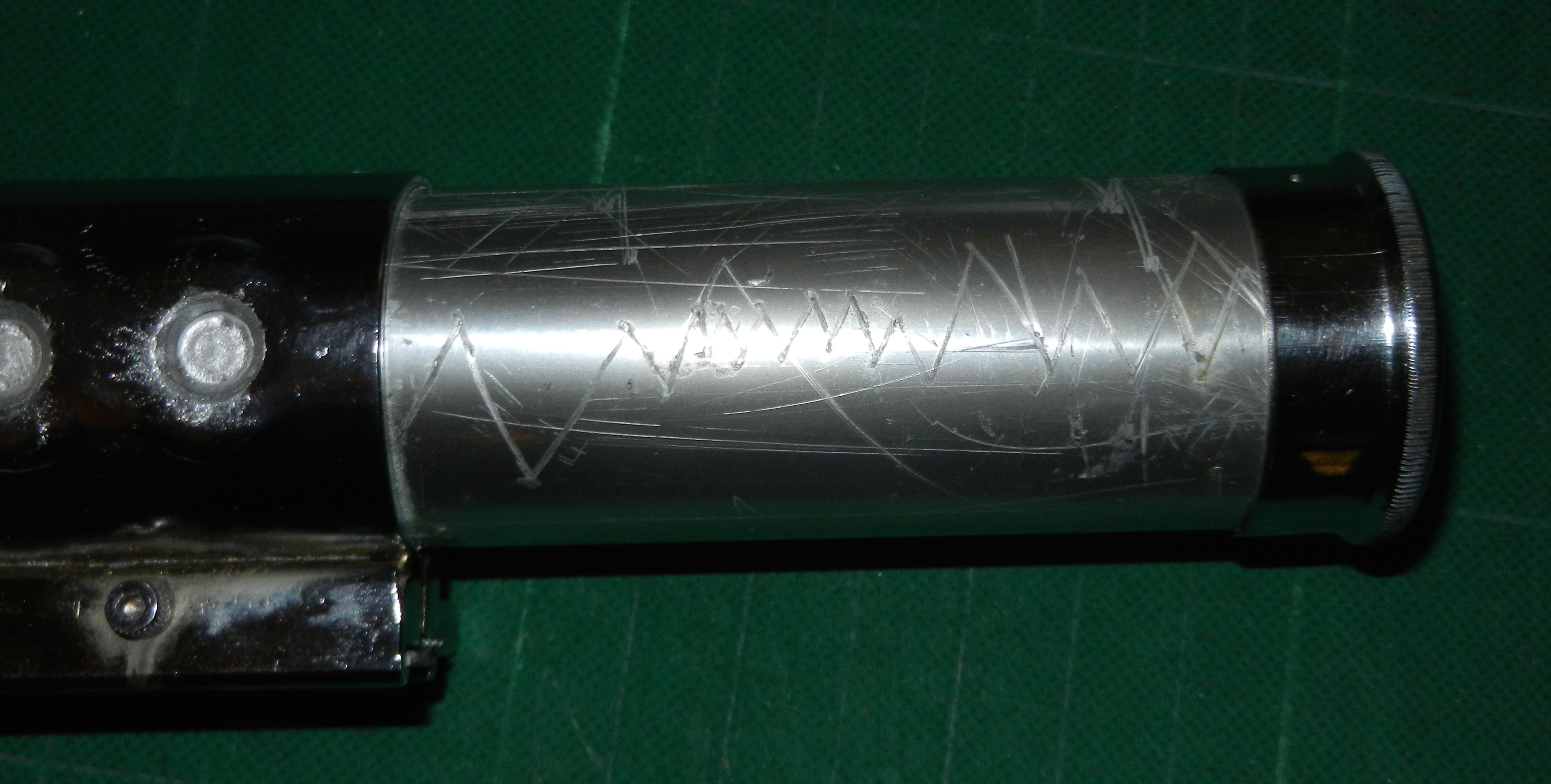

The previous owner tried to get the original king sol midband off too and gouged a nice zig-zag in the other side. I'll be happy to cover those up.

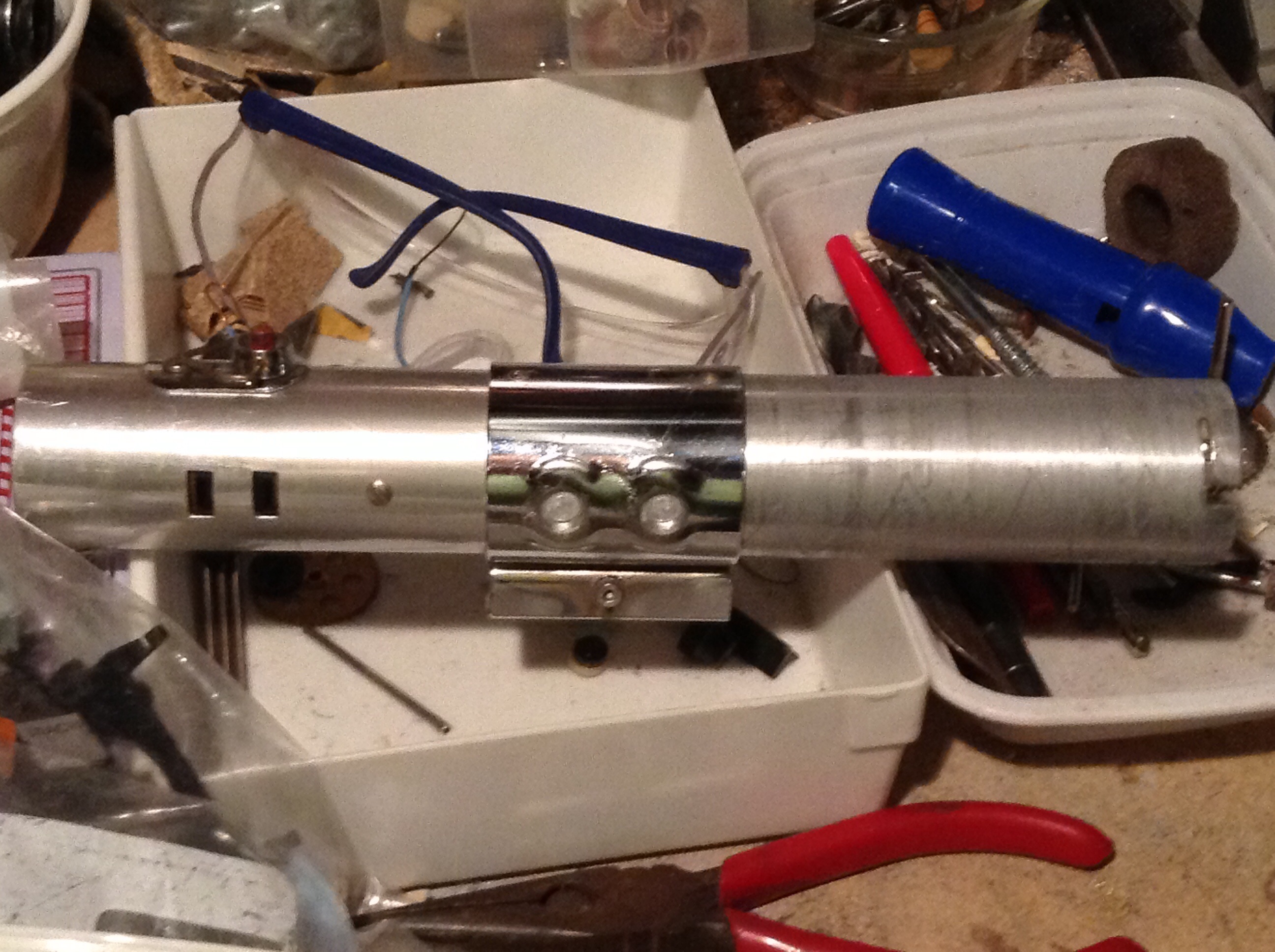

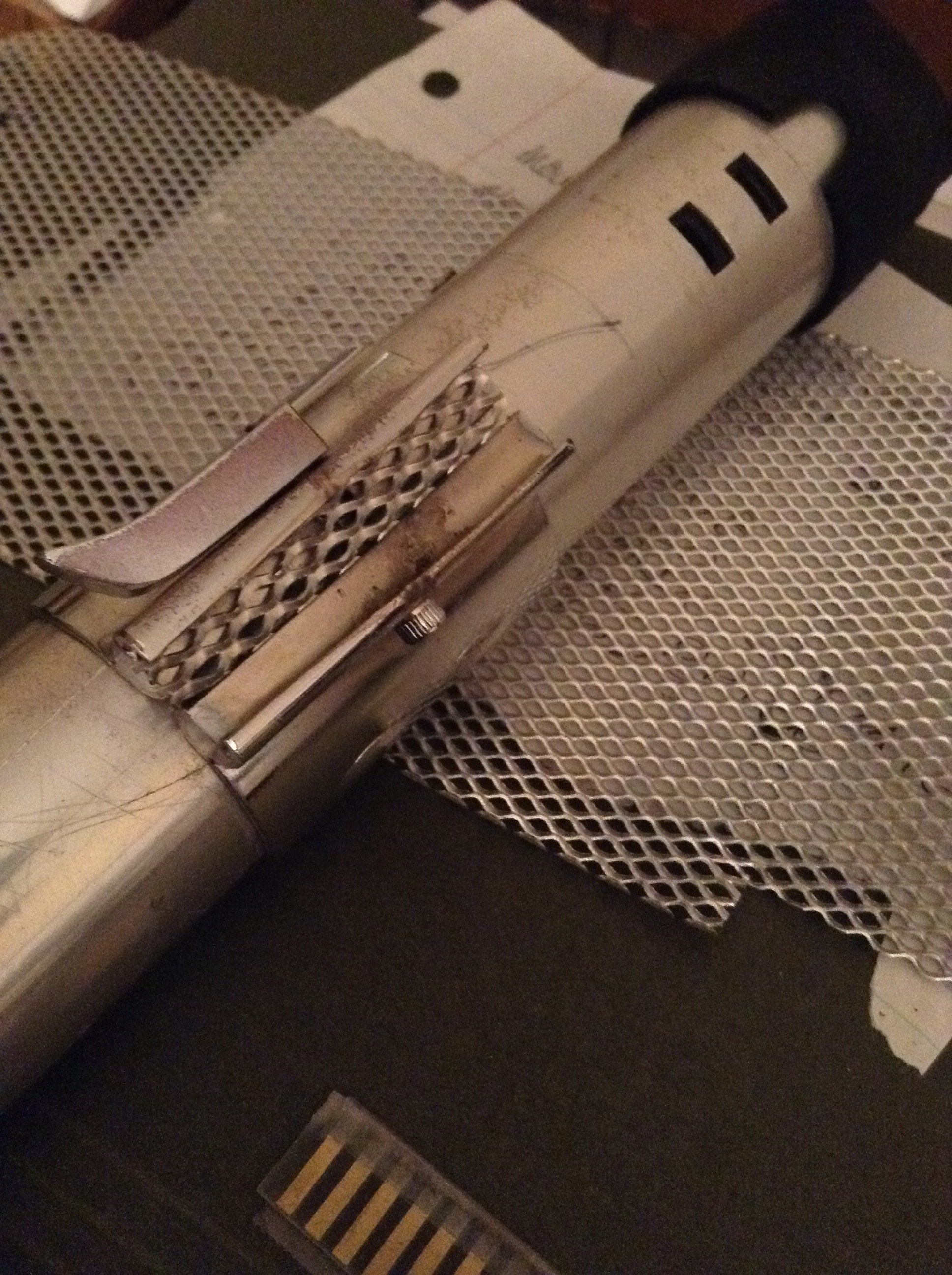

I'm documenting this project over two devices, so bear with me. Here is me painting the transistors and realizing the holes are too small. Then - I find material to level out the floor of the clamp. The next post will have better pics with my Nikon s9100..

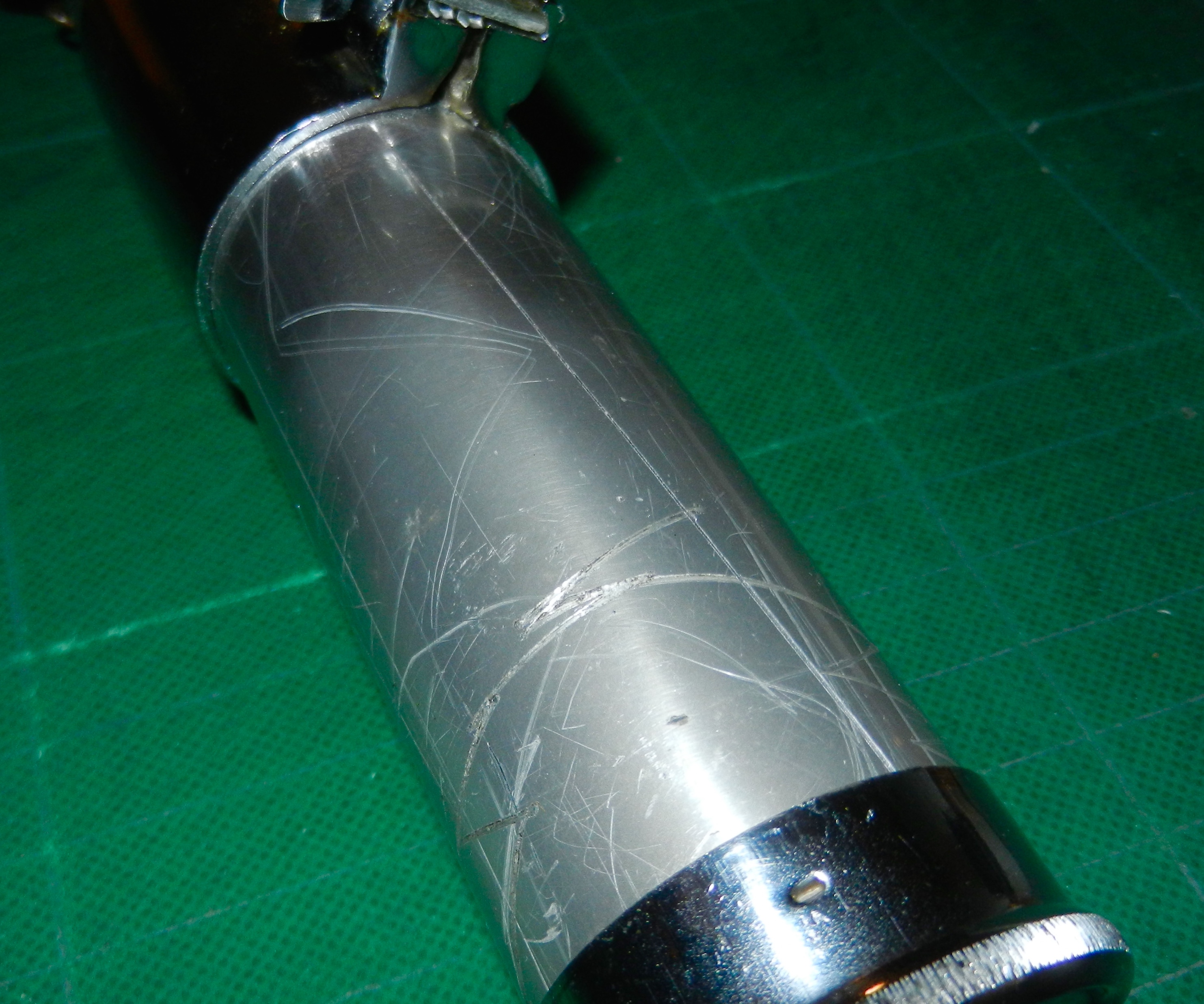

Here are the gouges in the body of the flash unit. They hurt to look at haha

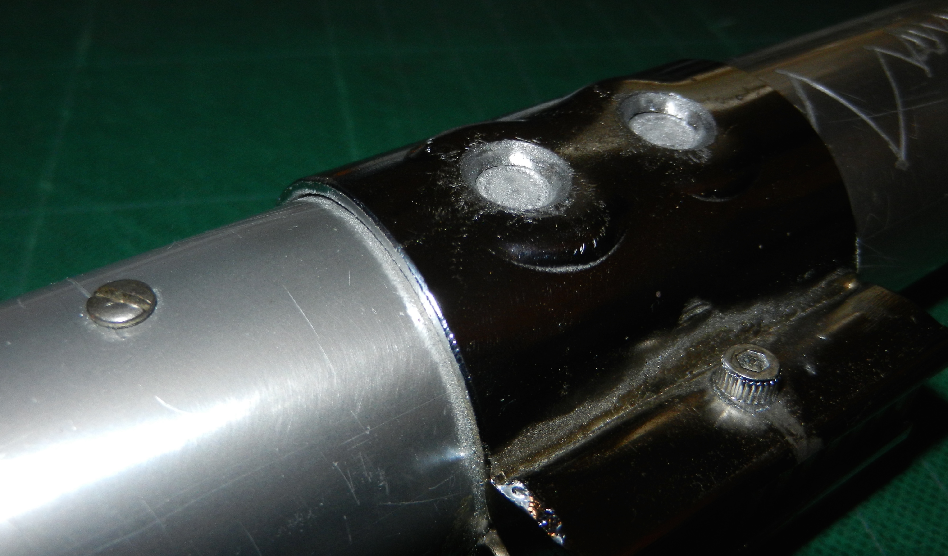

Now, here is the detail of that "clamp" section from Marco Enterprises. See how uneven it is? It looks like raw metal work, but it is heavy. I like the weight - and with enough packing tape and the mesh this card is going nowhere!
I tried to countersink the transistor holes and it took hours.They're just barely the size of the transistors (but the transistors don't sit at the bottom still). I'm thinking I may JB weld them in there, it IS metal on metal after all.

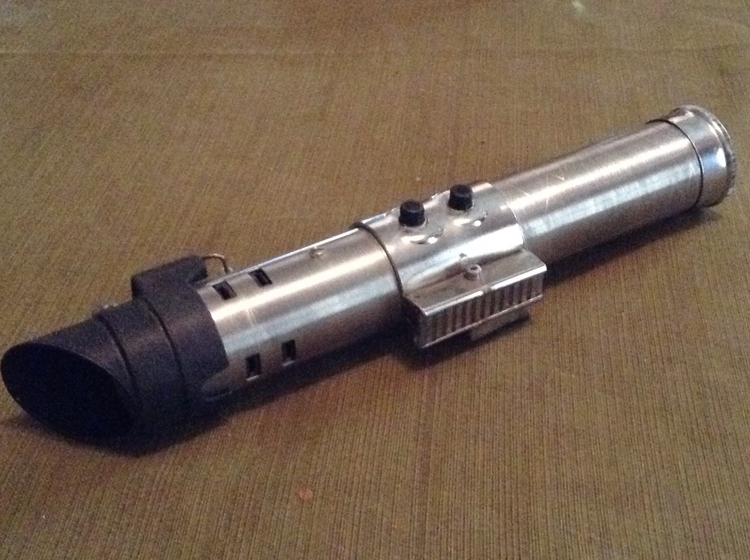

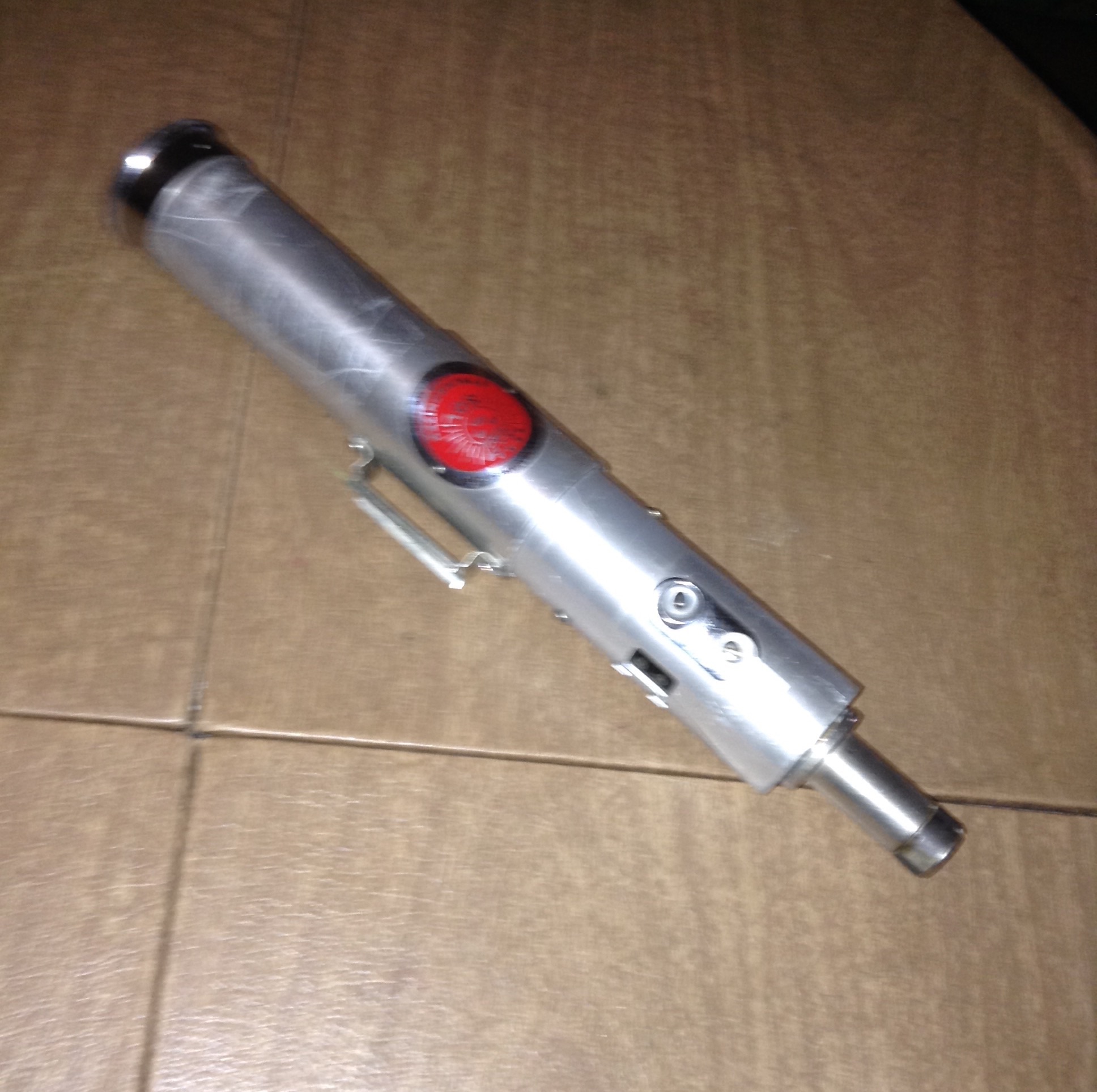

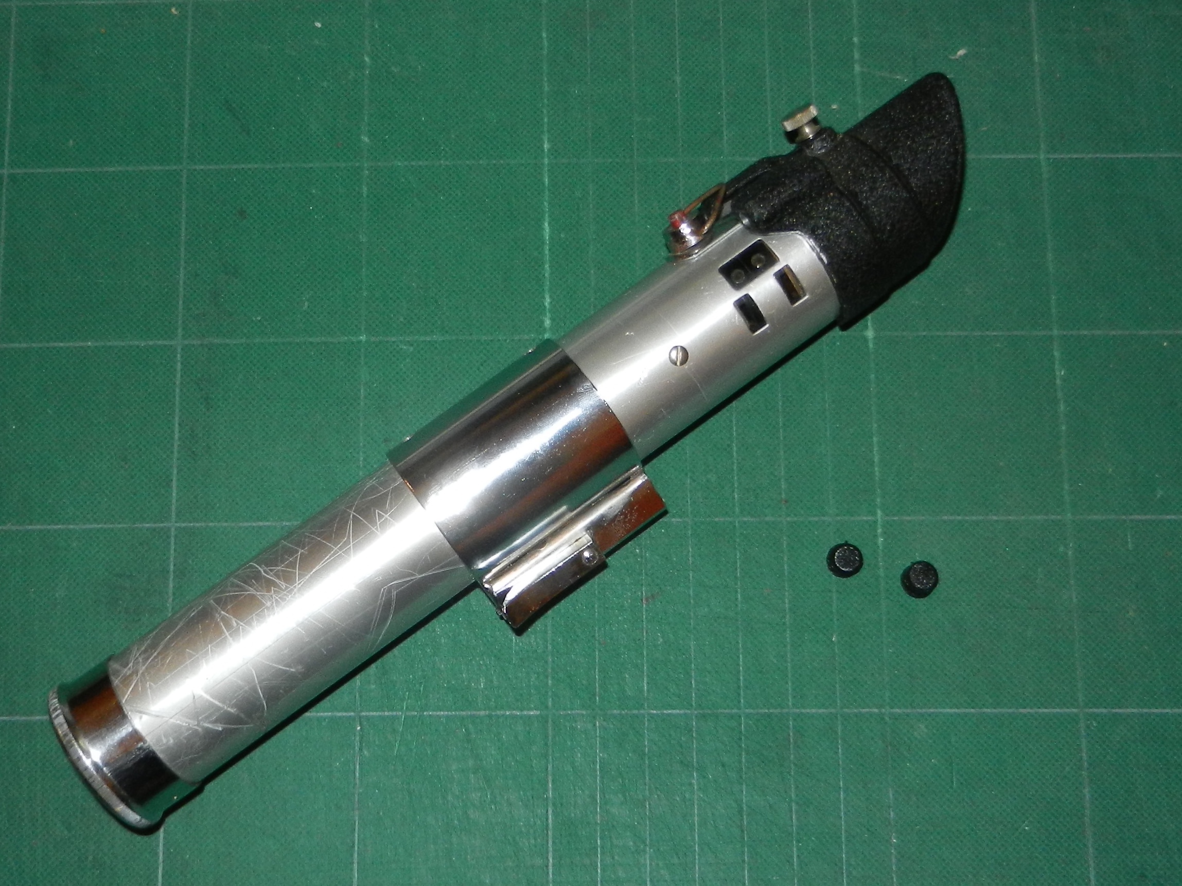

Here are some pics of where I am now with this Saber. The Ring is from the same old Radio strap that my Mystery Saber D ring came from. Also, I got the Heiland thumbscrew off my Vader ESB thing. I bought a diamond knurled thumbscrew from the custom saber shop to match the prop in it's current form.
(I'm still displeased with that project. I used the wrong screws, it's top heavy due to the shroud - which I am proud of repairing, and the clamp is bent and just doesn't look right. The bubbles actually broke and fell out last week, we'll see what I do with it later)
Anyways! This one is really coming together. I call this a Vader 2.0 :lol

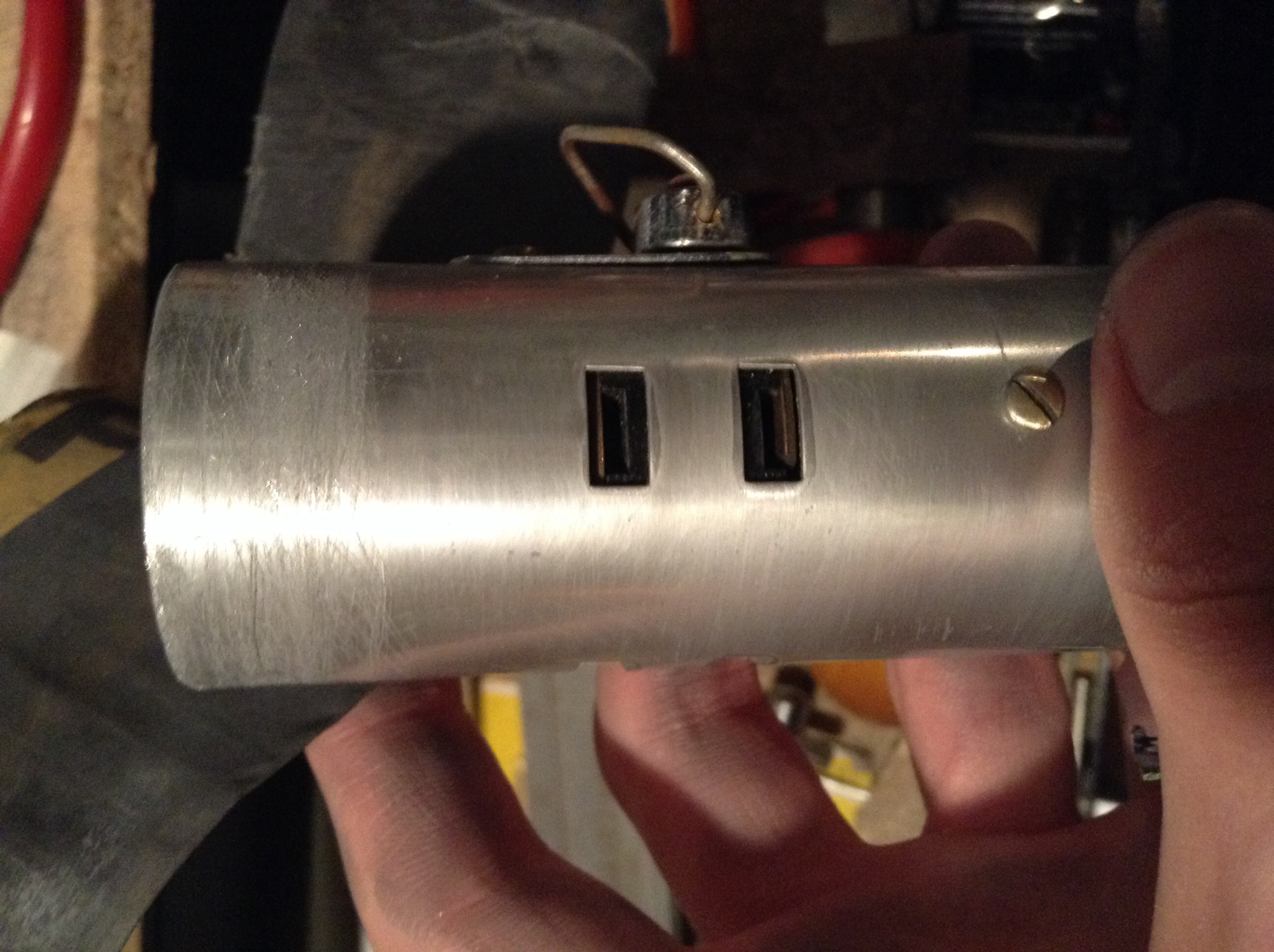

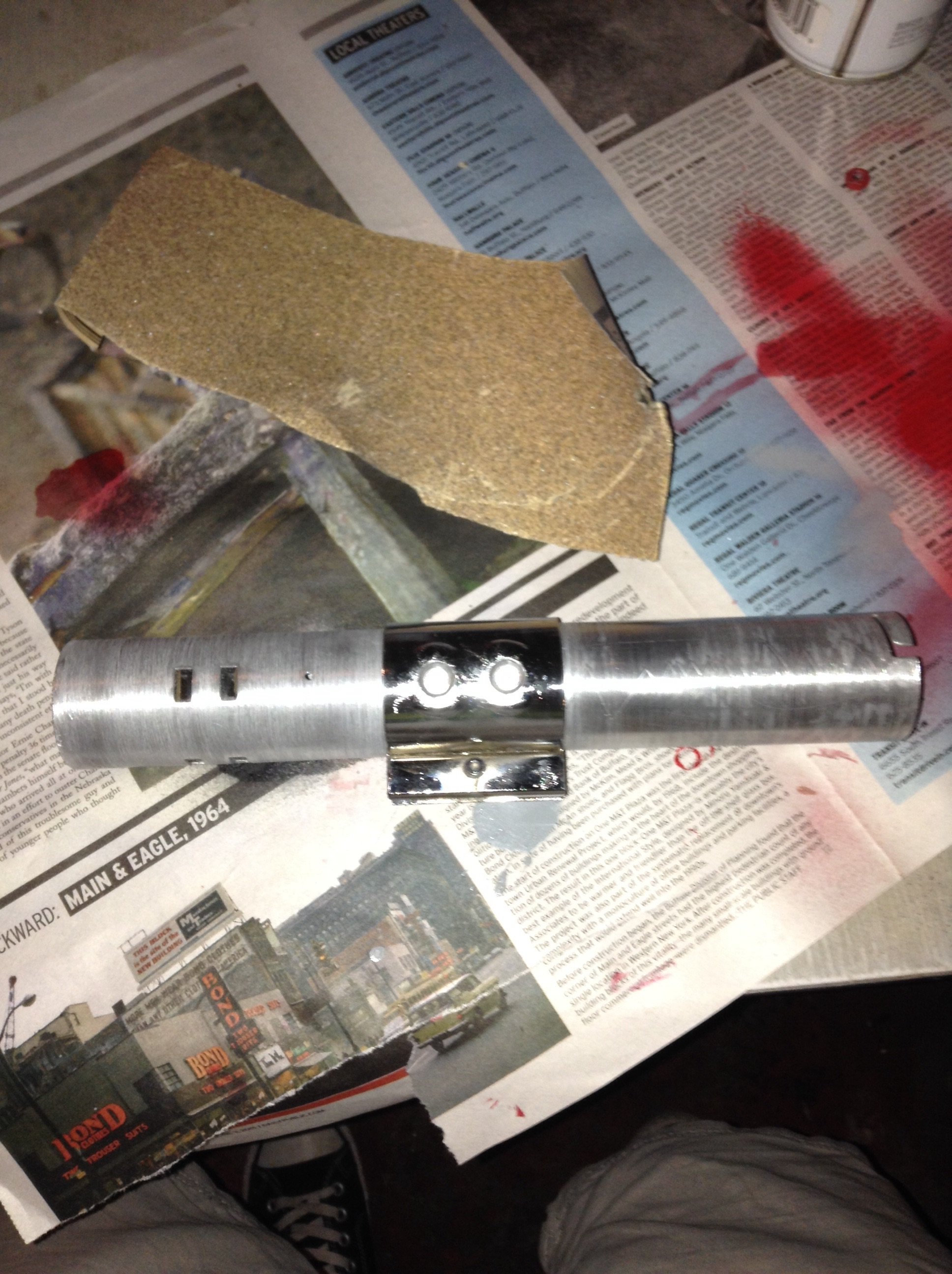

Speaking of the scratches - I decided to go the way another member went ;) I wet sanded the whole thing (rough then fine sandpaper) and with a lot of elbow grease it came out lovely! It looks like machined metal now. Those scratches are much less noticeable. also apoxie sculpted those transistors into the beveled holes (I also beveled the transistor rims to fit as well). Squashed some putty underneath, then peeled the excess away, and voila!
Hers a pic of where I am now, I'm thinking I need to gone some T Track :) I already have the belt clip covered

I got that look by wrapping a piece of sandpaper (rough) around the tube and twisting it back and forth. So, I was dragging the sandpaper horizontally and continued to do this.
I did the same thing with fine sandpaper, which actually created a lot of heat! I had to keep stopping so I didn't light things on fire
