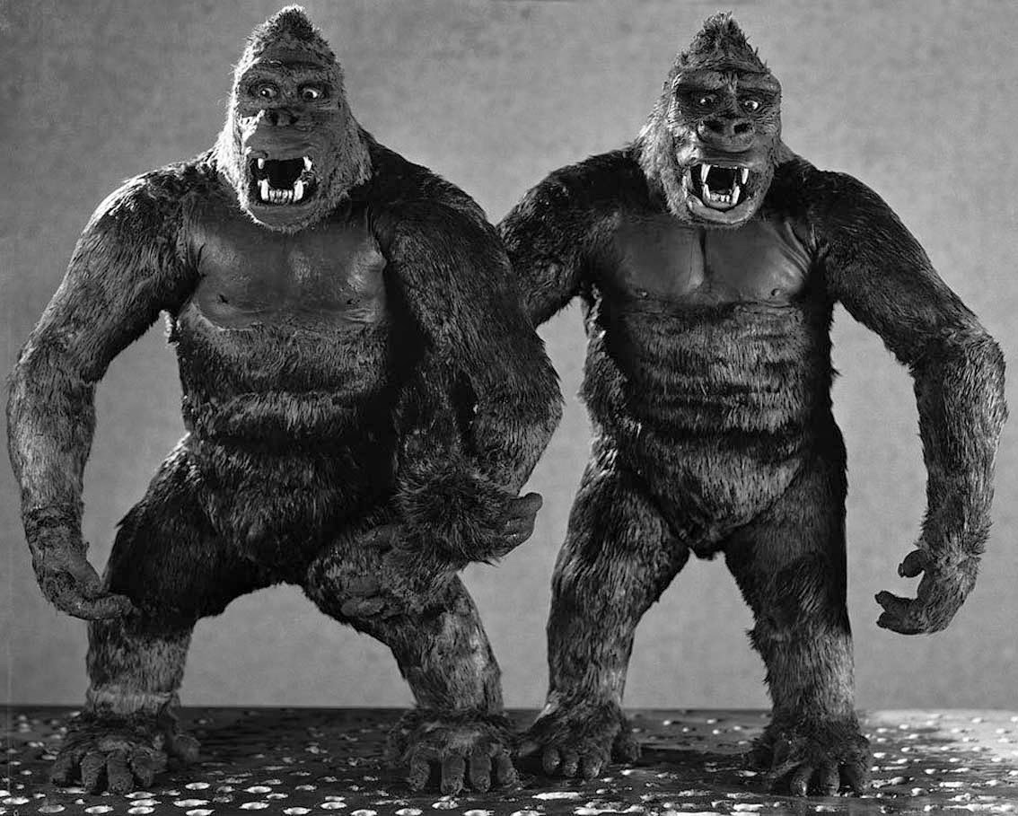

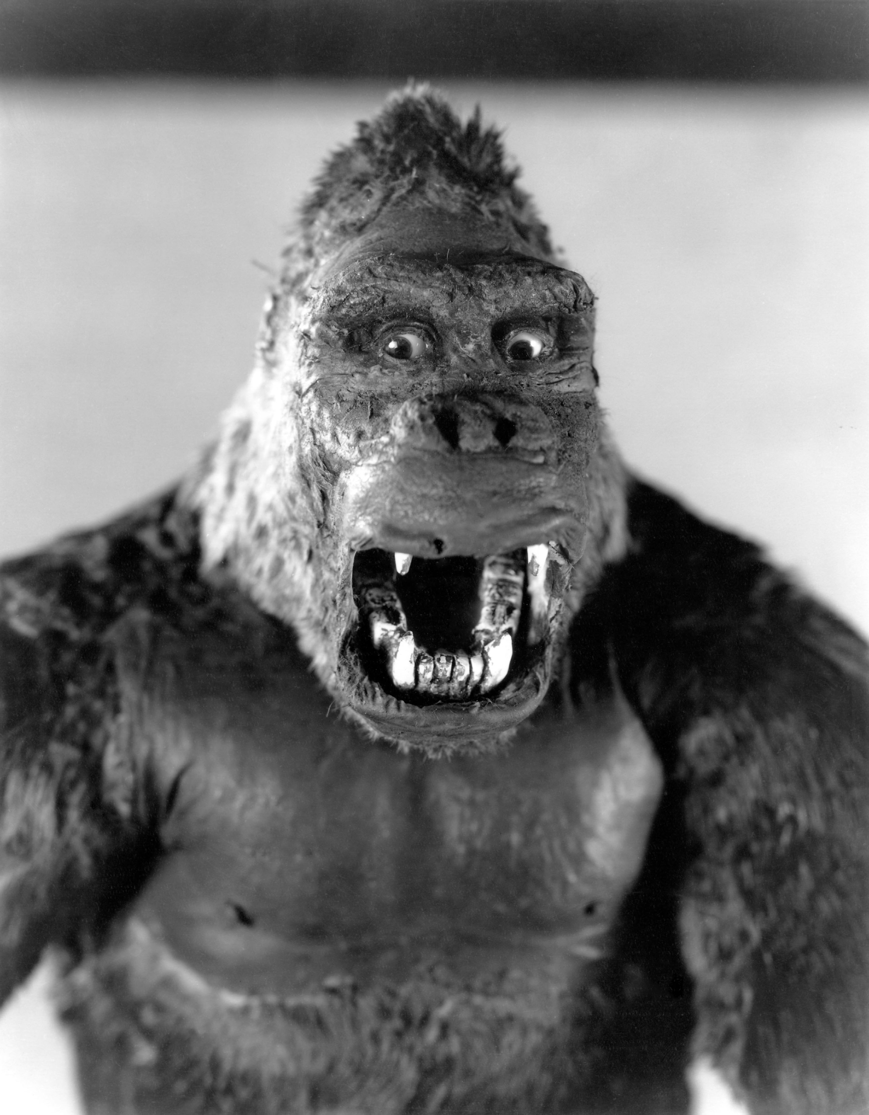

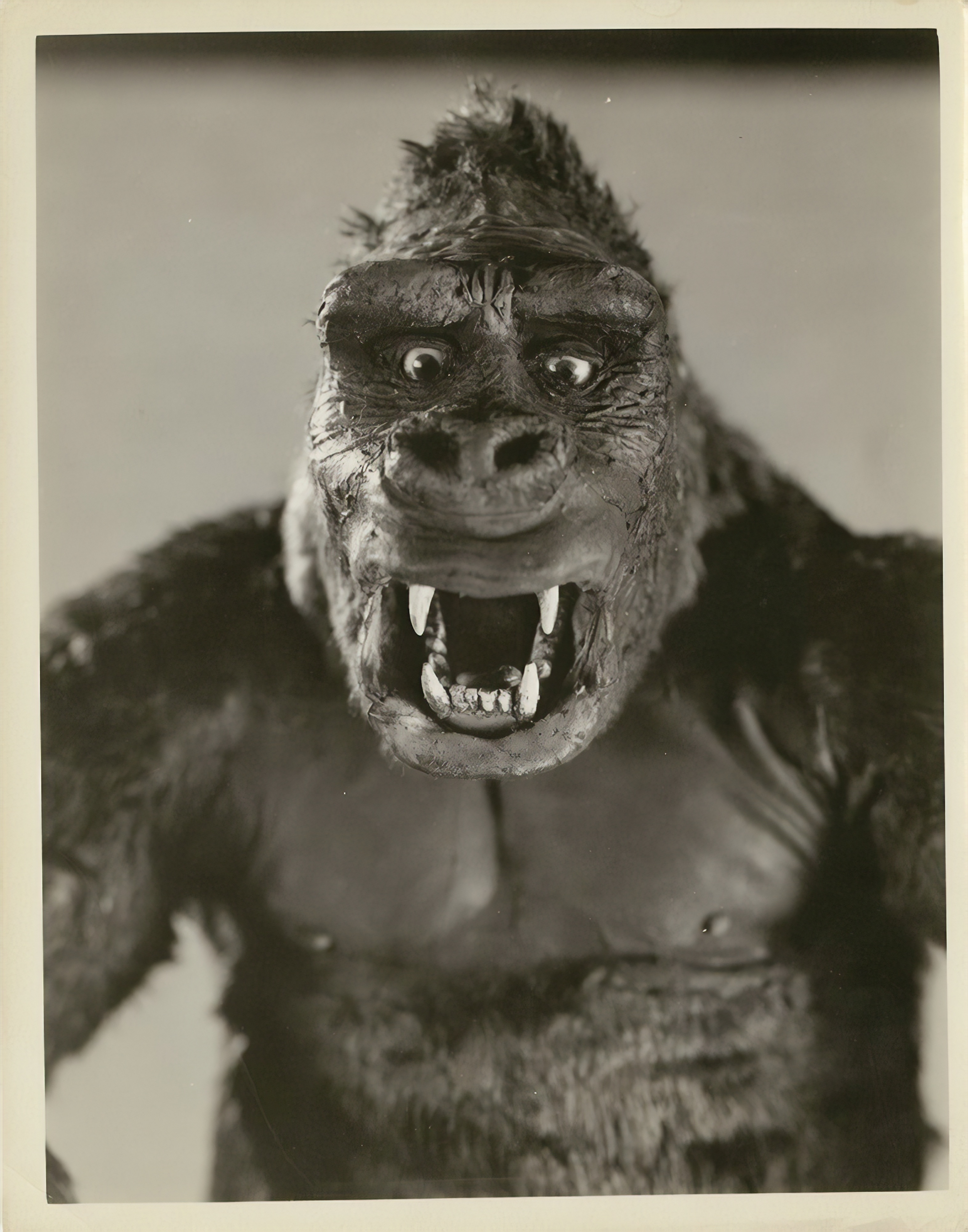

That is looking fantastic! Here's a couple of reference photos if you haven't seen them already.

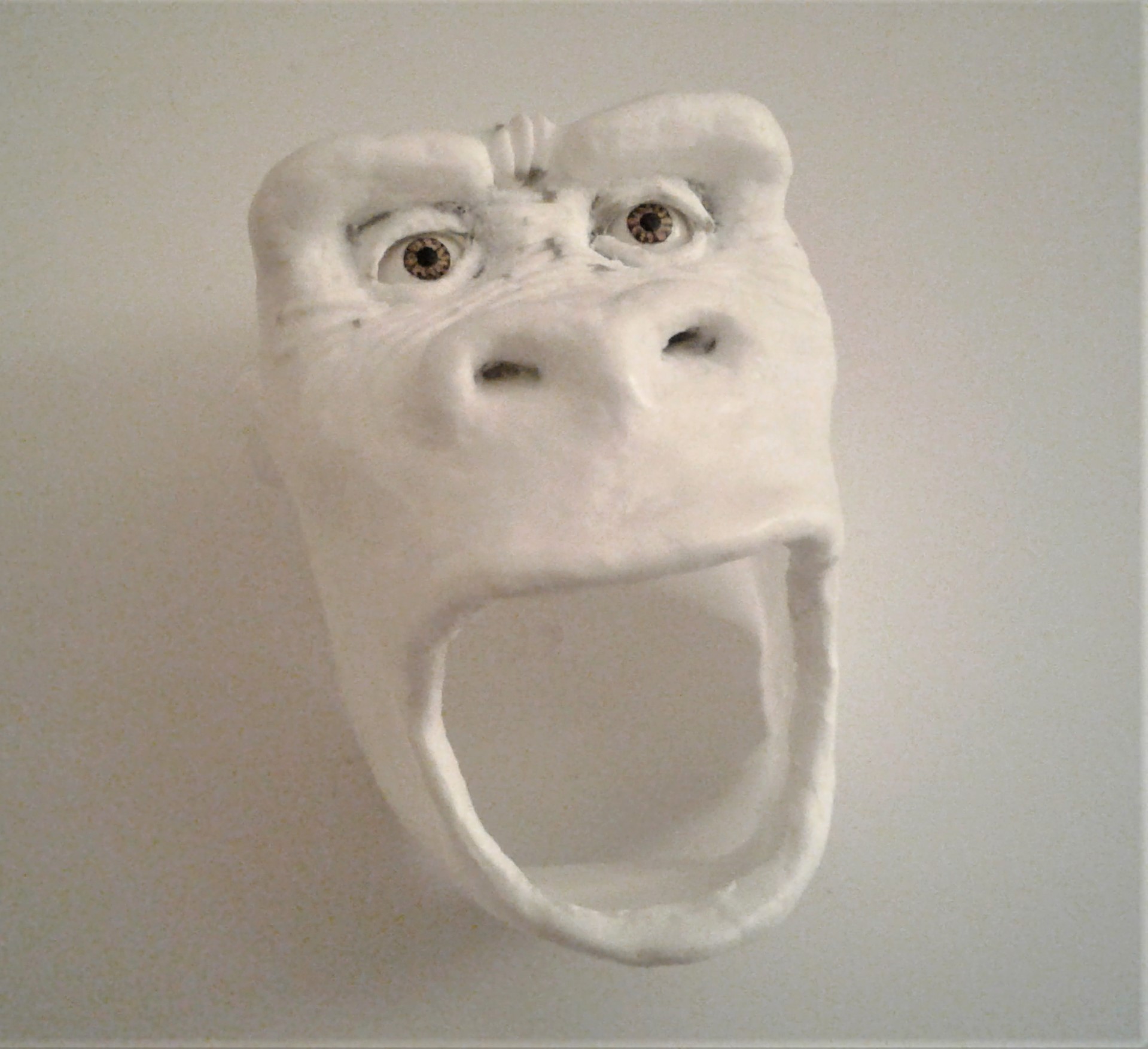

Thanks for the kind words! Those first two photos are of the long face Kong, I'm basing mine entirely on the round face one (see photo). I've ordered most of the materials I need to finish the build, so hopefully I'll have some decent updates by the end of the month/early March!

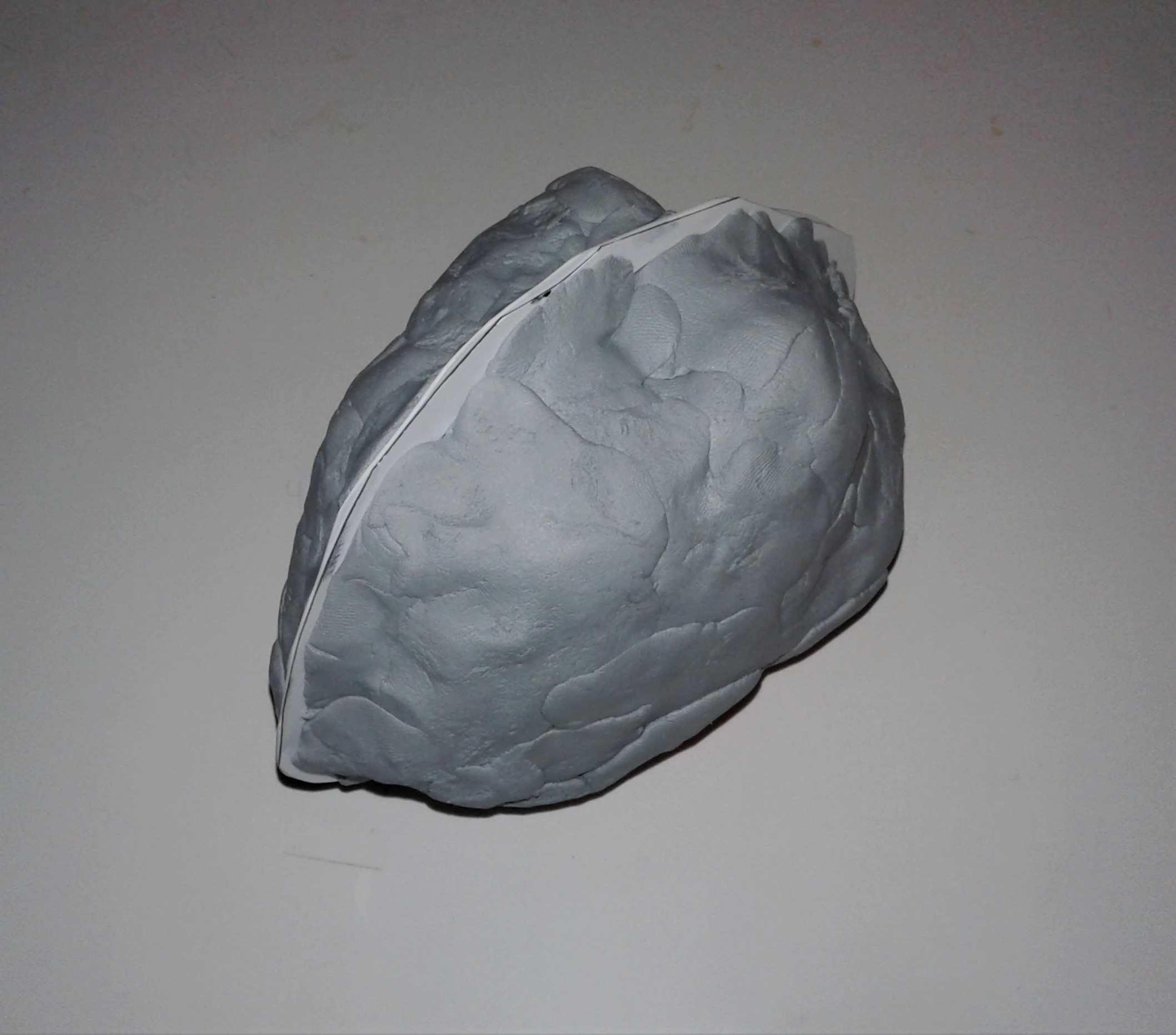

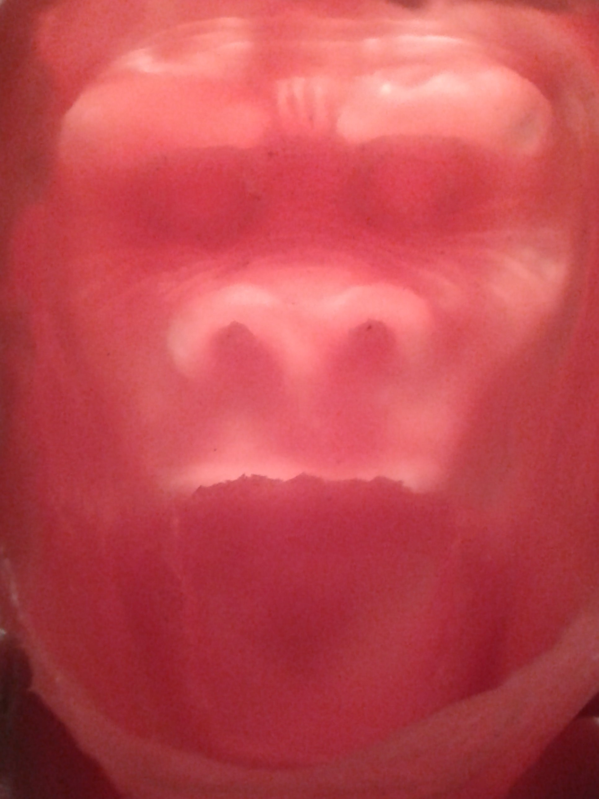

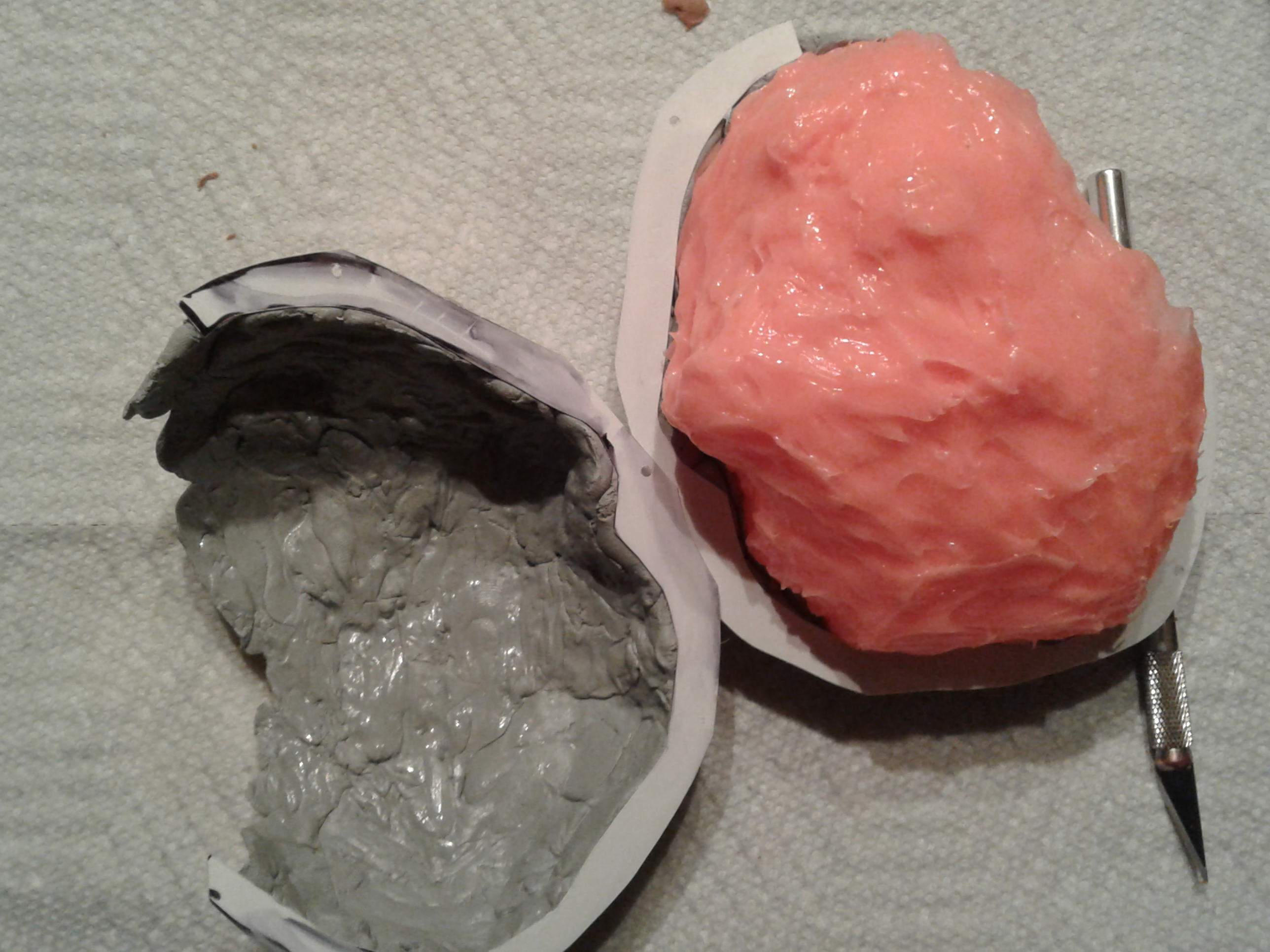

Kong's head is covered in silicone and an epoxy mother mold. I have yet to crack it open, I plan on doing that later this week, but I'm crossing my fingers that it works out. Even if there would be something wrong with the resin castings, I could still probably fix it, and worse case scenario I have enough supplies to redo the entire mold.

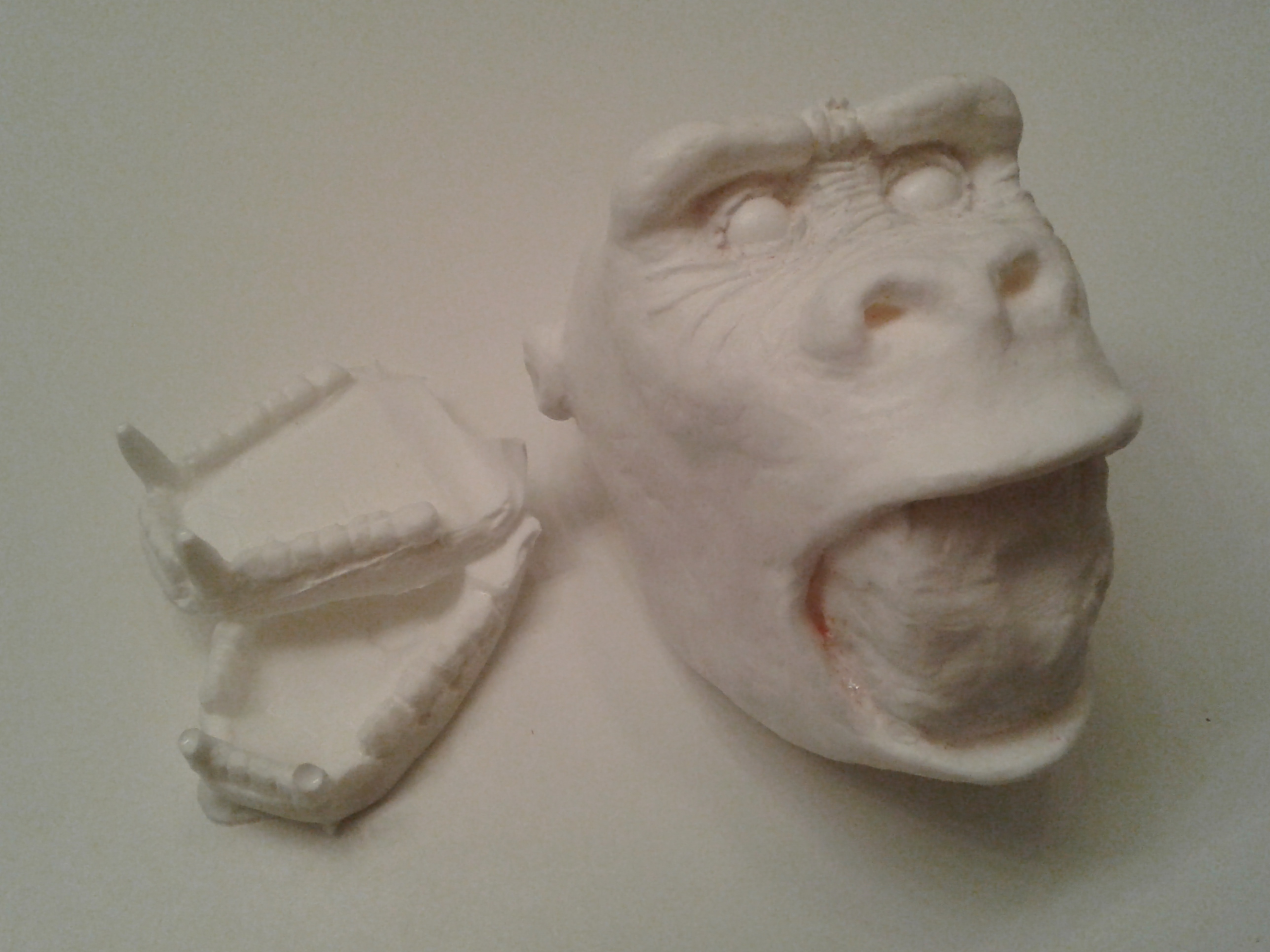

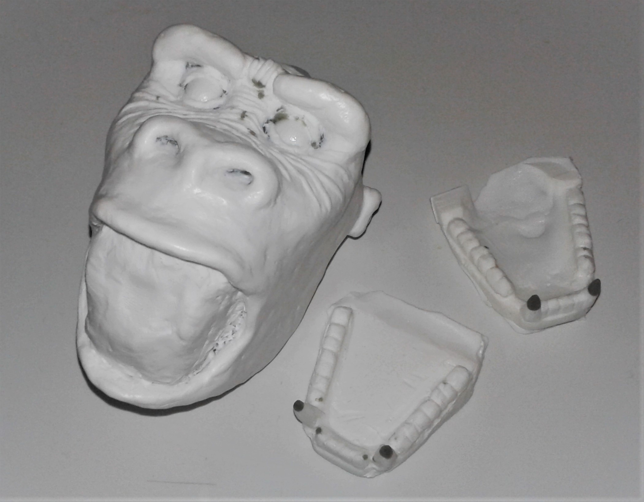

First castings! There were air bubbles at the points of the fangs, so I'll have to fix those with some epoxy putty - easy fix. And then the head casting came out great for the most part. A few of the wrinkles had some air bubbles so I'll have to repair those, and then there are some little specks of clay and silicone in the surface of the casting, so I'll have to get a needle and pick those out, fill them, etc.

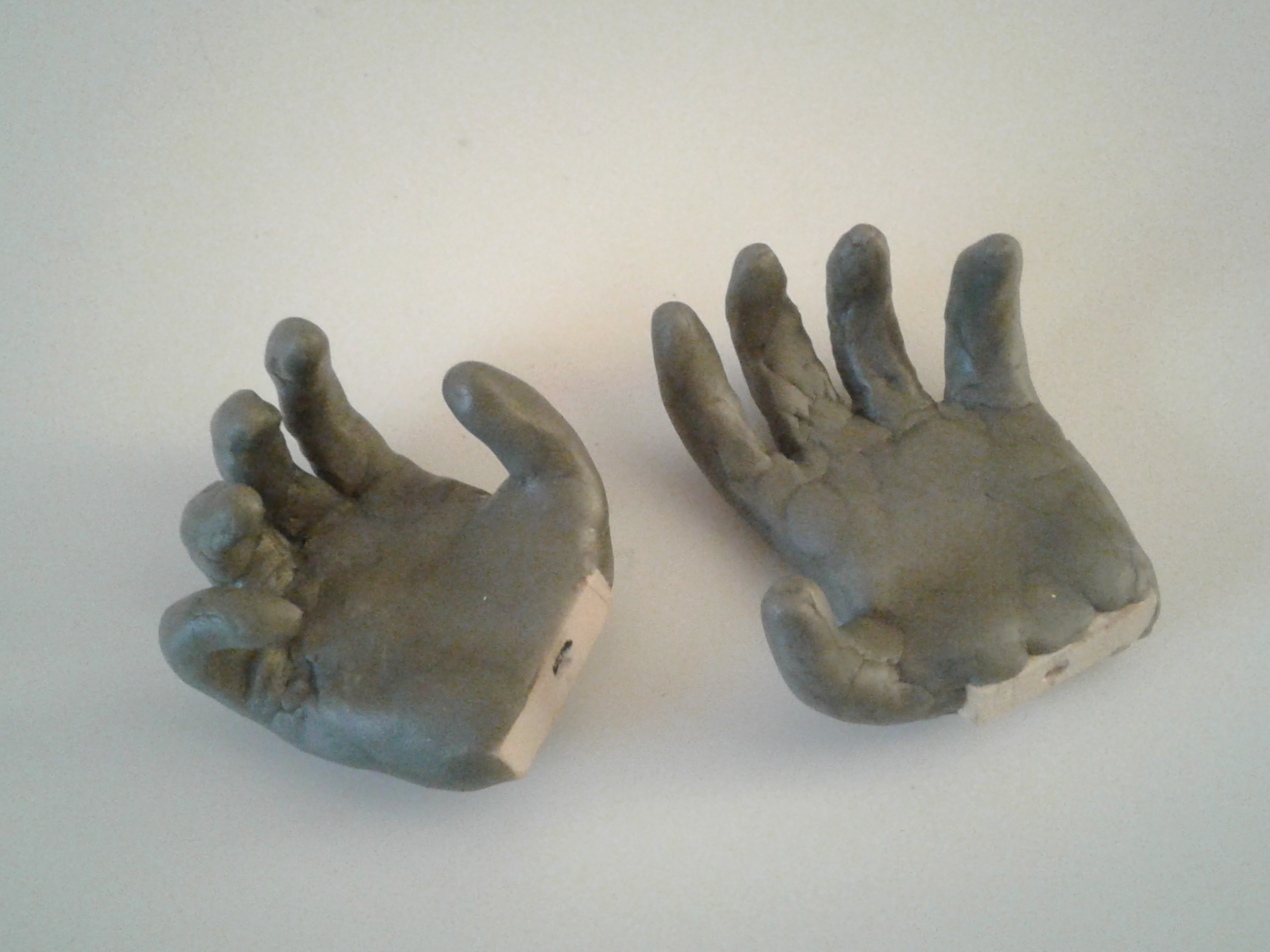

Small update. I made more castings of the head and got one I liked on the fourth try. A few areas needed reinforced with epoxy, and some bubbles needed filling as well, but this was the best casting so far. I also fixed the bubbles in the teeth castings. I'm pretty close to having the model finished - I need to sculpt over the hands and feet with epoxy, pick out a fur so I can paint his body appropriately, and then attach the fur.
About the fur... I have two ideas of how to do it: I cut out strips of the fur (including the backing) and glue those strips to the body, OR I basically make fur 'clothing' that I pull over the body. If any of you have other recommendations on a better way to do it, I'd love to hear it. Thanks!

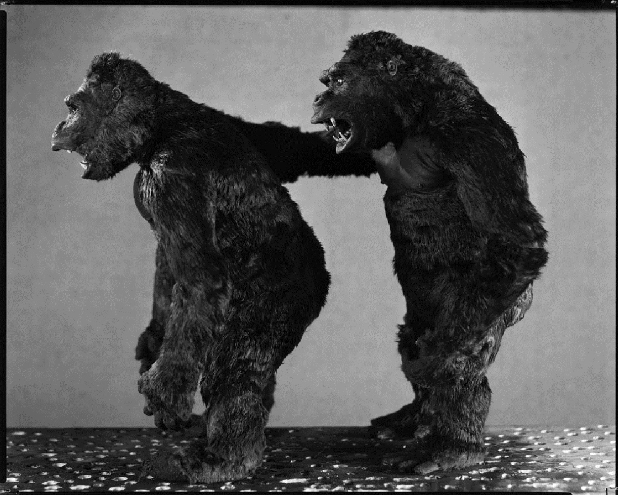

In the all the years of documentation I've read, this is the first I've ever heard of an additional, larger armature. Anyway, it is true that Kong appears larger in the New York scenes, but Occam's Razor and the nature of movie magic suggests Cooper and RKO taking the easier solution of just building the NYC scenery at a smaller scale than those built for Skull Island rather than commissioning yet another Kong puppet.
There was no armature taller than 19". I've been a Kong fanatic for 50 years. I've studied everything about Kong and the armature and I can say that with absolute certainty.
I've talked to Bob Burns and was lucky enough to hold the original Kong armature and he said there was only three armatures. Two long face Kongs used in publicity still and the round face Kong used for the movie.
The scale changed throughout the movie, most noticably the NY scenes but the armatures all stayed the same.

Technically speaking, Peter Jackson's Kong is 22" tall (based off of auction information) - I assume this is when the model is completely straightened out though, so in the film this model (the long face Kong) probably never reaches 22"
