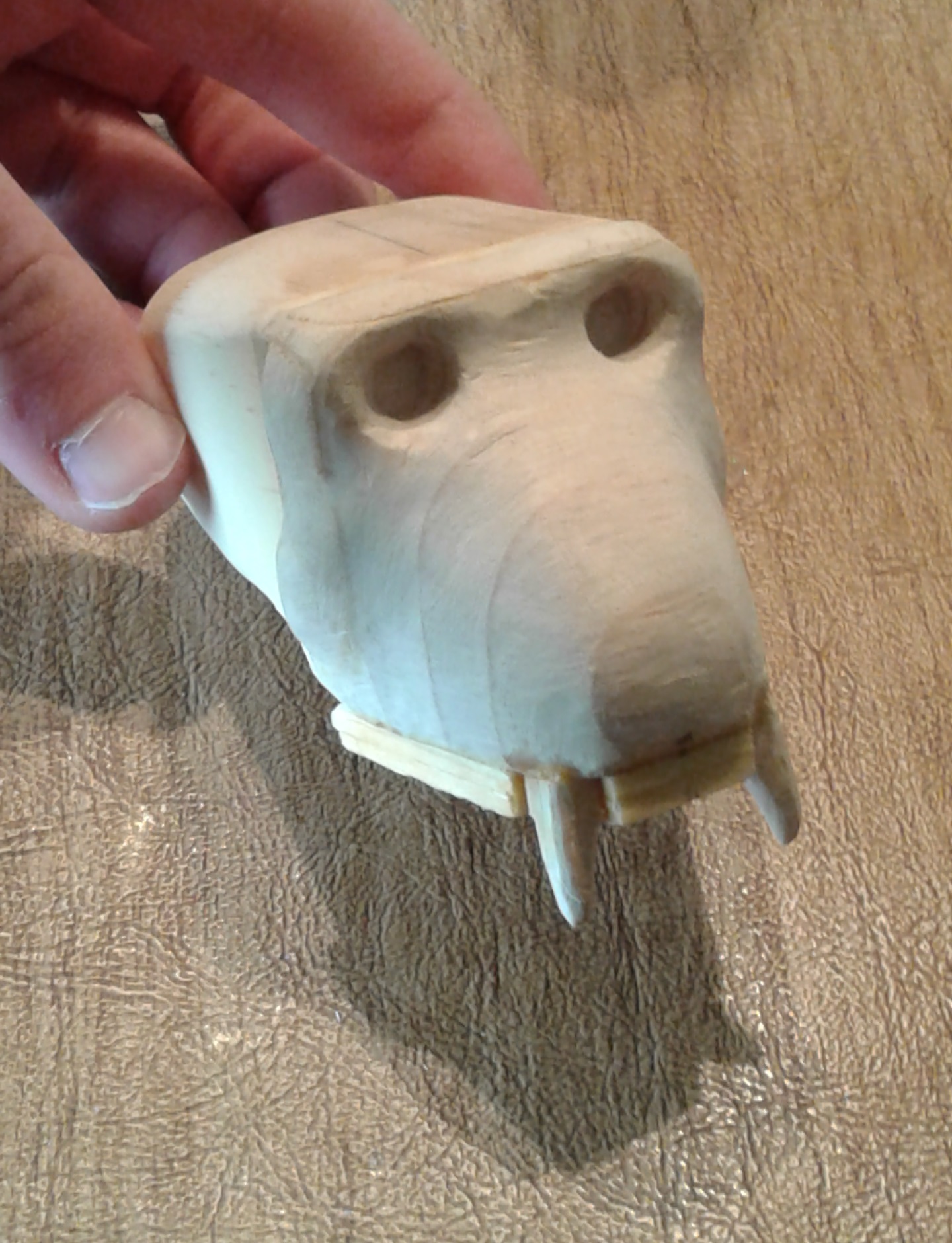

Small update - Just continuing the work on the skull. I was also thinking about display options, where one is Kong on the top of the Empire State Building. The building section alone would be 17.5" tall, not including Kong who would add another 10 inches or so. So I may just go with the puppet by himself with a Fay Wray miniature in his hand.
JoeCS
Continued work on the skull. I started adding the teeth by gluing on square strips of wood. The top two fangs took a long time to shape because I wanted to get them right. The other teeth will just be a matter of cutting in some detail with an xacto.
I'm starting to get something which looks like a Kong skull, which is promising. His skull is very different from an actual gorilla's, his is more square, which may be part of an effort to make him a mix between a human and gorilla.

JoeCS
Worked mainly on the lower jaw today.
I'd like for his mouth to be able to close completely, but if I can't get it to work, it's not the end of the world. His mouth will be open on the final display anyway. I'm pretty happy with the fangs, which are probably the most important part of this area, but the rest of his teeth still need some refining.
