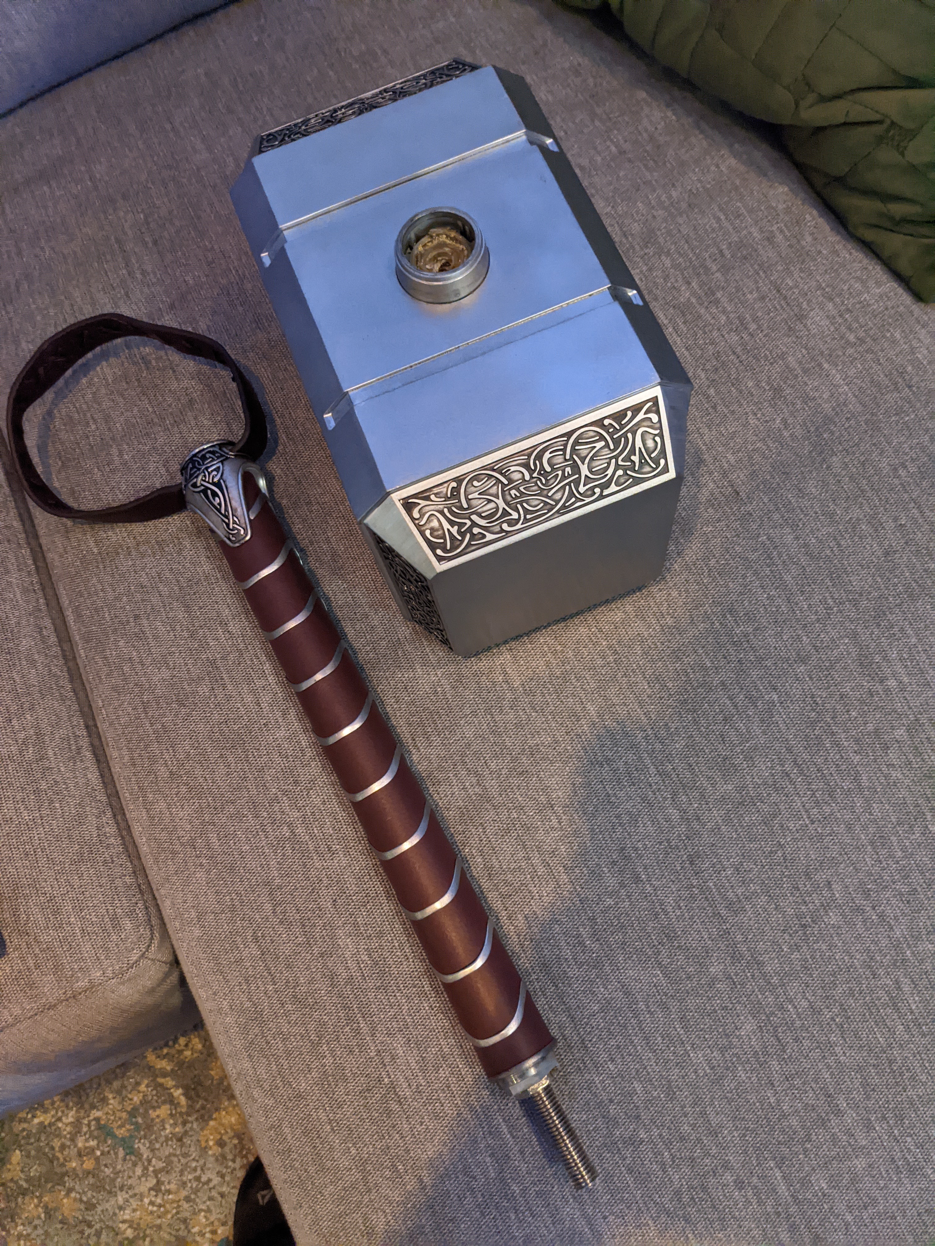

now that i have one, the first step was to pull it all apart.
i want to give a MASSIVE shout out to Heyjude7 for all of his support and advice when tackling this project. he went absolutely above and beyond and i am eternally grateful. he tackled this same project years ago and was happy to share his knowledge.
so pulling this sucker apart was incredibly difficult. in particular, unscrewing the handle to the hammer head.
for the wall mounted version the hammer comes in tact. however for the pedestal style i believe it comes separate which would have been nice lol.
loosening the epoxy grip inside the head was a herculean effort, and several times i thought i was going to break it (thanks Jason for reassuring me that i wouldnt lol)
but i guess eventually i was deemed worthy and it loosened!
now that it was separated, i decided to begin the paint stripping process.
after chatting with Jason, we deemed that the best method would be the good ole fashion manual process, fine grit sanding and wet sanding.
i tried several other chemical options and they werent successful... i also have a 4 yr old son and was hesitate on trying anything too toxic in the basement as im not familiar with ANY of this process.
so manual sanding began!
after 2 days in my off hours i finished 3 sides! LOL
during this stripping process i couldnt for the life of me understand WHY King Arts covered up this beautiful metal... i do know the reflectivity of the metal from the avengers moving forward definitely did get more matte... and i can only assume it was for filming purposes and not having to deal with reflections of the camera and crew... so it makes sense but i digress.
this metal is absolutely stunning and was incredibly excited to see this hammer literally come to life as i stripped and polished.
as for the materials, i used 600 fine grit wet sandpaper to strip the paint and then 0000 steel wool to polish and buff to a mirror shine.

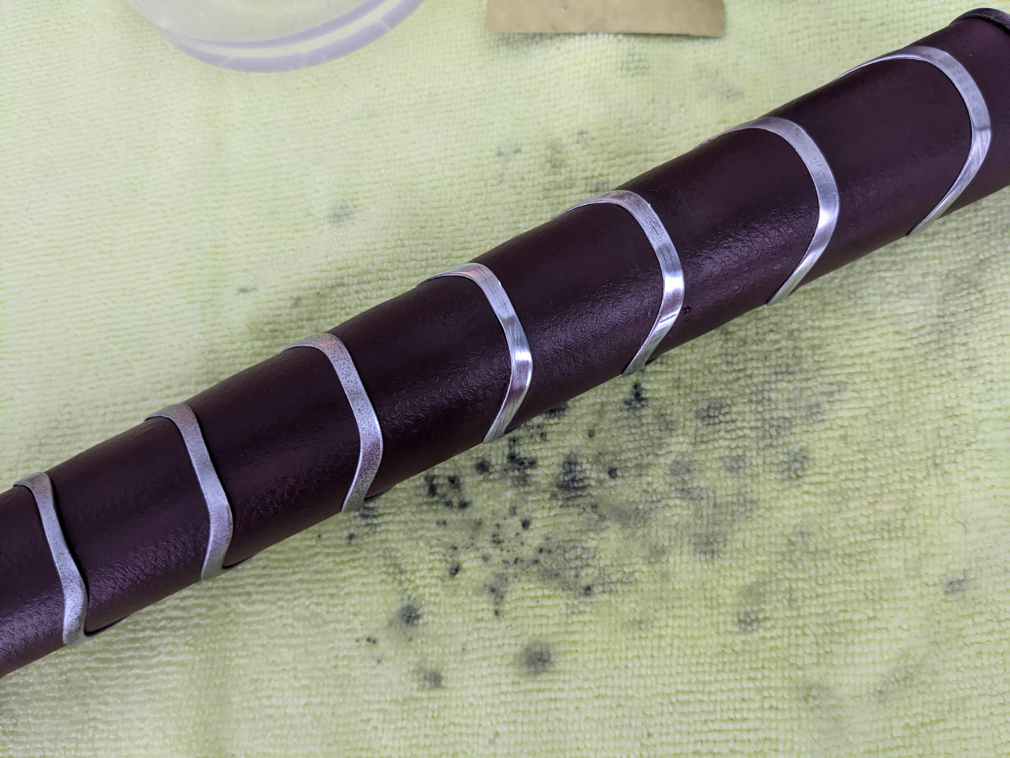

next step was to polish all the metal chevrons on the handle and pommel.
the right 4 chevrons are done and the left half isnt for comparison
and after 3-4 days i finally had a BEAUTIFUL clean Mjolnir!!!

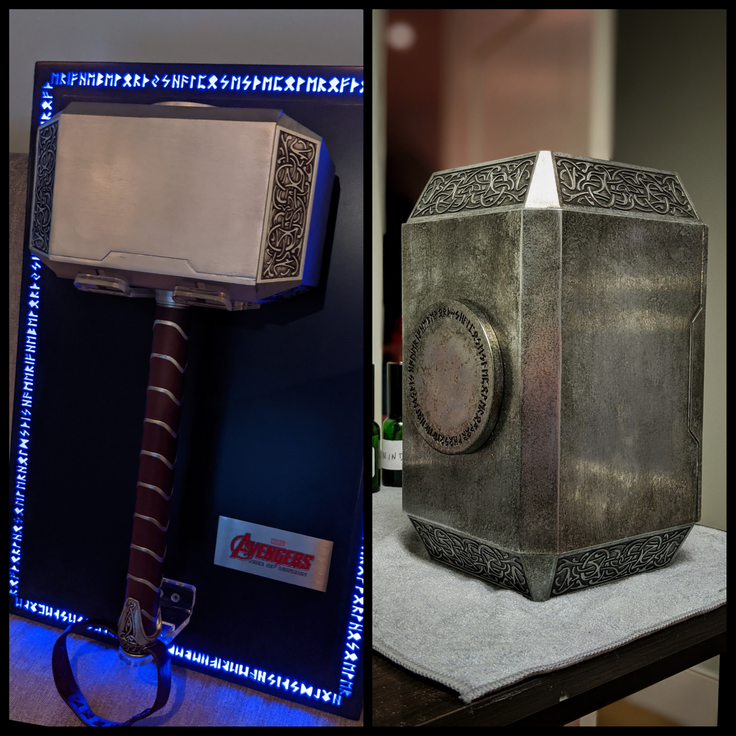

WEATHERING!!!
As a disclaimer... I have never weathered a prop before in my life.
In fact, my entire career is based in CG... I worked in the visual effects film industry for 15+ years and have recently moved over to games where I work as a senior texture artist at Epic Games working on characters for Fortnite.
Having worked exclusively in the digital world on many big films, I have always wanted to make the CG assets I have worked on in real life. To physically create it over digitally.
And as a fun fact, I actually painted the CG Mjolnir in Thor Ragnarok.
So I knew exactly HOW i wanted to weather it in my mind's eye, however I had no idea exactly how to do that physically...
And thanks to Filandrius and Heyjude7, I started doing some paint tests with some techniques they shared with me.
And after days of testing various techniques, I was finally happy with not only the overall look but the process in which I could achieve that look consistently.
I'm so used to easily ctrl + Z to fix any mistakes I do so not having that, and being on a clock with how acrylics work was a MASSIVE learning curve for me.
At times it was a bit deflating and frustrating but I stuck with it and finally came out on the other side!
And after several attempts and redos on the actual hammer, I finally completed the weathering process!
I couldn't be happier with the final result.
It is beautifully reflective with just the right amount of weathering and wonderfully solid and heavy.
View attachment 1374563View attachment 1374564View attachment 1374567
View attachment 1374569View attachment 1374568
