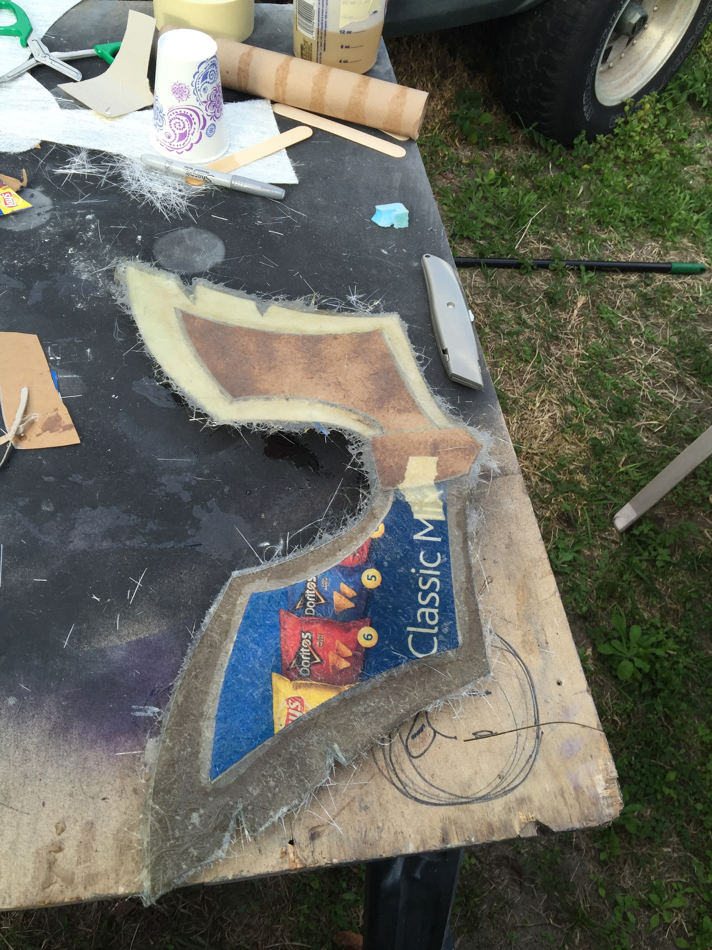

Been working on a scratch build of the Kill La Kill character Ryuko Matoi. This will be a wearable costume, I'm only making the armor, the soft bits will be made by another artist.Here goes the photo dump!First up we have a reference, It is this version that I am going for.

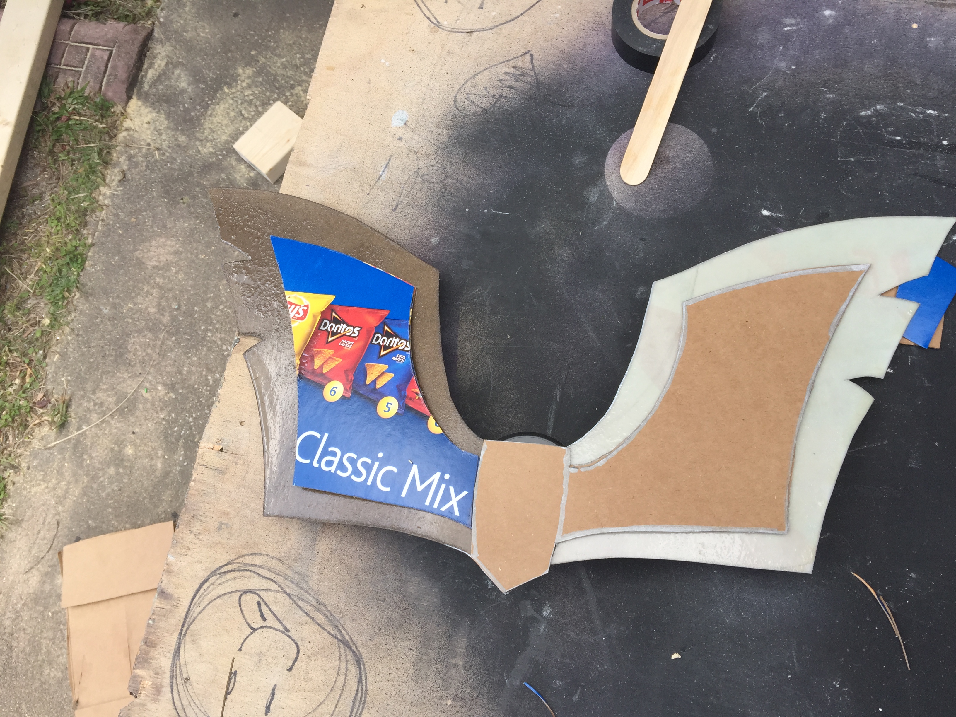

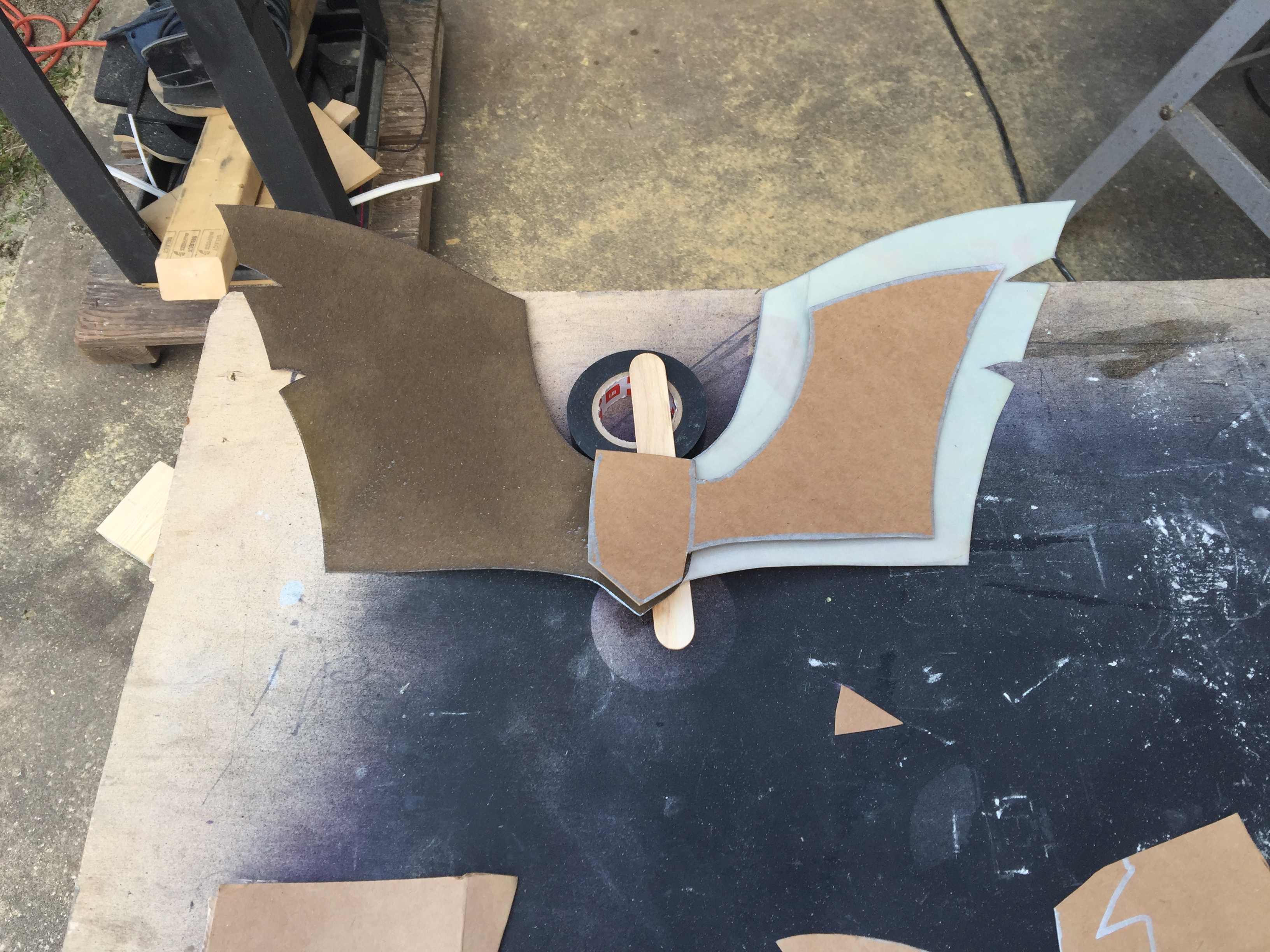

Staring out with some card board.

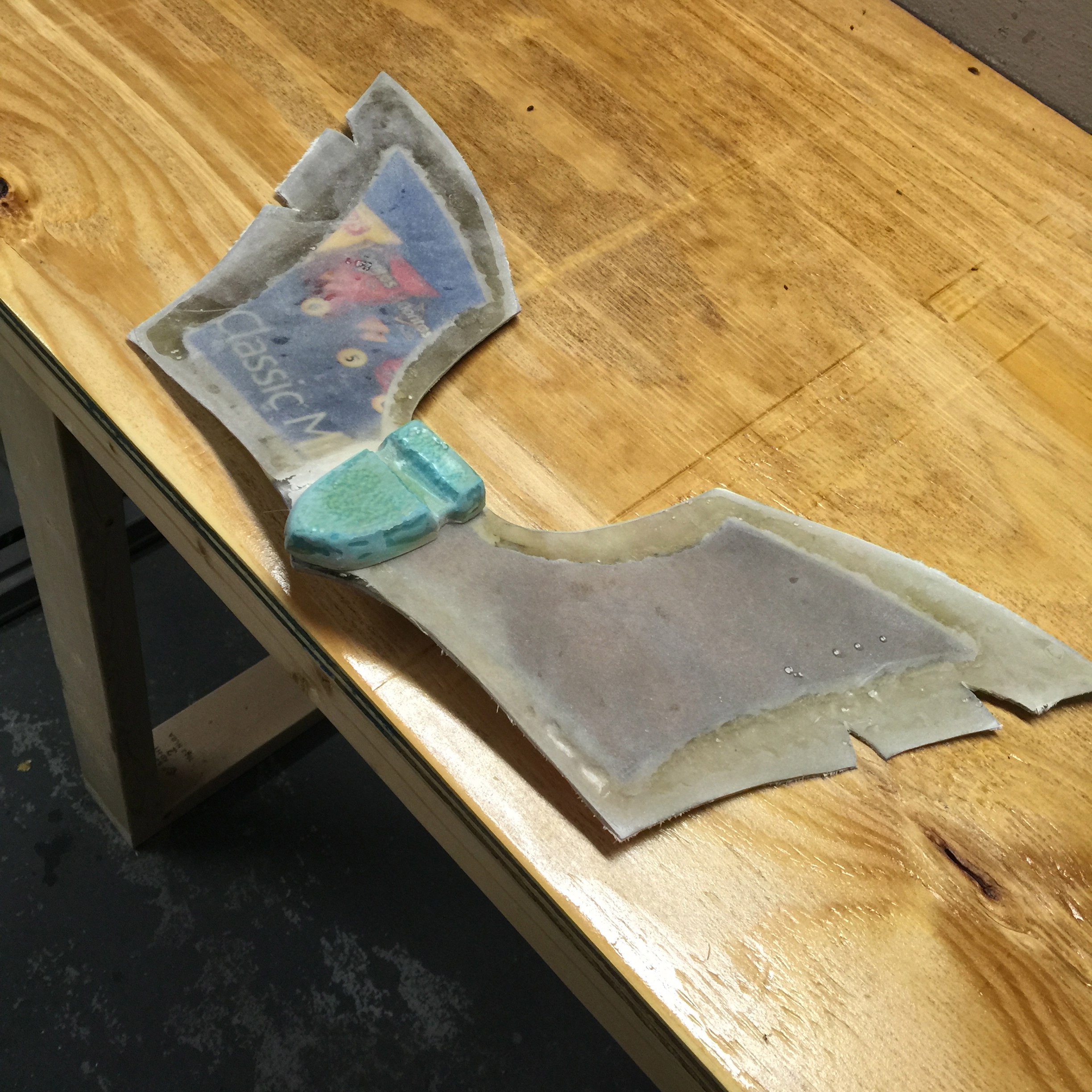

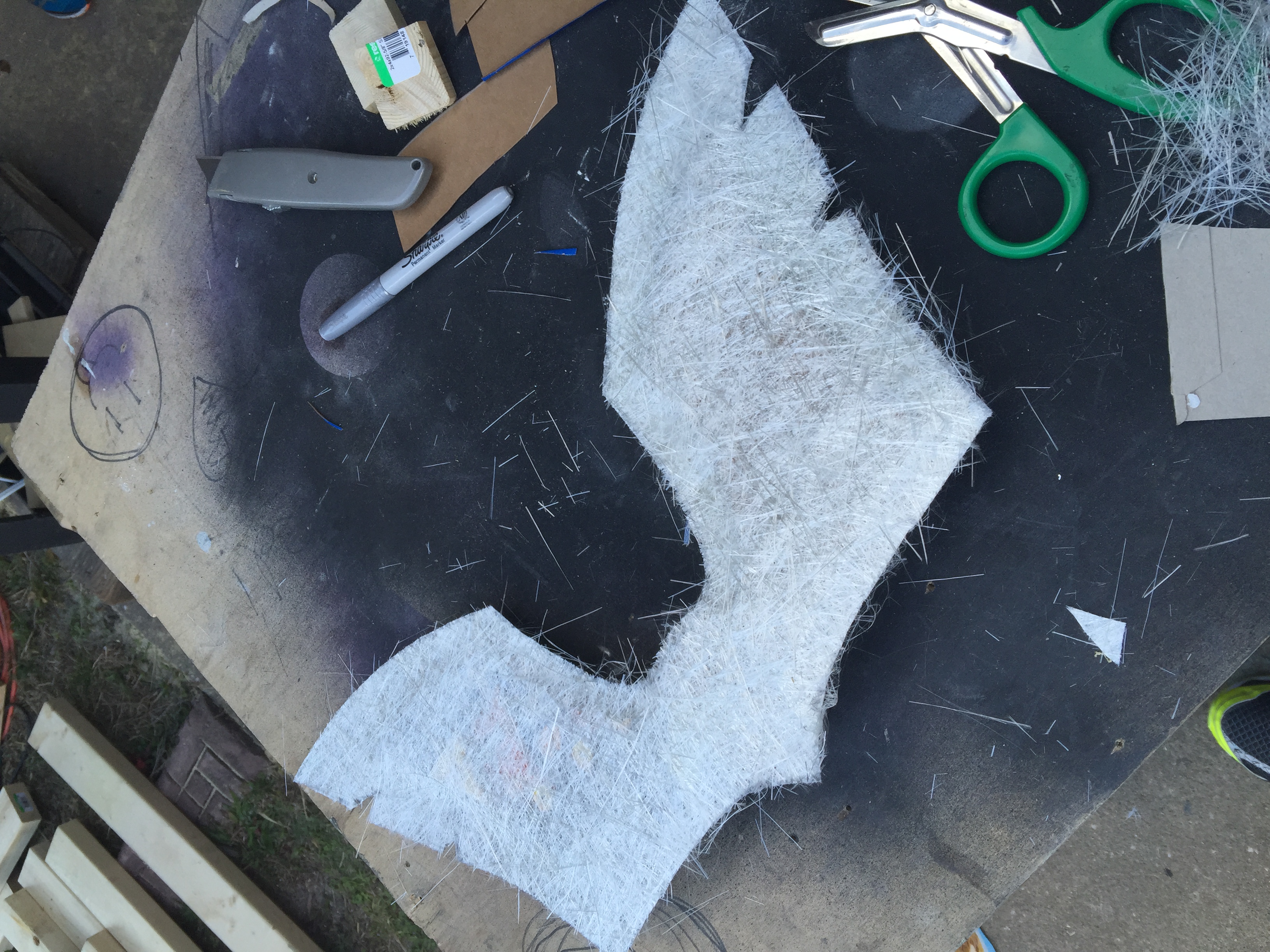

Fiberglass mat, and resin are next.

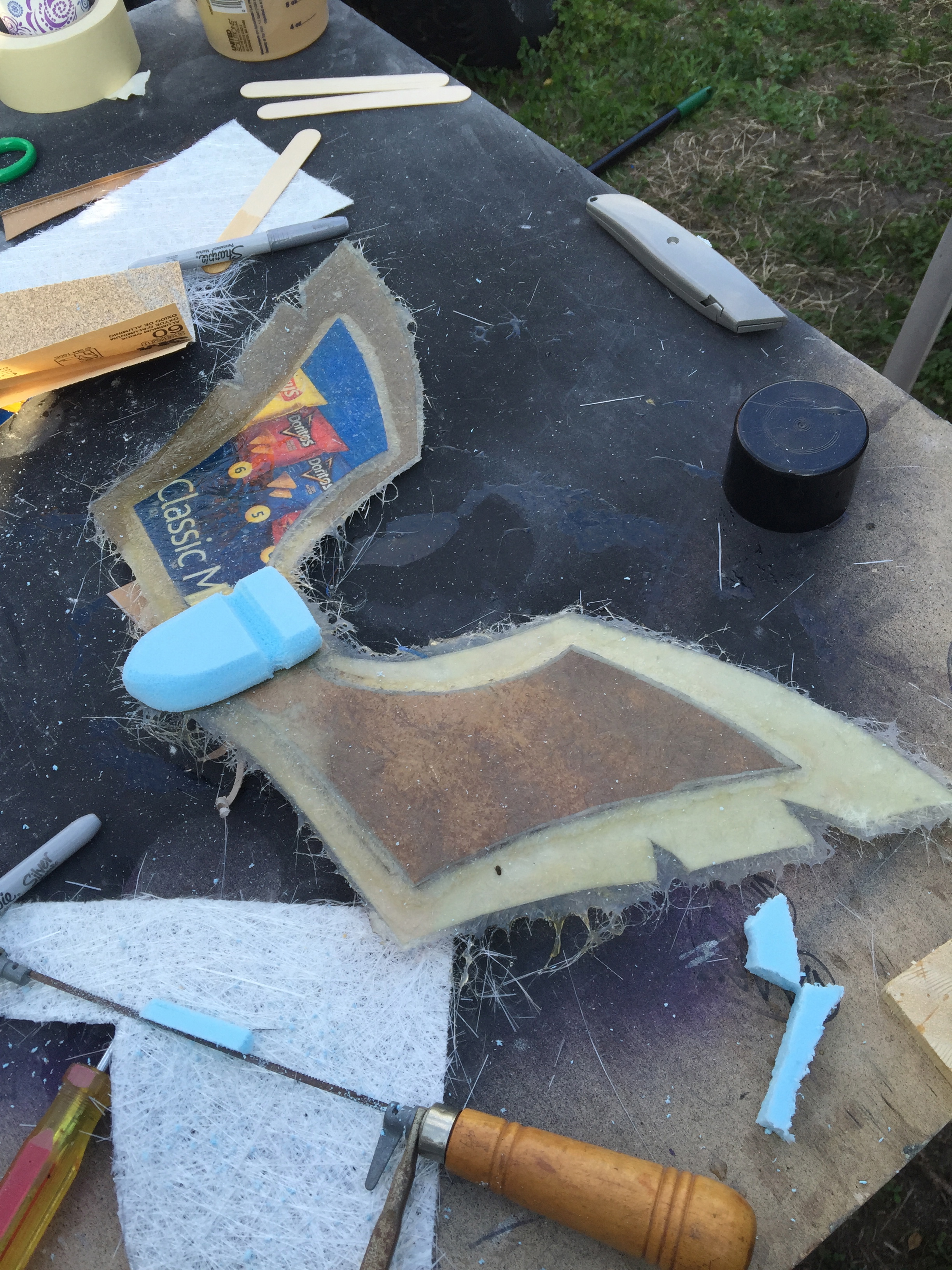

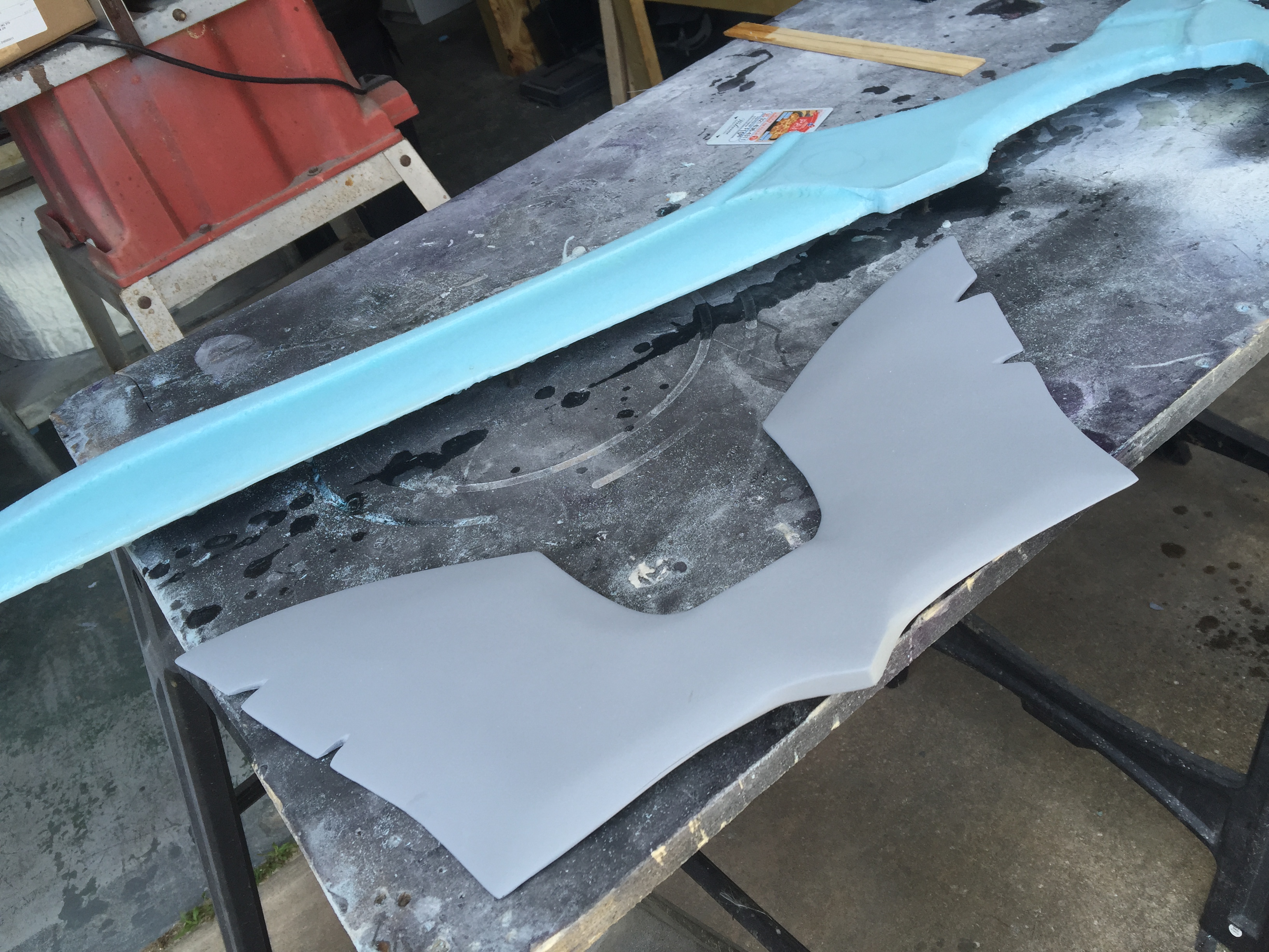

Next I use some foam to sculpt the center piece
Re: ryuko matoi Build log

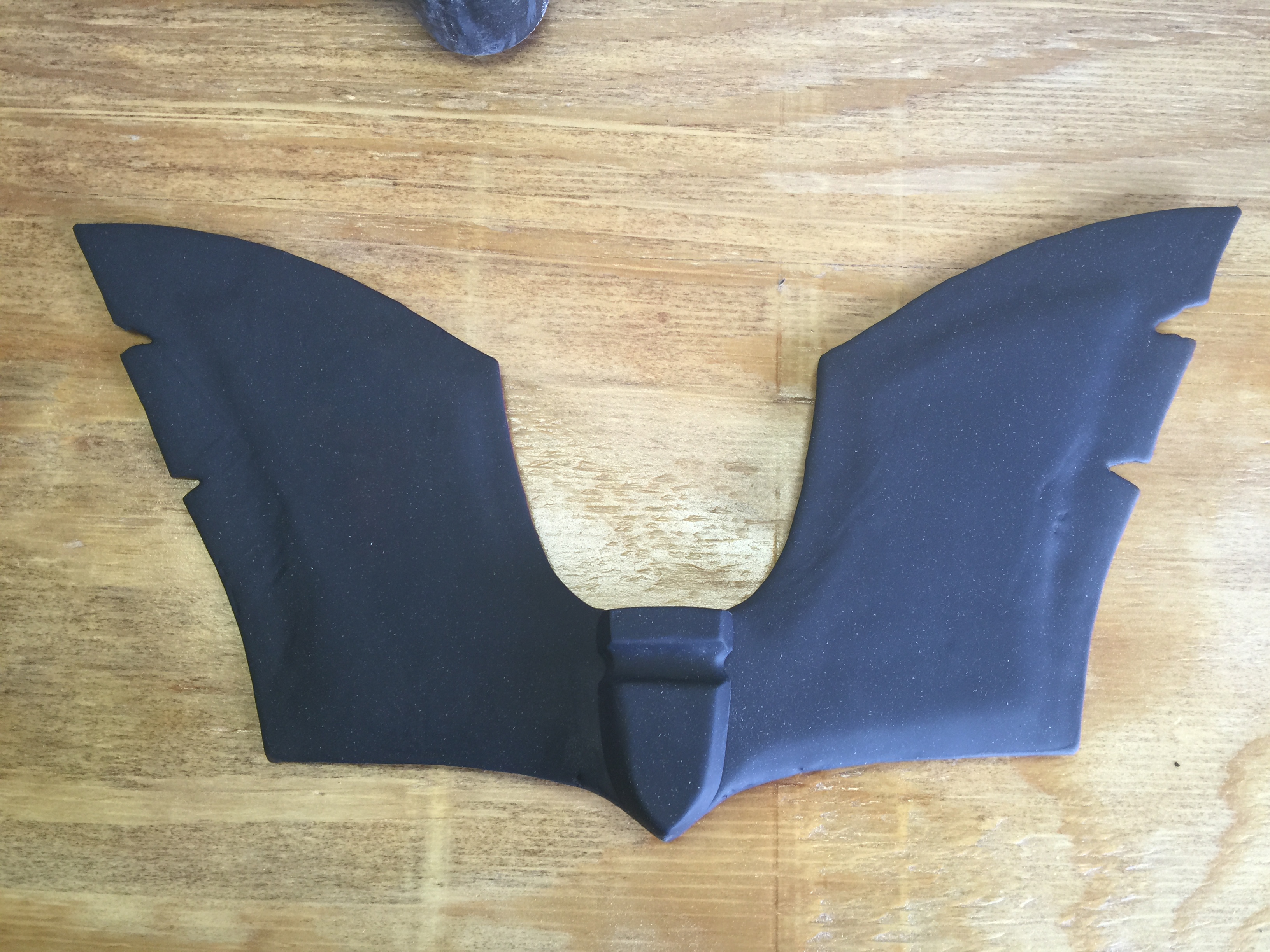

Body Filler and Primer, and lots of sanding.
The sward makes it's first appearance here. With a much smoother looking piece of armor, after much filling and sanding of course:)

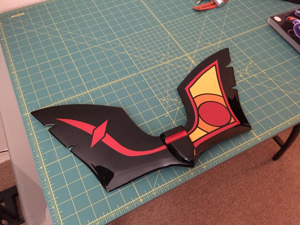

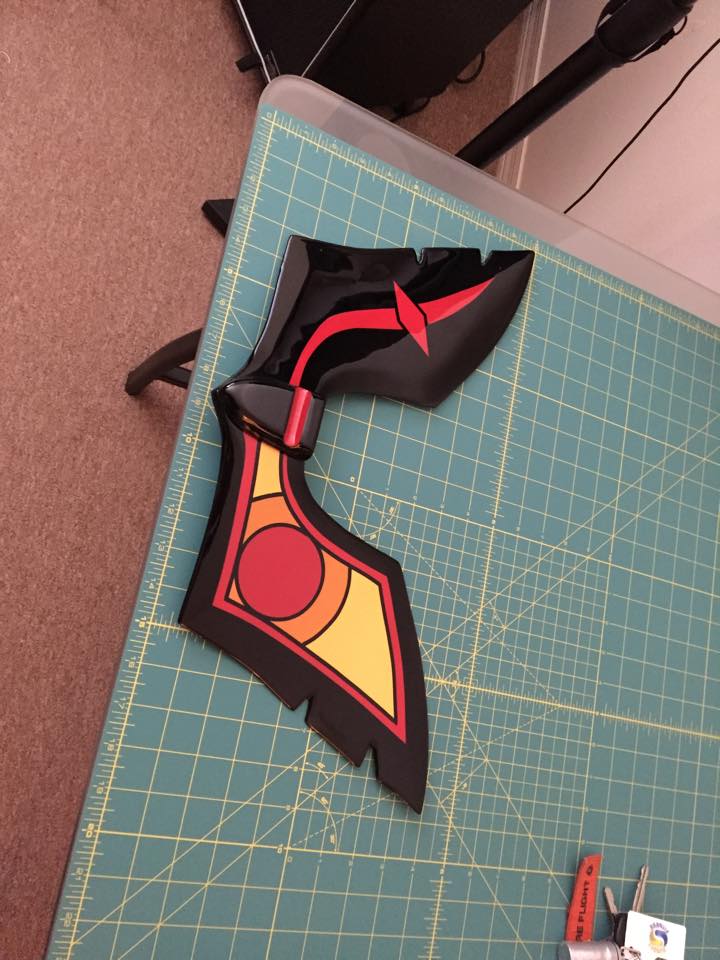

And now for the expensive paints ;)
And some fancy tape work

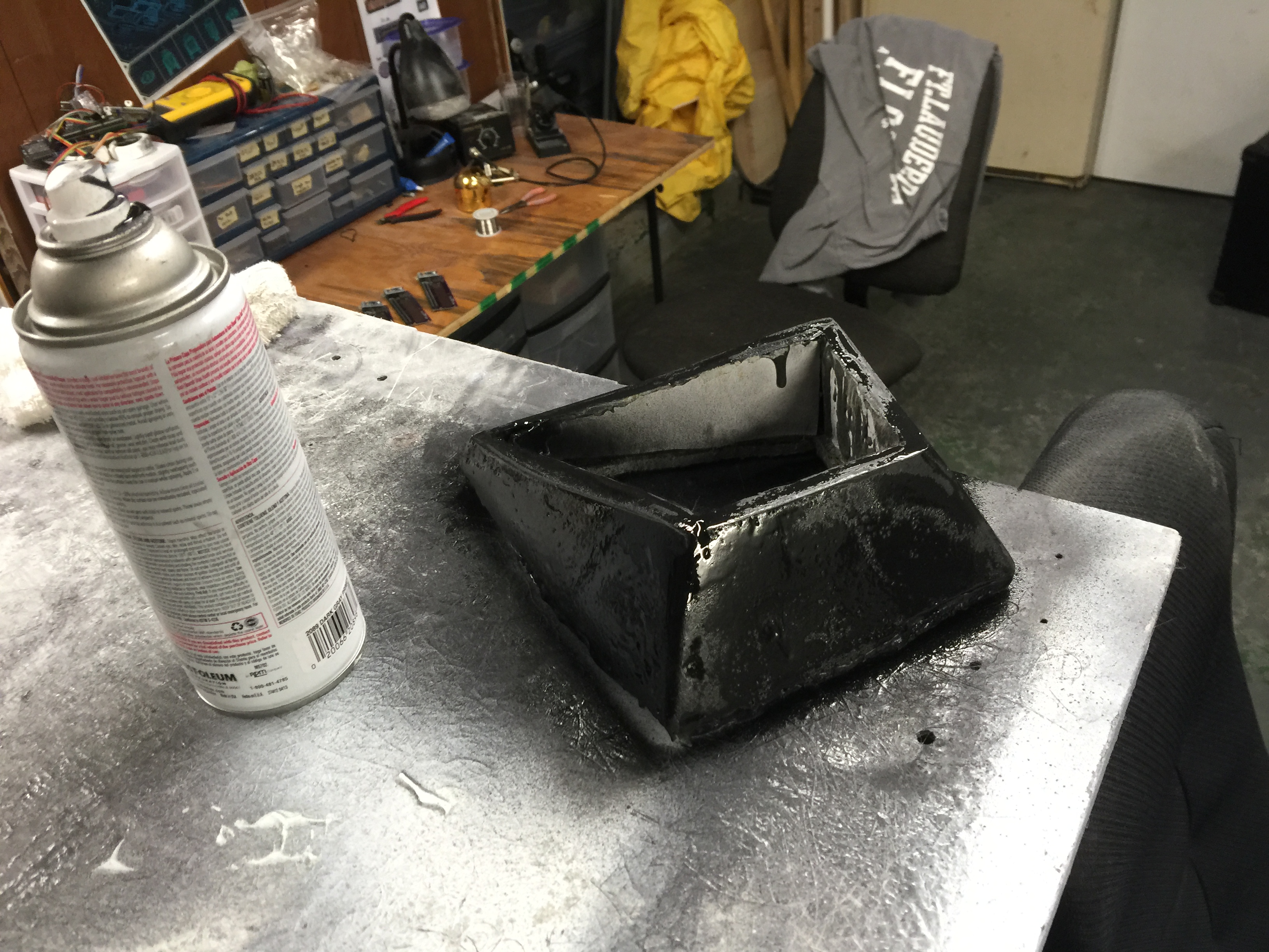

I want it shinier!!!

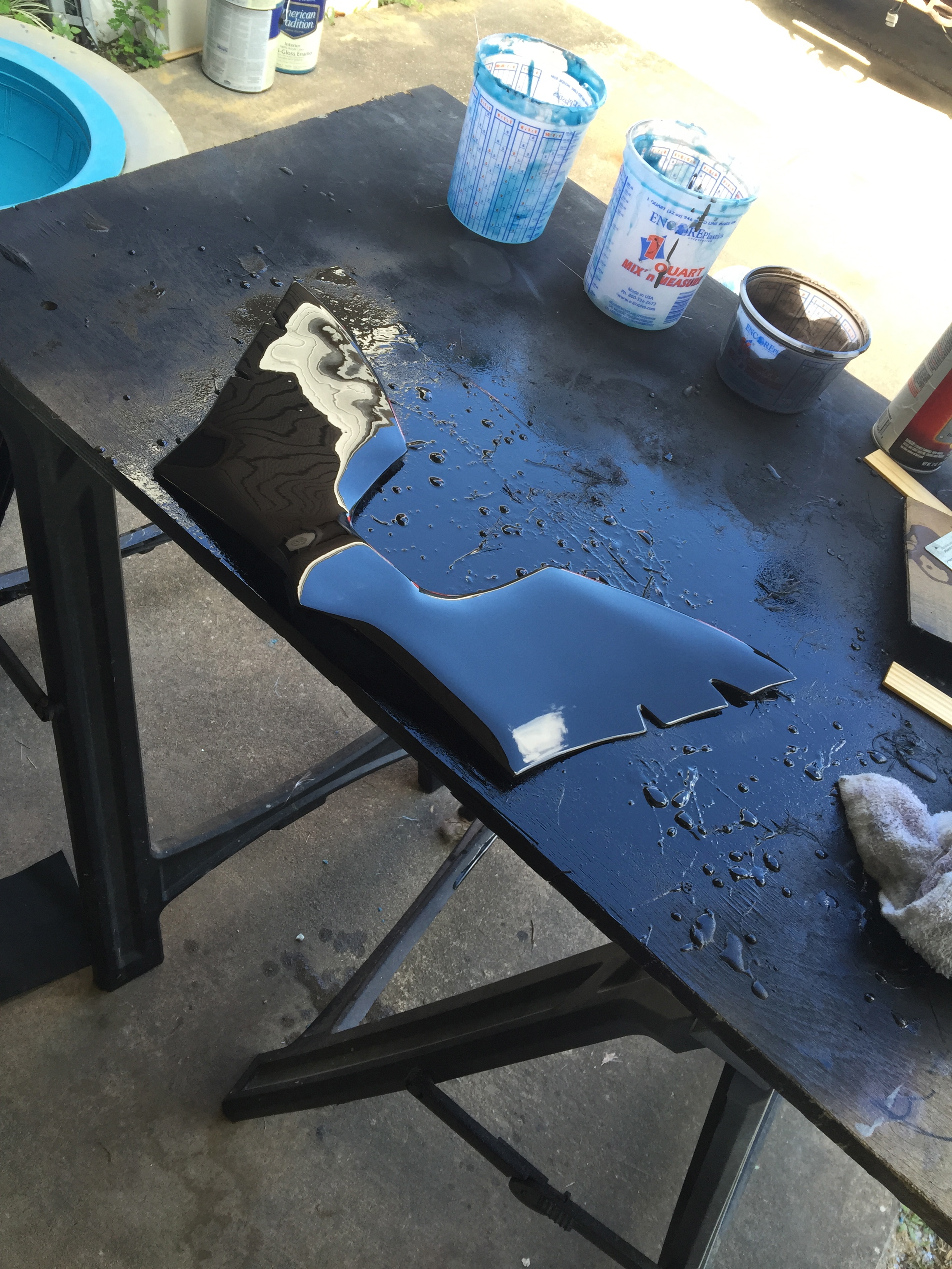

Get the gun, Time to spray some clear!

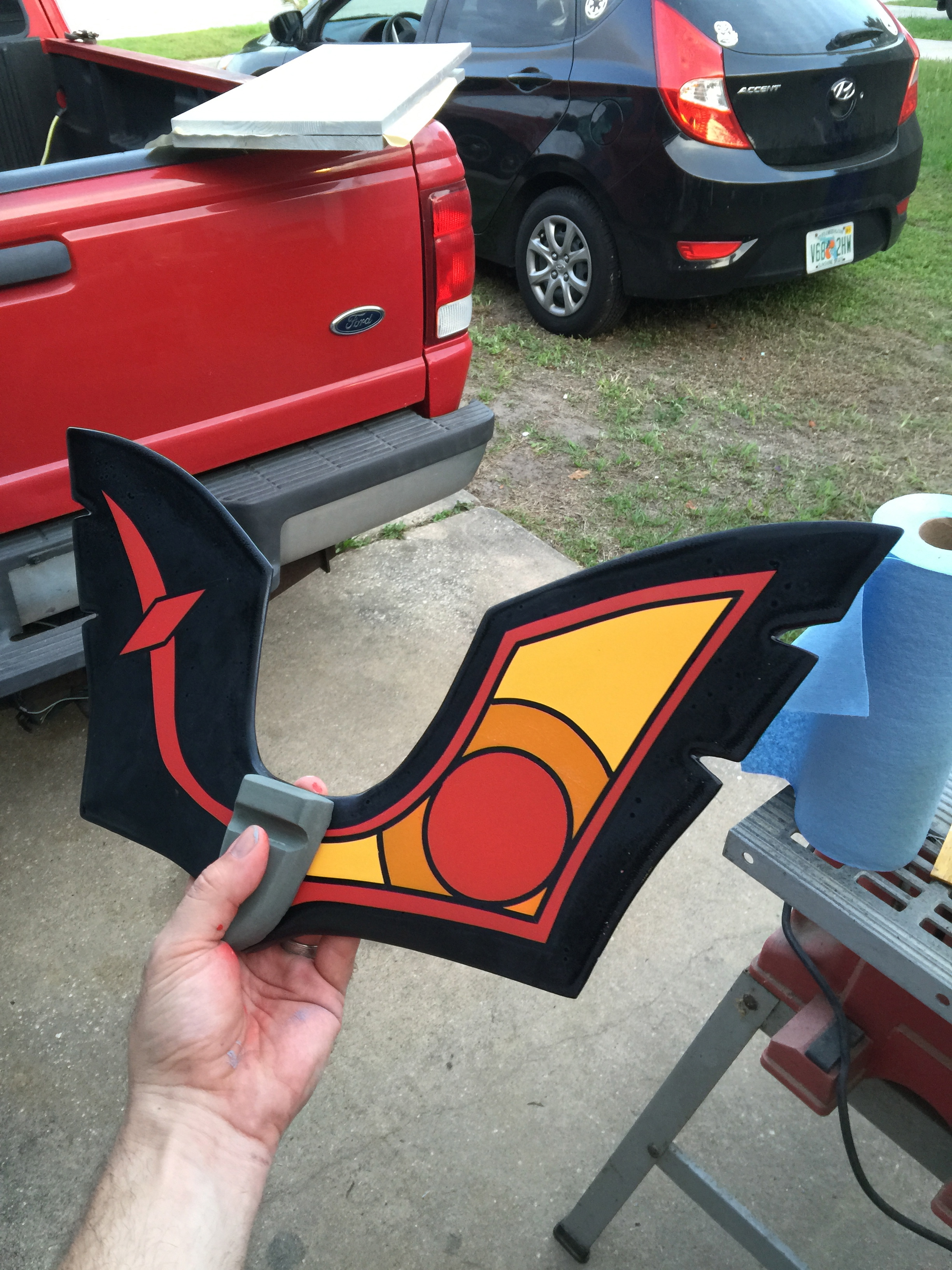

And this is where I left the project for today. More to come, I have started the back piece of the armor too, and will post on that. Still a lot to do.

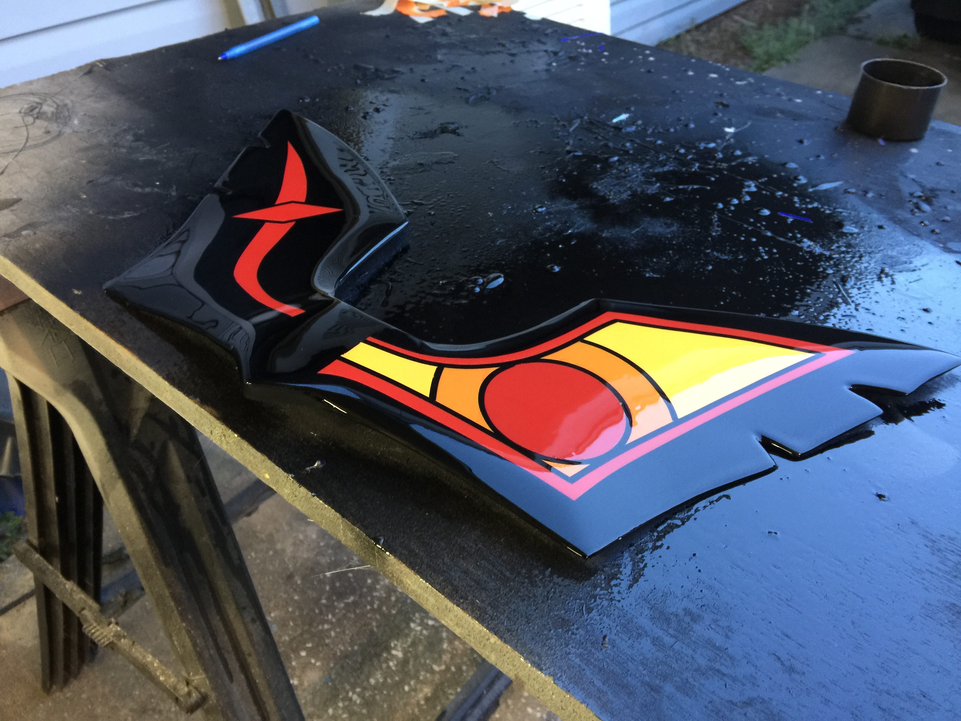

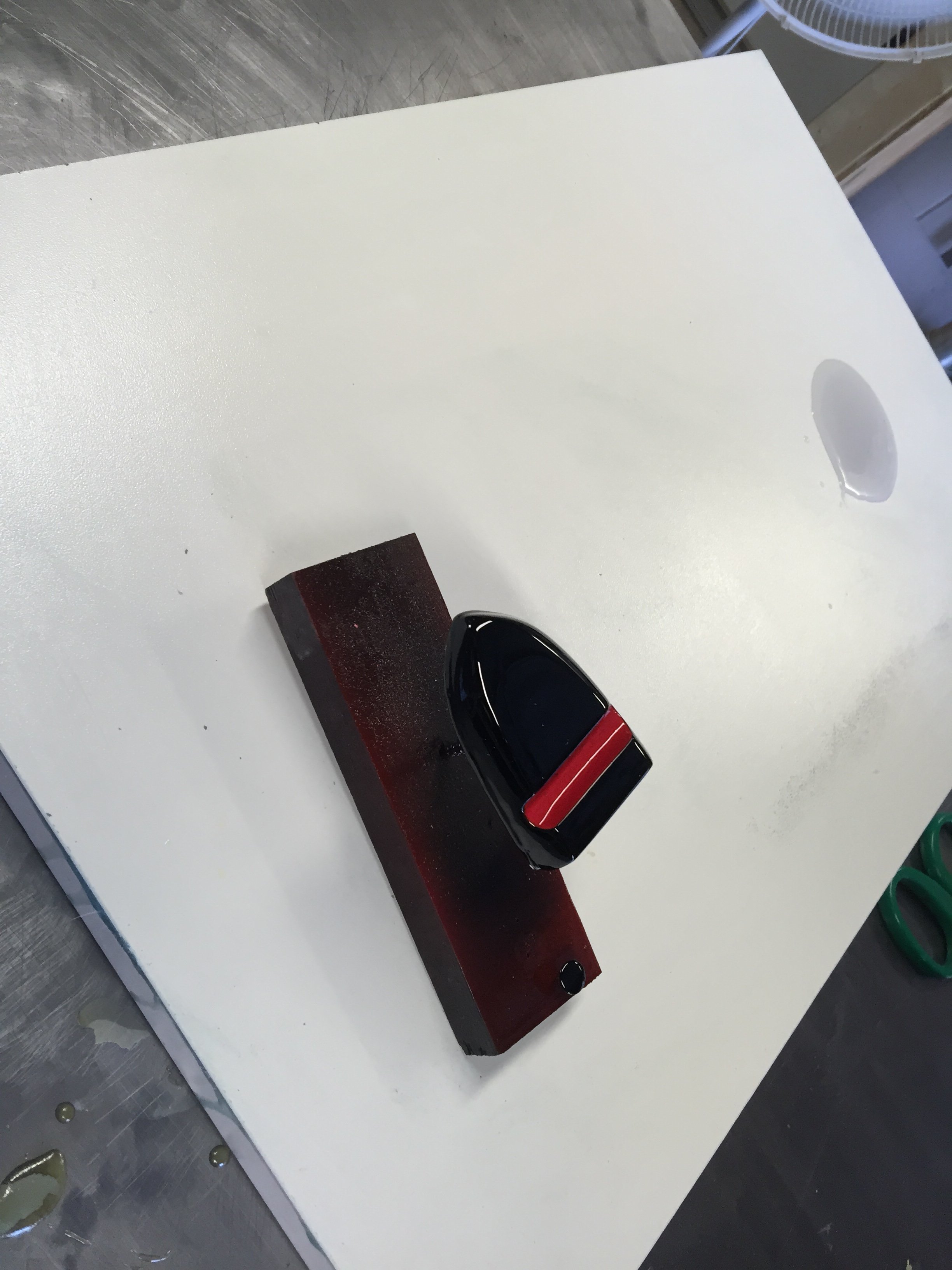

Got the center medallion painted and cleared, I'll wet sand it, paint the red stripe, and re clear coat, to finish it.
SHINY!
...both in the Firelfy and the literal sense. That pain job looks flawless.

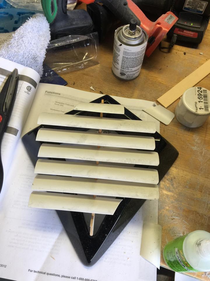

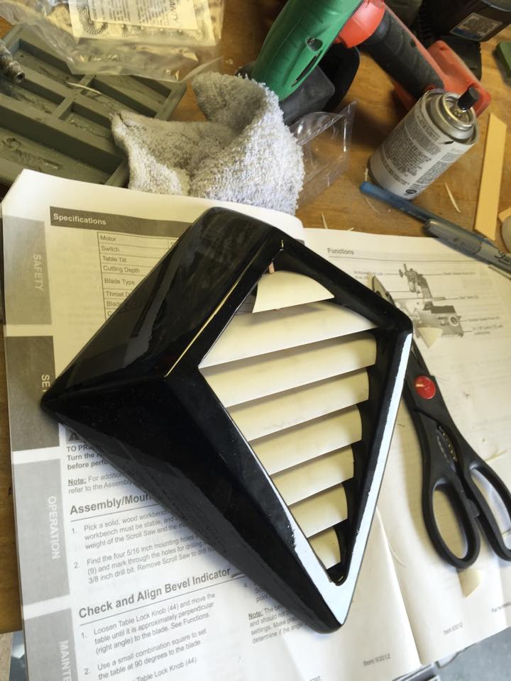

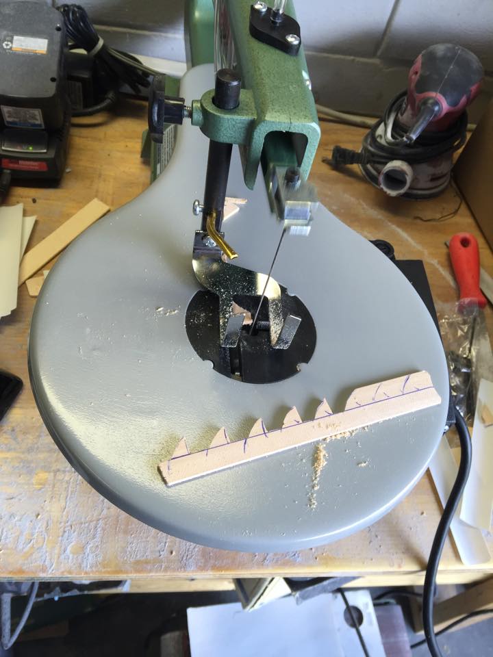

Started by cutting out a support structure for the vents on the scroll saw.
Then I used some old blinds as vents, glued them to the support structure, and then trimmed until it fit inside the housing.

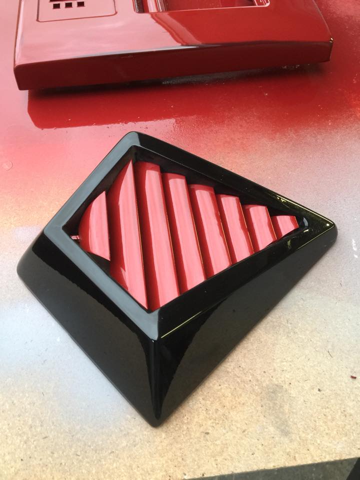

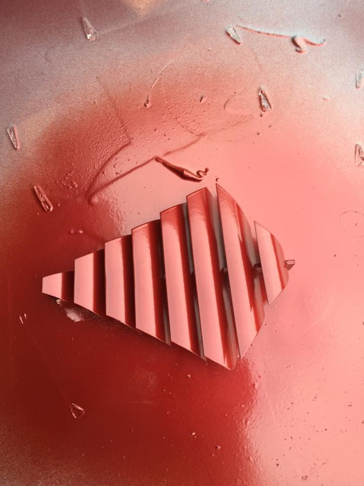

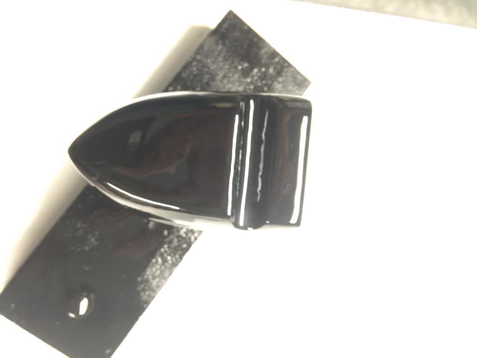

Get the, gun. it's ready for paint!
Let the clear coat dry and re fit into housing
Super happy with how it looks now!

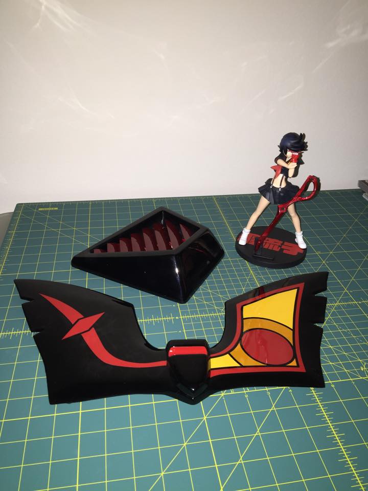

Put it with the rest and snap a photo. I even picked up a cool figure of the character to go with it.
