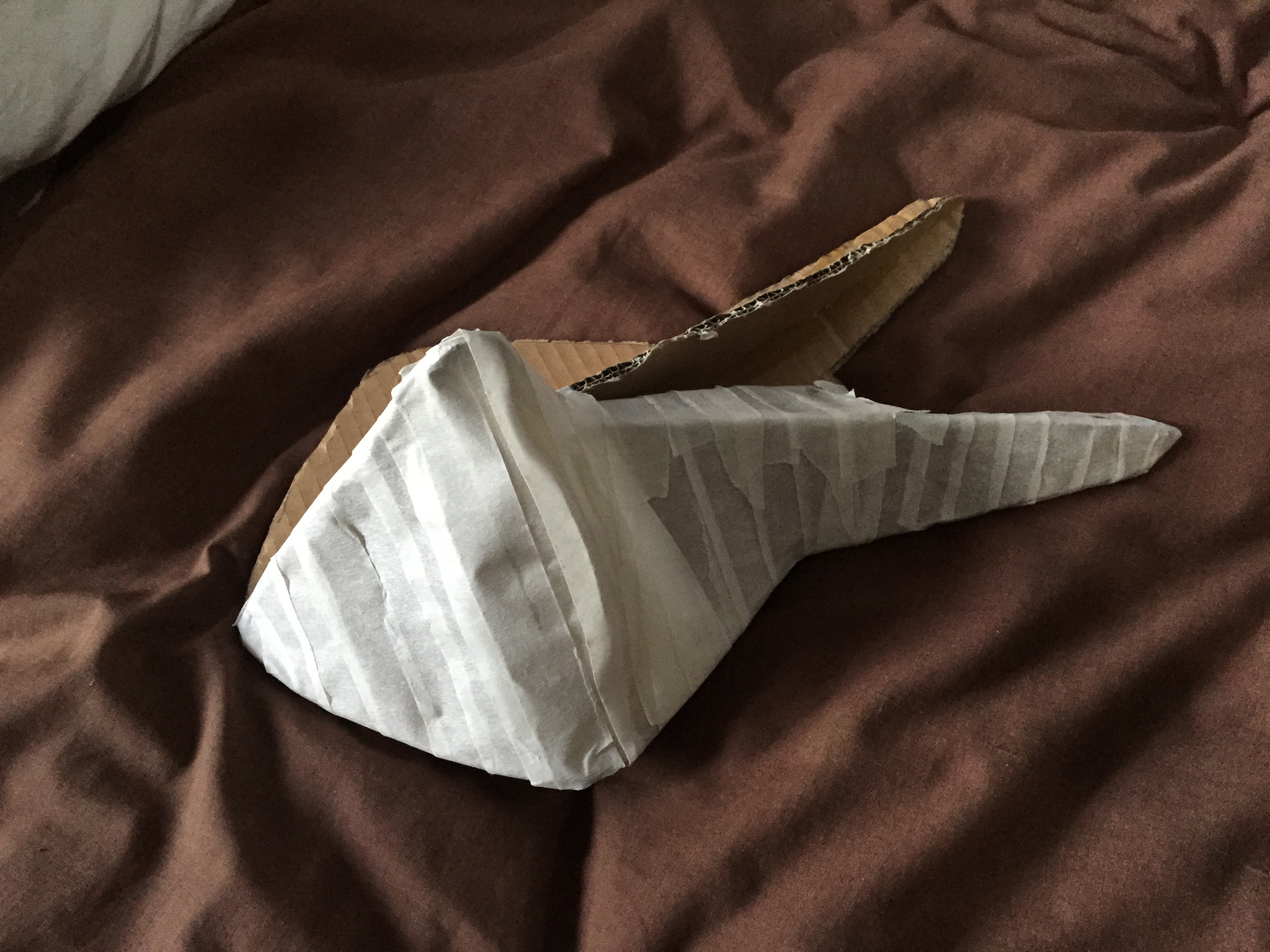

    I scaled up the paper template on my photocopier, and began making a cardboard frame. I'll mask over the frame and make a pattern for foam from that, before fibreglassing over the top of it.

    More work done on this tonight, I put masking tape over the cardboard frame and began to make templates for the foam. Then I scribed lines in sharpie for where I wanted to cut and coloured over parts of the tape in highlighter so I could see where the sections were. I then cut the pieces with a scalpel an scissors before sticking them to cardboard to begin to make my patterns. After that I tried a proof of concept piece with paper. There are a few little things to fix, but next it will be going onto cutting the foam and gluing it.
    If anyone has suggestions for things that could help with accuracy/shape/whatever please feel free to say them. :)
    IMG_2462.jpg IMG_2463.jpg IMG_2464.jpg IMG_2465.jpg IMG_2467.jpg IMG_2468.jpg
