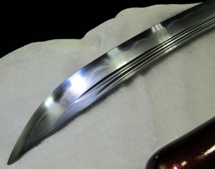

How I want it to look like (I know it's impossible to make it look exactly as this):
Japan-katana-sword-Pattern-steel-Burning-Blade-samurai-sword-katana-handmade-katana-blade-free-s.jpg

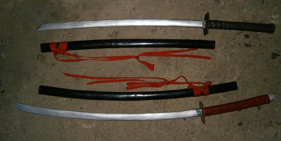

Aaaaand the painting I've found (sorry if these belongs to someone who's reading this. I'm not saying it's ugly)
