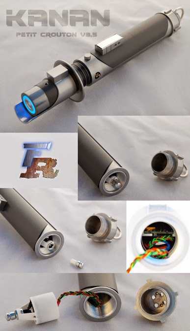

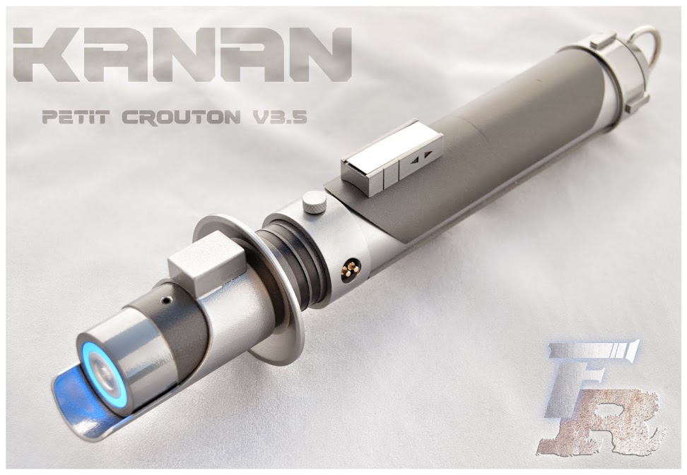

Hi everyone,
We are currently working on a batch of these sabers, and just finished our first fully wired Proof of Concept. I noticed we haven't posted pictures of it yet on these boards.
So here goes:
Specifications :
- Kanan custom saber hilt
- Petit Crouton 3.5 pcb by Plecterlabs
- Tri-Rebel BBW main led
- fully functional switch box with 4 accent led's
- in-hilt rechargeable battery pack : 14500 Li-ion 7,4V 800mAh
- Hidden aux switch
- Micro-SD access through the pommel
- Custom 3D designed chassis parts for electronics
- Custom machined alu inlay blade plug
- Graflex accents
- Full powdercoated hilt
Soundfonts :
- Bank 1 : Kanan by Link
- Bank 2 : Light Meat by Eastern57
- Bank 3 : Grey Meat by Sekrogue
- Bank 4 : Dark Meat by Eastern57
- Bank 5 and 6 : not used
VIDEO:
Pictures:
Jevaho
Thanks guys, we are currently working on a run of 18 sabers. A lot of work, but very rewarding. I loved the saber design the moment I saw it.
Jevaho
The blade holder is threaded so you can screw it apart. But then the main LED module would be loose. We are working on a way to secure the module so this saber can be fieldstripped like the one in the series.
So short answer: yes, but you won't see it in the vid yet.
