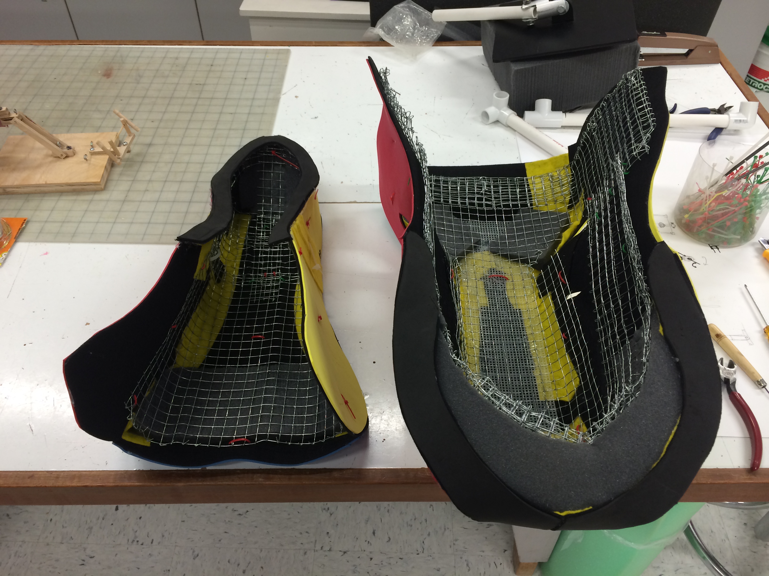

I used a softer yellow felt covered in hot glue to bind the left (red), right (yellow), lips (black) and top/bottom (blue +green) together.
The wire mesh provided a stiff reinforcement, held in place by zip ties and hot glue.
The foam-wedge lip was to provide 'bump' padding in case of a rapidly-incoming child, to reduce any hurt.
