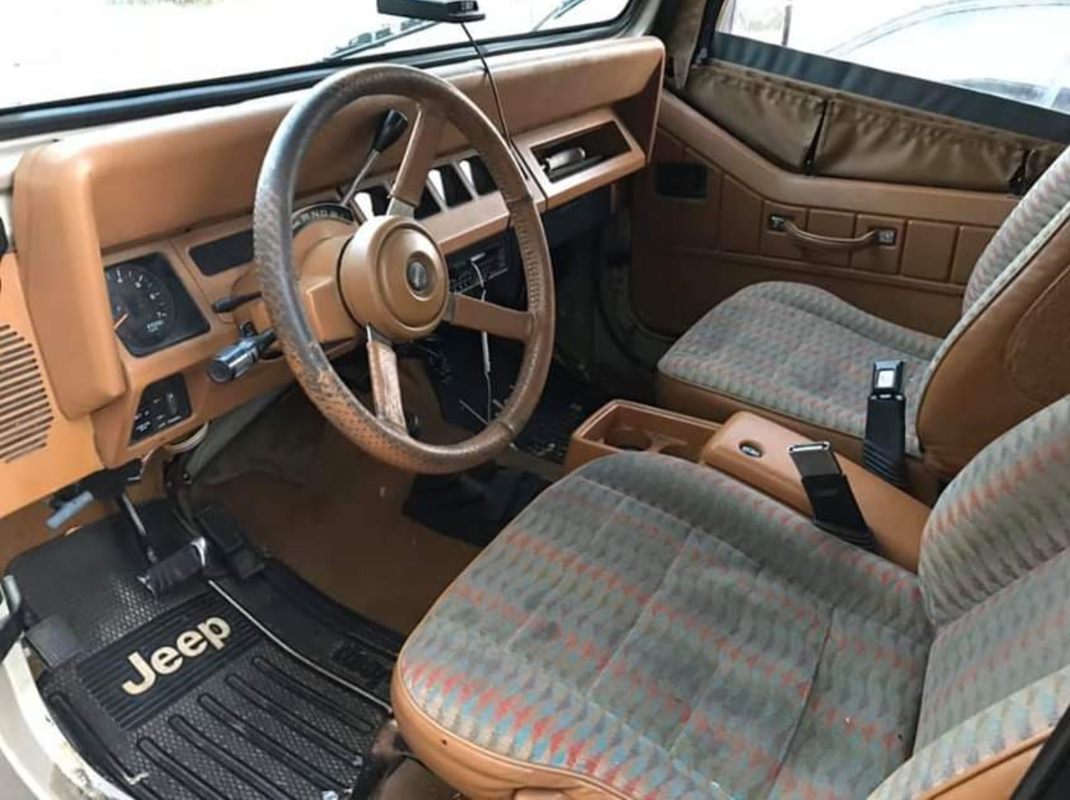

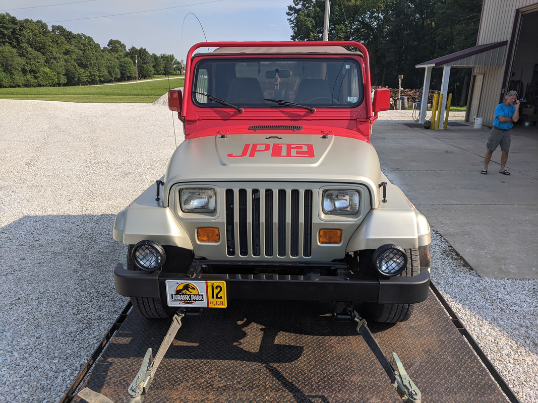

As if I didn't have enough projects, the stars finally aligned and I was able to start on one of my dream vehicles. My uncle sent me a link to a 1995 Jeep YJ that looked to be in good condition and just a few miles from my grandmother's house. A few days later he was able to inspect it and pick it up for me. It's in really good shape for a 25-year-old vehicle. I had a few dents pulled out of the hood and picked up a set of side steps and other accessories to drop on after getting it painted over Fourth of July weekend.
Three crazy days later I loaded it on a trailer and towed it home.
Once I got it home I put it up on blocks in my driveway while the rims were powder coated. I've used the opportunity to change the oil, flush the cooling system and repaint the dash to gray using a vinyl dye. Still need to touch up the mirrors as we got a little excited and painted the arms red, too.

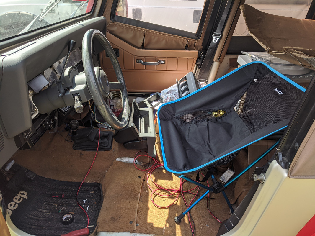

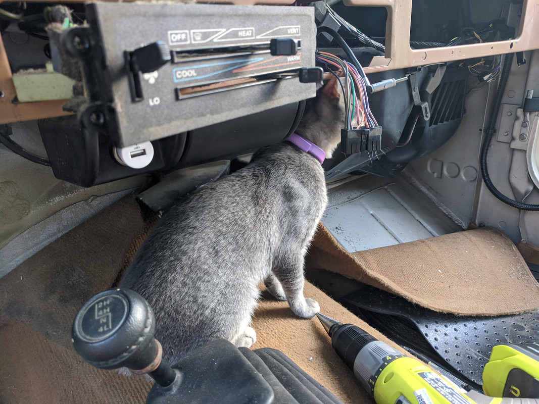

One of my cats decided to inspect the wiring (and the 25 years of filth under the dash).

I'm in the process of installing an air conditioner and a bunch of wiring for new speakers, a Bluetooth amp that allows me to retain the factory AM/FM radio, power distribution block and fog light controllers. Found out the wiper controller in the column was broken, that was a pain to replace. Once all that's done I'll install the green carpet. My original plan was to have the seats reupholstered but I stumbled across some original Sahara seats that will work nicely for this build. Once I have the Jeep mobile again I need to swing by an exhaust shop and get the muffler under control (sounds like a jackhammer) then on to a friend's house to get the rear drum brakes swapped out for disc brakes.

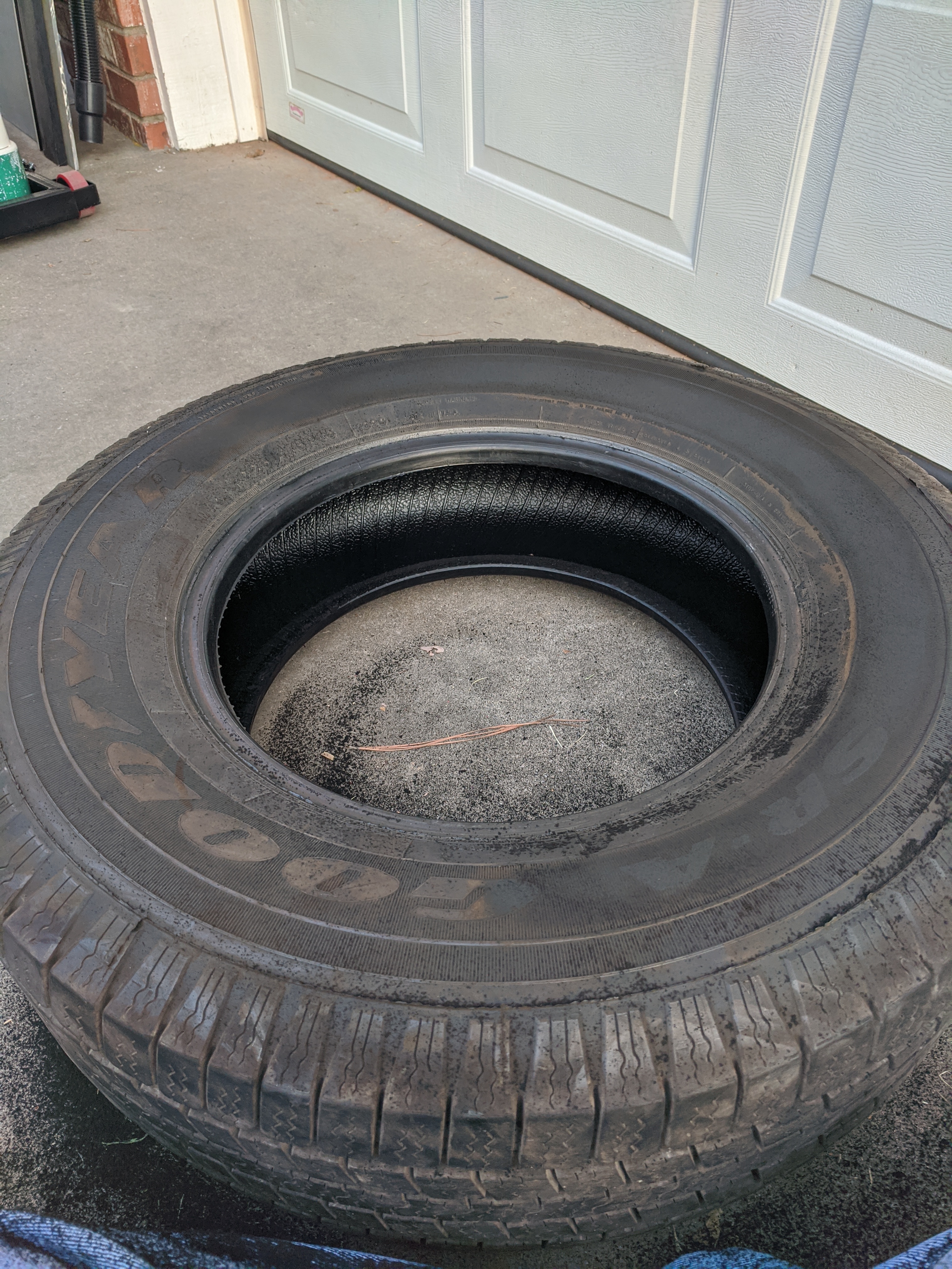

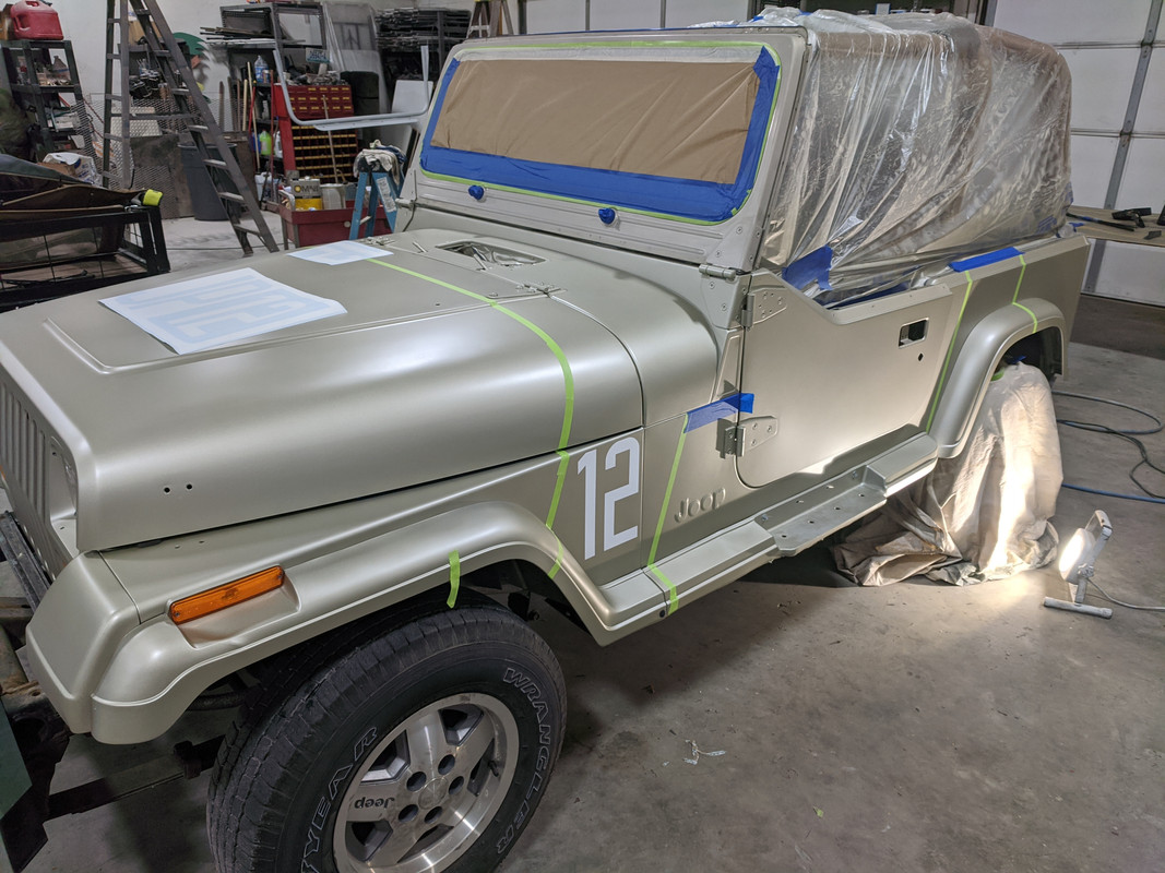

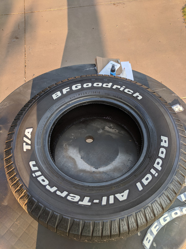

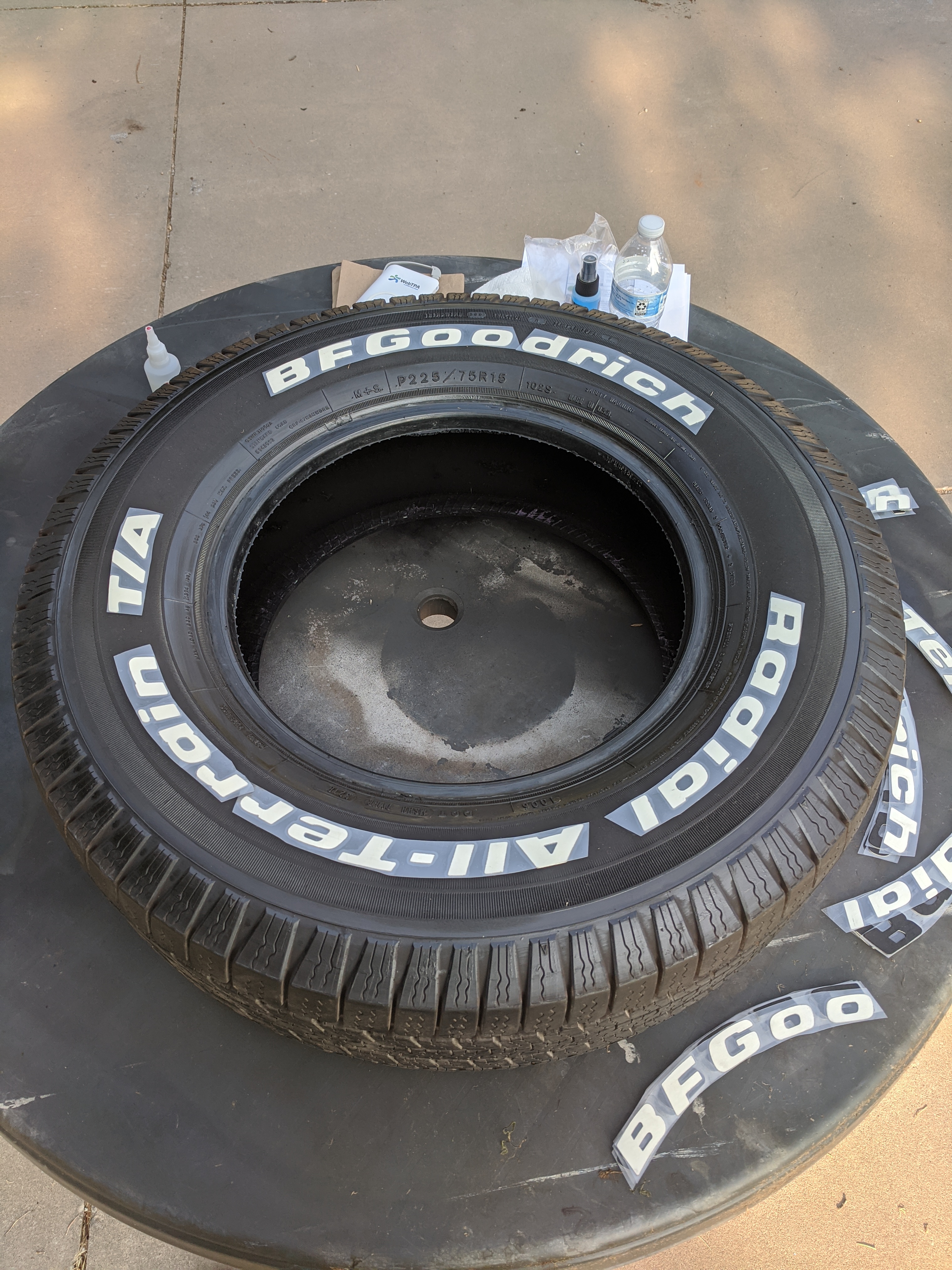

I ordered a "tire sticker kit" to put the correct lettering on the tires since the Goodyear Wranglers were still in great shape. Looks good but they're a pain to install.

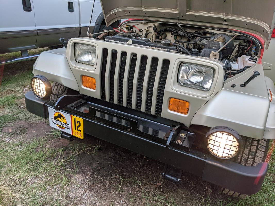

We had storms producing large hail the other night. Knowing they were coming, I slapped on the few remaining parts to get it drive-able to move to my barn.
Installed the air conditioning compressor, new serpentine belt, new coolant reservoir and the remaining tire. Also got the steering column put back together. Went to re-assemble a seat only to find out the sliding rails had been damaged during the power coating process. Doh! So, with no way to mount a seat, I had to get creative.
This was also a really bad time to find out the brakes quit working. Had to pump them like crazy to keep from running in to my mother's Excursion. Found one of the hard lines broke, probably when I was replacing the coolant reservoir. I'm leaning towards replacing all of them along with the brake hoses so I'll be 100-percent certain everything's in good shape.

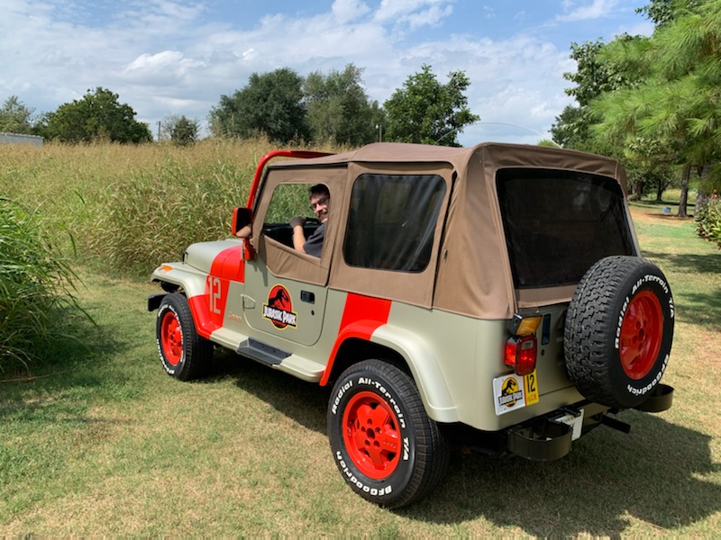

Took the opportunity to snap a few photos since it was mobile again.

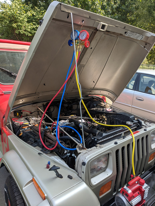

Thanks, everyone! This has been quite the undertaking and I'm using the opportunity to learn a lot more about automotive repairs. My A/C gauge set and vacuum pump showed up on Saturday and I had to order a new engine thermostat since the old one got stuck. I tore out the old carpet, did some scrubbing on the tub and put the new carpet in.

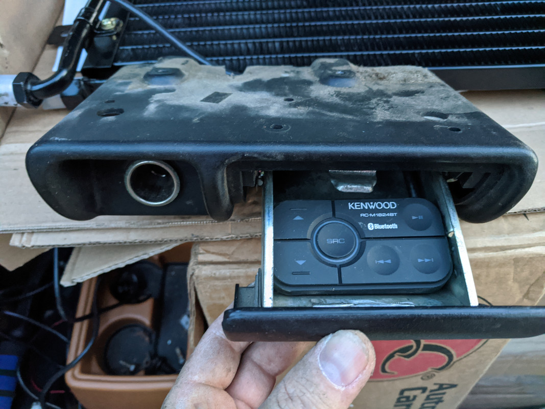

I relocated the 12v outlet and ashtray (due to A/C install) and modified the ashtray to hide the controller for the new amplifier. Probably should cut some foam or something to fill the little gaps on the top and bottom of the controller. Also finished splicing in the lines for the new audio amp, wired up the fog light switches and started work on the new power distribution block for the fog and searchlights. Once that's done I'll get the wiring bundled up and tucked away.

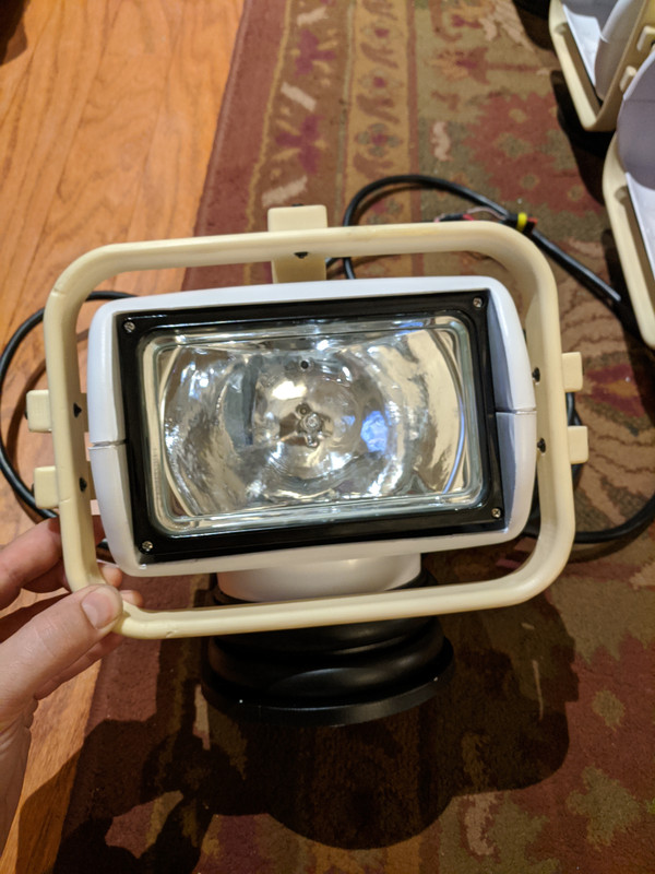

Two-thirds of the dash has been re-assembled and I'll be able to finish off the glove box area once I figure out a solution to the searchlight controllers. The ones included with the lights are nowhere near accurate and the ones that I purchased that were "close enough" don't want to work. Will have to do some further investigating with the multimeter to figure out what's not playing nice.

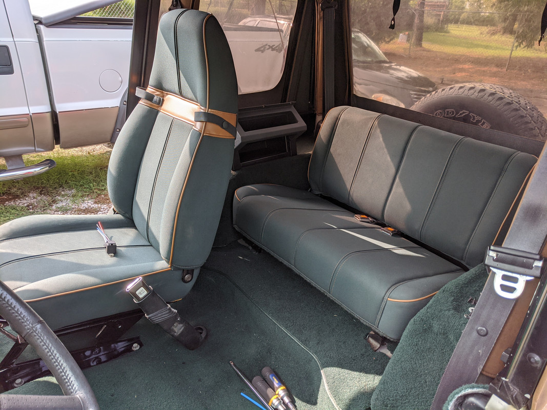

Two of the seats have been mounted. I'll get the driver's seat put in once I'm done with the center console. These seats are in incredible shape! Mounted them on the risers that I had powder coated and they look like they just rolled out of the factory.

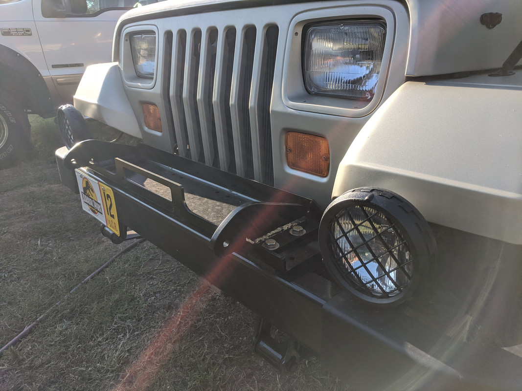

The rings for the searchlights should be here shortly and I'll be able to get those painted and mounted on the light bar. I'm hoping my replacement brake lines will be here this week, that's the last piece that's preventing it from being roadworthy. I get those on, then it's off to the muffler shop for some exhaust work and then a few final mechanical pieces at my friend's house.

Juiced up the AC over the weekend and now I have ice cold air. Still have some tidying to do on the cabling for it. While roaming beneath the vehicle I found some split loom that had been melted (looks like somebody had zip-tied it to the exhaust or something) that contained what appeared to be a few melted vacuum lines. I think these might be a part of the 4WD system but I'll have to do some more tracing to be certain. Shouldn't be too much of a problem to repair them.

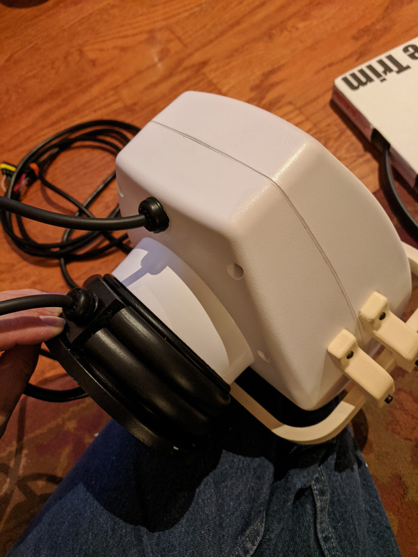

For whatever reason, there's a fake wire that runs between the light housing and the base. Some of the other builders suggested using valve stems and windshield wiper fluid tubing to create it, so that's what I did.
Just a little more sanding and cleaning to go, then I can paint and epoxy everything into place.

Install the seats two of the three installed

I'm finally able to get back to work. This stupid Covid garbage really knocked me flat. I got the driver's seat mounted and poked the floor mats in. I really love how the powder-coated seat risers turned out.

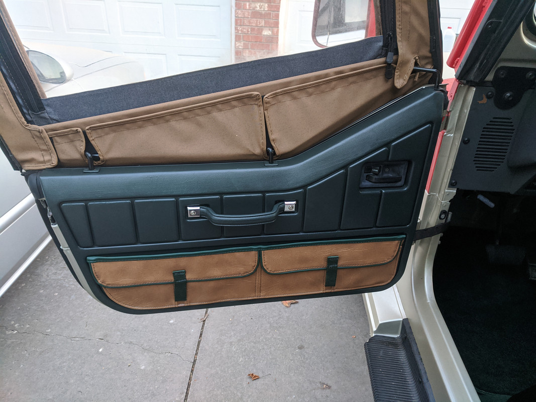

I painted the door panels and installed the pouches. The center console didn't turn out how I wanted so there will be a bit more work on that before it goes back in.
Finally figured out what was up with the searchlight controls - one of the joysticks was bad. Got a new one ordered and wired it all up. Still need to come up with a blank plate for the dash (I used the plate off the one with the failed joystick temporarily) and will make the final electrical connections once the searchlights are mounted to the light bar.

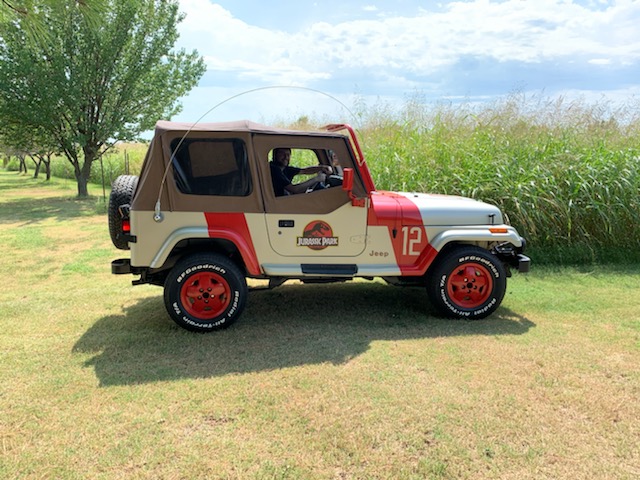

With it mobile again, I took it out to gas up and give it a good washing. It turned quite a few heads! I can't wait to get the searchlights back from painting and get the winch in.

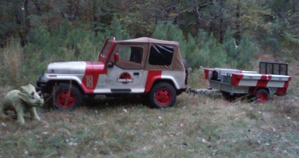

Really looking GREAT and I know how much work it has been firsthand! I built my #18 from a 95 too, which I have heard were the best YJs made from a mechanical perspective. #12 is the biggest challenge, but by far the most impressive when finished. Hopefully we will have another Jurassic Jeep Meet up in Branson MO. again when the next Jurassic World movie premiers. I think we had 45 jeeps from around the country the last time. It was a blast meeting jeep builders from around the country, and shouldn't be too far of a drive for you. Hopefully we'll see you and your jeep, and a few more that have been built since the last meet. Here's mine, with the "half scale" Jurassic Park gateway I built, and a drone's eye view of the Jurassic Jeep and Explorer meet we had in Branson. Are you a member of the Jurassic Park Motorpool on Facebook?

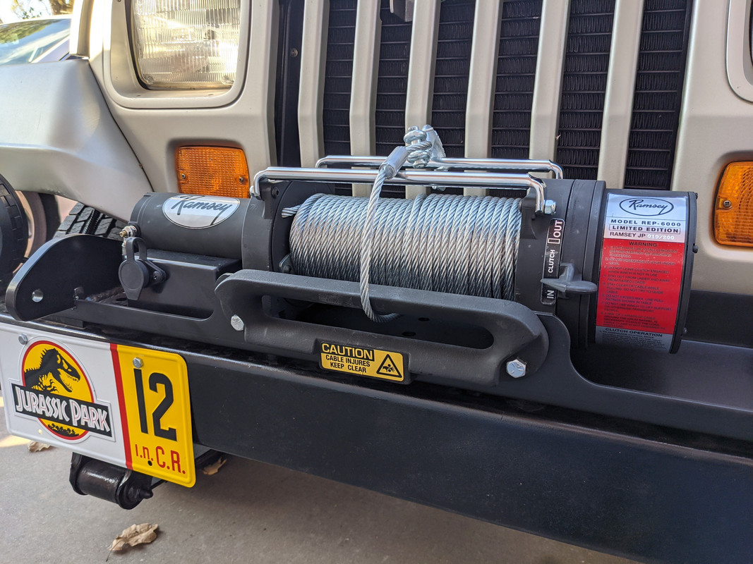

All the brake lines have been replaced and the disk brake kit is now installed. Picked up the winch on Friday and finished installing it today. Swapped out the winch plate with a different one to fix some alignment issues and all is good. Ramsey Winch did a special "JP" edition run of their original REP6000 that was featured in the movie. I'm super pleased with it. Hopefully the searchlights will be completed soon and I can get those mounted.

It's my first time seeing this thread, could you tell me more about these "Tire Stickers" I have the new BF Goodrich tires with the wrong lettering on mine. Would love to change that...
dstone
Looks awesome! I have one of those winches on the way as well :D
I ordered the kit from No-Limit Customs (https://no-limitcustoms.com/shop/ols/products/jeep-tire-lettering) and an additional bottle of glue and some of their custom tire shine from tirestickers.com. I used a dual action sander with 80 grit paper to knock down the lettering on the blackwall side then wiped it off numerous times with acetone. The letters arrive stuck to a plastic piece that helps with spacing - I cut them apart into chunks of three letters to help with gluing. Found out the hard way on the first tire that if you try to glue it all at once the edges will curl up and, once dry, they're impossible to get back down.
