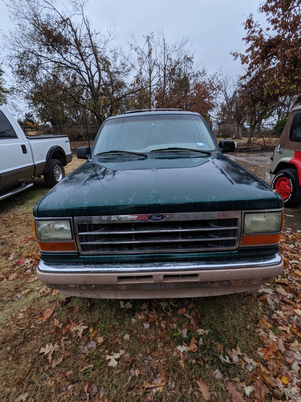

I thought I'd wrap things up with just the Jeep but now I've got the bug. A late night session of Facebook Marketplace led me to a solid base vehicle for an Explorer build. It's a 1992 Eddie Bauer 2WD with a tan interior that's in halfway decent shape considering its age. I'll have some rust to repair or replace on each side near the rear wheels and several dents and dings to try to fix. The rear windows all have the privacy tint on them and the back glass seals look to be rotting a bit. Engine and transmission are in good shape and it recently had the cooling system reworked (an aftermarket thermostat gauge was added since the original stopped functioning, I'll be replacing all the gauges with digital when replacing the dash).
A few weeks later, my father lets me know he found a 1991 for parts. The engine works in that one but the transmission only operates in reverse. It has the AS2 glass in the rear door windows and AS3 regular glass in the back glass and hatch glass so I'll transplant those to the 92. It also has manual seats. And it's red. So. Much. Red.
I'll probably wind up swapping an entire door or two so I won't have to hammer out some of the larger dings. I've started gathering a few of the smaller parts like the antennas, license plate and frame, roof box lights and Pelican case. Decals and bubble dome have been ordered and hopefully I'll be able to get in on a run of accurate brush guards. I think the next steps will be to start dismantling the interior so I can see if the carpets can be cleaned or need to be replaced.
My intentions are to go as screen accurate as my budget will allow (with the exception of the receiver hitch, I'll be leaving that on there). Now the hunt is on for some of the oddball items like cameras and such. I'll need to do some research on structural modifications when I cut the hole in the roof and hopefully I'll be ready to paint by the middle of next year.

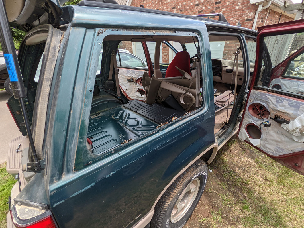

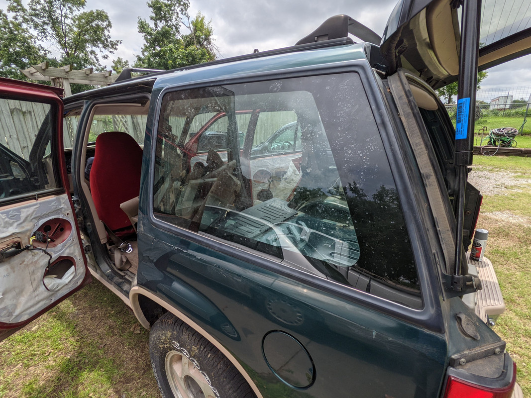

Did some more cleaning on the 92 Explorer and started stripping down the 91 to get ready to swap doors. I also pulled the seats out of the 91 and discovered that the floor pan profile changed between the 91 and 92 and I'll need a different slide track. I've found some aftermarket replacements but those guys want $124 per seat for the rails. My local scrapyard has three pre-95 Explorers on the lot right now and, if I'm not mistaken, I should be able to use the slide rails all the way up to an 01, which gives me 23 vehicles to pick from. Hopefully I'll be able to find some AS2 glass in that mix and maybe pick up some new side mirrors in better shape than mine while I'm there.

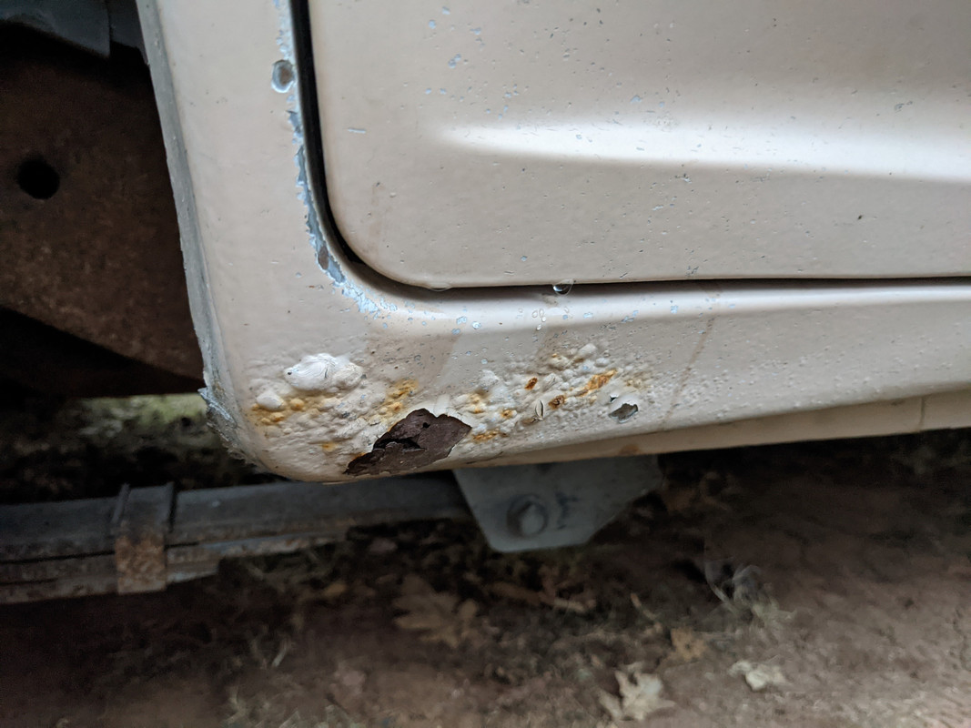

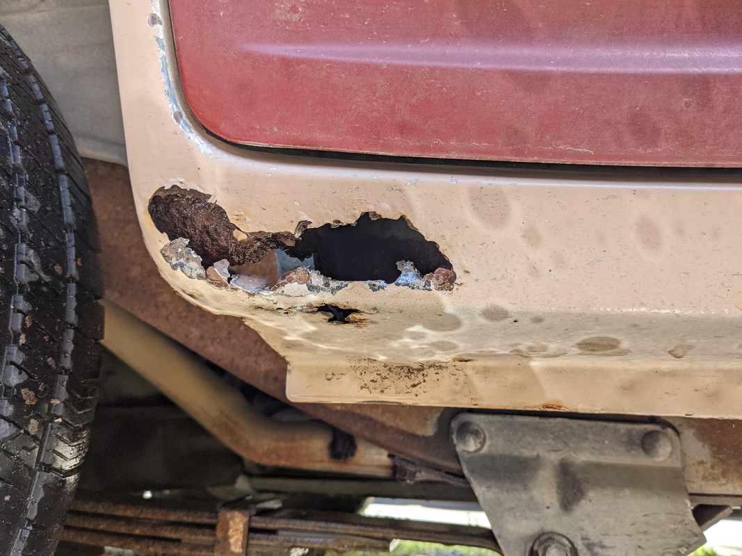

While stripping down some of the 92 interior I noticed water in the cupholder. Found a small drip coming from the headliner. Tracked it back to this lovely rust spot. Probably going to do a temporary patch on it until I get to the painting phase, at which point I'll pull the windshield, correct whatever lies beneath and have a new windshield put in.

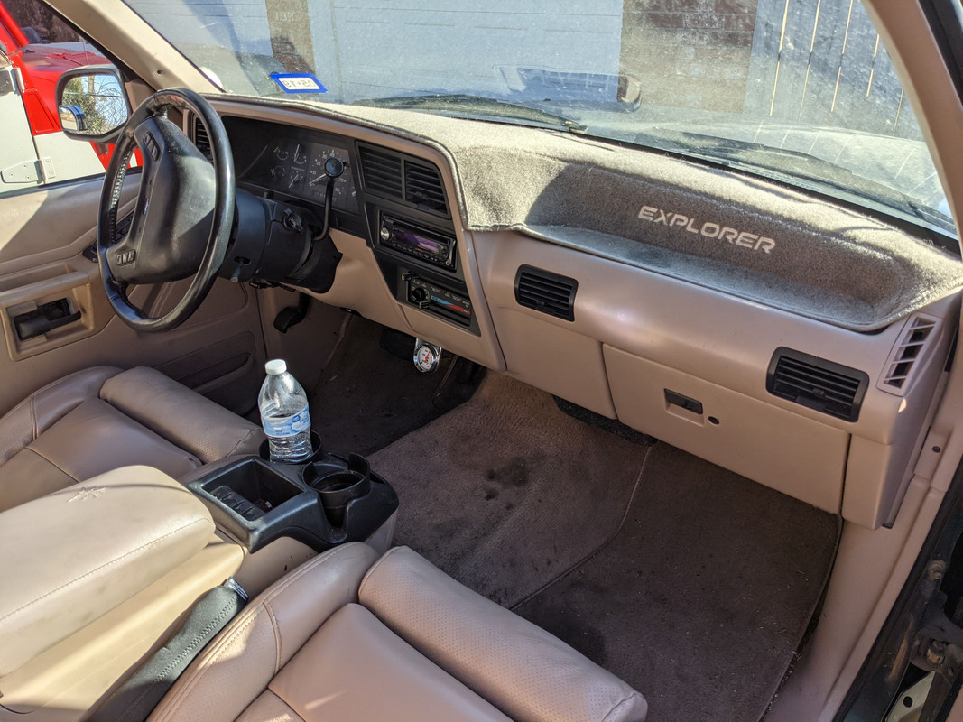

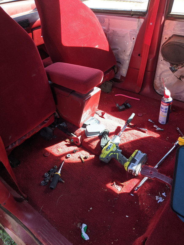

I pulled all the seats out of the 91 and started prepping them to go in the 92. Discovered that the floor pan changed a bit between the 91 and 92 resulting in different seat tracks. The 91 seat tracks are two separate pieces with some springs connected between them. The 92-01 seat tracks are all one piece. A quick trip to the junkyard yielded a nice pair of seat tracks from a 96, rear quarter AS2 glass from a 99 and a factory premium sound subwoofer plastic faceplate from a 93. It's slow going pulling the aftermarket tint off the quarter glass and one of the windows has pitted rubber but it should work well for the time being until I come across something in slightly better shape.
Snapped this for a quick comparison of the back seats. The red cloth is from the 91 XLT and the tan leather is from the 92 Eddie Bauer. The seat foam and mounting brackets are all identical. Just the front seat mounts changed.

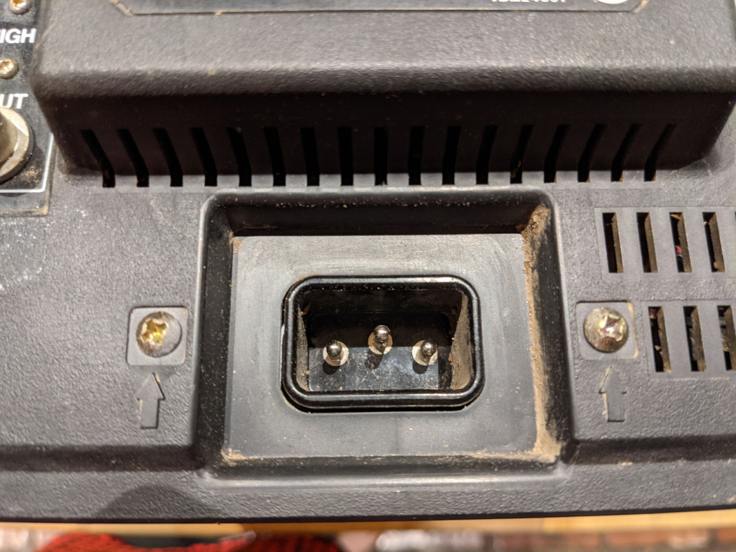

The 7" Panasonic monitor showed up and looks pretty good. Just need to rip out the weird power connector and replace it with a standard one. Or just wire it directly to a cord - that would probably be more reliable since it's going in a vehicle.

Speaking of doors, got two of them replaced today and the wiring pulled out of the other two before I managed to hurt my back and have to quit for the day. Much easier than trying to hammer out all the dents, plus the back doors had the AS2 glass in them.

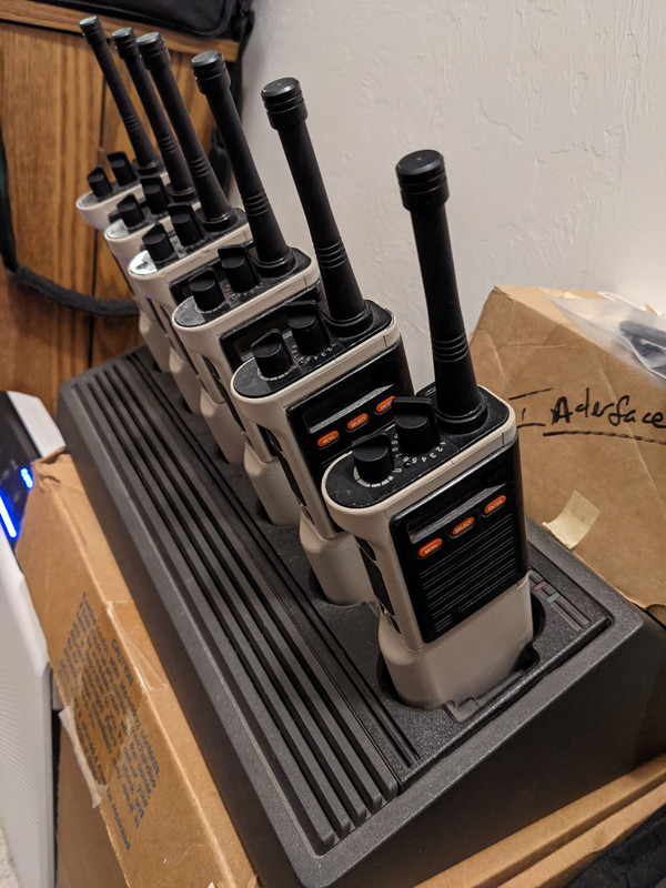

I've also taken the opportunity to fiddle with some more of the props for the vehicle fleet. Got all my radios painted up and programmed.

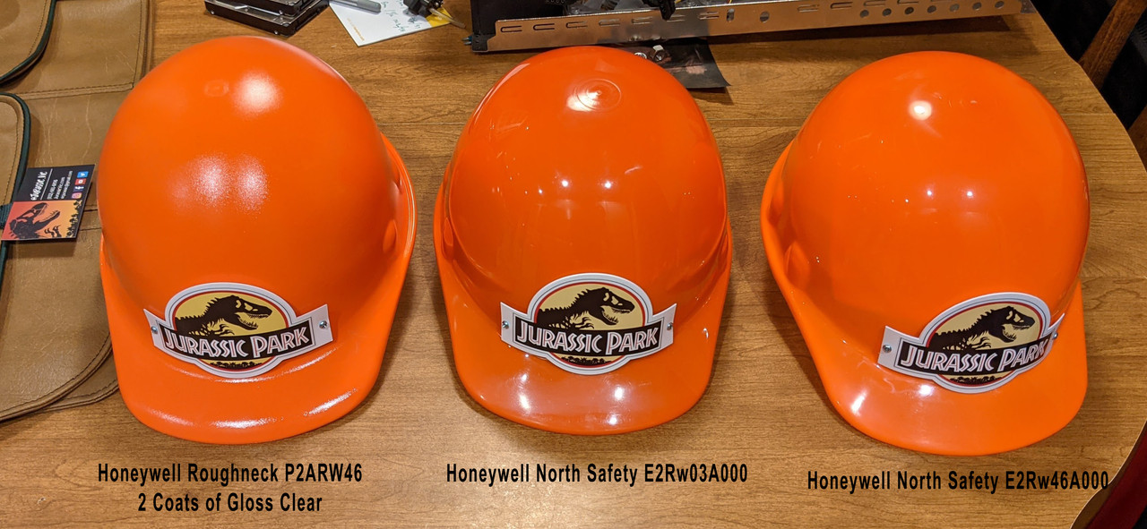

I've noticed that the recommended hard hat on the JPMP page has changed styles and is only available in a matte finish now. Looks pretty slick, but definitely not the same sheen that was on screen.
I sprayed a few coats of gloss clear on it but then went ahead and picked up a few other styles to tinker with. I ordered two alternatives to compare to the Roughneck and the images I've been able to find online of one of the screen used hard hats. The Honeywell North Safety E2Rw46A000 and E2Rw03A000 have a near-identical appearance to the Roughneck P2ARW46A000 (minus the drip edge around the rim of the hat). Ratcheting headband mechanism appears to be the same. The two North Safety hats both come in a gloss finish. I think the regular orange E2Rw03A000 looks to be a bit closer in color to the screen used hat versus the Strong Orange.

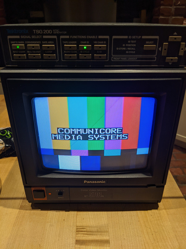

The Panasonic BT-S702 I bought is eating fuses. Still stepping through the power supply to try to figure out what's going on. I ordered a replica faceplate when I purchased the dash and center console; I think I'll transplant the faceplate over to one of my JVC or Sony monitors and use that as a backup if I can't get the Panasonic running again.

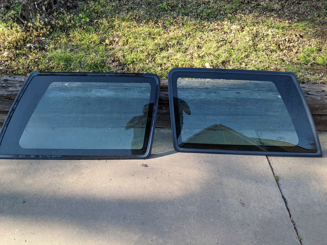

I scraped off the bad sealant and dropped in the AS2 glass. I'll be pulling them back out when I'm ready to paint. Hopefully I'll have a different passenger side glass by then as the rubber is quite pitted.

Picked up a functioning Panasonic BT-S701N, so the non-functioning 702N gets banished to the spare parts pile.
