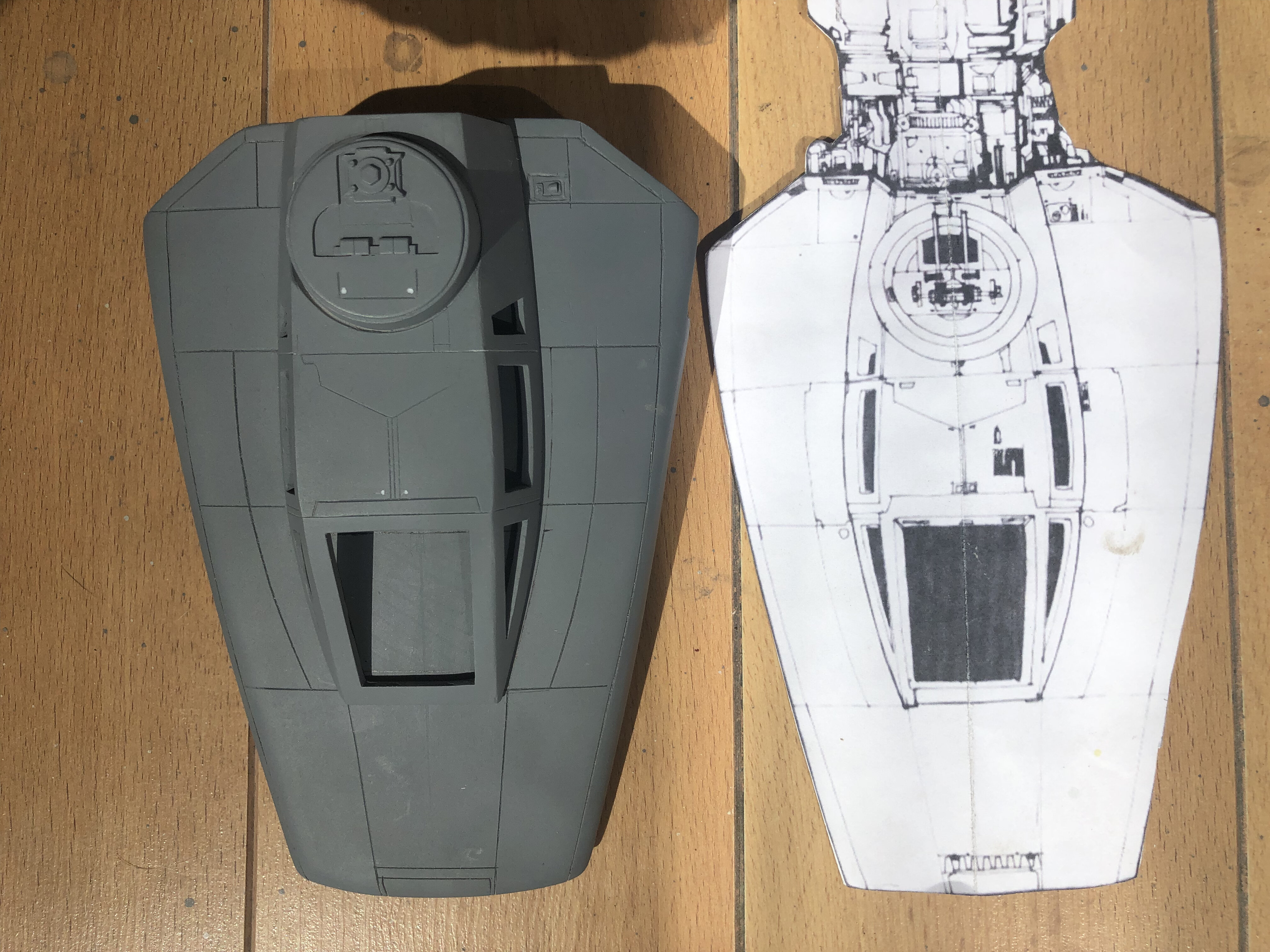

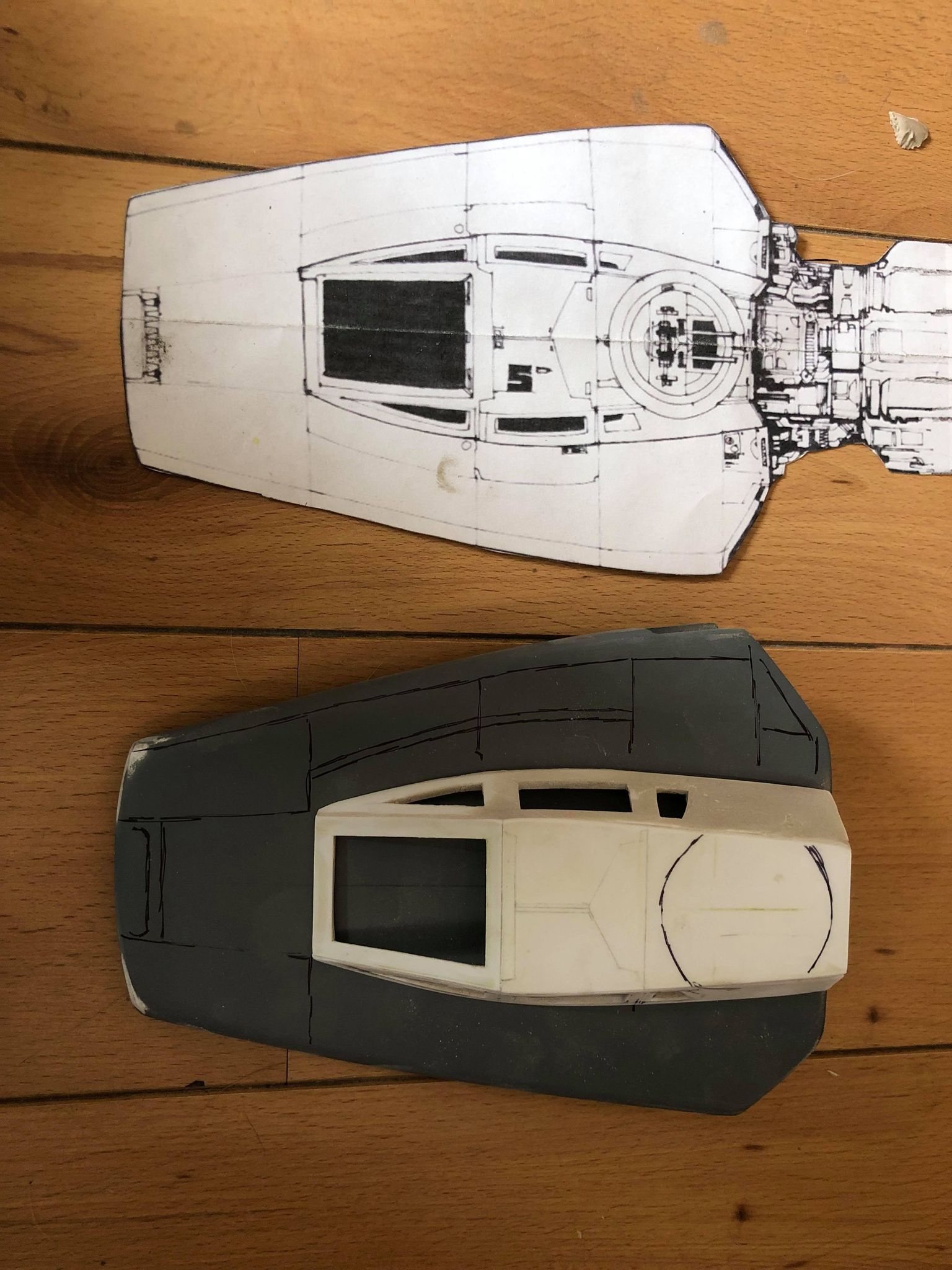

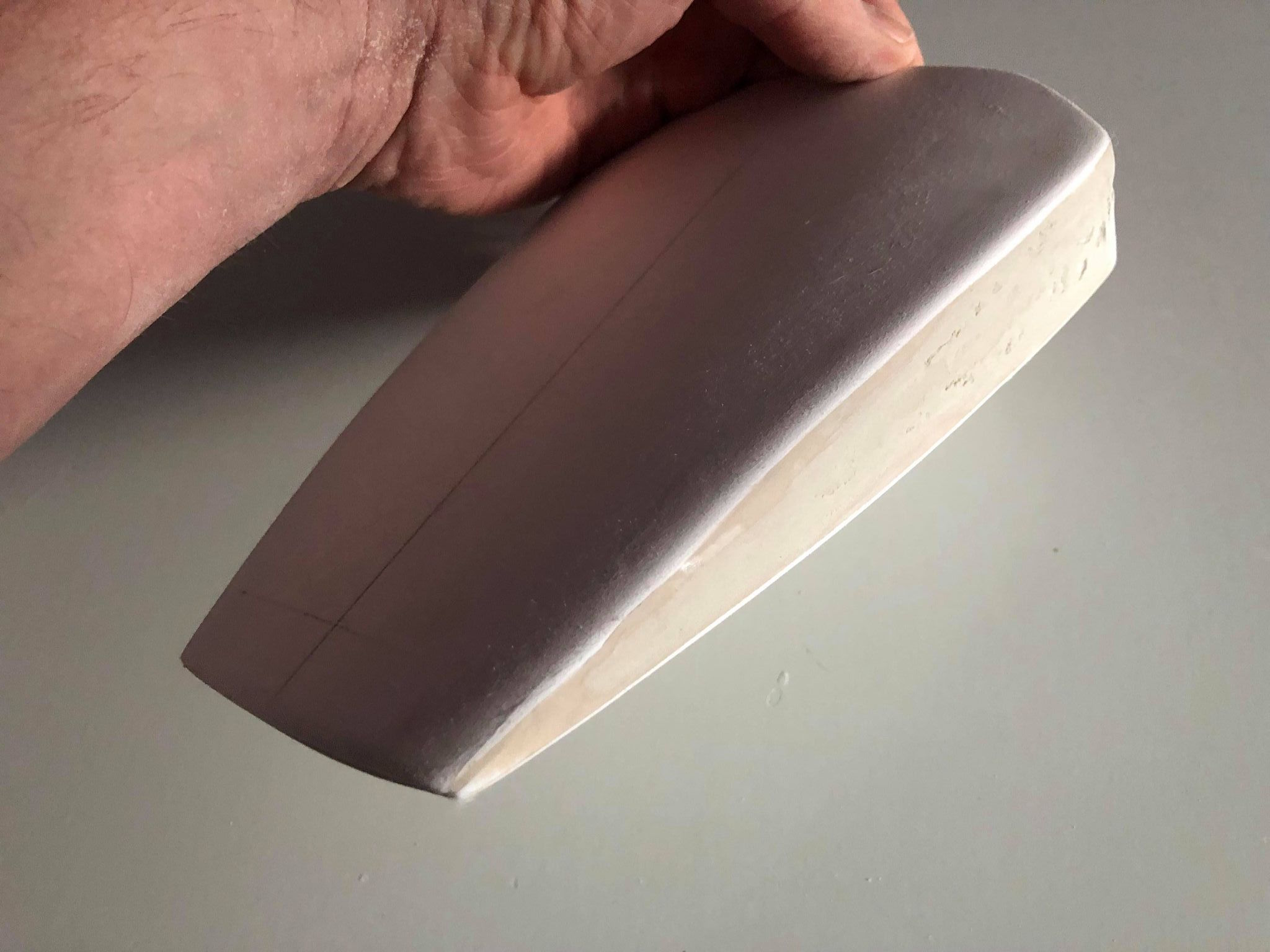

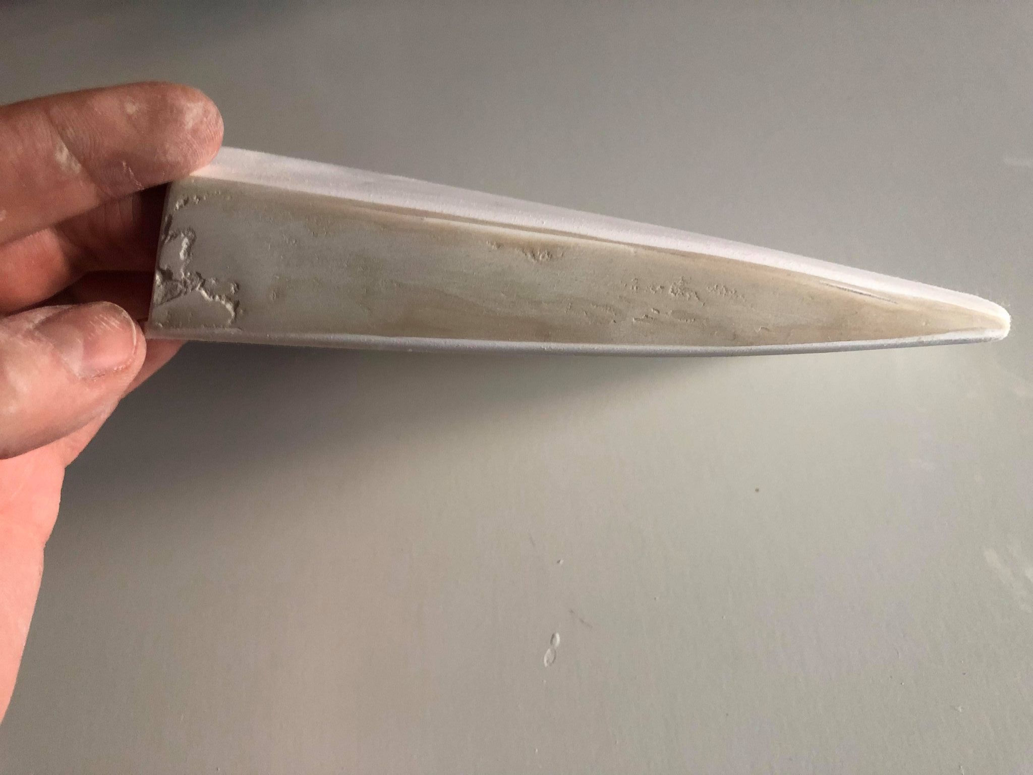

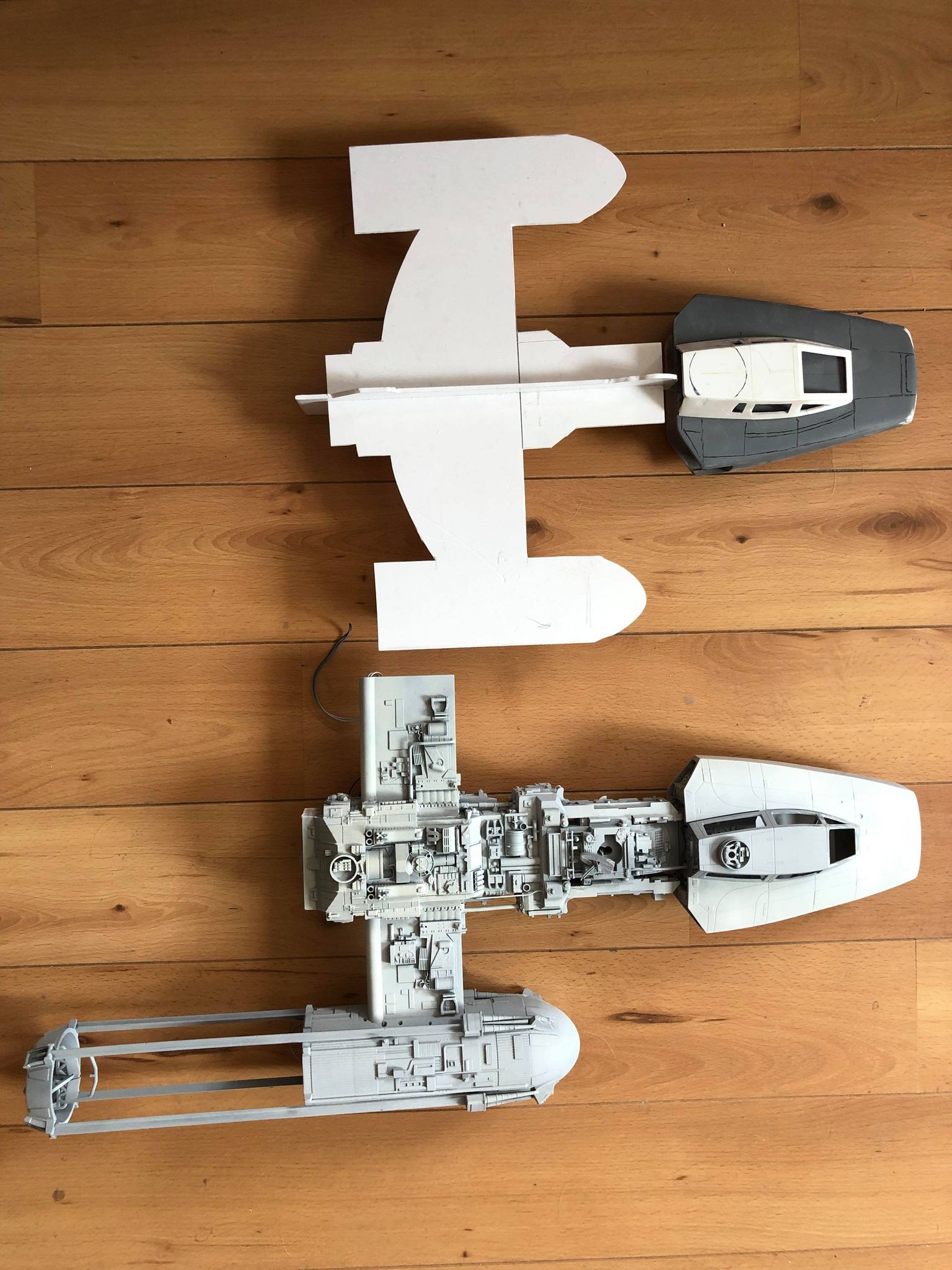

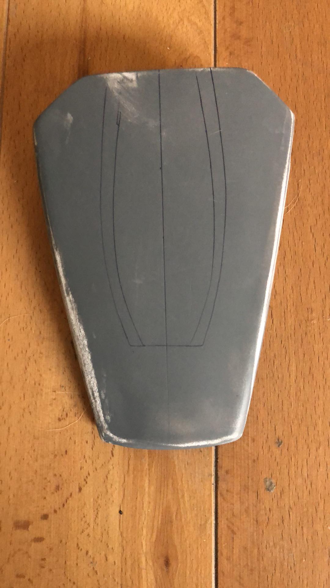

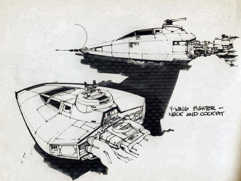

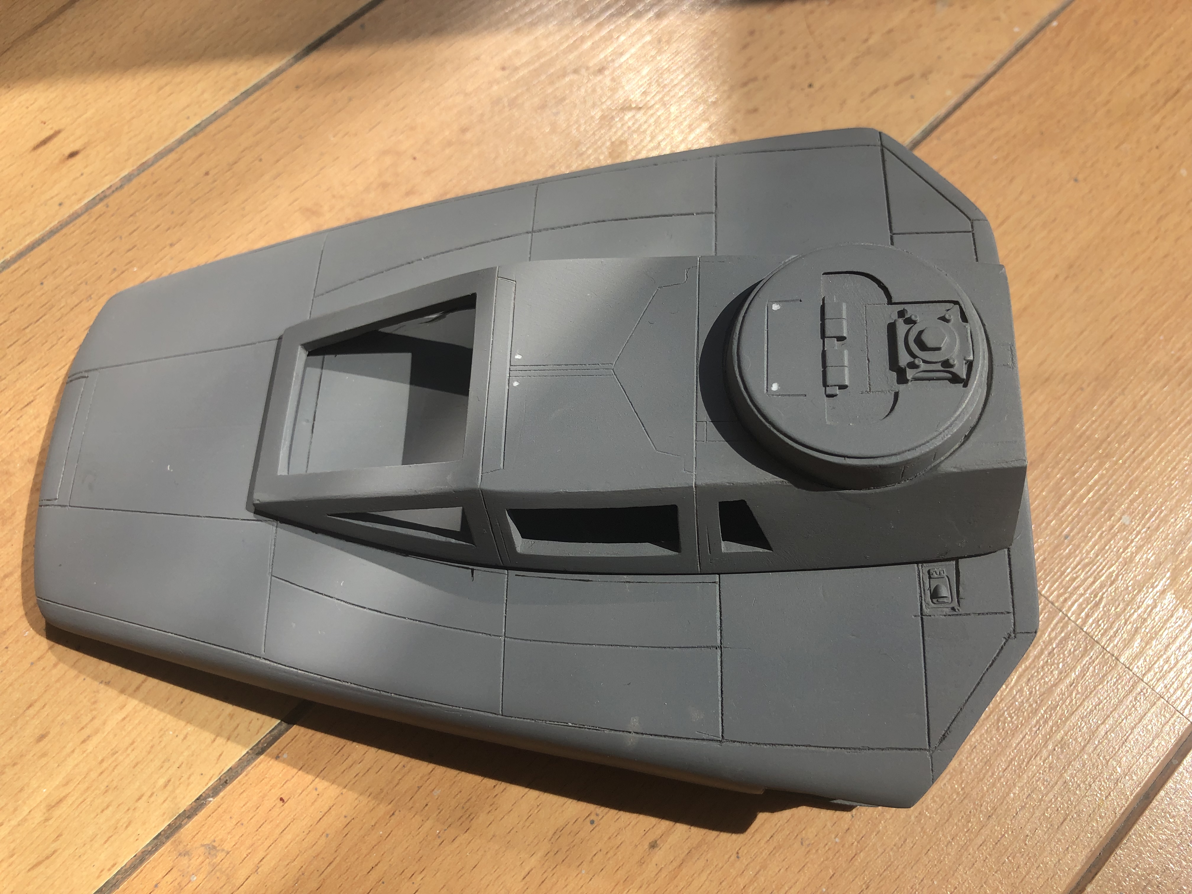

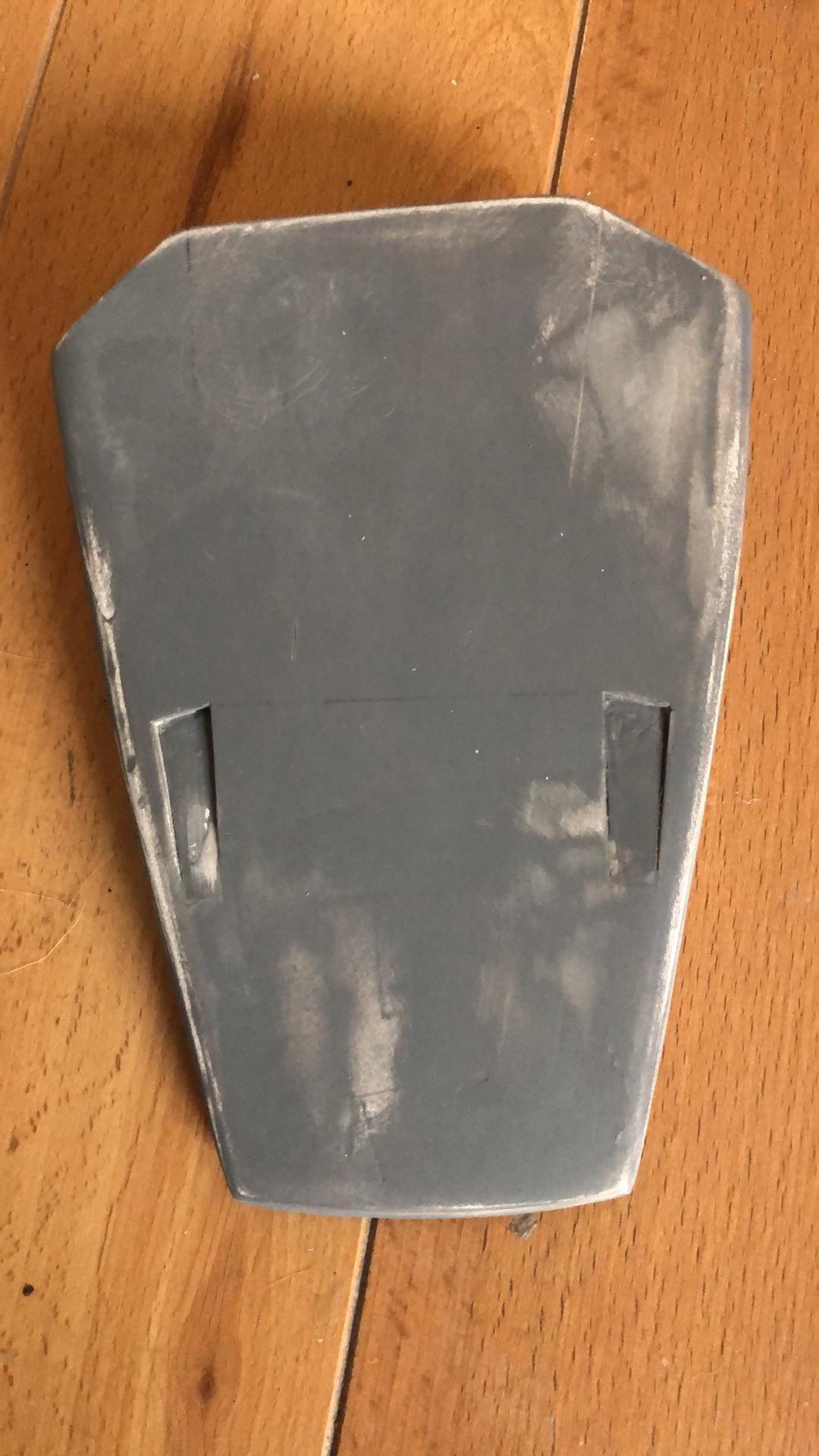

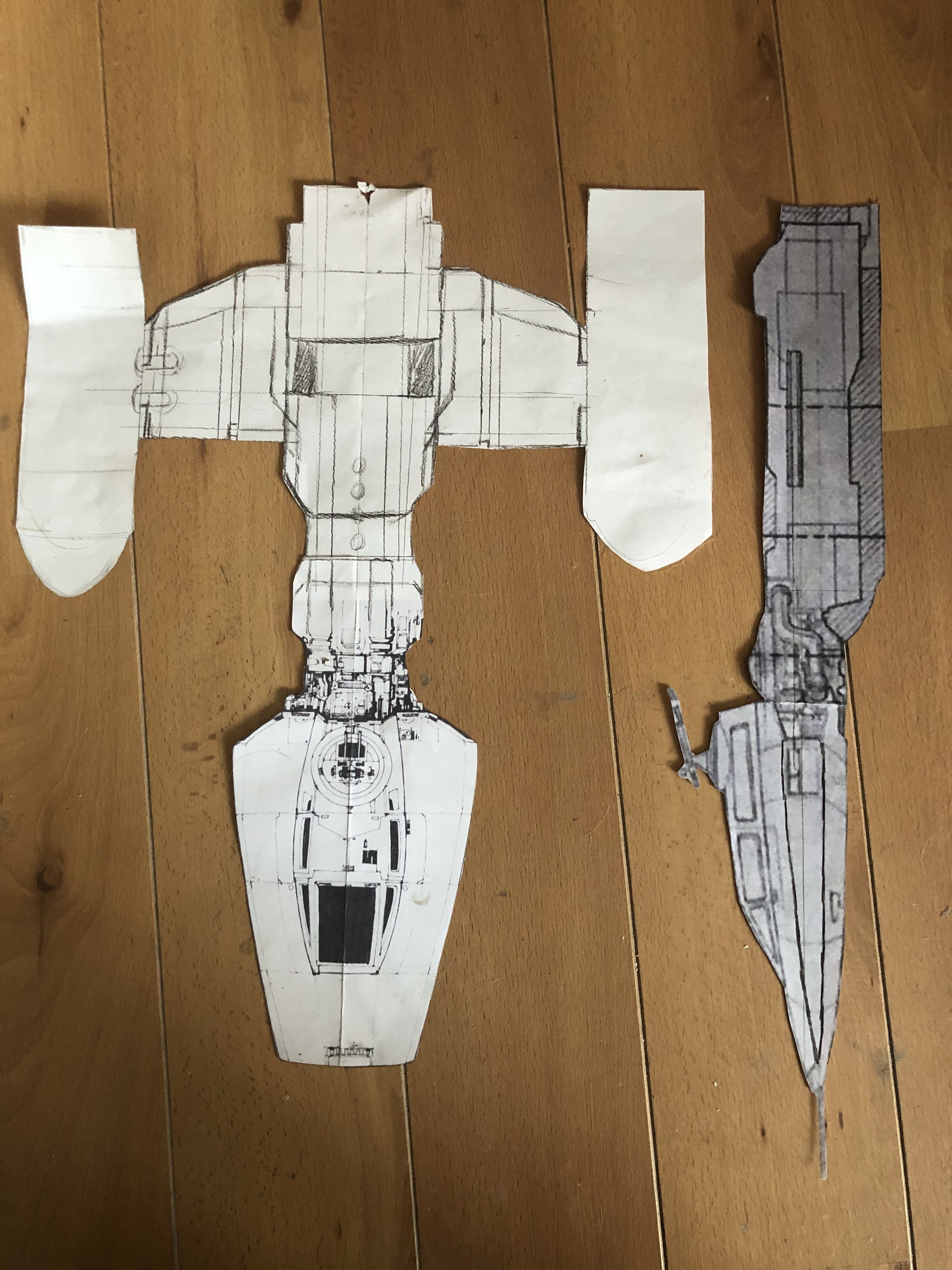

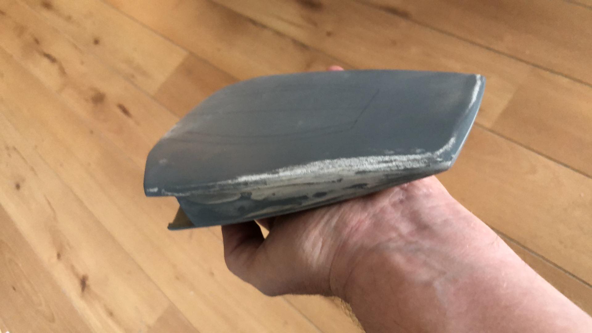

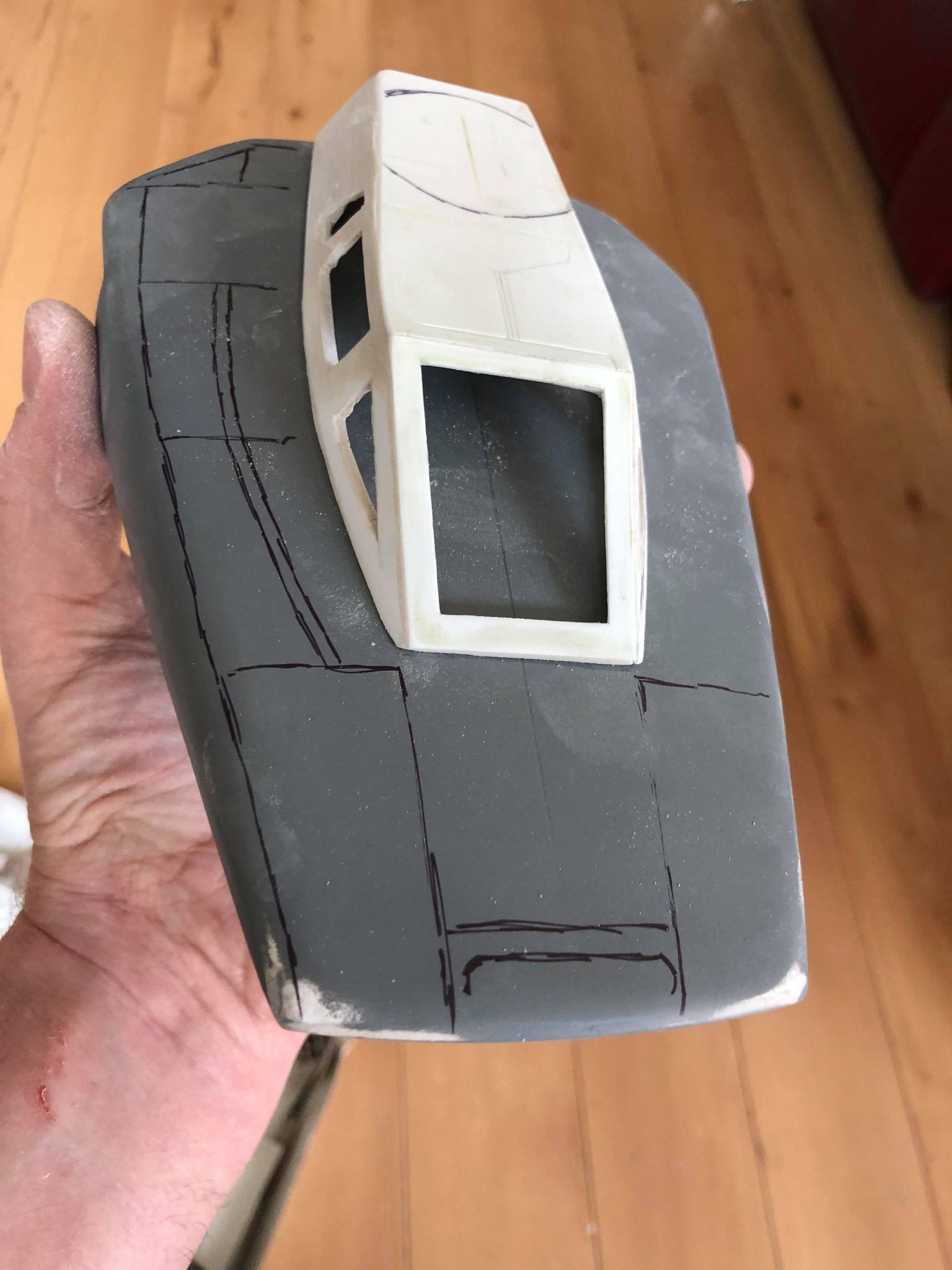

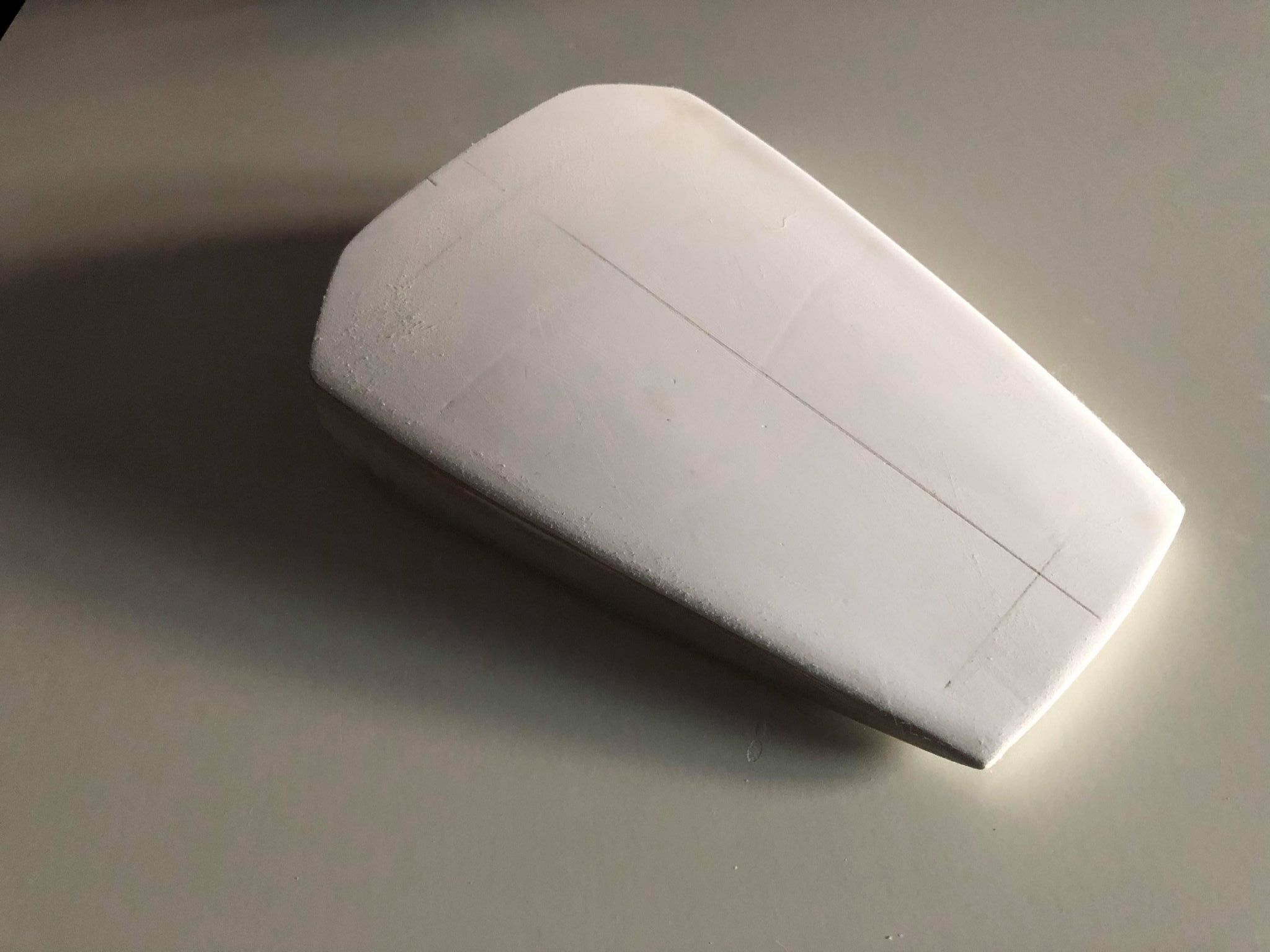

While working on a Cooper Star Destroyer, I had an itch to do another Joe Johnston Concept Model
I decided to base it on a different sketch than what Jason Eaton & Lee Ralph used to make theirs
I printed the sketch out on paper scaling the cockpit head to be similar in size to Studio Scale, then drew in the body basing it on a sketch that Ralph McQuarrie had made for his hanger painting
I then copied the outlines onto PVC Foamex board & began cutting & gluing
Thanks for looking
John

View attachment 1472700 View attachment 1472701 View attachment 1472702 View attachment 1472703 View attachment 1472704 View attachment 1472705 View attachment 1472707 View attachment 1472706 View attachment 1472708 View attachment 1472710

Your model work is always great, can’t wait to see it finished!

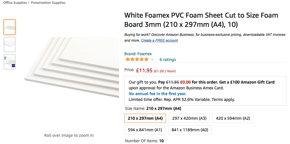

Thanks for posting your build John. I look forward to more updates. I have am unfamiliar with PVC Foamex board. How is it to work with? Is is easy to cut and sand? thanks Scott

Thanks scotthothpatrol, its a PVC board thats used for sign making,... quite light, easy cut with a blade, can be sanded, filled, drilled, just glue it together with superglue
Different brand names around the world, in UK, Foamex or Foamalux

Thanks John I will have to check out that material. 48th Ronin chimed in with the US name

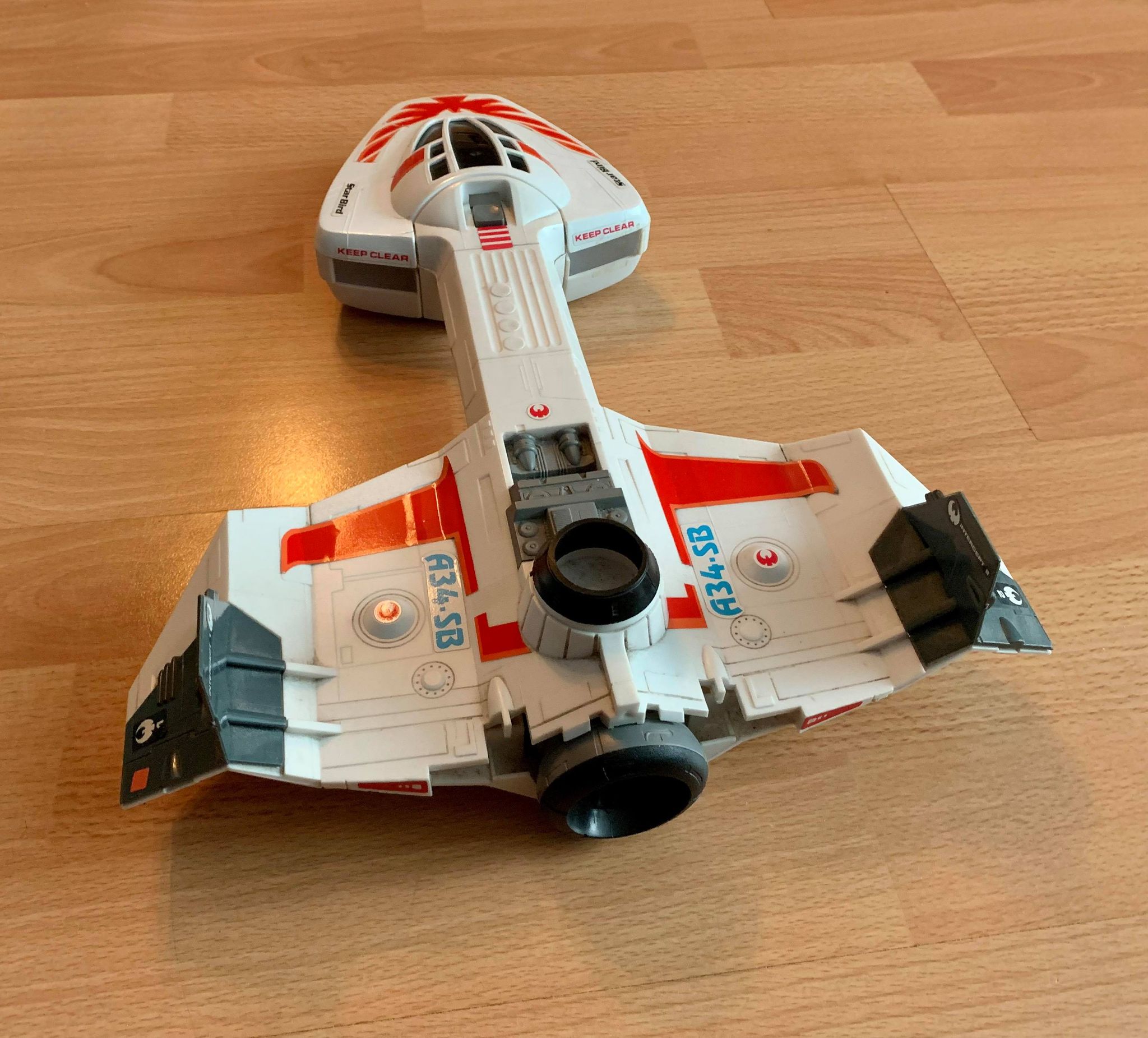

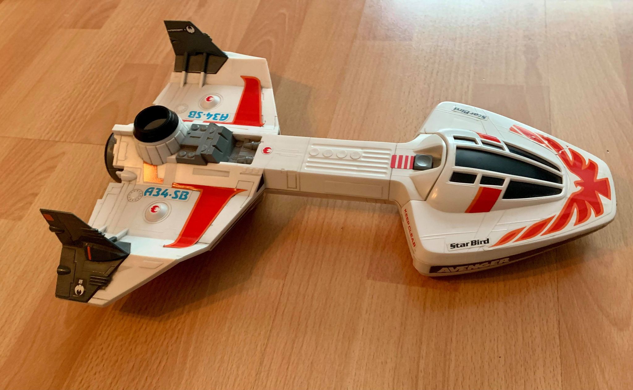

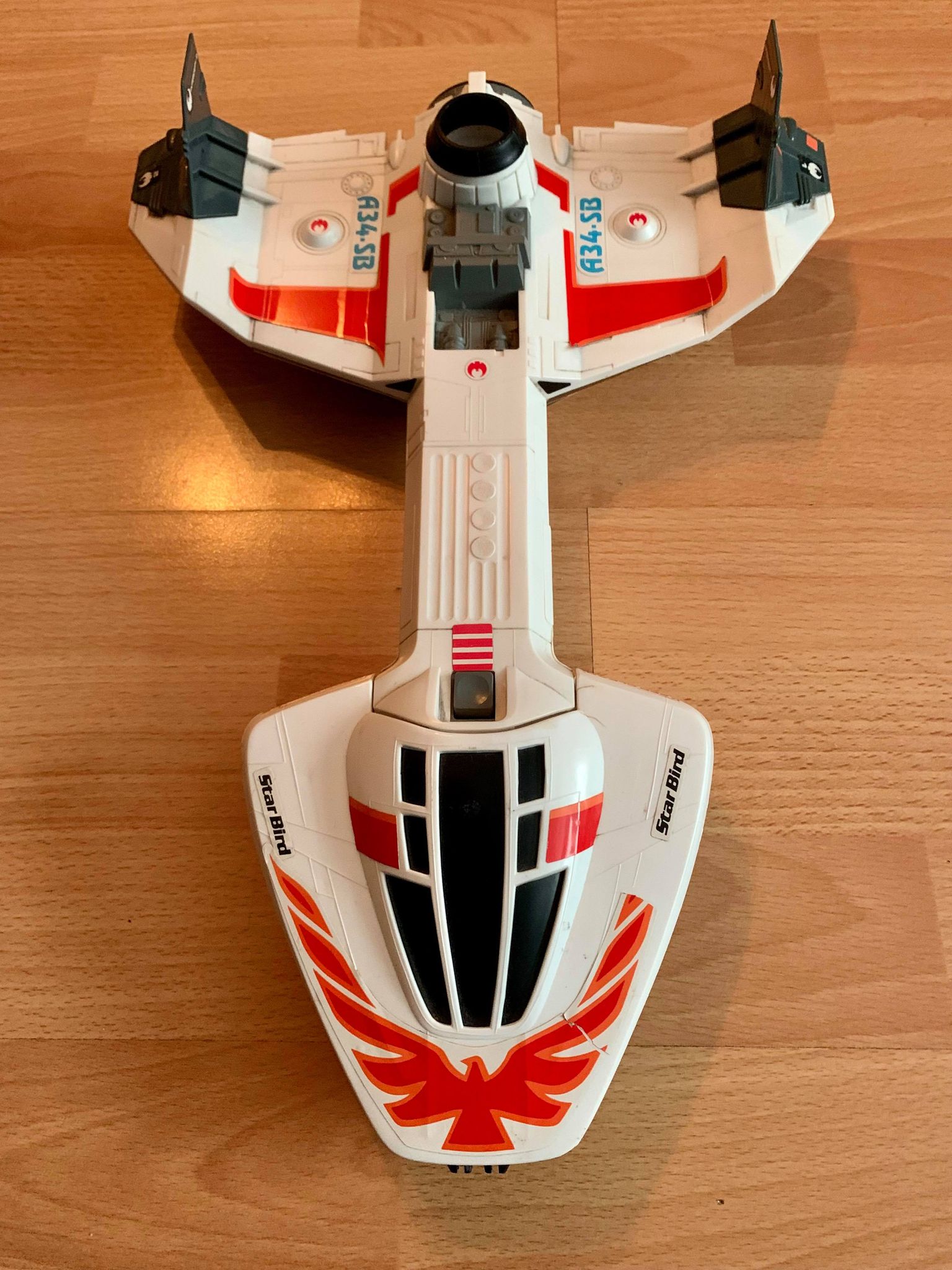

Back in 1979, Testors had a flying model with a tiny engine that looked to be based on the Y-wing. It was the Testors GALAX IX Spacefighter…something worth looking at. It, the Starbirds…and the Autobot ship based on it all draw from the Y-wing and would look great in formation with each other. I remember toys from the 1980s where you had X-wing style F-16 toys. I haven’t seen those in years.
Jaitea
Ha, my mate has that Star Bird toy on display in his living room, I asked him take a photo of it
Always liked that design...specially the top turret. Very sleek compared to the other 99% of the rest of the look ;)
Thanks Joberg,...I'm going to try & keep the sleek look on the rest of the ship
