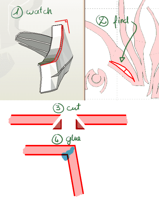

I must confess it did never happened to me, which explains my lack of tip about that. Anyway, if cutting at once each side of the triangle turns to failure, they may try to cut concentric triangles, starting with a small shallow one, and going larger to deeper until almost reaching the other side. The way a beaver would do... :)
Edit : conscientious that I am, I've just tryed out. At first I've sharpened my knife (ALWAYS resharpening, as soon as you feel that you don't cut warm butter), I apply my thumb on the side of the blade AND on the foam simultaneously, so as to prevent the blade from pearcing through it. My inch acts as a depth stop.
Never had problem.
