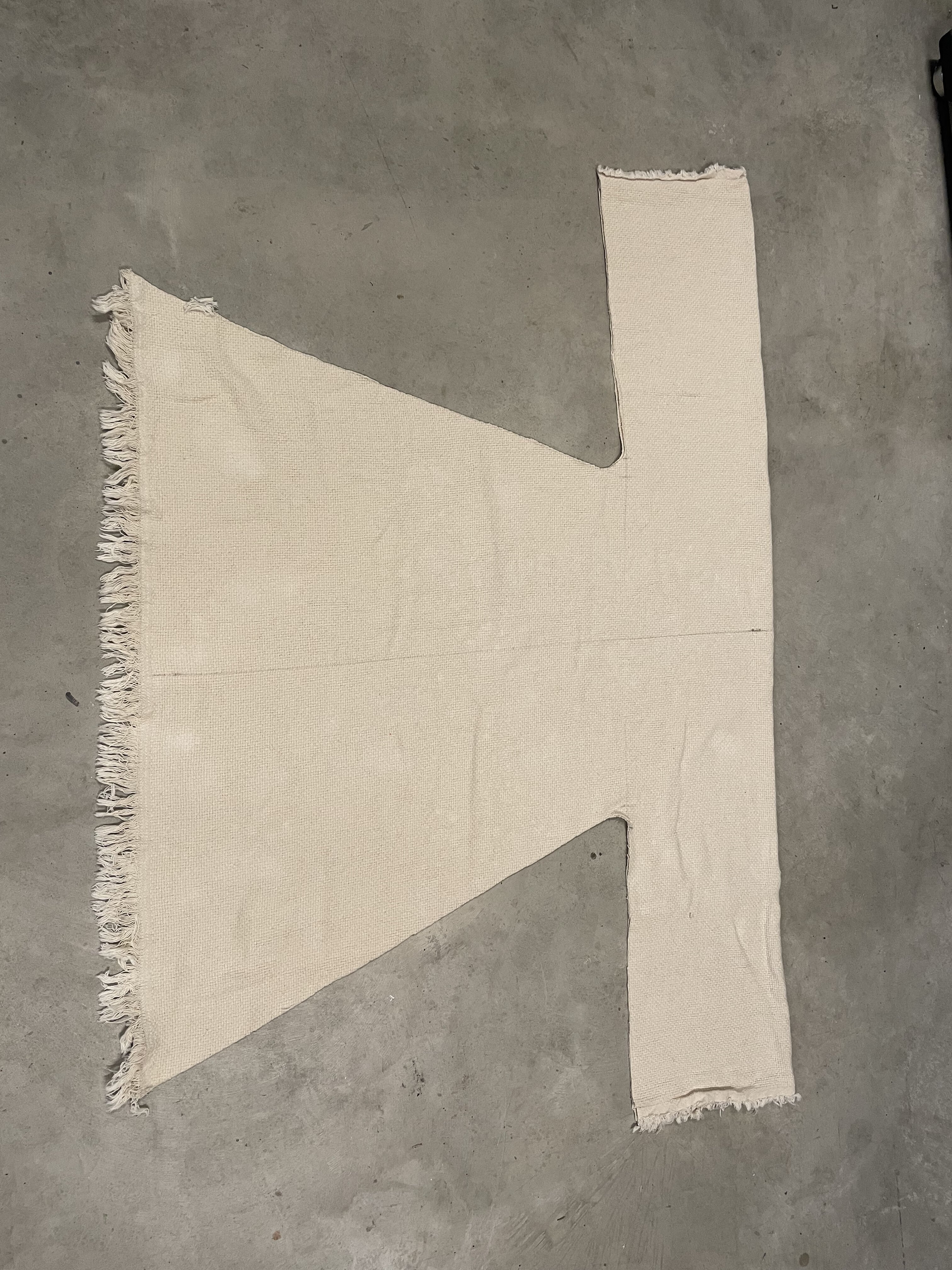

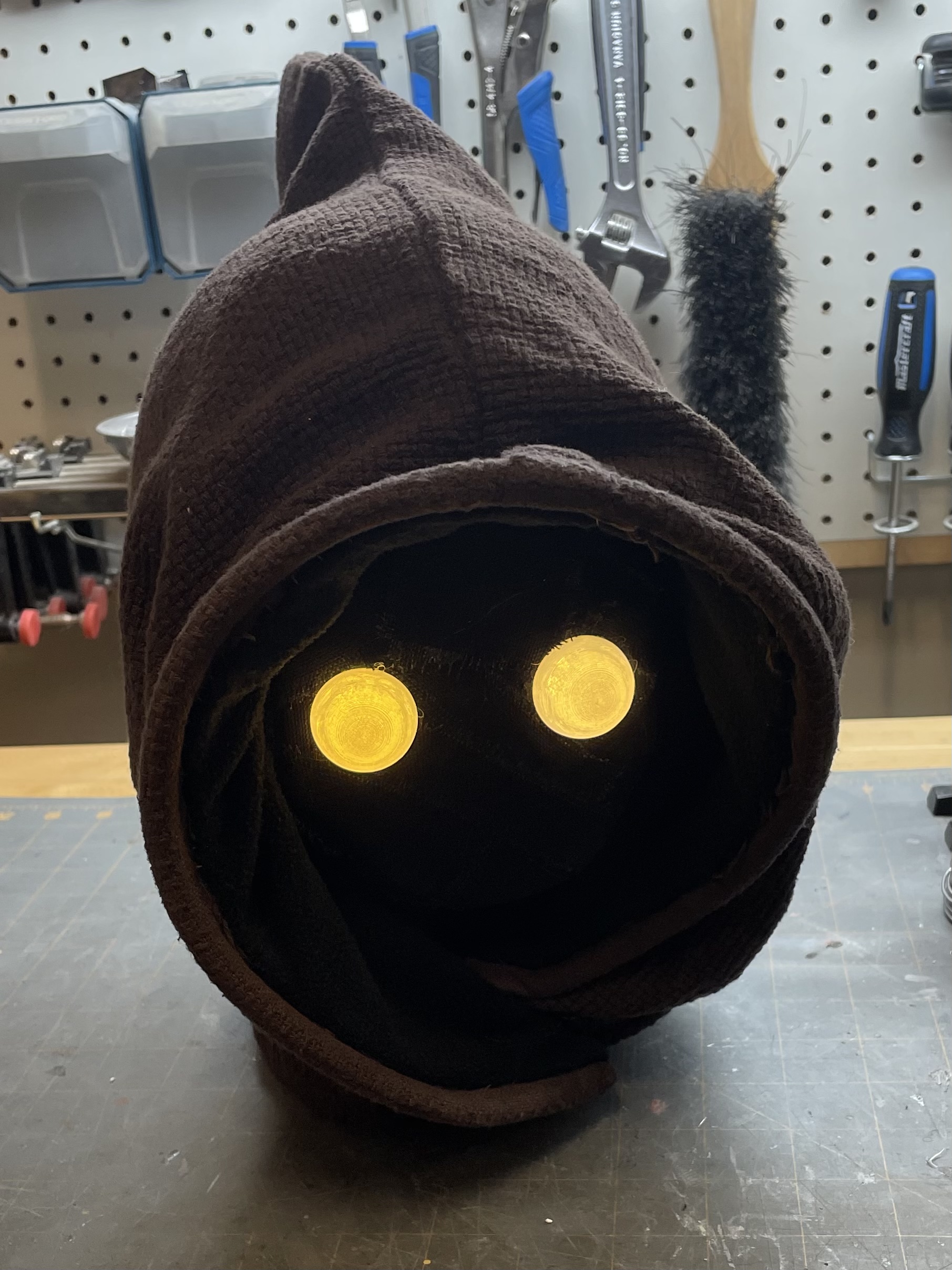

I want a couple of inexpensive Jawas for my Halloween display this year. I started with these cheap IKEA blankets (recommended on the Krayt Clan forum) and drafted my own pattern based on what is universally accepted as a Jawa robe.
I used small clothes pins to keep it together for sewing as the material is a very loose weave and won’t hold pins.
I used a long straight stitch followed by a loose zig zag stitch over top to keep the edges from unravelling, flipped it inside out and had a finished robe.

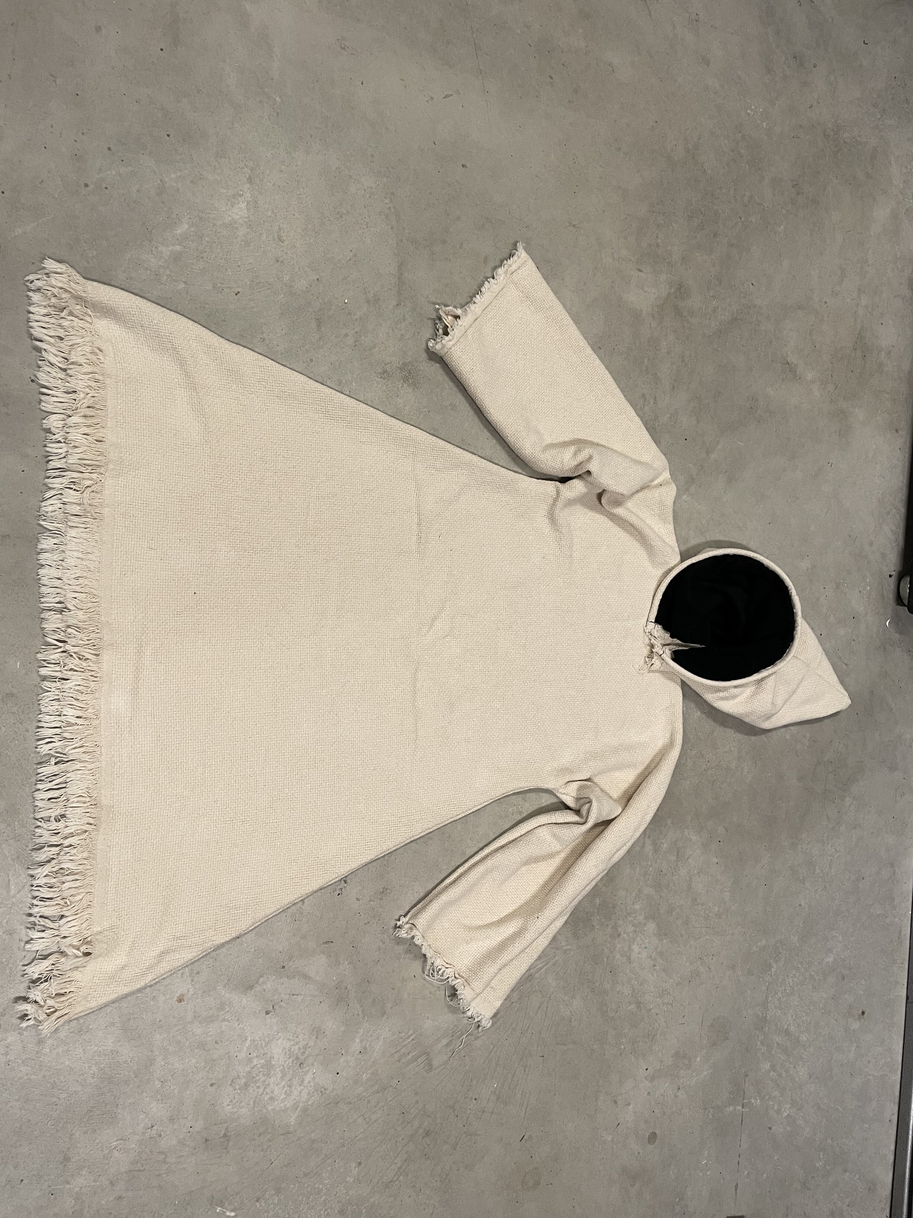

This was my first attempt at a hood and I had to figure out how to assemble it with the liner. It ended up being a little short so I am not using it. I made it from the offcuts from the blanket so there isn’t any waste.E6548A85-63F8-4F50-B35B-3CBFBC25D0CF.jpeg
I then dyed the robe with Rit brown dye. It didn’t take as well as I was hoping (I think I needed to stir the dye bath more) but I’ll dress any imperfections with weathering.

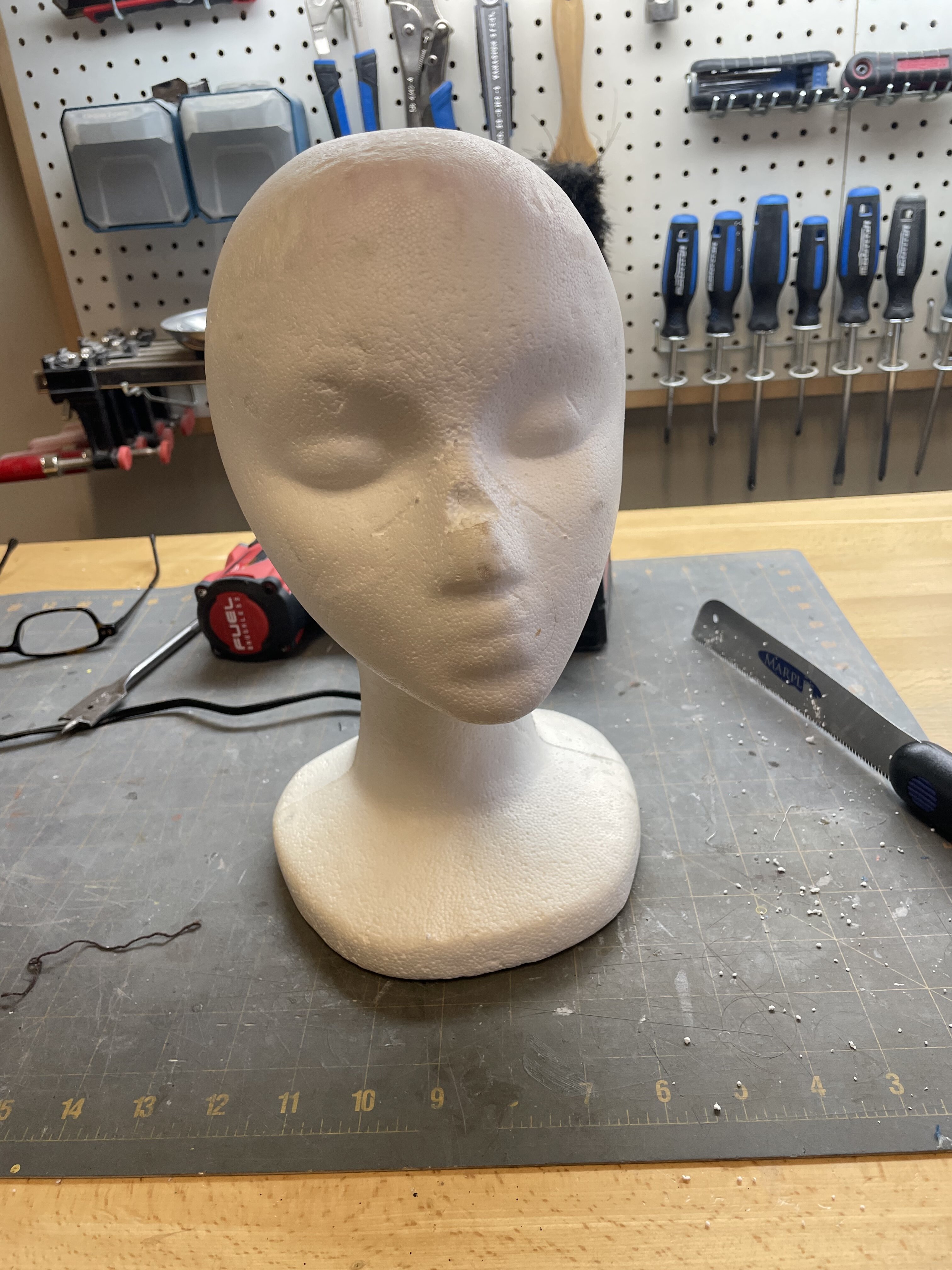

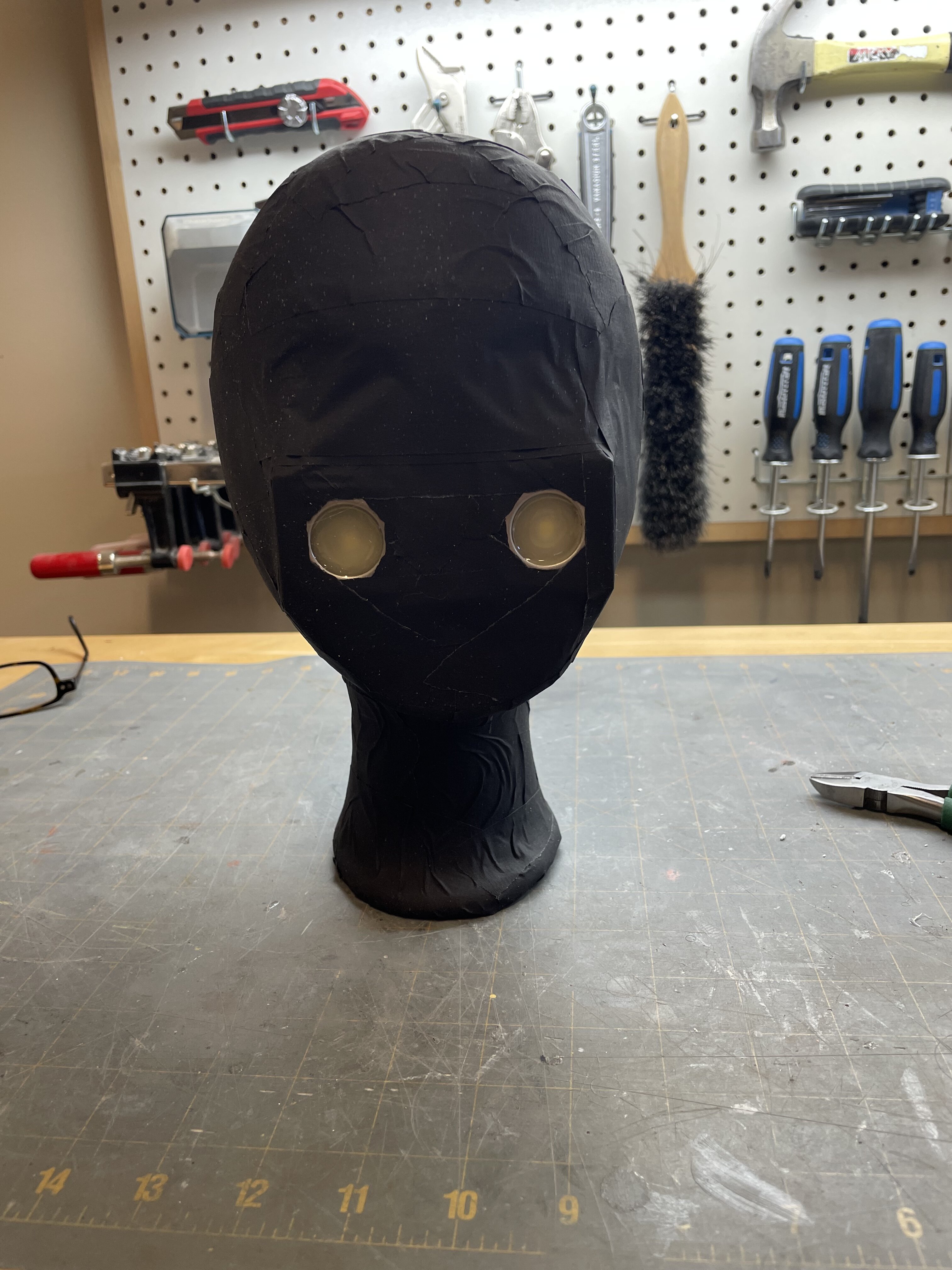

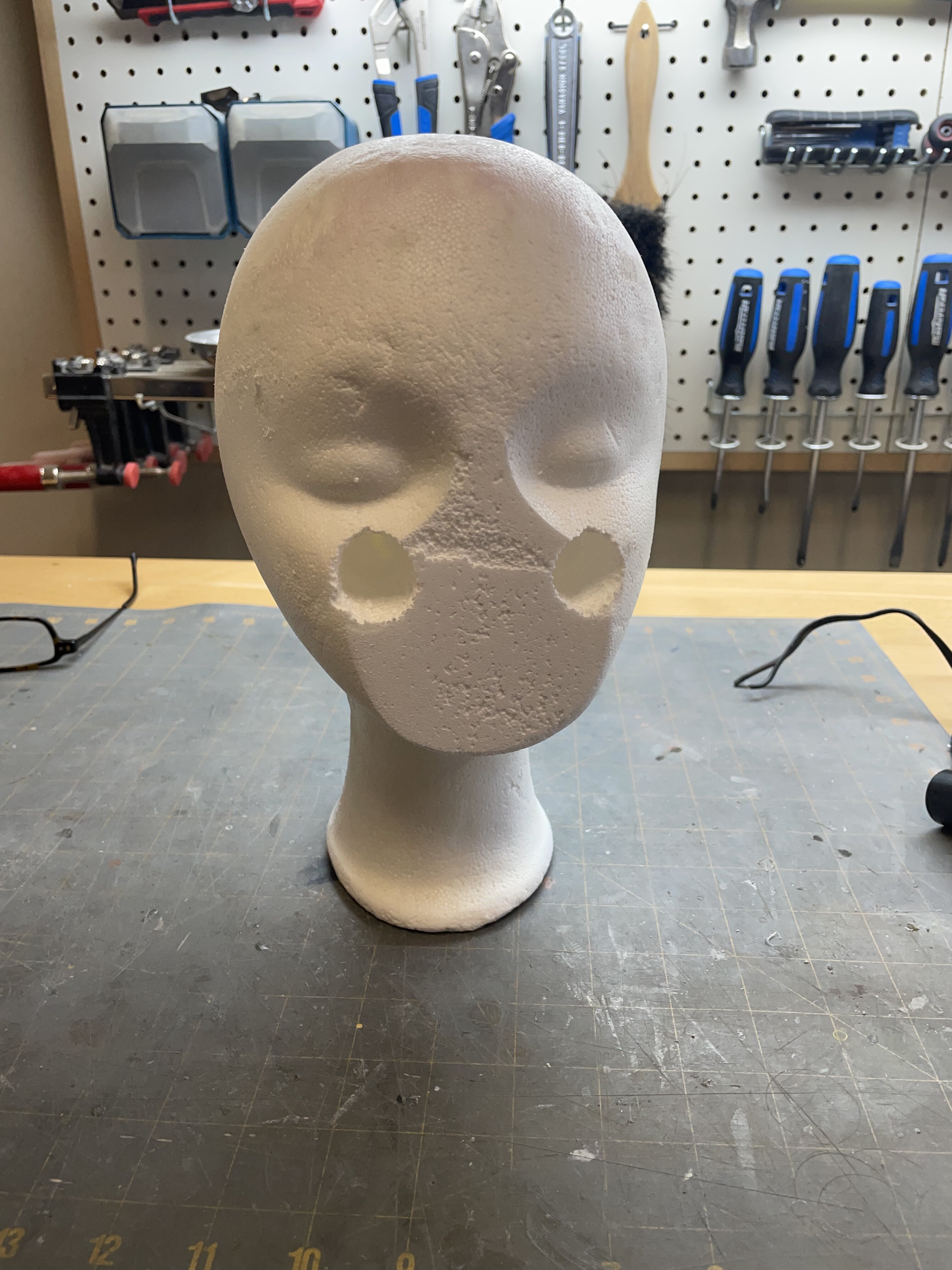

For the head I started off with a styrofoam head I hade lying around and some old outdoor led lights that I stripped down.
I cut the front of the face to create a flat area and mounted the new eyes below the original ones.

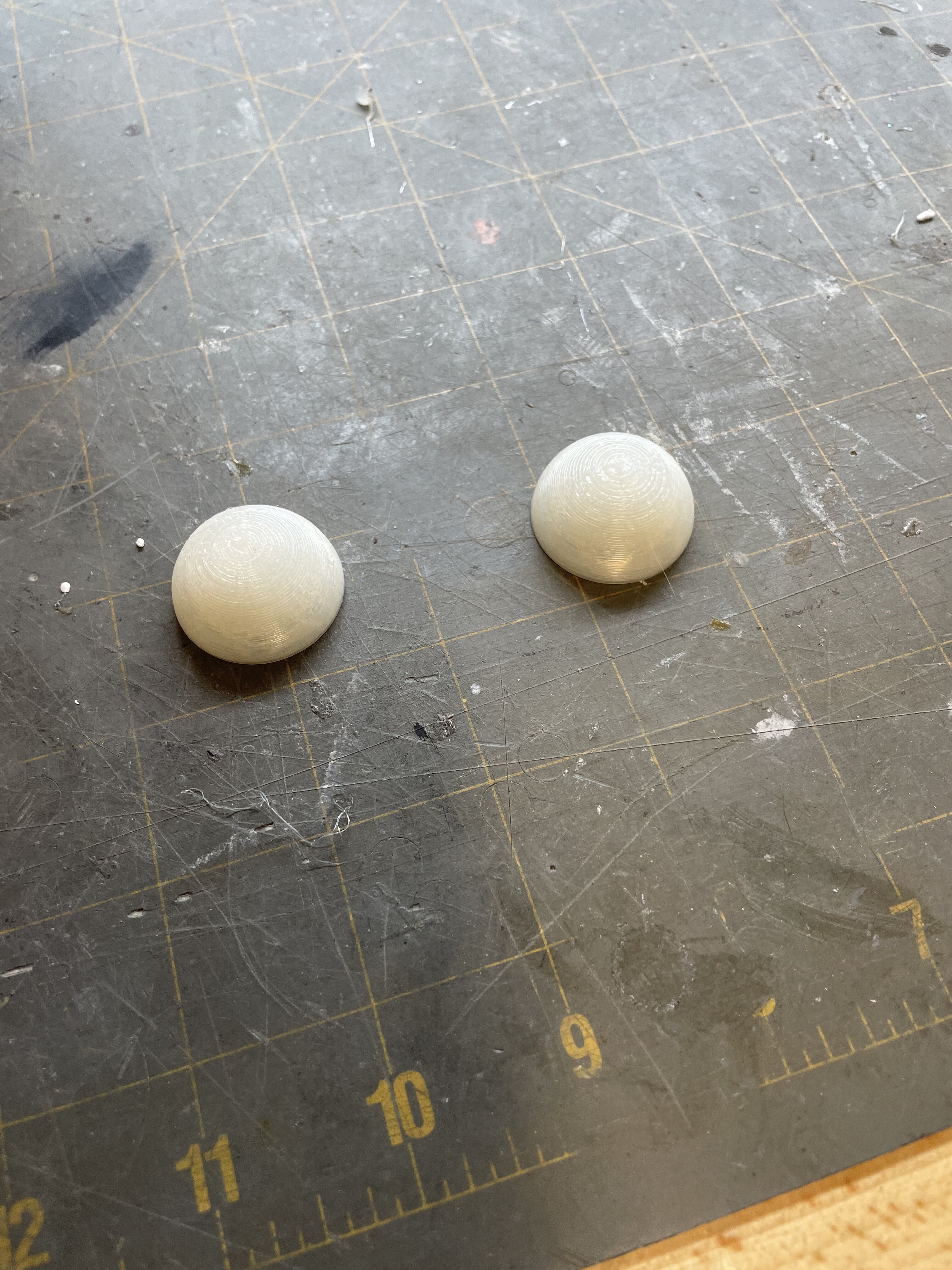

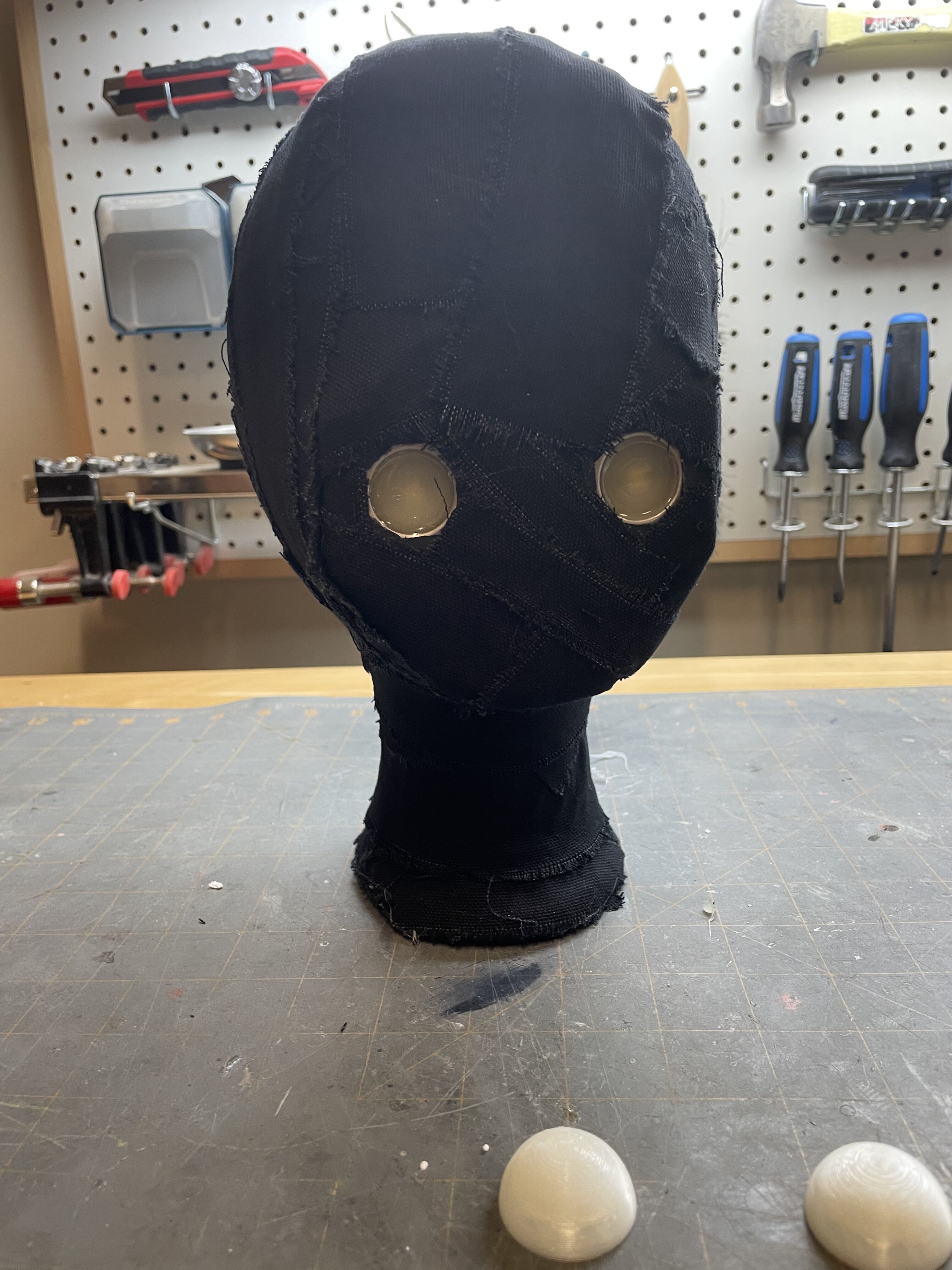

I then wrapped the entire head with black gaffers tape and 3d printed some hemispheres in translucent white PLA.
I could have stopped here but decided to add some black duck cloth I had lying around. I figured they may be like the Tusken Raiders under the hood.

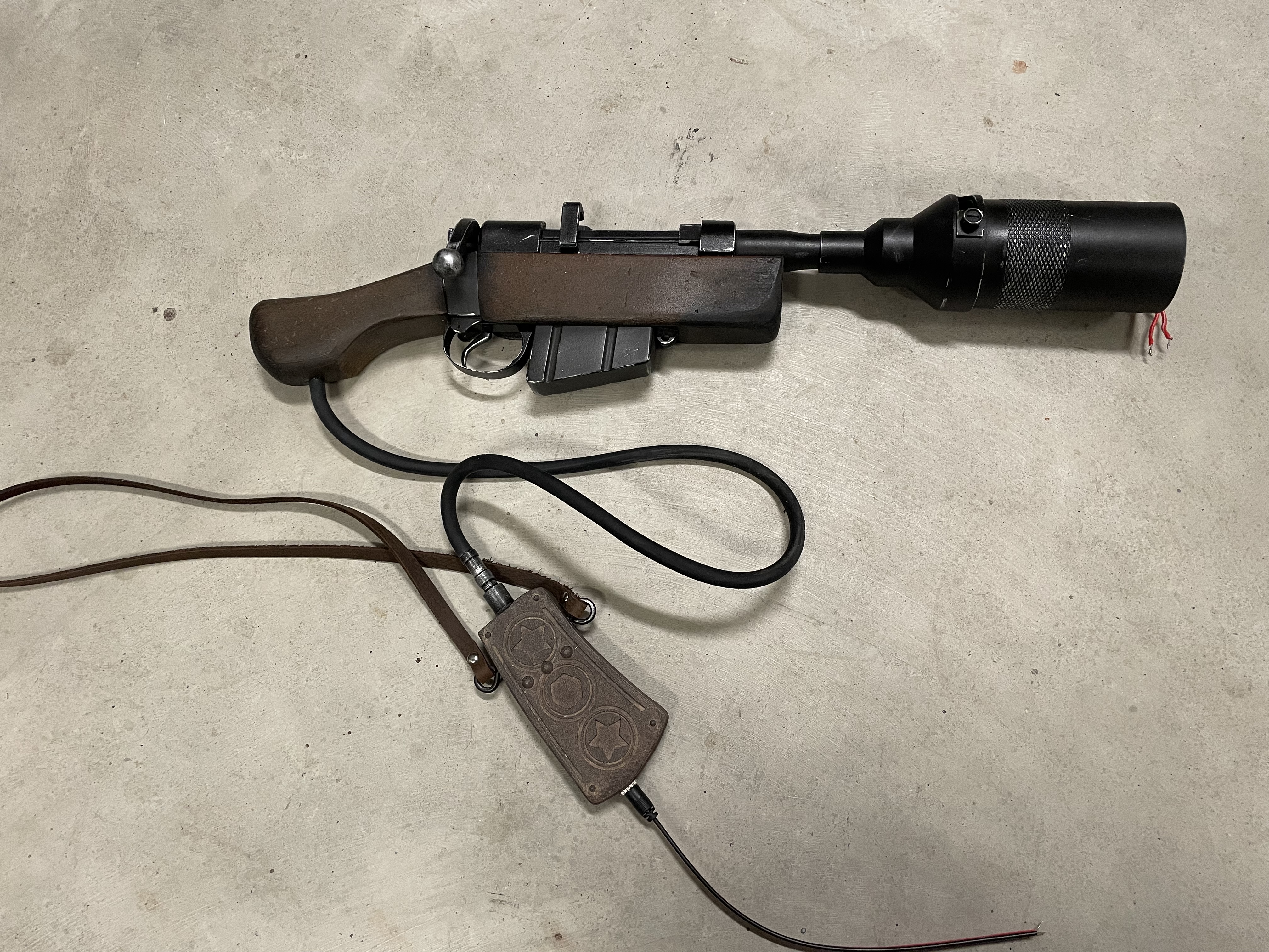

It took me a few try’s to get the pose I was looking for but I think I finally have a decent action pose. The blaster will be motion controlled and light up but I’ll detail that buildup in another thread.

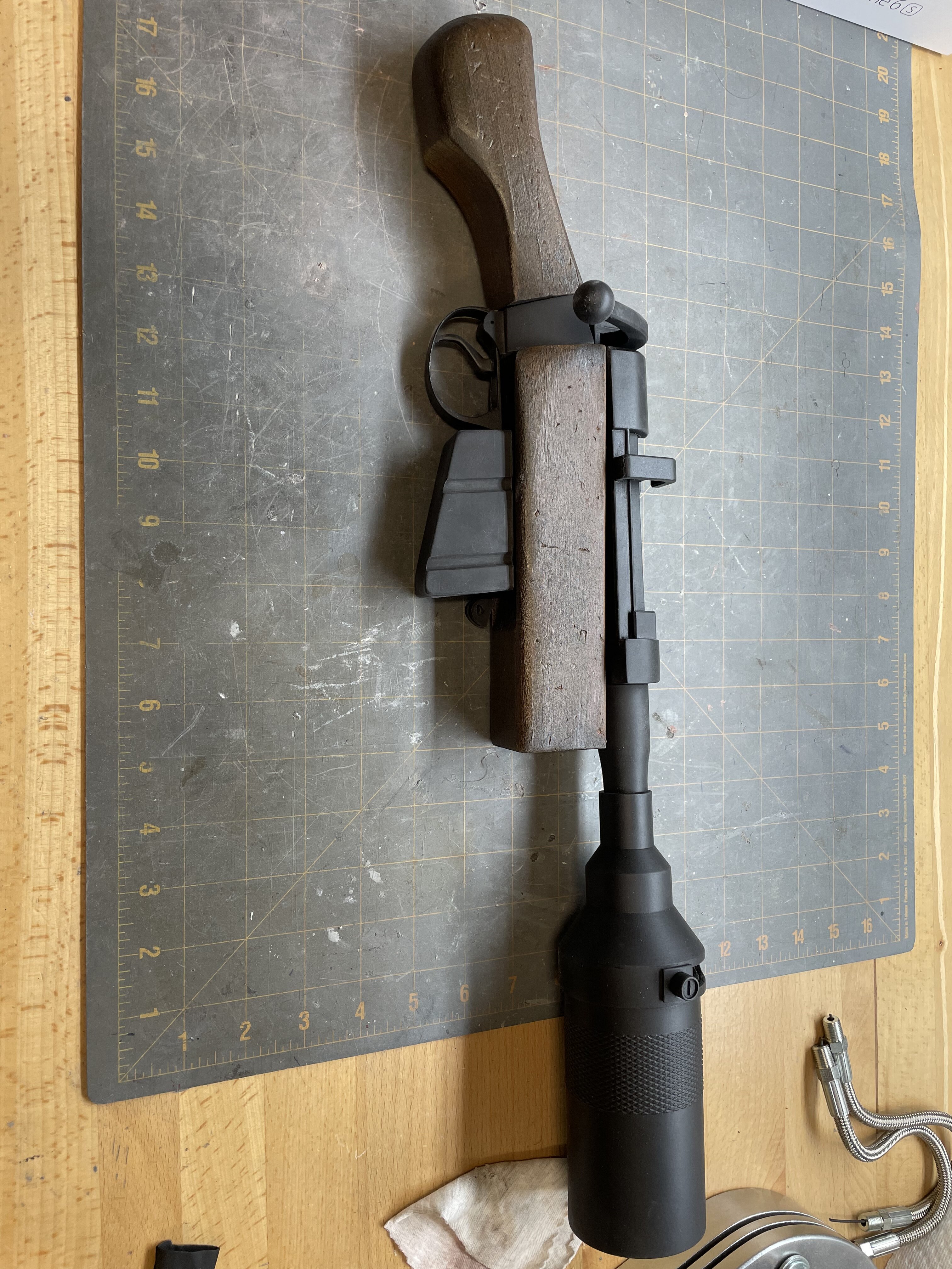

Seems like I didn’t document the ion blaster build as much as I thought I had so I’ll add it here.
I 3d printed some free files from Thingiverse from a couple of sources and modified a few of the parts and had to make a couple new parts.
As with any prop I work on, the more I analyze it the more problems I find with existing models. I’m not a good enough modeller to completely scratchbuild something like this but I can cobble together a reasonable facsimile.
I made the barrel and stock from a 2x4 and used acrylics for the stain.
All parts were glued and pinned together.

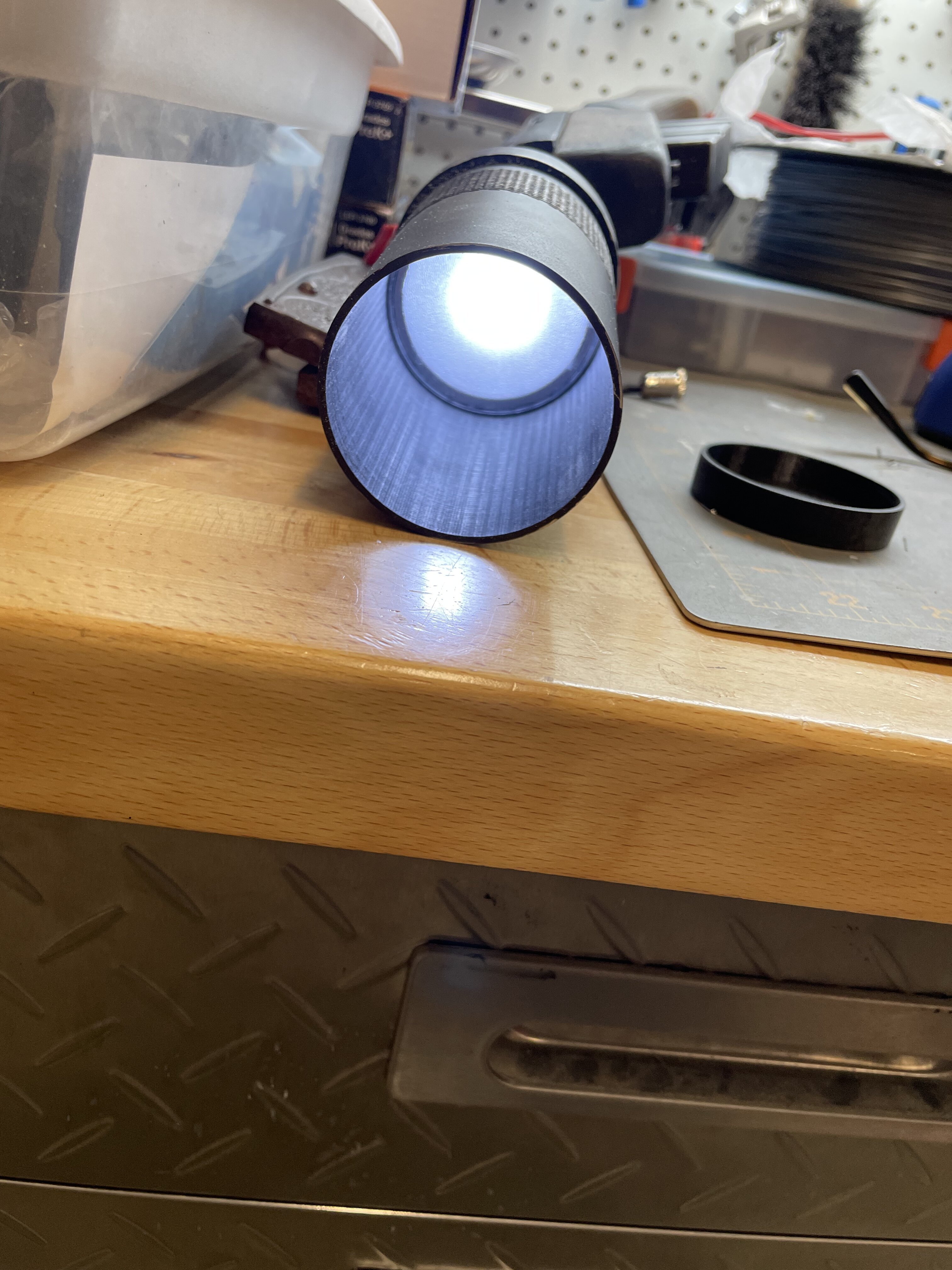

I added leds to the barrel as I intend to wire this up to a prop controller.
I modelled up my own powder flask so it would be easy to print and I made a channel in the model for wires and the power plug.
Added a leather sling and this is where I am at.

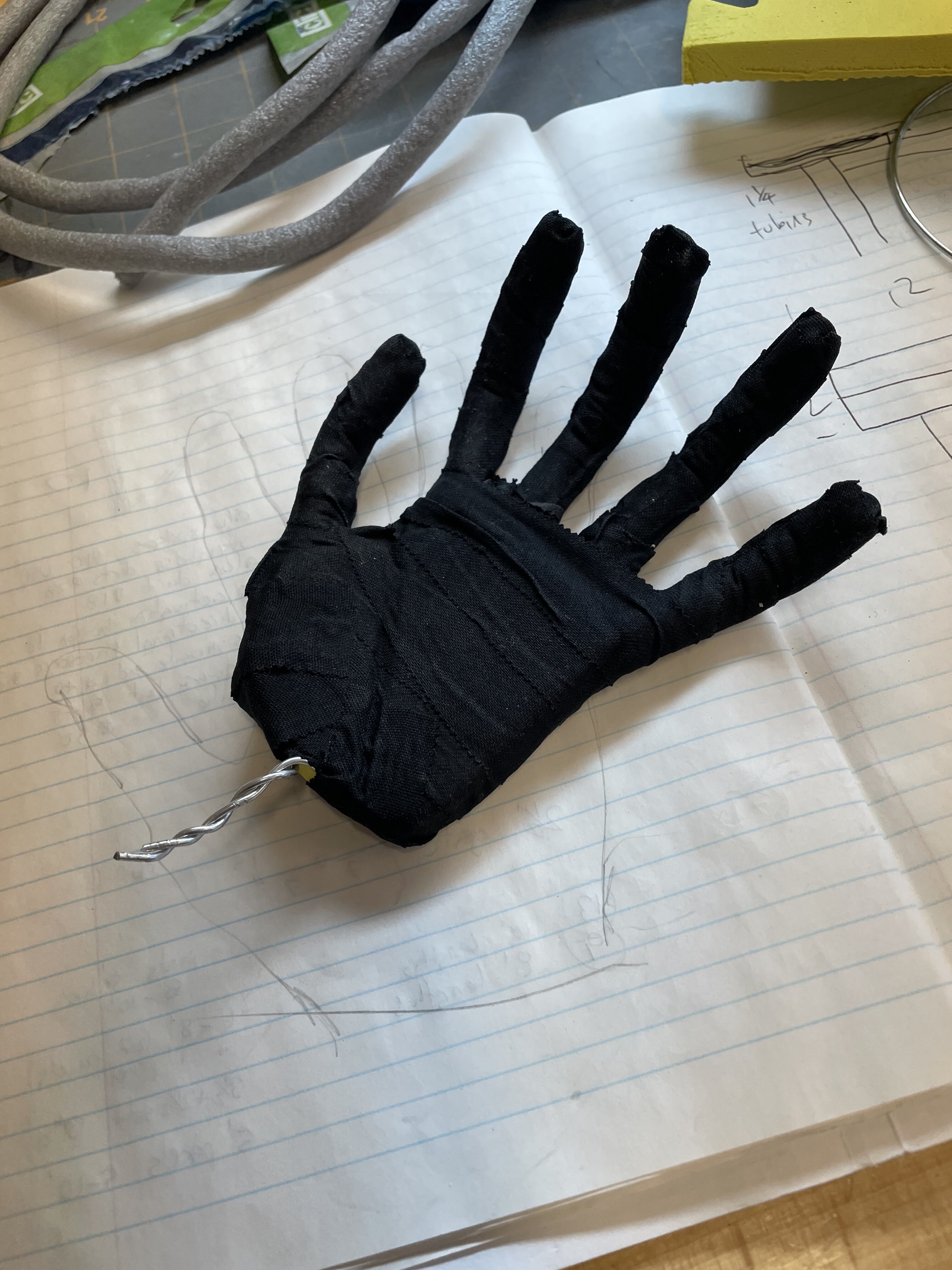

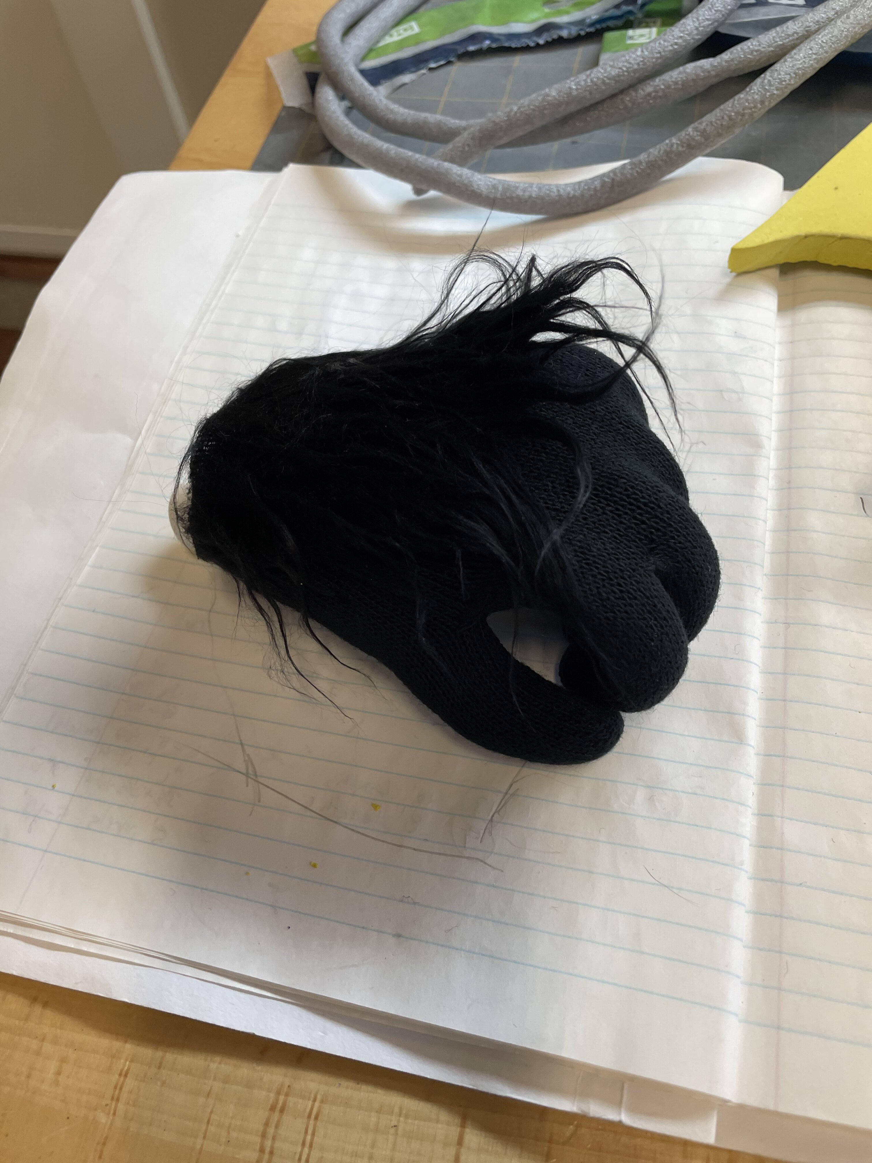

I traced my wife’s hand and followed the outline with some stiff armature wire.
I used backer rod for the fingers to give some bulk and wrapped them with hockey tape.
For the palms I used a cut up foam mat that I had left over. I sliced a wedge shape down the middle as I want to be able to move the thumb into an opposing position. Everything was wrapped up in the hockey tape again.
I had purchased some inexpensive kids gloves on Amazon and used two layers for each hand. I could have gotten away with one layer but these gloves were so cheap and the second layer made a big improvement in the finished look.
I finished off with some fake fur I had lying around and then I had a finished set of posable Jawa hands.

I love your Jawa's!
Perhaps some yellow candywrappers or paint added inside the eyes to make them glow more yellowish?
