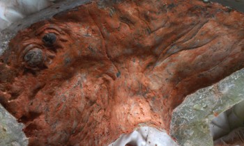

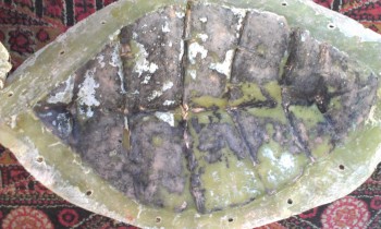

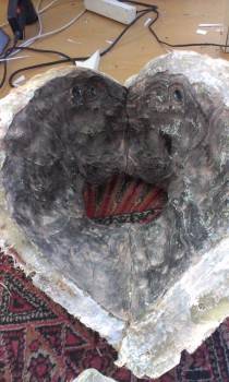

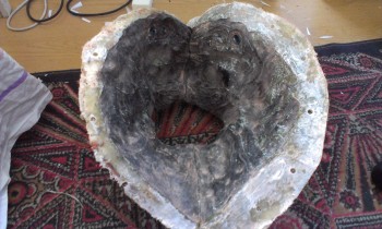

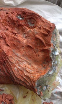

So started cleaning mold from clay
now just need to brush out it from textured parts and its ready for casting
Did you release the sculpture before molding?
I'm only asking because of the paint stuck to the inside of the mold. I'd grab yourself some acetone and a cut down chip brush and get that out before casting latex in to the mold.
Otherwise you won't see that nice smooth surface you had from the primer before molding, you'll get the uneven underside of the primer thats showing now.
You may have already done this but I thought I'd throw it out there to make sure your castings come out as nicely as possible after all the hard work:)
i actually like how paint captured all small details, i did test pull with very thin latex to see how it captures details of paint and resign and lines between, because i brushed some paint off and saw that it looks good, no lines of transition or anything like that.

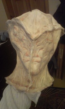

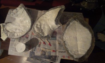

here is my first 2 layers of latex, ow i need it to cure properly and then apply more latex, gauze ad even more latex, to support top of the head
and here is my first pull from mold
Few minor bumps in back, a cavity between layers in one side of chin and thin part on on one side
more pictures, this time me wearing head cast, trimmed some lashing, eyes and a slit in back of the head. i will have to fill inside bubble in chin and reinforce one of the sides, also add fiberglass layer inside of carapace
