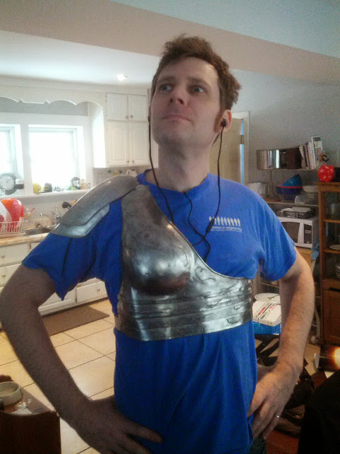

I built a replica of the breasplate worn by Jane Foster in Thor 2 over the past couple of weeks.
Here's the rundown:
Hammered from 20g mild steel sheet and masked with vinyl that I cut on a silhouette.
Etched using a 5A, 30V power supply running at 4.8A for about an hour in a table salt (NaCl) solution. Armor anode (+) other plate as cathode (-). Both submerged in the solution.
Here is the lovely bucket of of sludge at the end of the process.
Final Product:
Also made a video of the creation:
