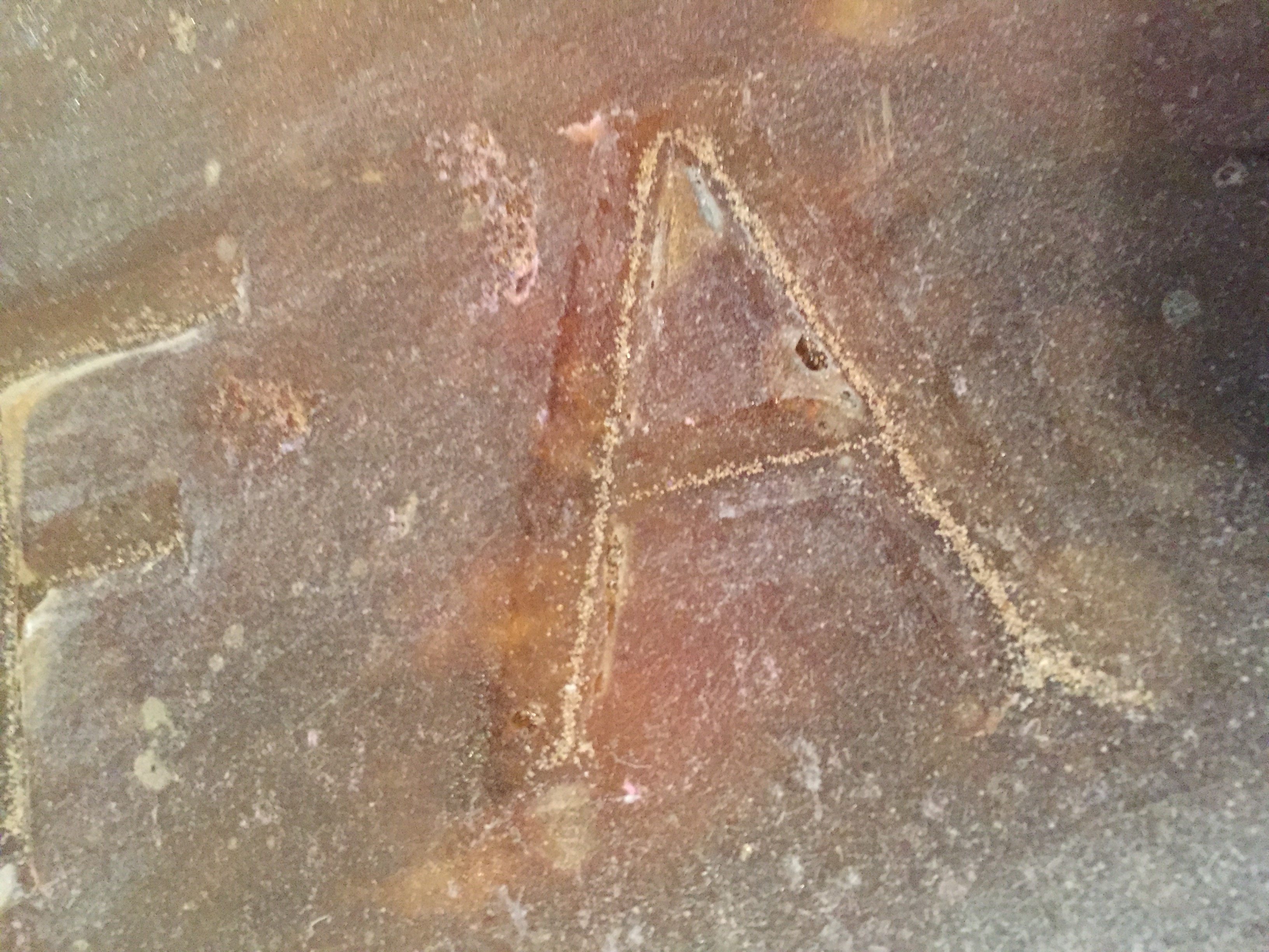

Recreated the SKYFALL sign on Bond's house from the movie. I had a couple of research images that showed the actual prop being handled.

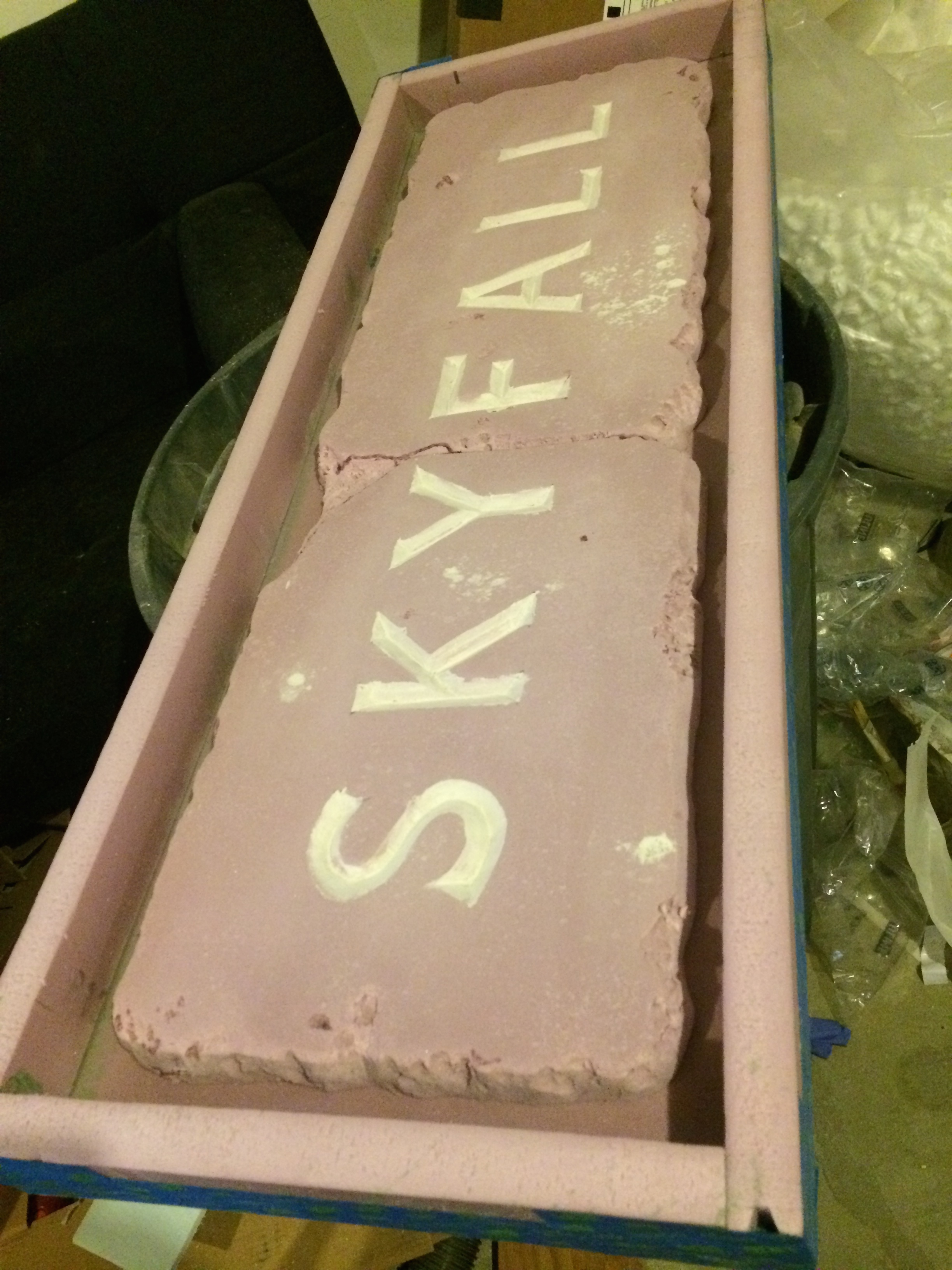

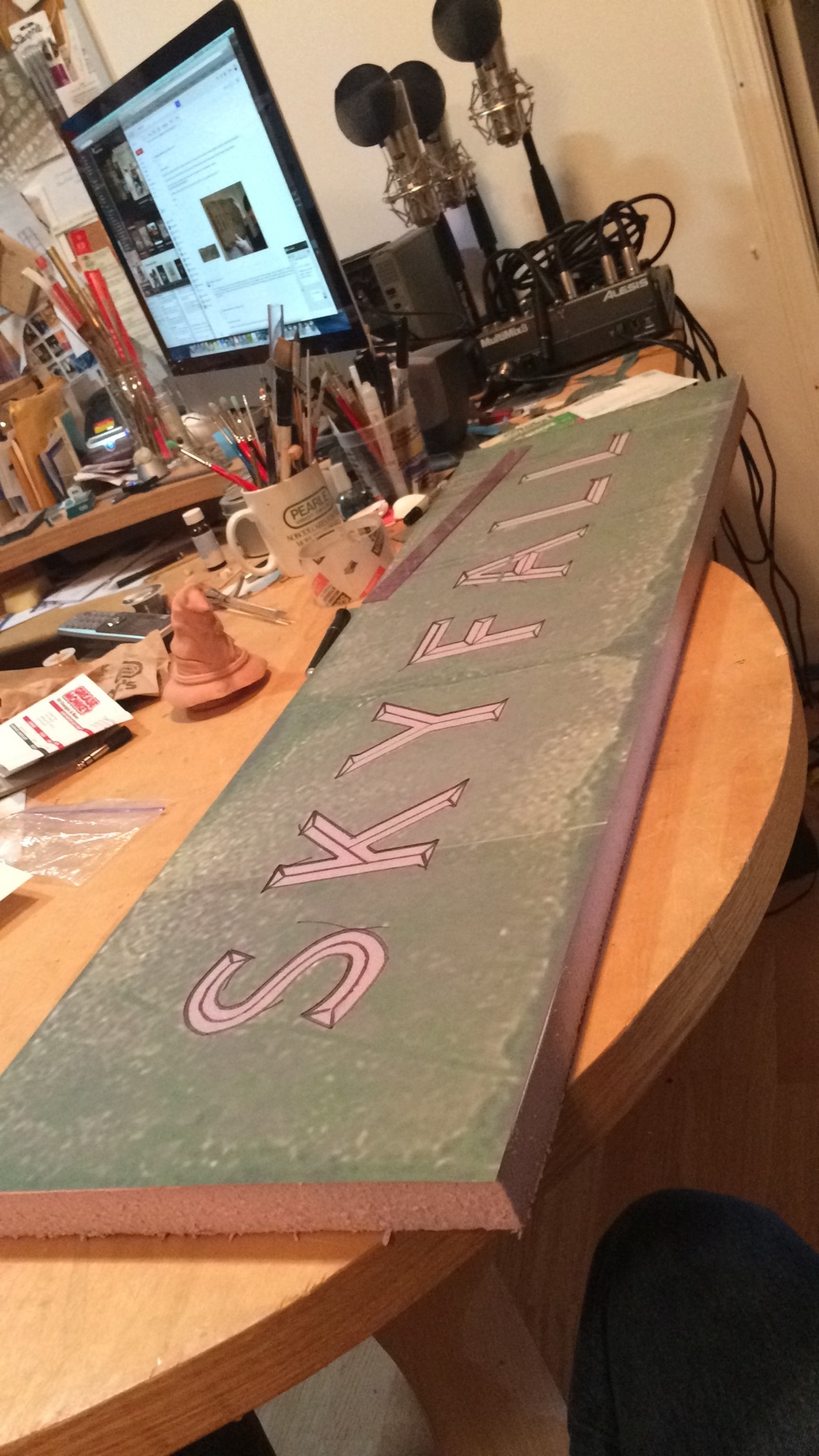

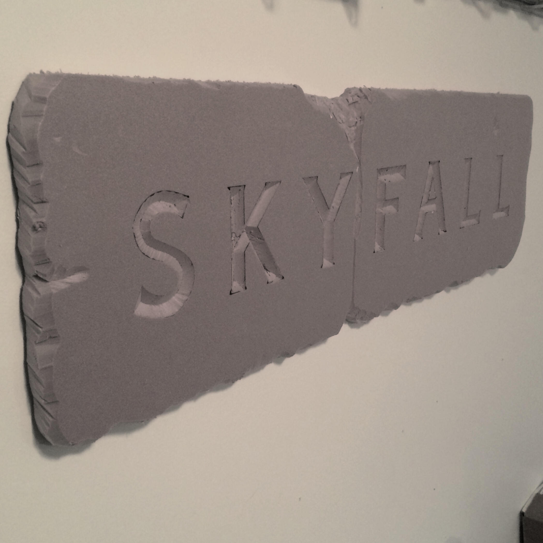

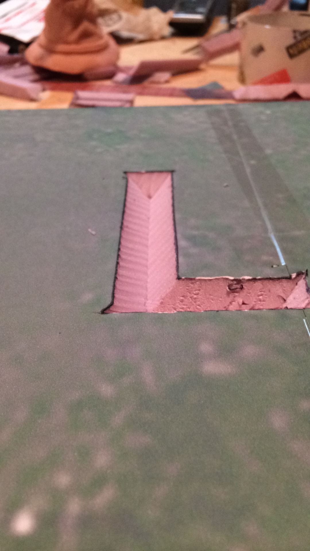

Started by printing the sign at full scale. I used extruded foam to carve the stone look, spritzing it with acetone and sanding it to give it a more coarse look.

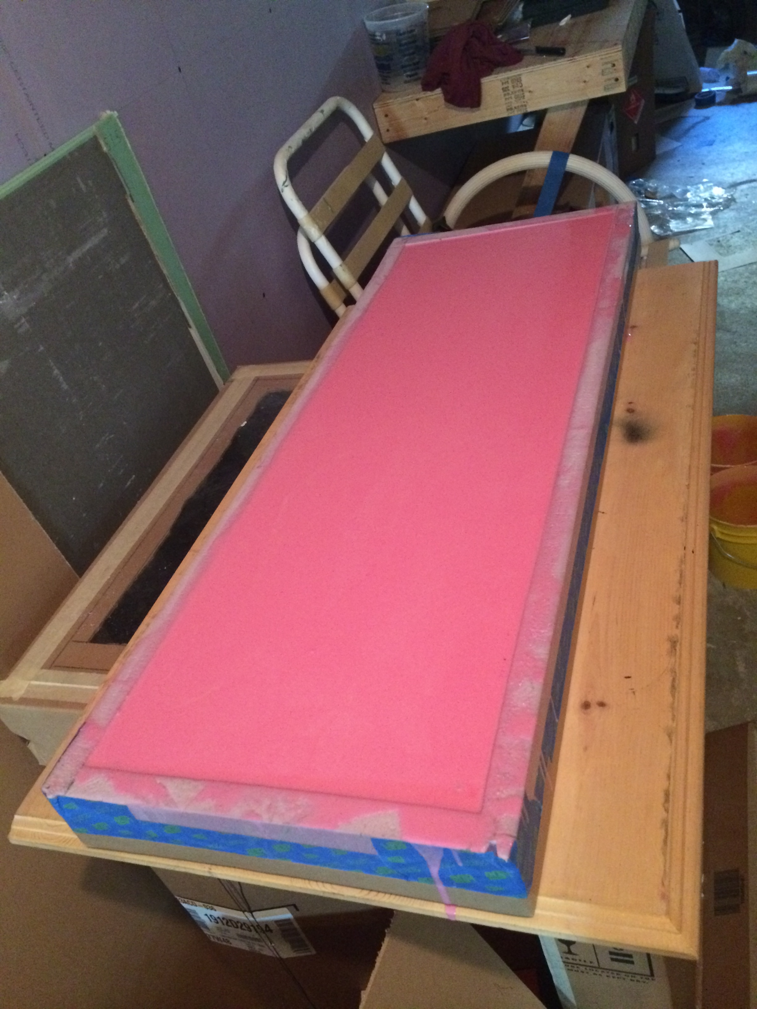

Then it was time to box it up and pour the silicone.
It took almost two gallons of silicone to pour it. That's a mess of silicone. I used Mold Max 30.

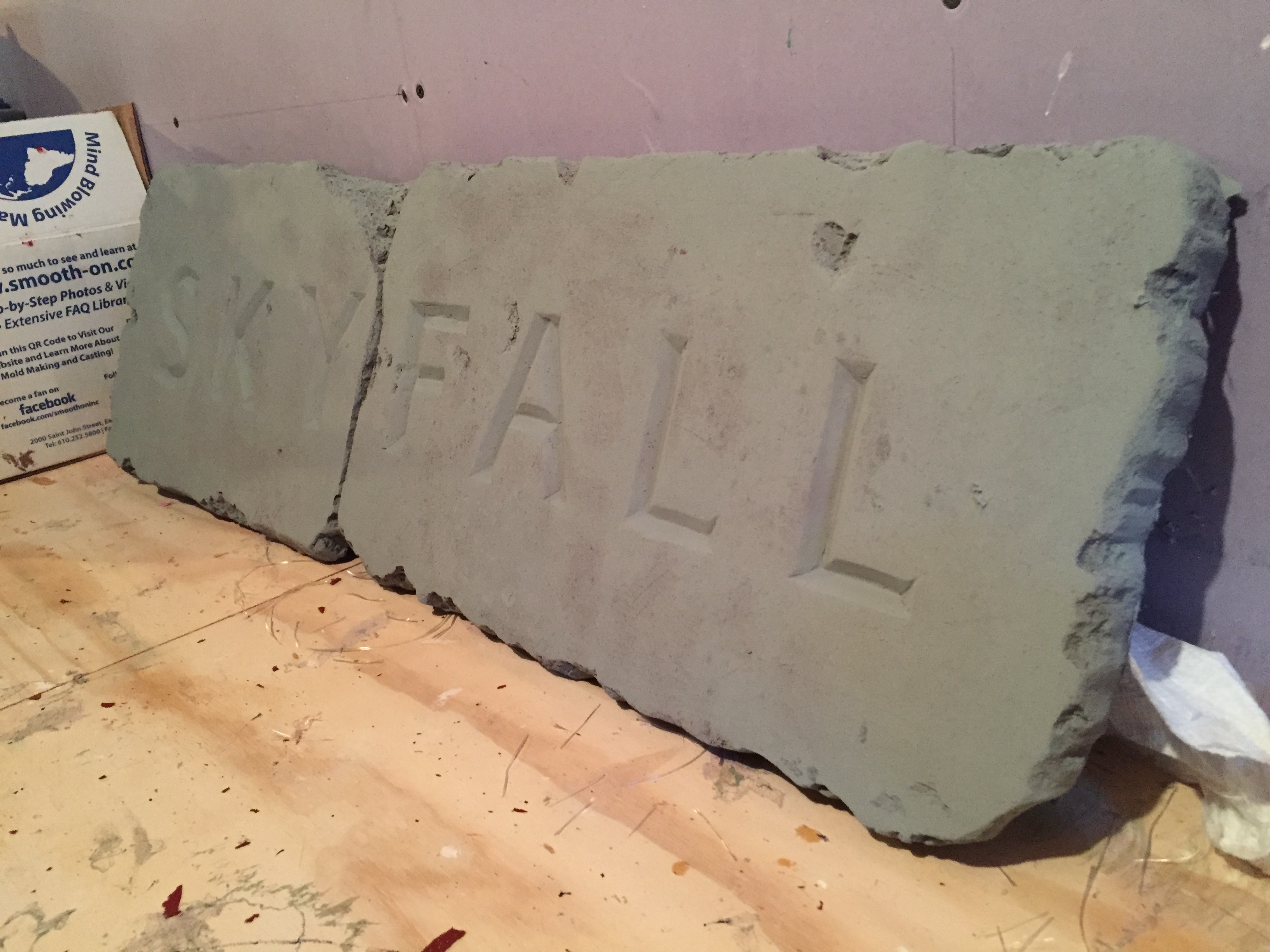

The first two pulls were of UltraCal. It turned out great, but weighed almost 40 pounds. I had even sunk a 3/4" sheet of ply and mixed in some cabofil to help lighten it. Unfortunately, during the full cure phase, they cracked apart and were lost.

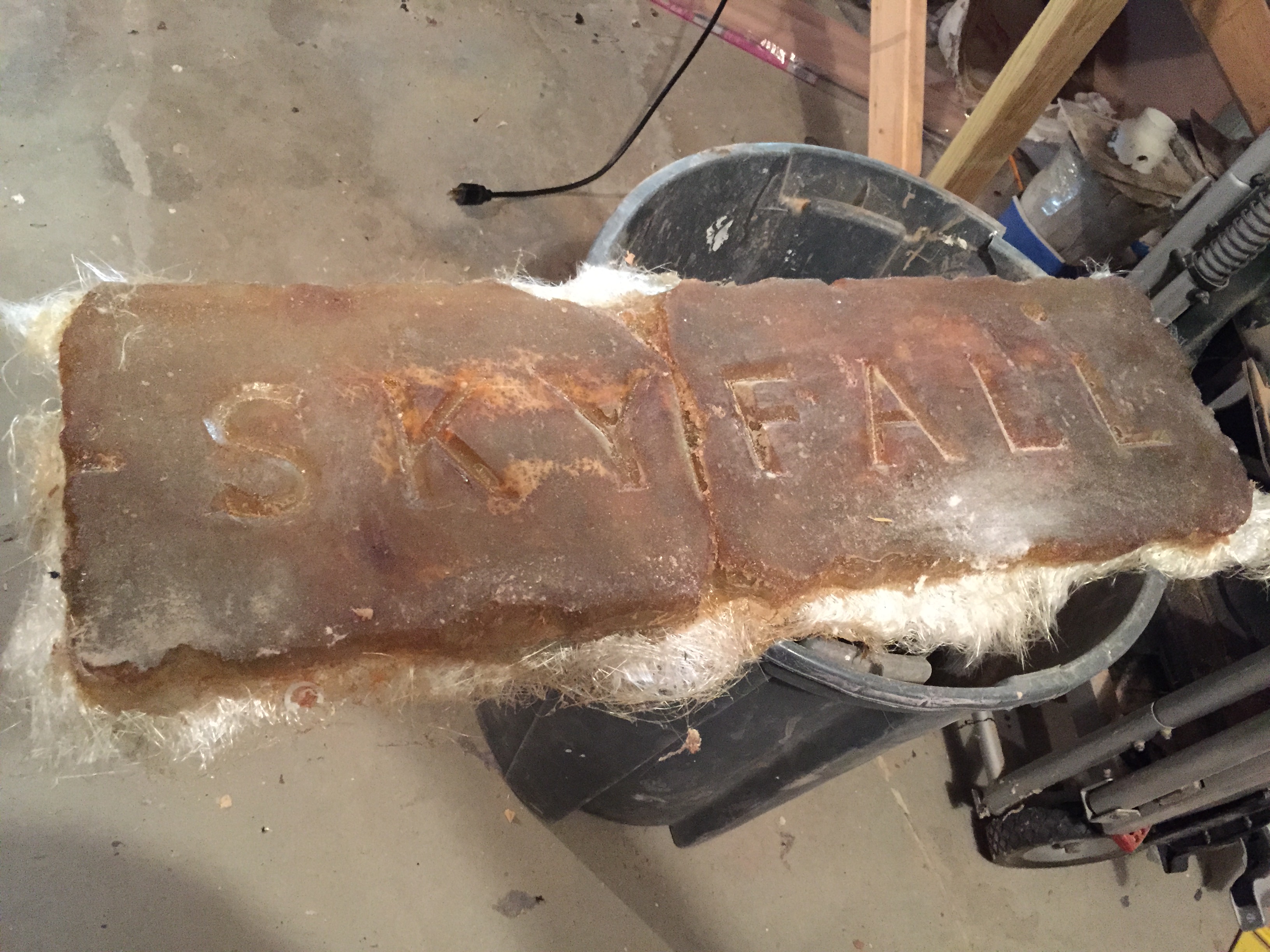

My next attempt was with fiberglas. I have a bad reaction to the smell, so I cast it outside and it just kicked so quickly that there were many pock makes and voids. It was my first attempt with this size of a fiberglas piece.

Looks Great! May I ask how you got the carving of the letters so nice-what tool did you use for the bevel?
I actually used an Xacto blade. I've been carving foam for about 20 years, so it's kind of second nature. The big thing to keep in mind is that, as soon as you feel any resistance, change the blade. Foam dulls blades very fast. Do that, and keep your blade at a good 45 and you should be good. Also, don't saw, let the blade slice. If the blade is sharp enough, it will just carve right through it. I used a paper template to let me know where the outsides of the letter were as well. Hope that helps. If you have any other questions, ask away.
