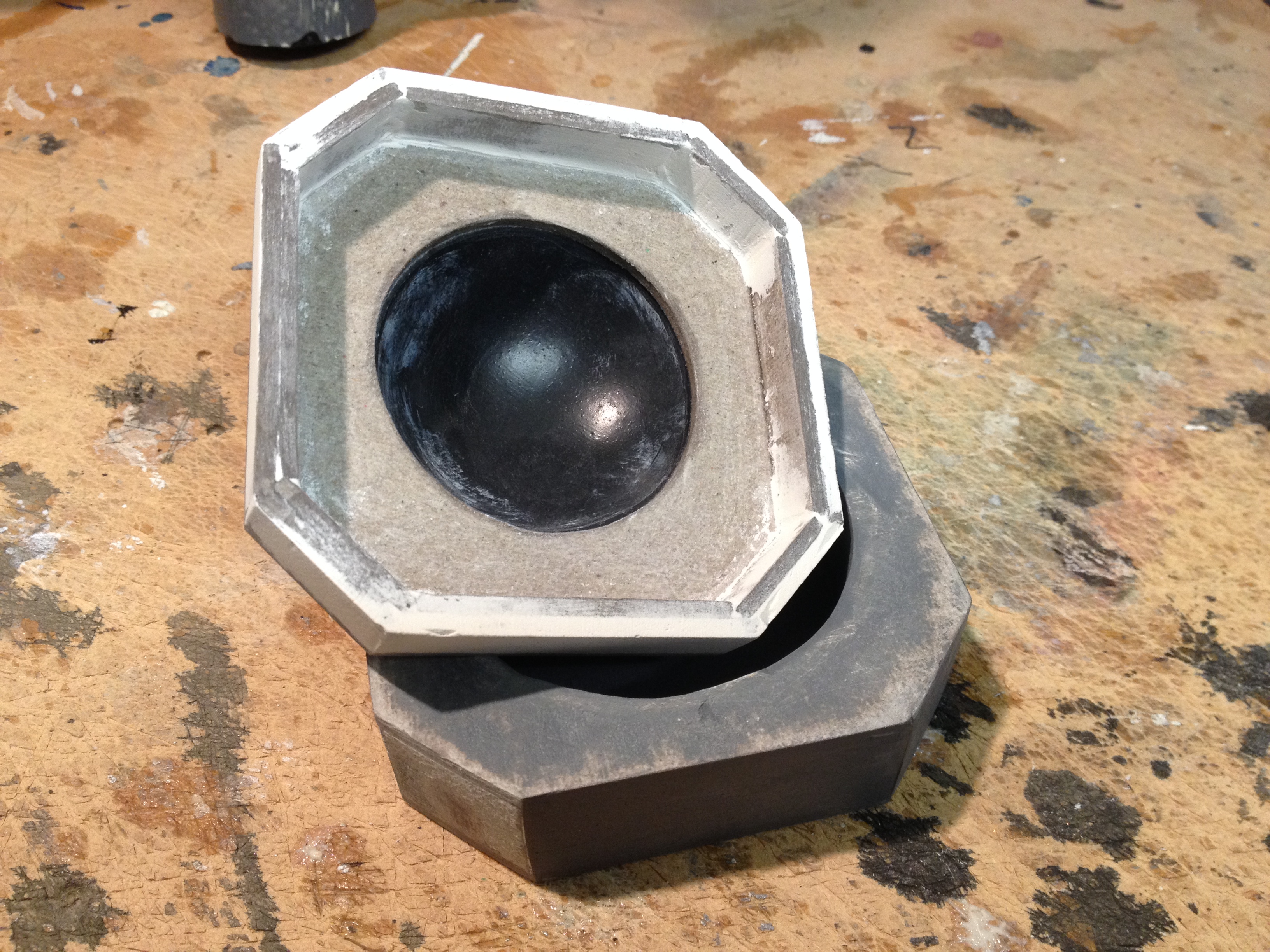

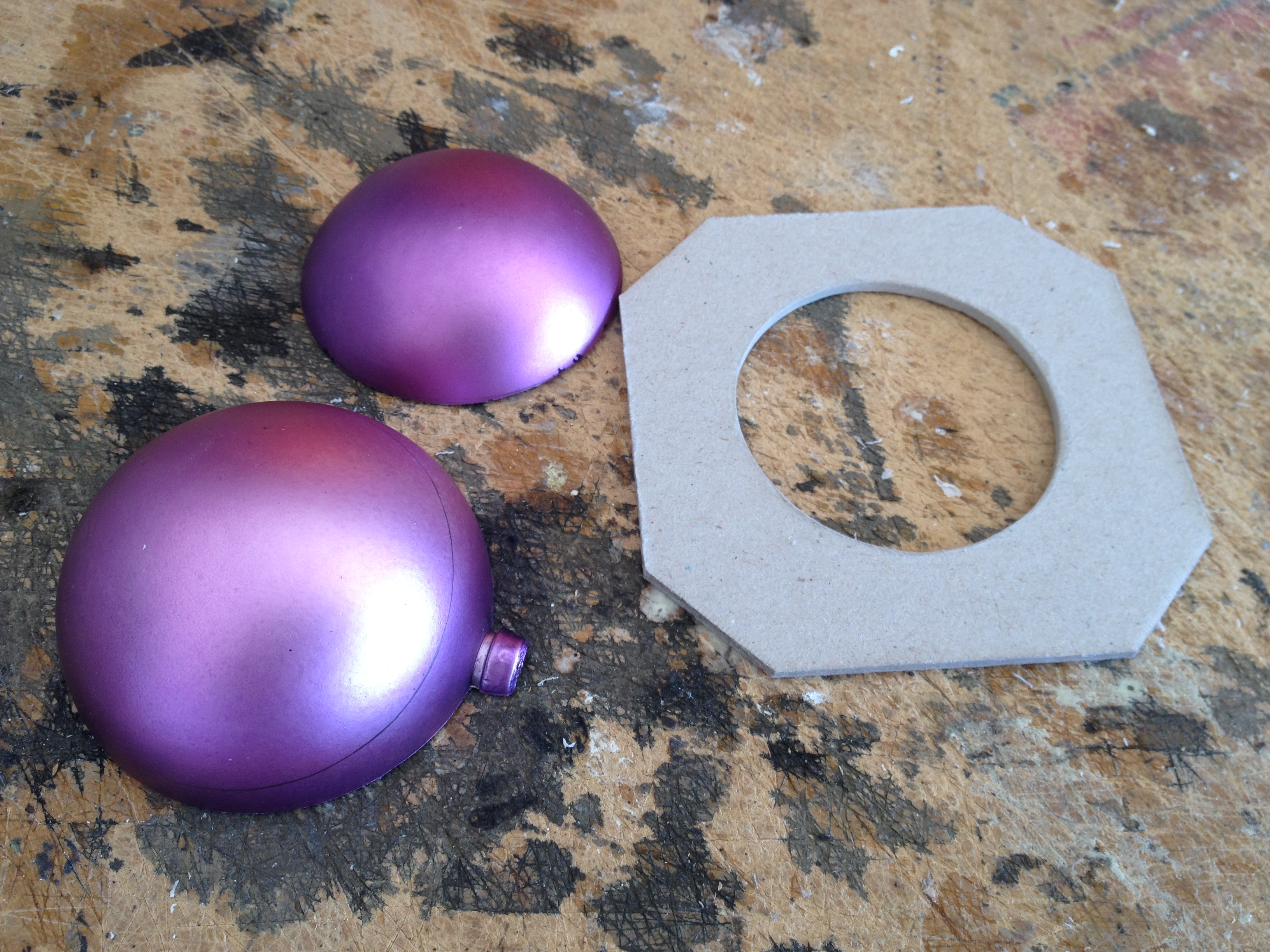

    I found some scale plans and decided to make my own.

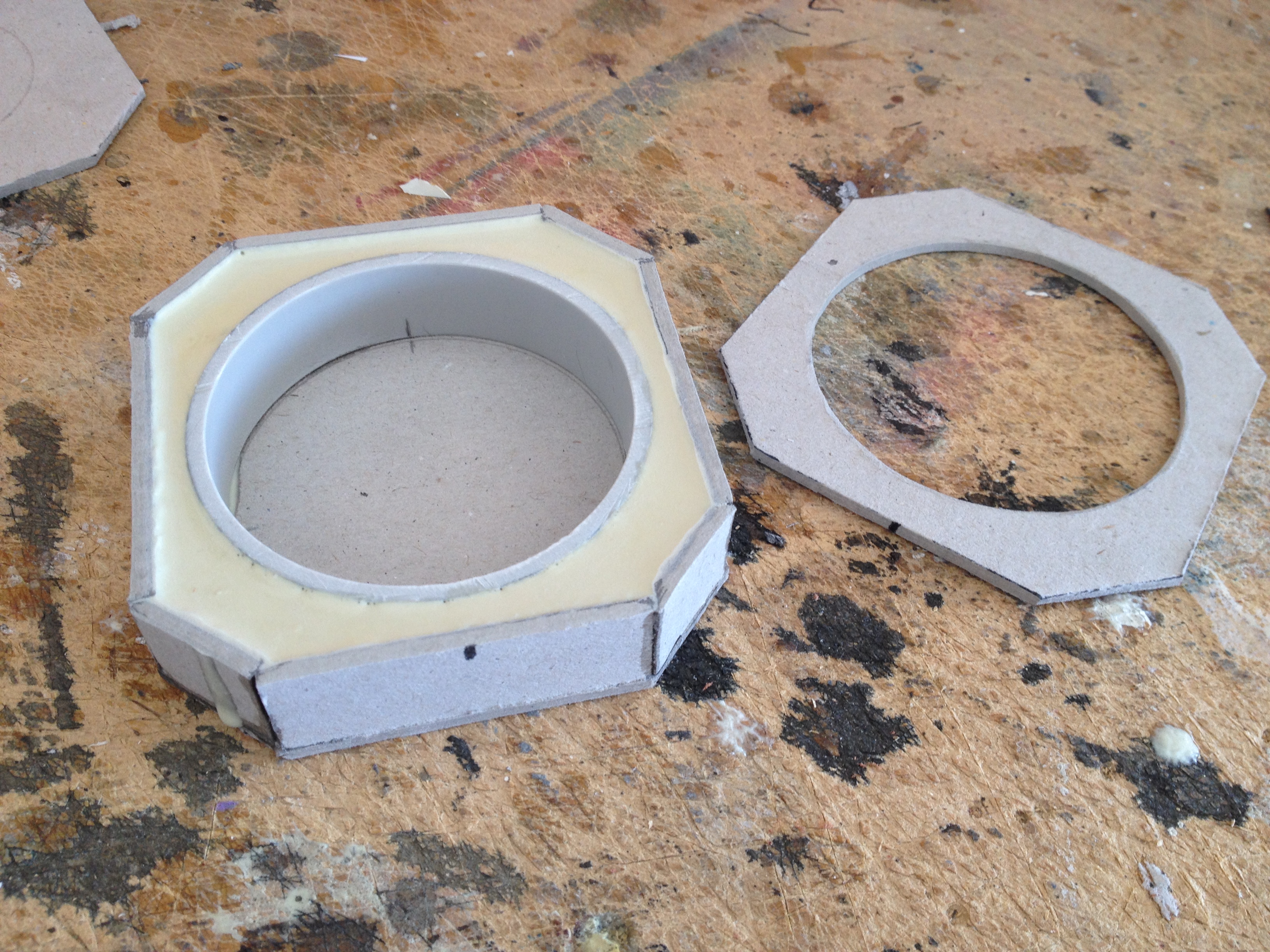

    I drew out the templates onto posterboard (compressed cardboard) and then cut them out and started assembling them.
    A piece of pvc pipe was used for the inner part of the compass, I then filled the cavity with resin to add a little weight and to give screws etc something to grip to .

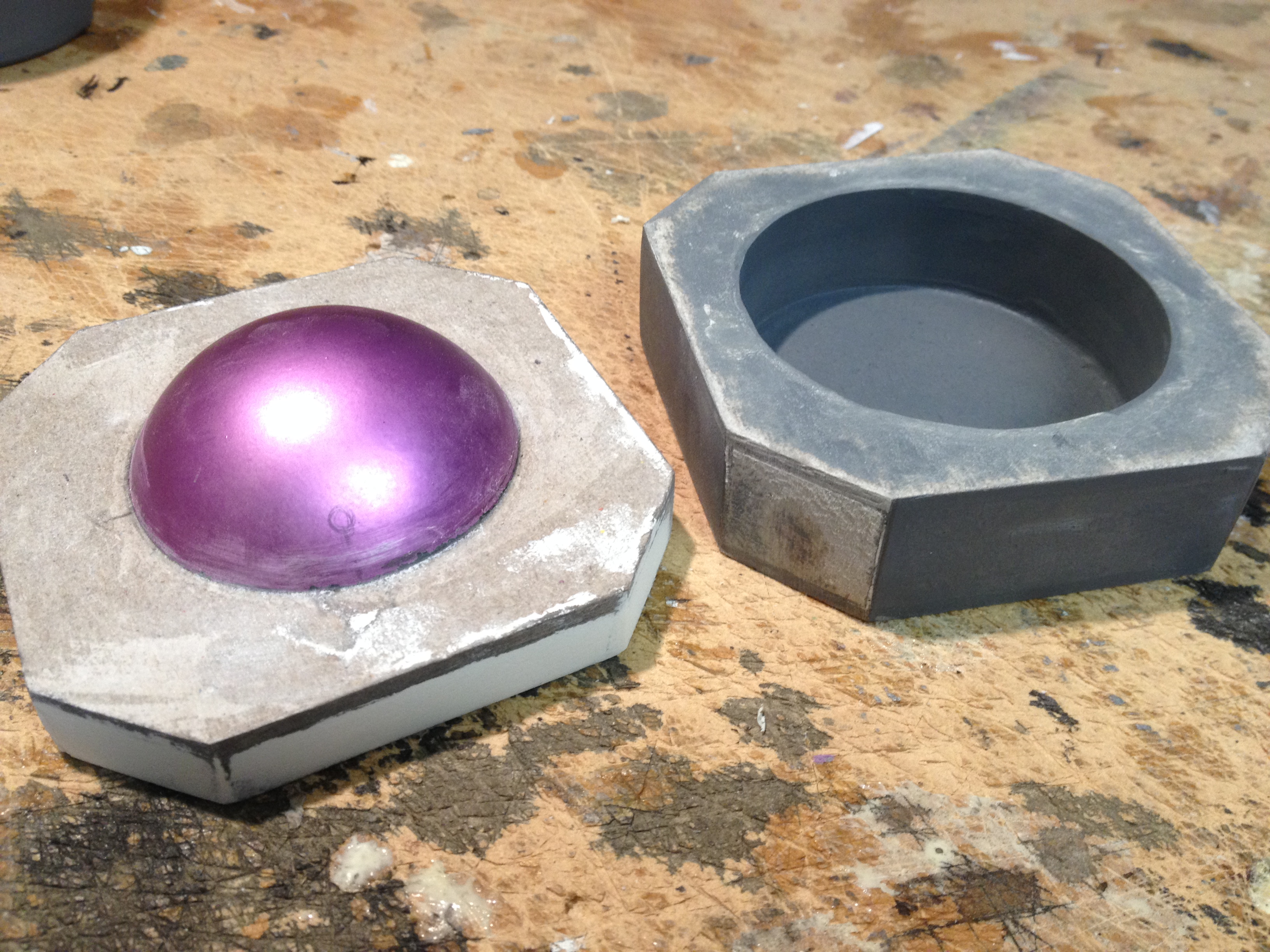

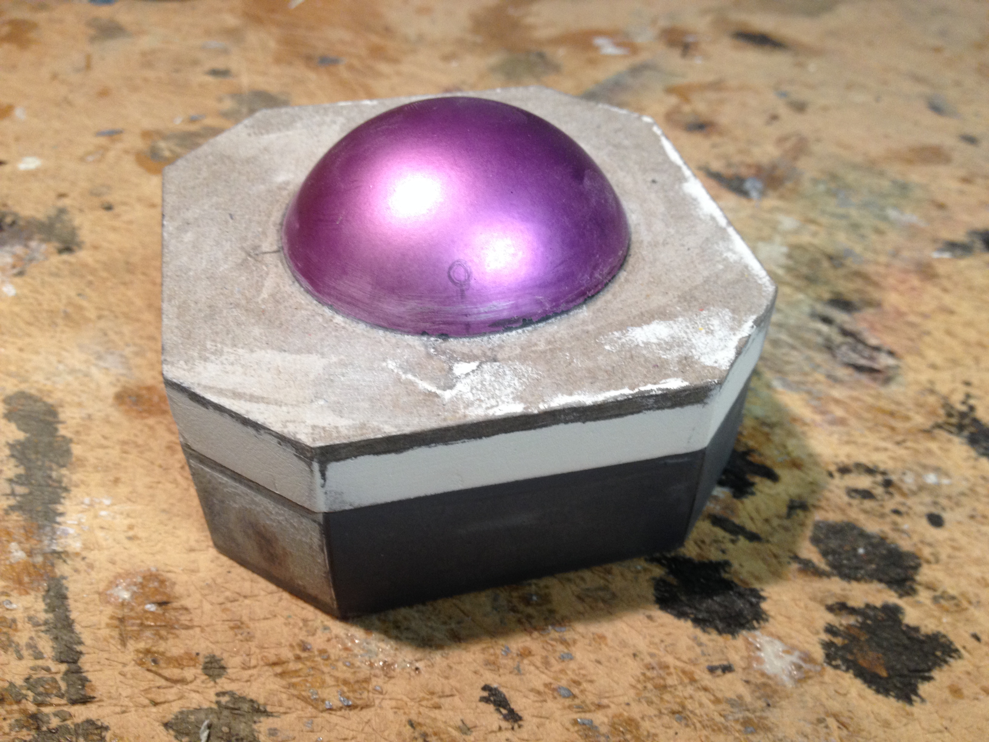

    A Christmas bauble made a good dome for the lid, this was doubled up to make it stronger.
    Stay tuned .. more to come ......................

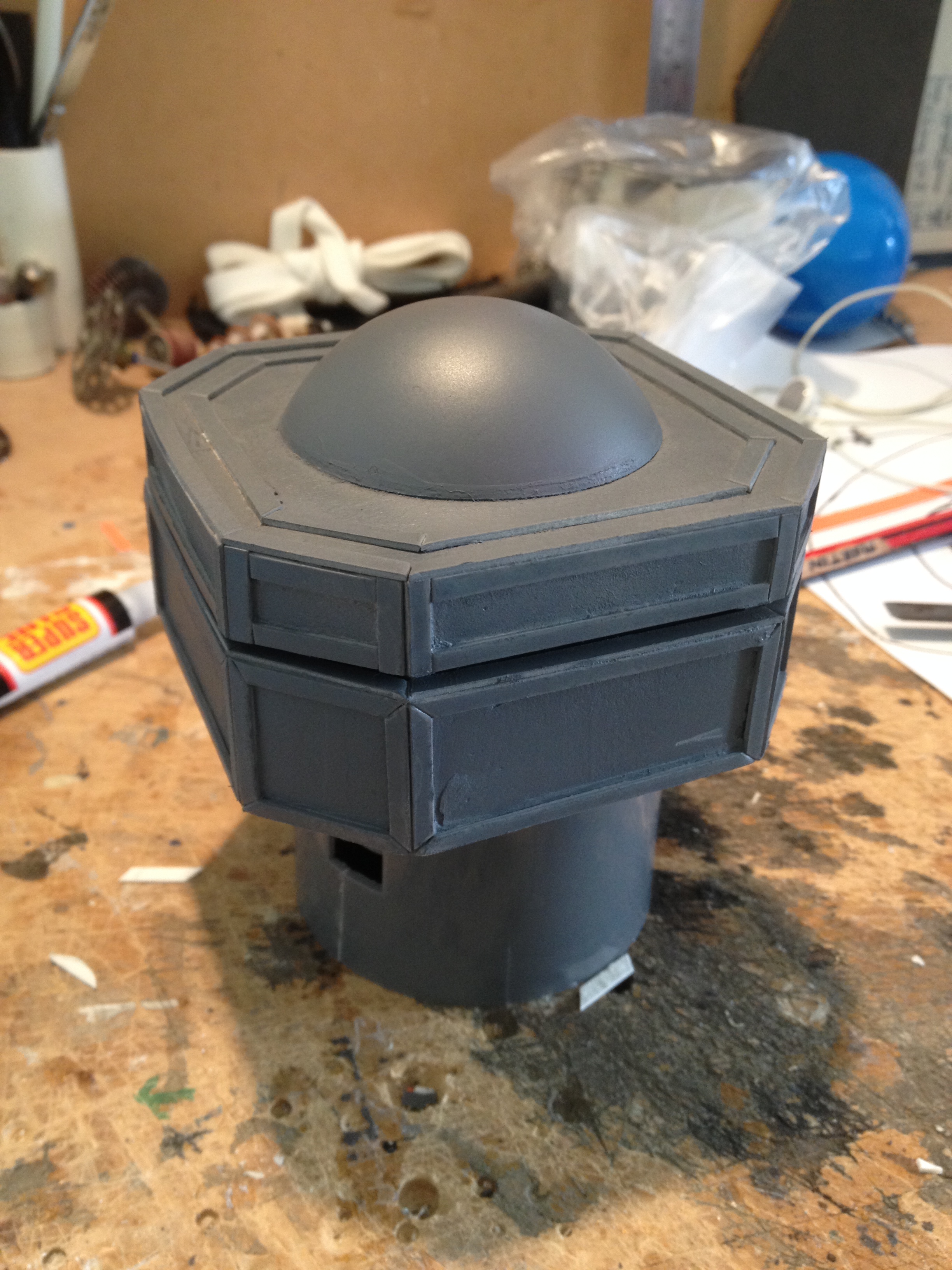

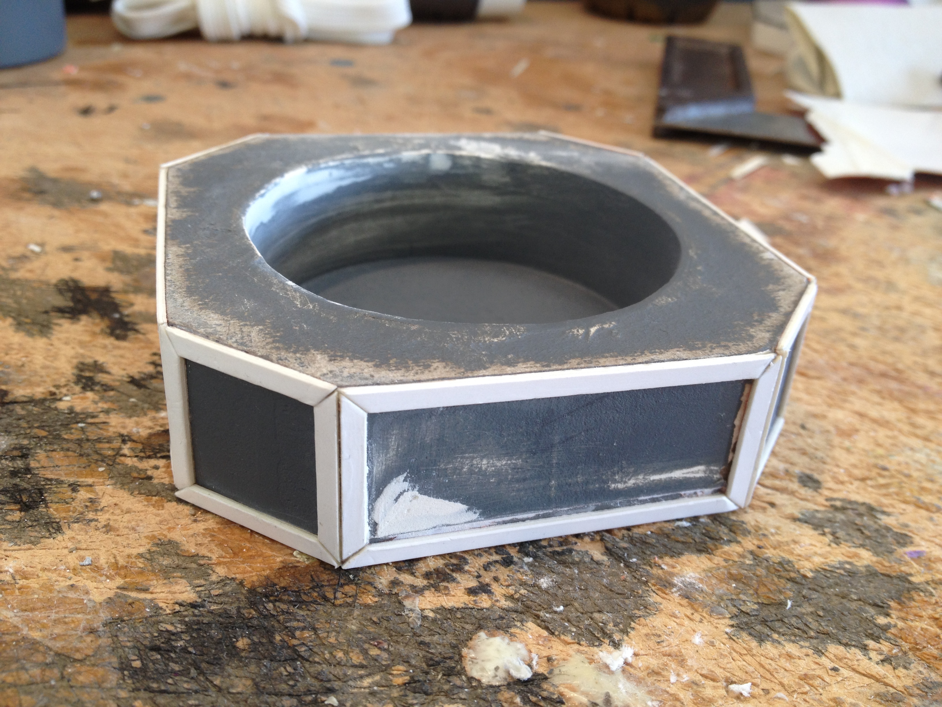

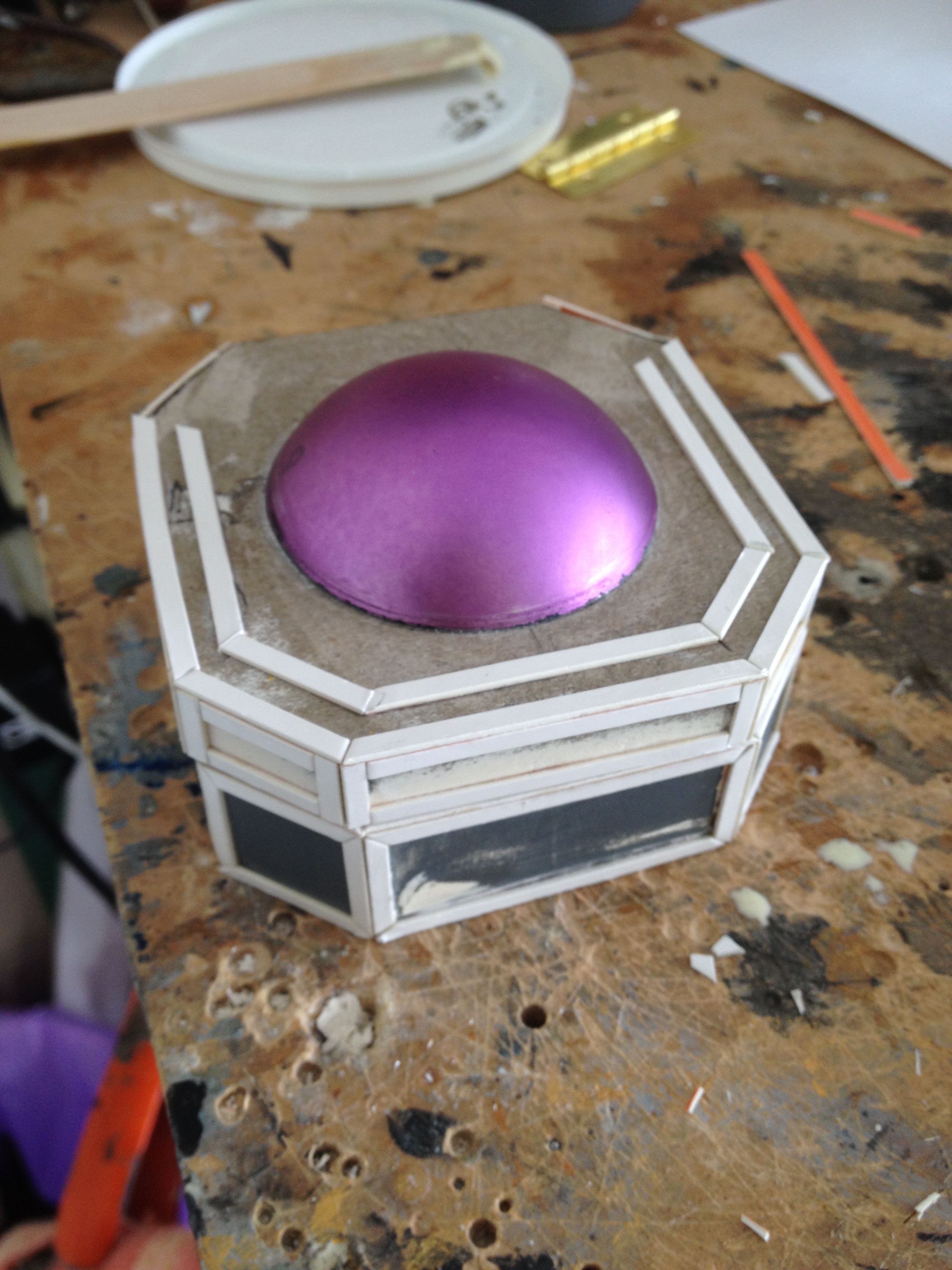

  7. crypto
    crypto Active Member
    Trophy Points:
    361
    I had forgotten all about this build until I found it in amongst some gear I was cleaning up.
    I need to get this finished before it ends up hidden on a shelf somewhere .... :p

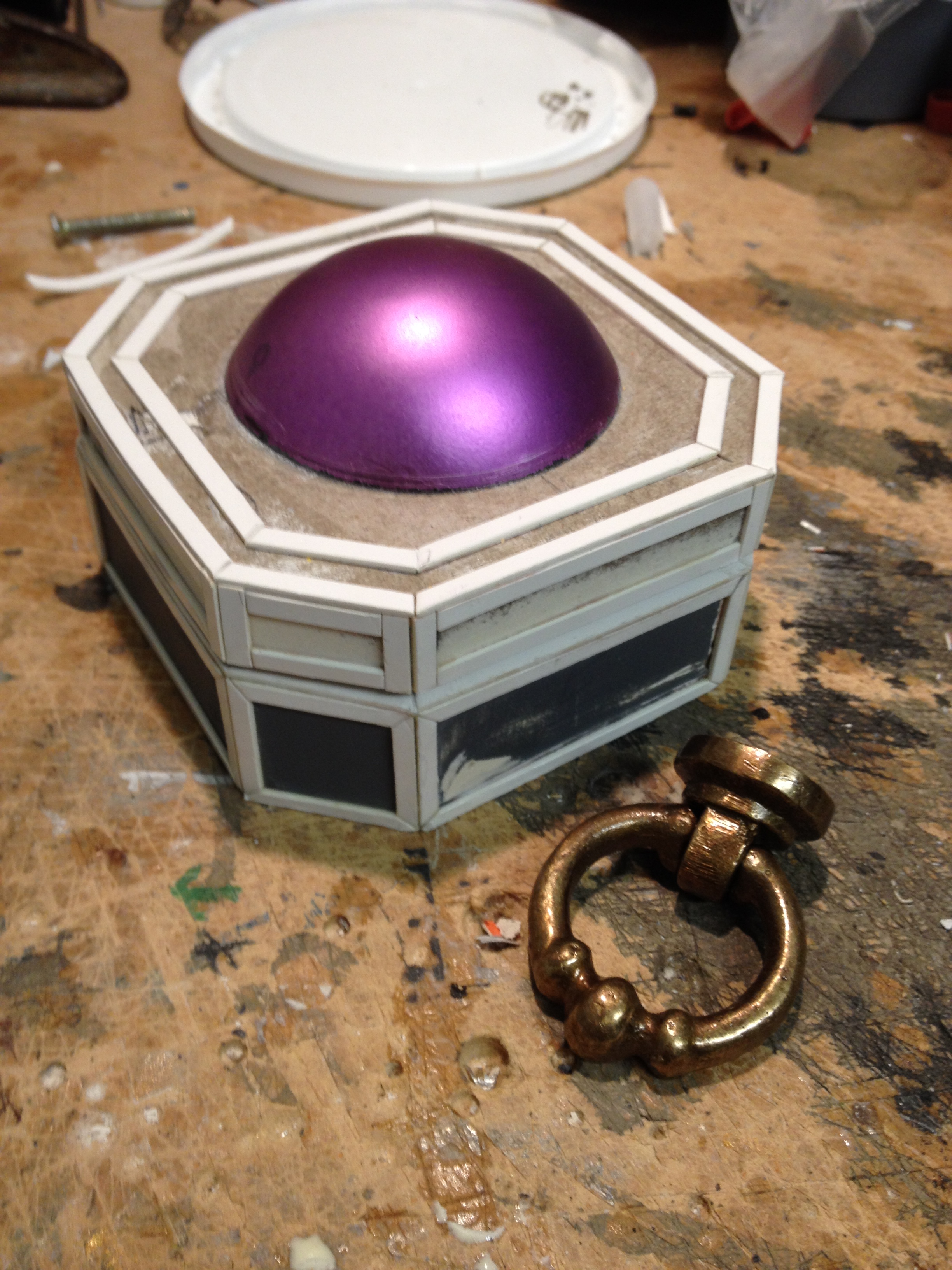

    I used 2mm card on the edges.
    Once all the edging was done the whole piece was undercoated.
    More to come ................

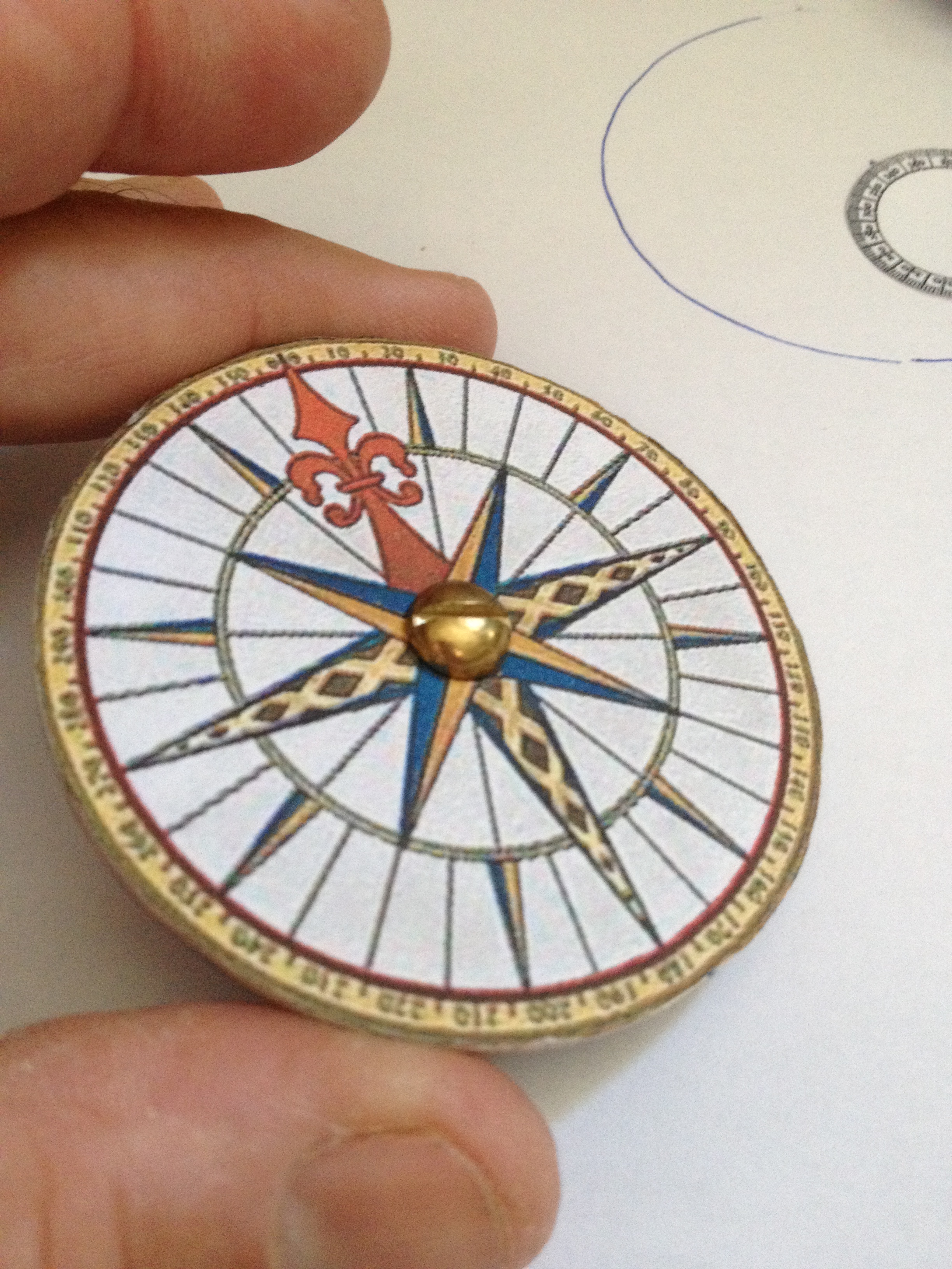

  9. crypto
    Trophy Points:
    361

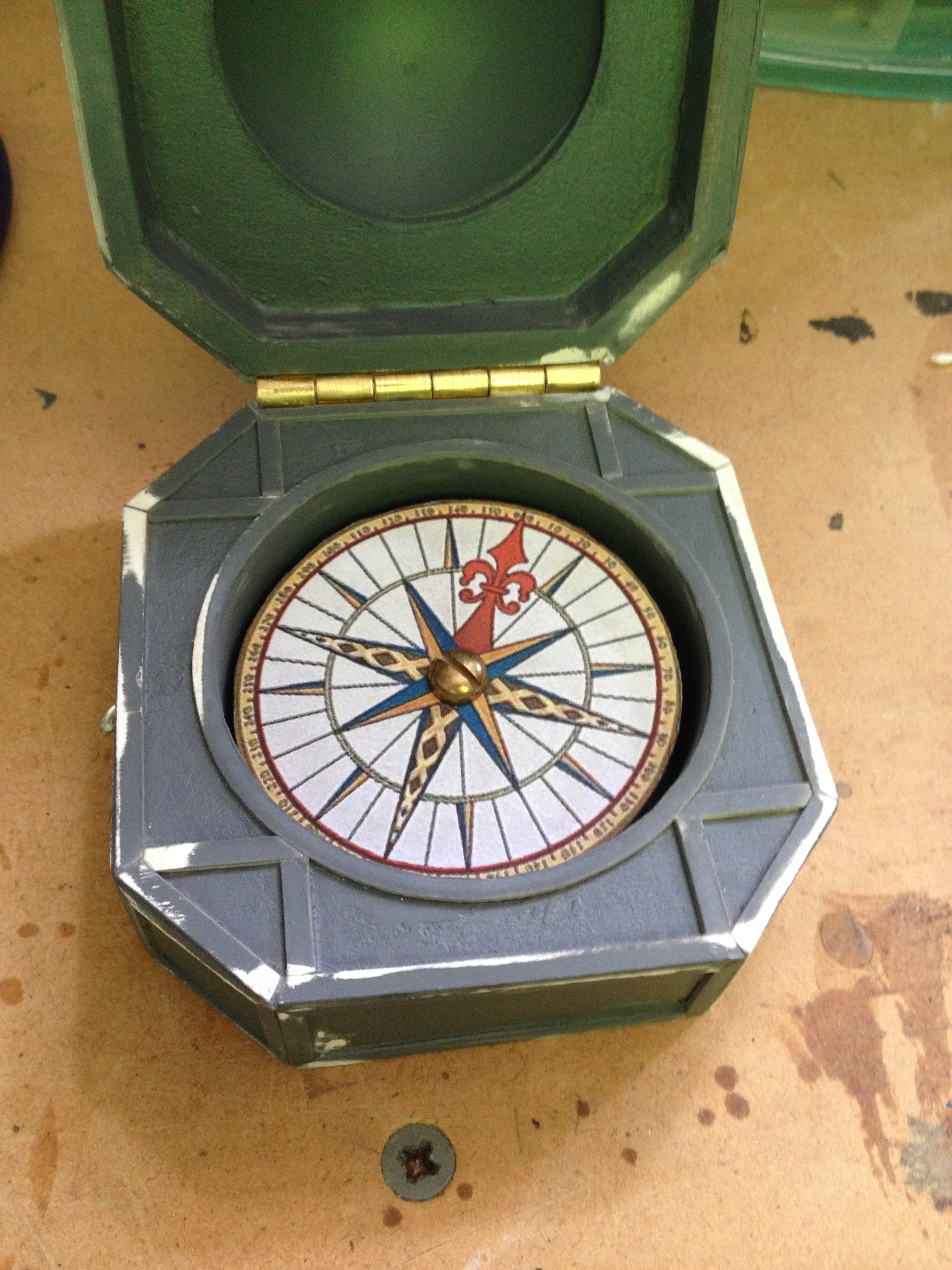

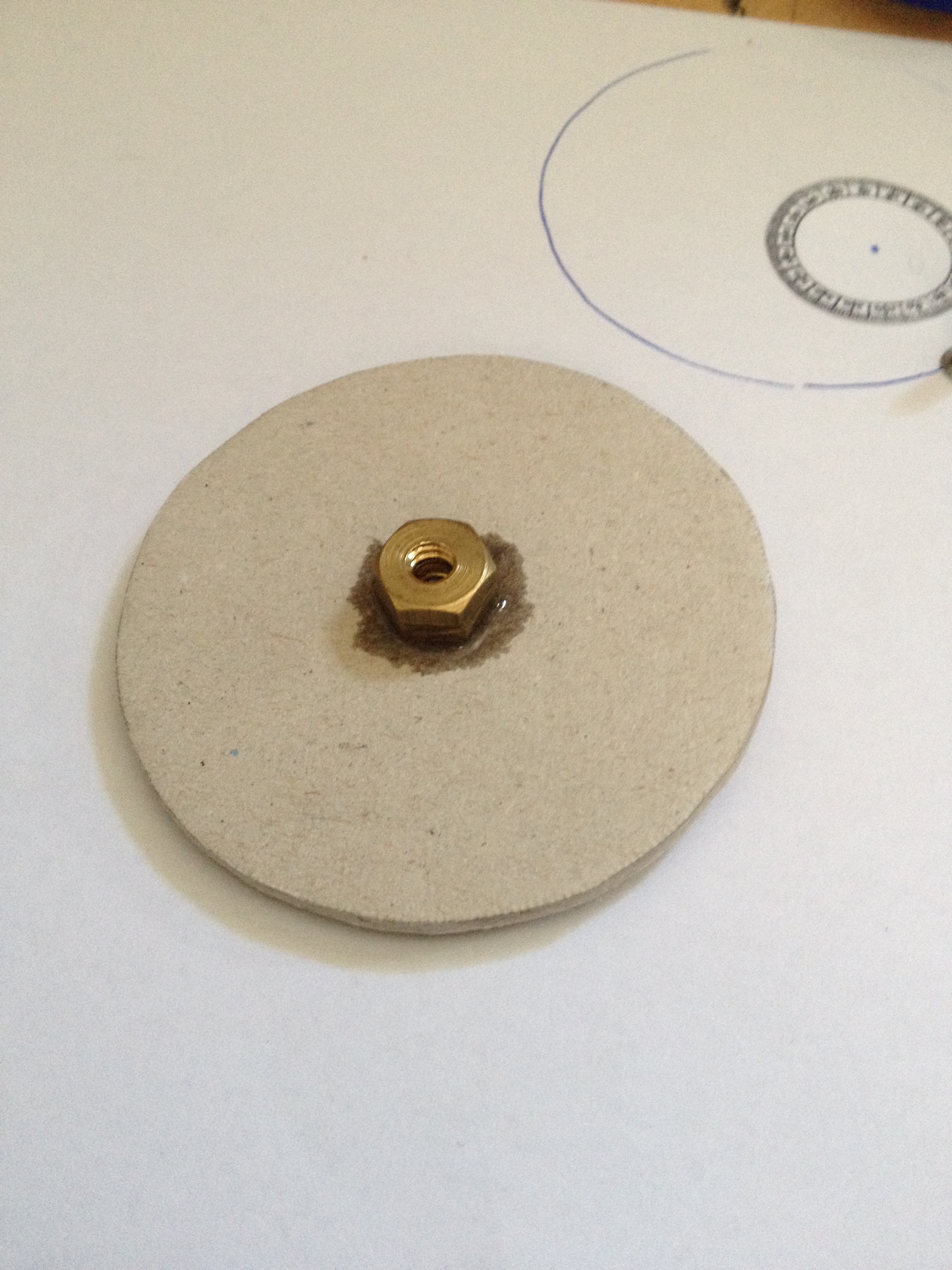

    I found a "dial face" I was happy with and printed it out and glued it to a piece a card.
    A couple of nuts added to the back allow it to sit and spin on a cut down nail that is glued into the bottom of the compass body.
    Card and plastic sprue used to make the central piece of the compass.
