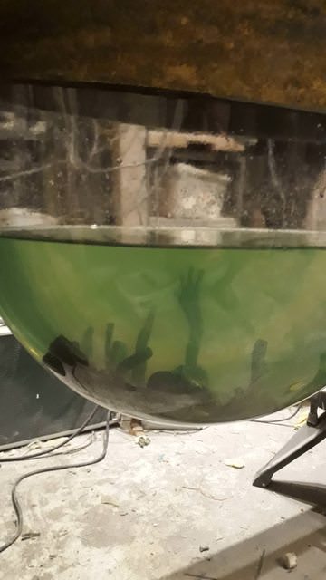

Used oil in the bottom tank in the end to give it more of a magnifying view of the frogs

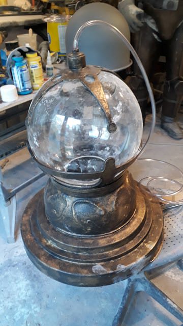

Modelled everything in Blender and 3D printed it all. It's quite big when u scale it because he's so huge.
Painted it all gold and black washed it. Inserted a metal bar with power for the humidifier running thru
View attachment 856175 View attachment 856176
Found a perspex sphere for the top tank which will have smoke and greenish liquid in

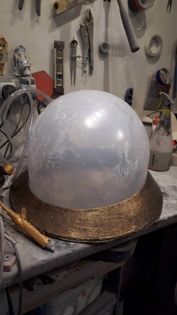

As I couldn't find an extended perspex hemisphere the right size for the bottom tank, u can see I printed a former to vac-form one
