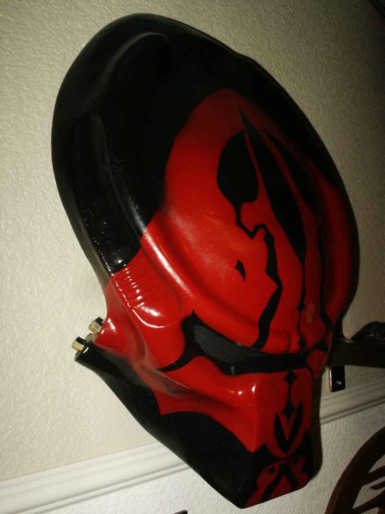

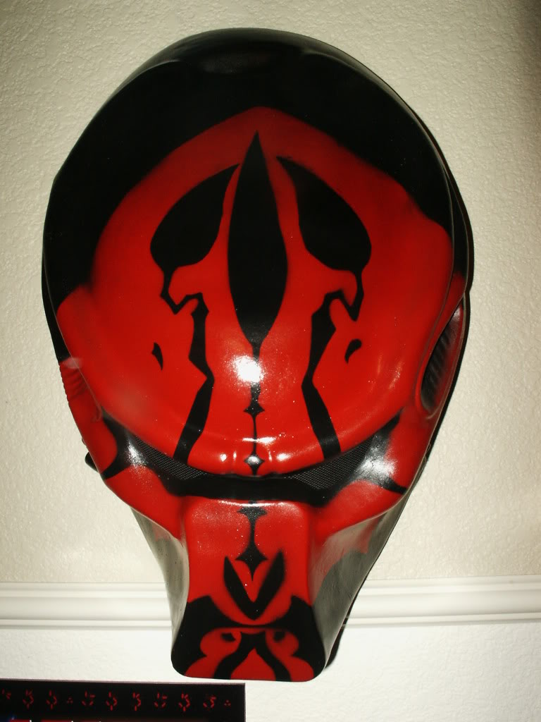

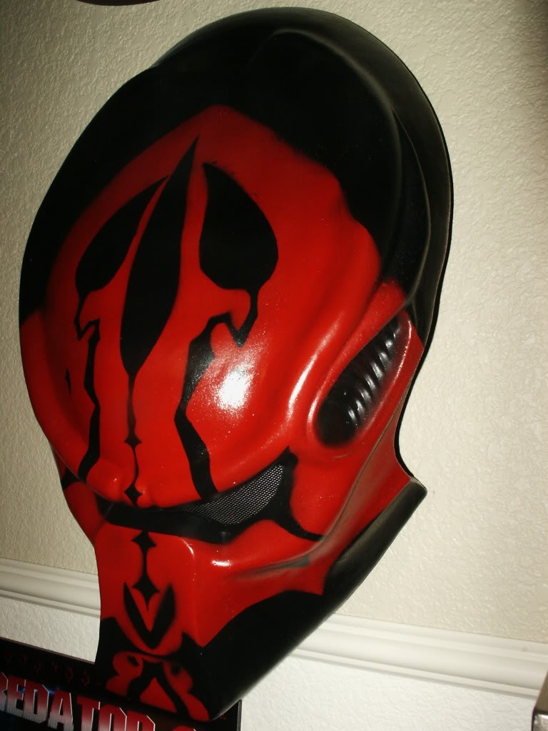

Hello fellow members,
Well I recently did a P2 bio painted up to look like the claw predator in the new AVP game,and wasn't really happy with it.So I decided to put together two of my favorite things,Predator and Star Wars.So here it is my Darth Maul inspired P2 Bio helmet.The designs were painted on using stencils that I drew up and cut out, the eye lens is wire mesh screen wrapped over black 1/16" inch plexigalss,and the hose connections are standard gas stove connectors.Oh and the final clearcoat is a mixture of one coat matte and two coats gloss.Oh question,do you guys think horns would give or take away from the helmet?
Enjoy and Thanks,Daren

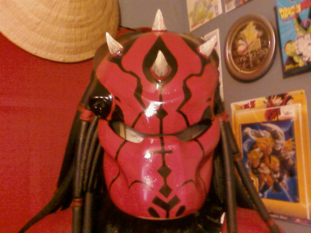

Aw, I was hoping that batmanvspredator had his P1 maul posted in his profile.
http://www.thehunterslair.com/index.php?showuser=2741
he's got his Darth Maul theme mask in it though.
I did find it in his Power Loader WIP thread
http://www.thehunterslair.com/index.php?showtopic=15832
fourth pick down in the background. I know he's got pick of it some where.
Anyway, my point is that it could still look great with horns. :D

Yours looks pretty good as well.I think I am gonna not apply the horns after all,I am liking it the way it is.
Daren

Thanks so much for the cool comments.punishing pred asked a question about how the paint looks so sleak and shiny.I will try and answer it.I first started out by sanding the bio down with 150,220, and 400 grit sandpaper.Then applied about 6 coats of opaque black,then applied about another 5-6 coats of opaque red,then finally applied the patterns using stencils that I drew up and cut out of Bristoll paper.The final clear coat is a mixture of one coat matte clear and 2 coats of gloss.I put it on semi thick,but make sure no runs appear.I then heat set it with a hair dryer on high,do this between each coat of paint.All paint used including clear coat is createx waterbase airbrush paint.
Hope that helps,Daren
