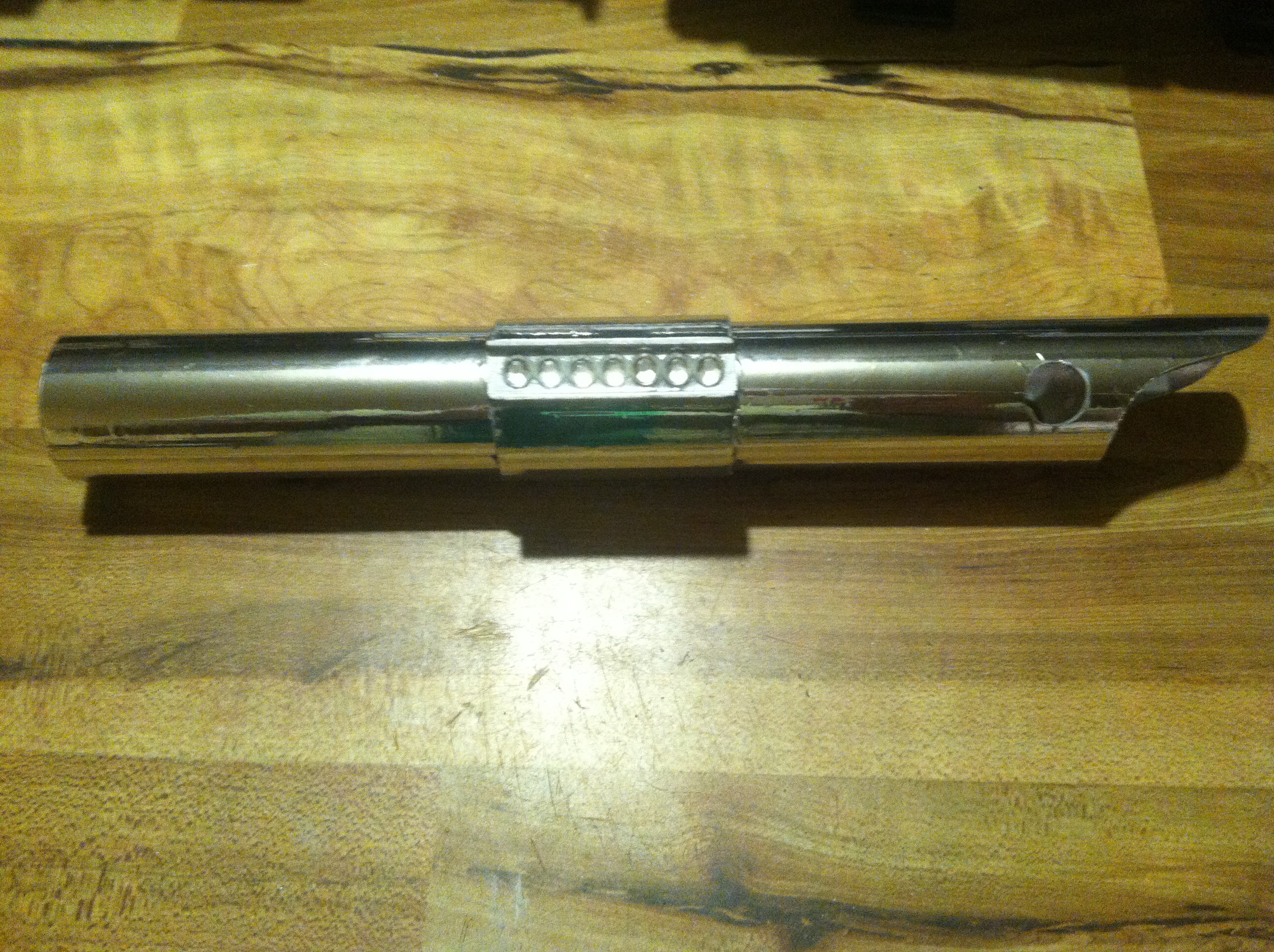

It is. The trick is to lay it down without wrinkles or getting any little particles of stuff underneath it. The saber I tested it on required one tear off and reapplication on the grip end and two on the emitter end. Either it's very difficult, or I'm just kind of bad at it :(

Thanks, that worked. My first pic post. Woo hoo! And yes, that is it.
And by the way, that pic was taken before I replaced the tape the second time on the emitter end. You can see little wrinkles and the bad cutting job I did around the recharge port hole!
Holy crap - even if this was a first attempt, I'd coat ANYTHING in this if it wasn't metal, this is awesome!
