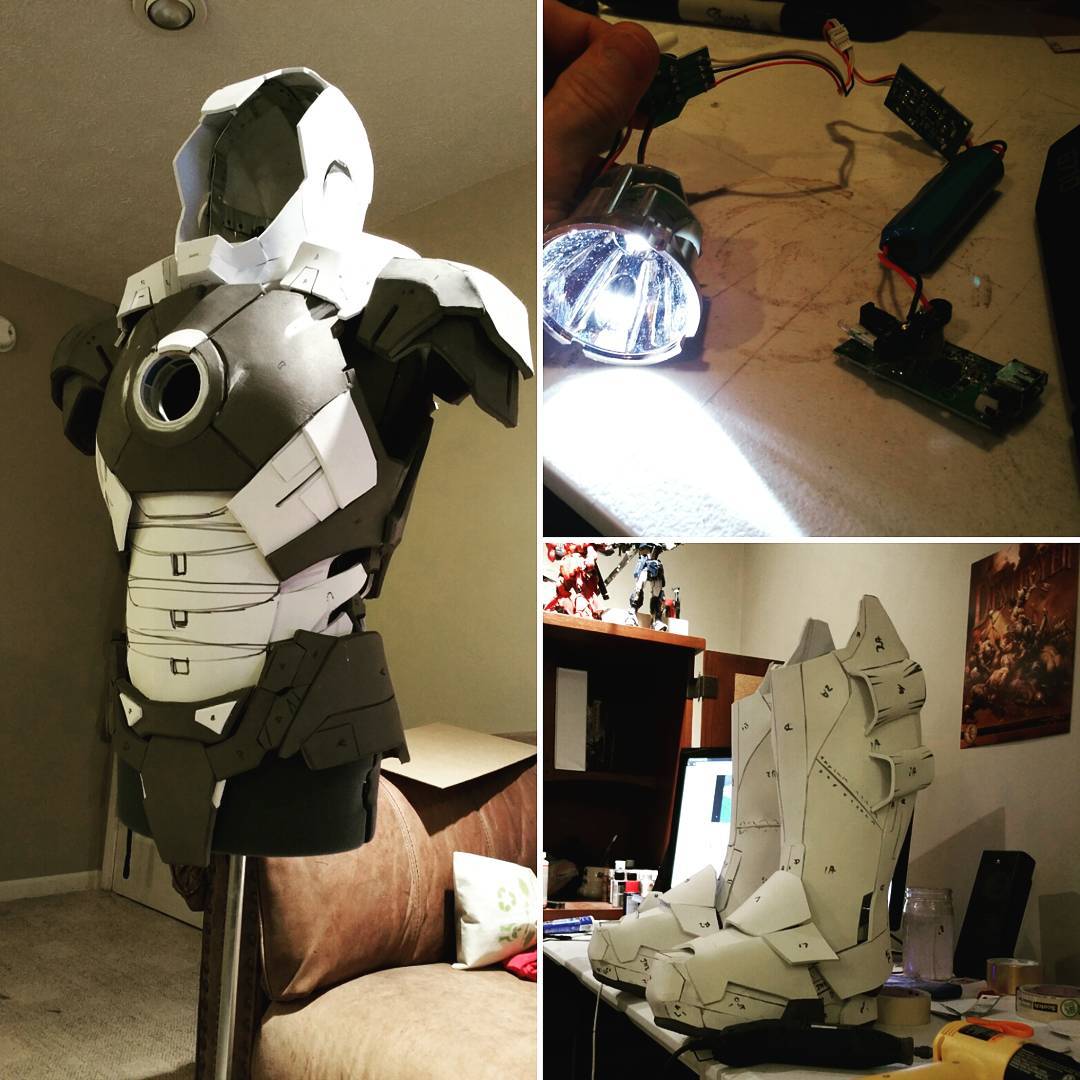

Hey Guys, I'm hella new to the forum myself, but I've been a distant admirer for a long time now. I started to get into costuming and cosplay last year around this same time, and have done two previous builds. First being Commander Shepard, and the second being Uther Lightbringer. But this isn't the get to know you section so if you wanna see those, link is in my sig. Anyway! Mark 9 Ironman is my third build and it's my first build featuring micro controllers (Arduino specifically).

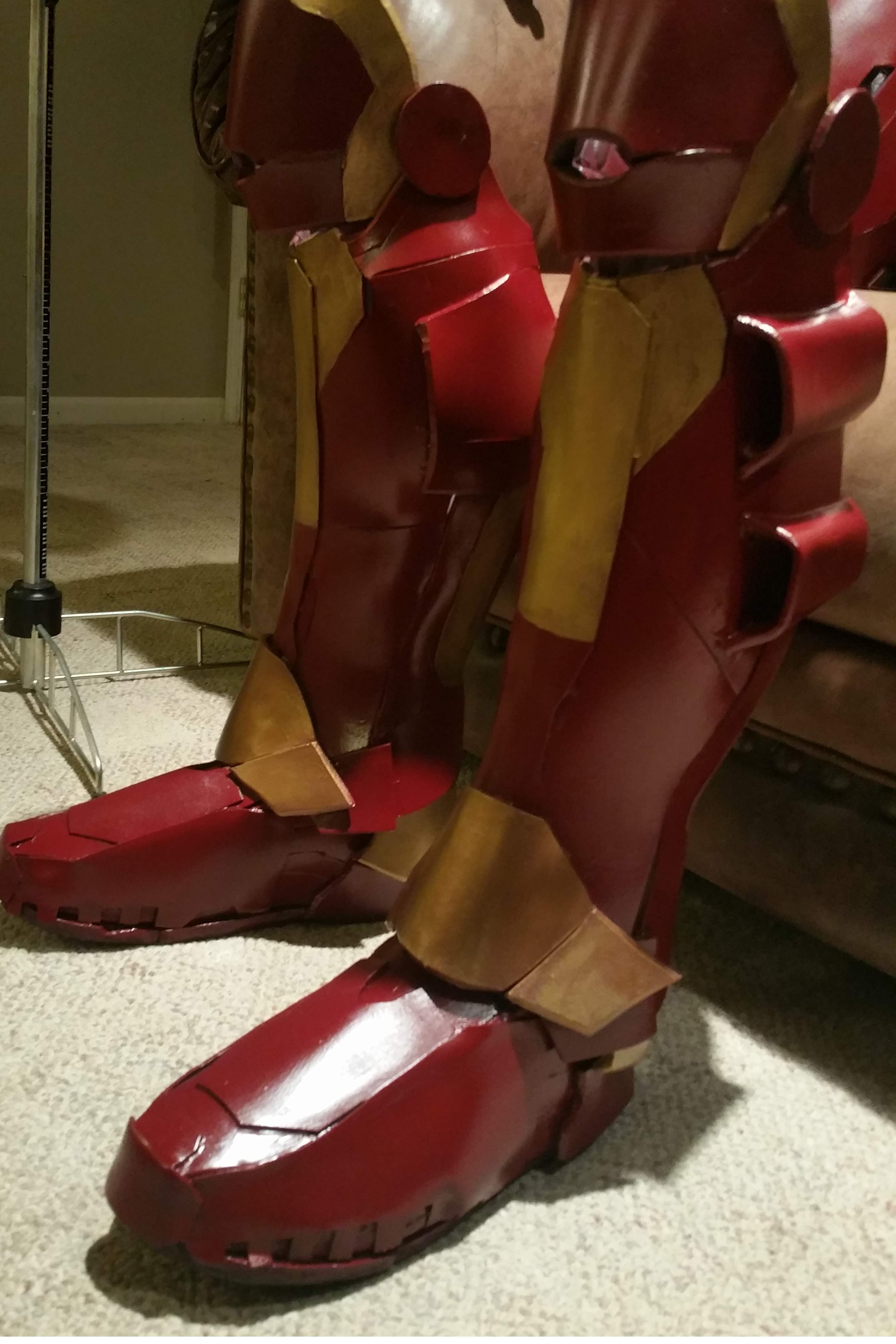

This is a WIP so I have a decent start on the suit itself. Im mixing 5mm craft foam, 1/2" floor mats, and various electrical pieces (the mess in the top right used to be a roadside emergency flashlight). The thing that makes the mark 9 stand out is the legs, which are thicker, and designed to increase Tony's flight speeds to supersonic levels.Its actually the suit the gets just absolutely dusted by Pepper in the end of Iron Man 3.

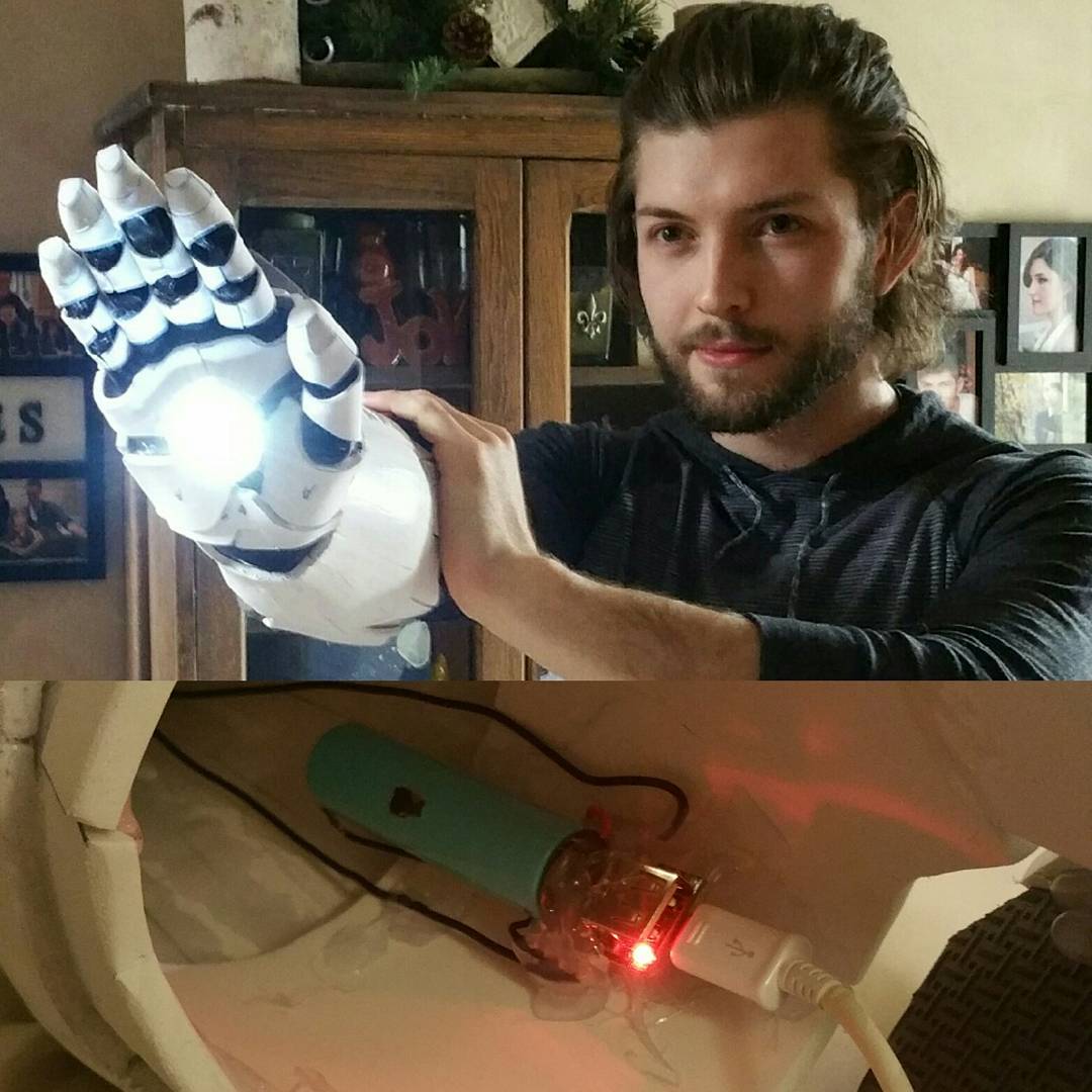

One of my favorite features of this suit is that I am utilizing several discount battery packs from the Carson's I work at, as they allow me to integrate recharge features into the gauntlets. The arc reactor is also rechargeable as the flashlight featured a power bank in the bottom, but that required a little soldering and rewiring. The repulsors are triggered by a small momentary witch embedded on the outside of my index finger knuckle so it is easily pressed with my thumb, and at the same time, easy on the power consumption.
The above video shows the arc reactor in action. I went with a small momentary switch that toggles on and off like the top of a pen. The suit fits well enough that by flexing my back and pressing my arms into my sides, I get a very Unibeam-esque effect when turning the light on.

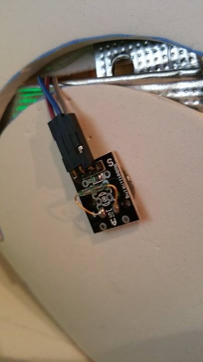

This last video shows the eventual circuit once I finish the faceplate. A reed switch in the ear pod will react to a small magnet embedded into the finger of my glove, and that operates in a binary switch, with the on off case calling different sets of functions in my arduino code. So thats about it for my first post. I know its very text and pic/video heavy but I wanted to try and lay everything out in one go. Shall keep you guys updated! Cheers mates.

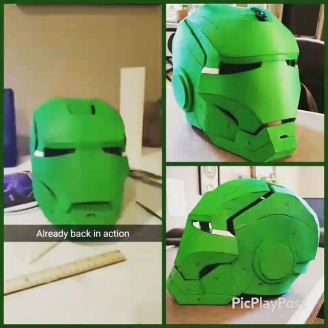

We now have motion! And Lights! one of the leds in the right eye is delayed but I switched the signal pin over and it works fine now. I need to layer thin strips of 2mm foam to create a light barrier to keep the mouth from lighting with the eyes.

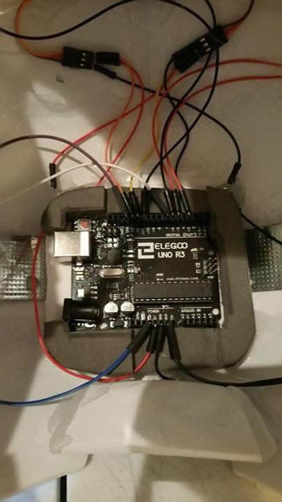

First of all, praise be for rechargeable 5v battery banks. I plan on mounting this one in the rear of the helmet on the top of the foam guard I built for the arduino board here:
I also want to manufacture a cover out of 5 mm white foam and thin velcro strips to keep my hair/sweat off the electronics.
The reed switch that triggers the open/close function is mounted to the right ear (cause Im right handed), and I will have to engineer an ear cup to fit around it and still allow for me to trigger the unit via magnet. All that is left here is to do some organization of cabling, adding padding and trim, and then we move into full boar Bondo/KwikSeal.

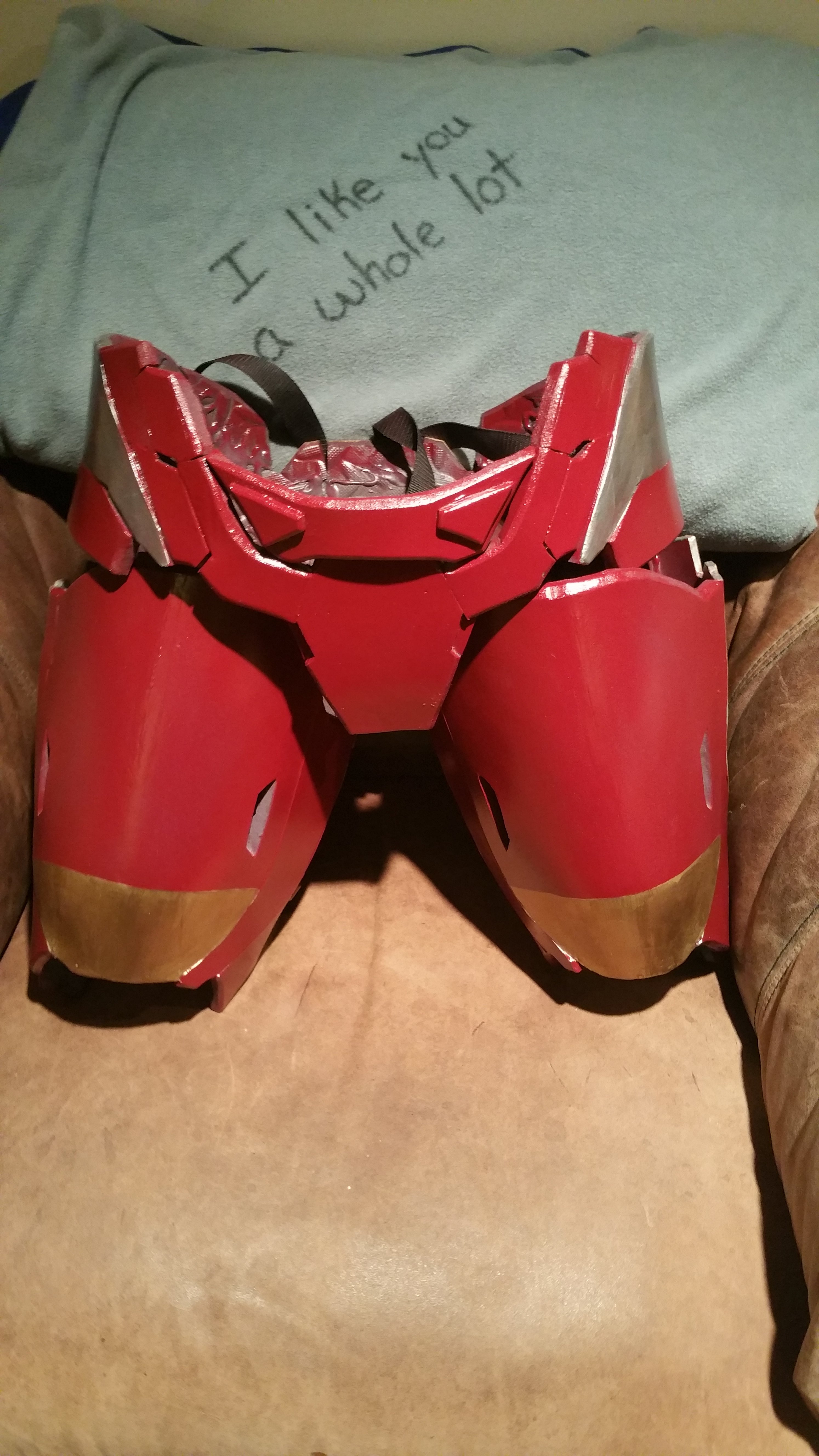

Everything all lined up and getting ready for paint. I did three coats of basic rustoleum primer, and then three coats of rustoleum satin claret wine red. After that I went in with acrylics and painted the golds and silvers. Which brings us tooooo

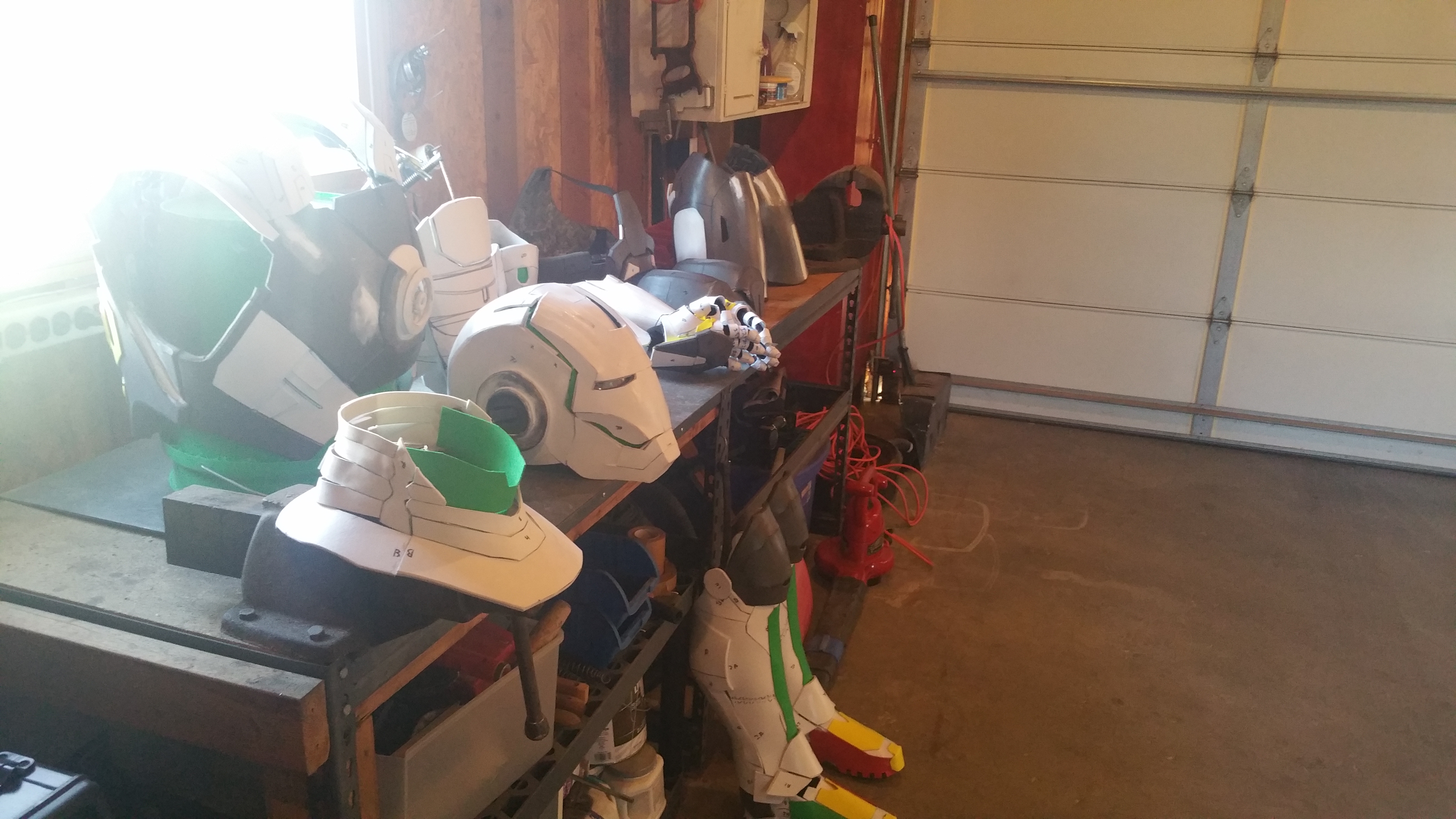

All the major colors lined up, Im really happy with how it looked at this point. The change from raw material to painted is just amazing. It really turns into the product you envisioned. Sadly, its right after this that tragedy struck... The original helmet had a servo die, and an led in the eye burn out. Unfortunately, the nature of the wiring I did prevented me from making any alterations, so a new helmet had to be whipped up from scratch.
This is the new design, with a thinner ear cuff, and a modular wiring system so I can still detach all the components individually, in case of emergency. ;)

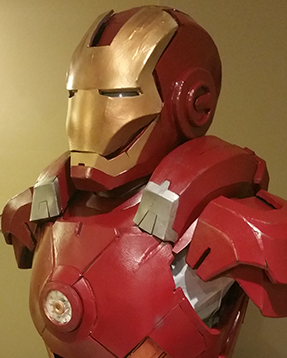

After many more days of painting, weathering, and adjusting straps/buckles, I did a first test fit. And boy, did I love it...
The shades were a recent purchase, as I find it only fitting. I will be wearing the helmet at the convention but only sparingly, as I am rather terrified of the electronics breaking before the costume contest they are holding this year. All the more work it needs is gold paint in the finger joints, and some dark red dye for the under-suit. If i find the time, ill also add gold to the elbow and knees so it looks true to the reference.
