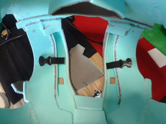

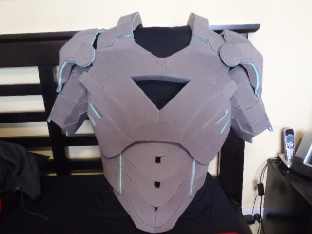

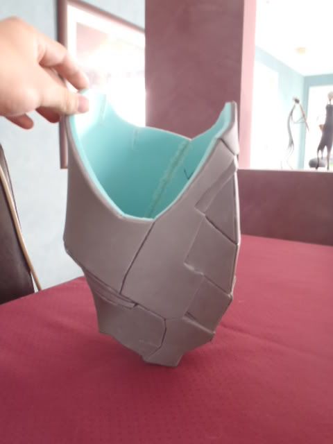

I have finished the arms!

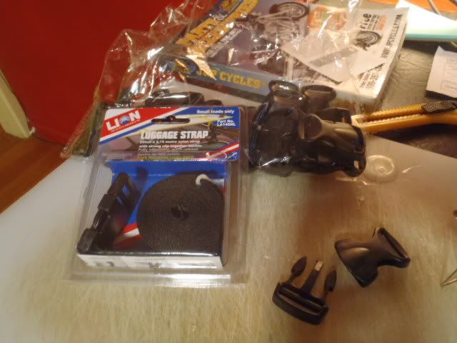

For those in Australia, I bought my strapping/ webbing from Bunnings Warehouse. You can buy it off of eBay but it was too expensive and they only sold HUGE lengths of it. I bought a 'Luggage Strap' for about $6. It also came with a clip! I bought all my plastic clips off of eBay eBay Australia: Buy new & used fashion, electronics & home d 24 for $14.
I then followed Stealths tutorial on youtube for connecting all the pieces. TUTORIAL - "SUIT UP!" How to Connect Foam Armor Costume Parts - YouTube
The shoulders and arms
Chest piece, side.
Chest piece, shoulder connections.
All connected!

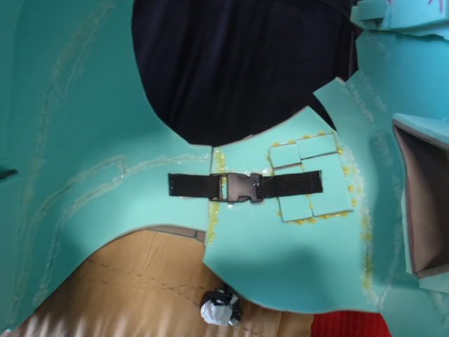

Looking good mate! What did you use to attach the straps to the inside of the foam? Doesn't look like hot glue. Also, what was the width of that Bunnings strapping out of curiosity? Have you decided on a painting method yet?
P4r: Thanks mate! I used hot glue! haha The strap is 25mm in width (1 inch). I'll be using IndieFilmGeeks method for painting

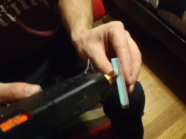

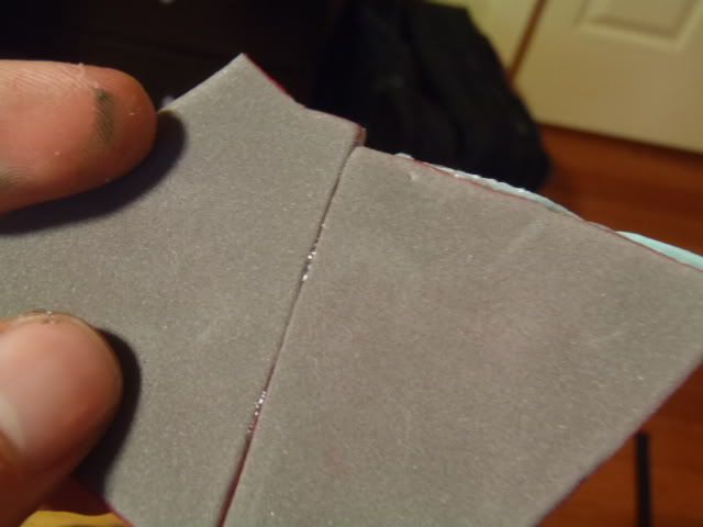

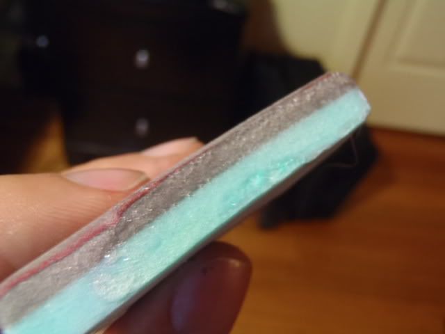

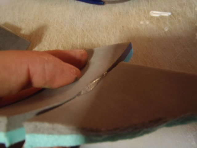

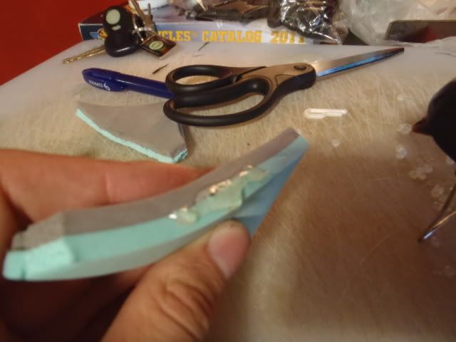

I cut all my foam out with scissors and I use a blade for the fiddly bits.

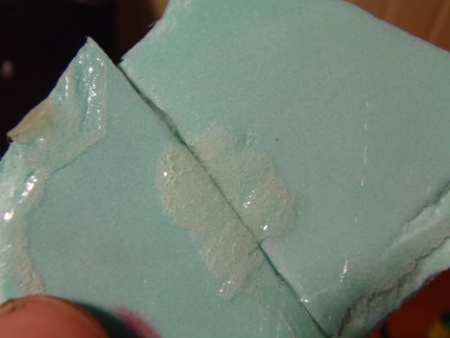

My gluing technique
No technique
You just splurge the glue onto once piece
Put it against another and it squirts out the sides :/

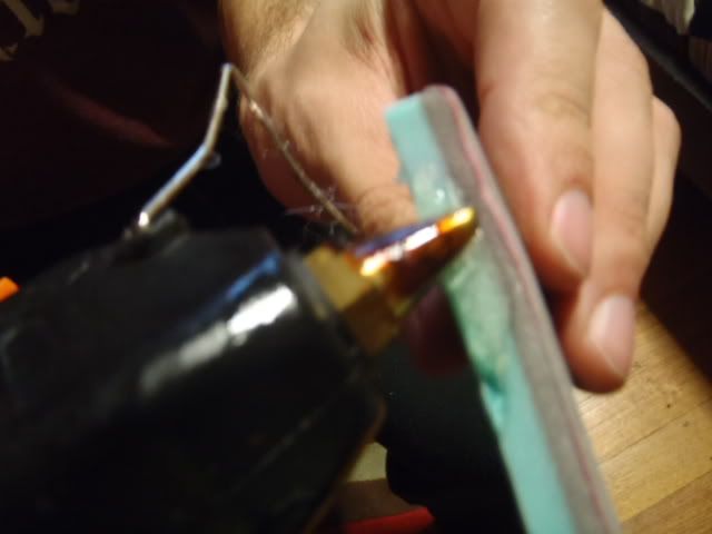

My technique
I thinly run the glue along the side of the foam
I then FLATTEN it out with the side of the hot glue gun.
When the pieces come together, no over squirt.
I then reinforce the pieces by sealing it behind with glue.
Oh yeah, that was some weird glue stick I bough from Dick Smith, don't know why they came out yellow...
