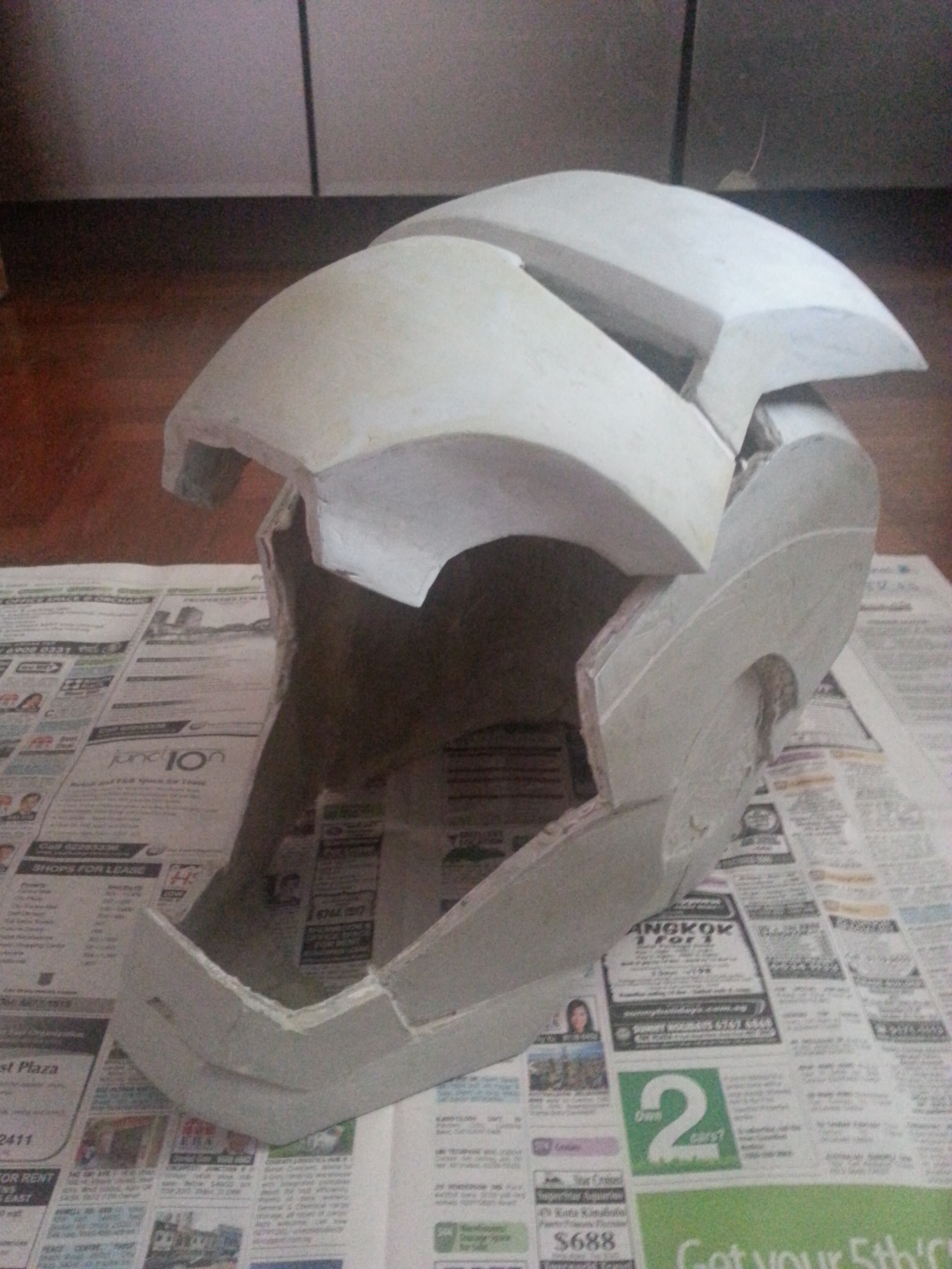

So, I know I'm a bit slow, but finally got around to making a Full Resin/Body Filler Suit.
Constructive feedback would be great. So here we go! I'm at the Body Filler Stage, skipping or showing very little of the Pepakura Cardstock stages. Don't know about you guys, always feel that the helmet gets warped in one way or another during the resin stage..

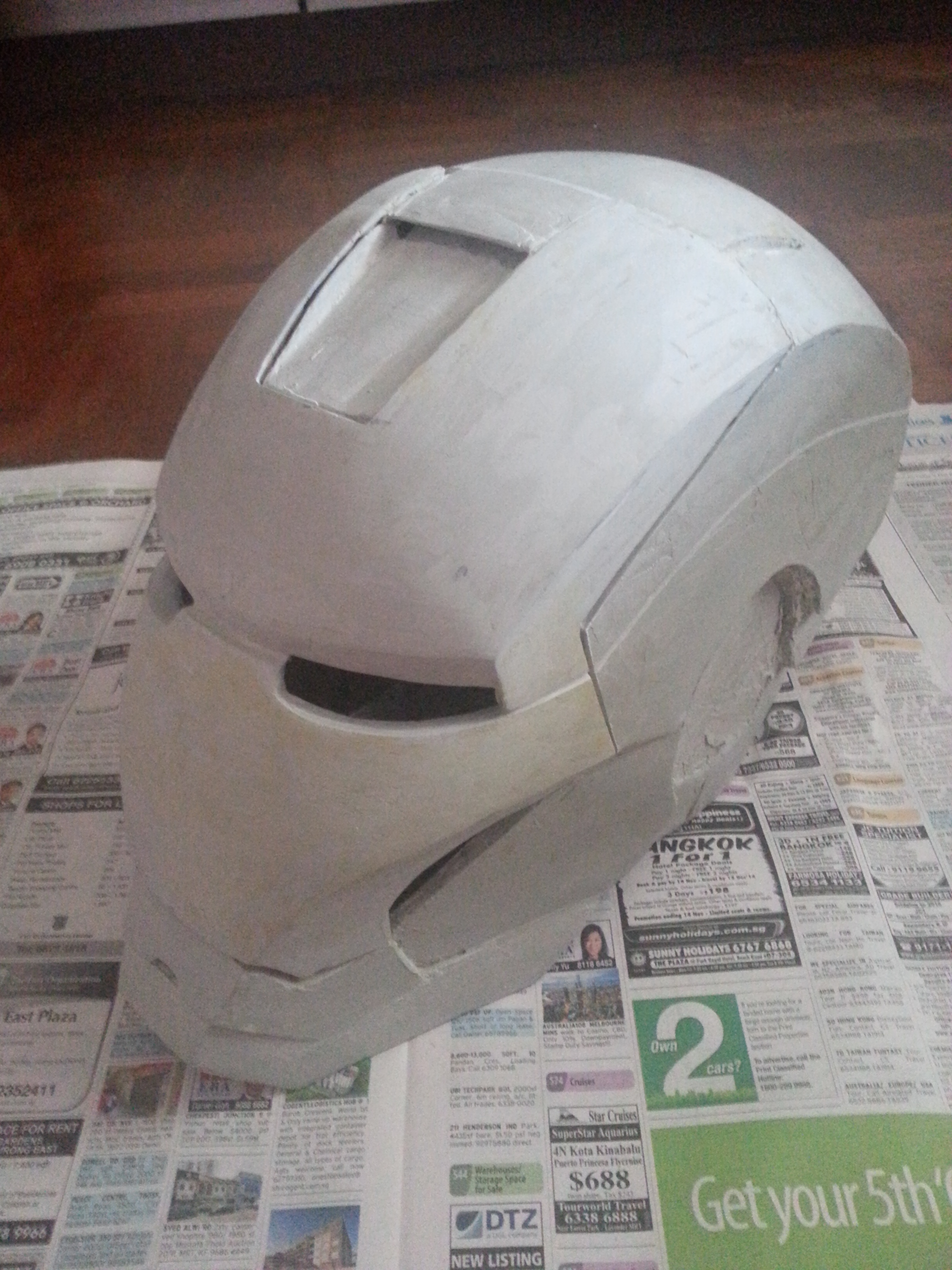

20141112_102140.jpg I have a love hate relationship with sanding... I hate it... But I love it (Quoting Tony Horton from P90X):facepalm
20141112_102150.jpgTook 3 hours to cut the faceplate out with a dremel tool20141112_102230.jpg "Roar... More sanding Sir!!!"
20141112_141057.jpgThose you work with bodyfiller know.... BodyFill, Sand, BodyFill, Sand... OMG.... You can see the uneven surface at the back..
20141112_141112.jpg Imperfect Seams... Really got to praise Members like ProjectEarth7, how did you do it?! Let me guess... Bodyfill, sand, rinse and repeat....:(
Dude, that is looking SHARP. And yup, you got it right, skim,sand,repeat until you think you're done, and then another few passes. :lol
I shoot a thin coat of cheap sandable primer on after each sanding pass, helps to highlight the areas that still need work. Keep going!

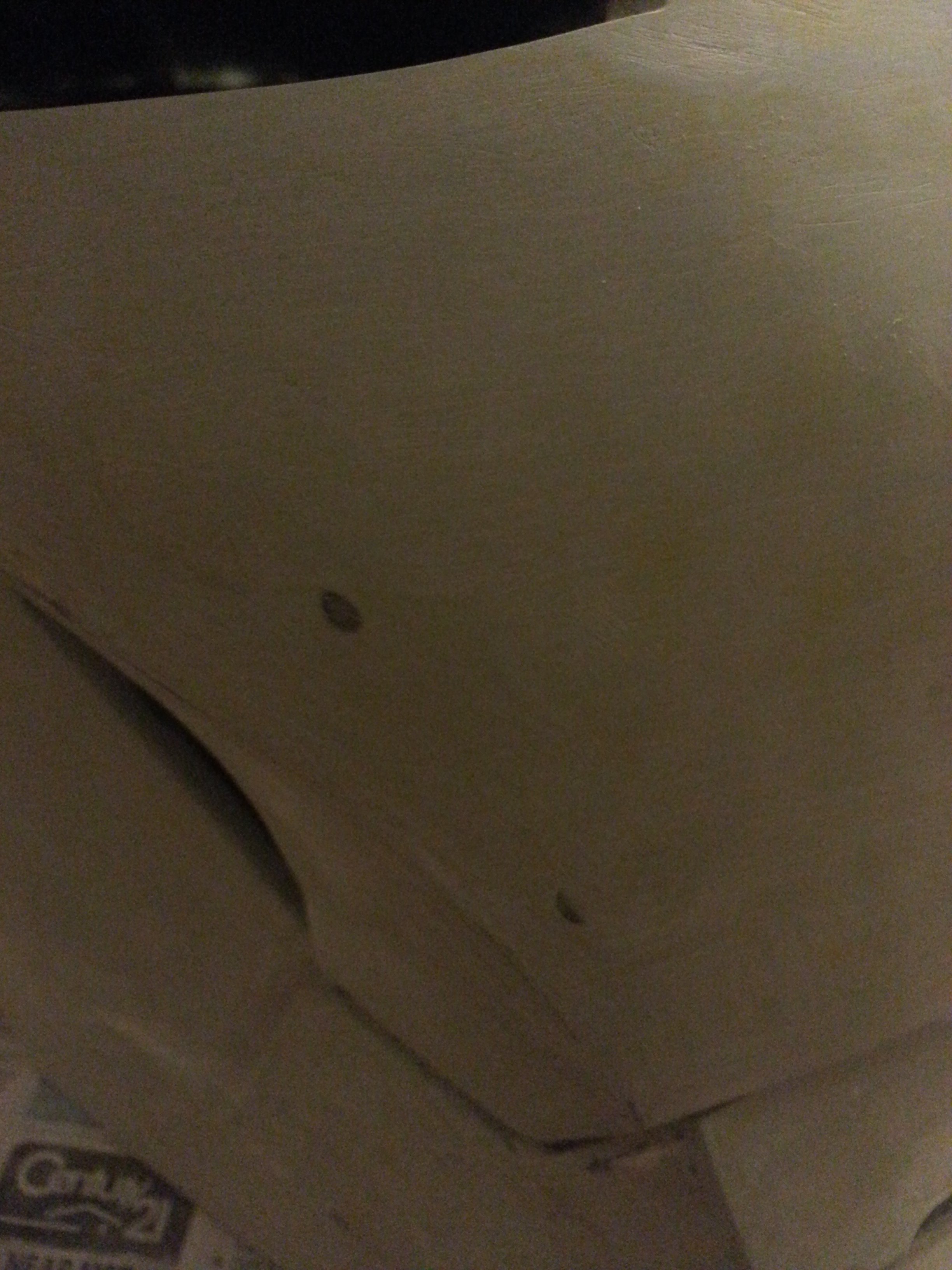

But I would really like to know, what happens if you can't sand it perfect... What I do is use 180 > 220 > 400 > 1000 Grit Sandpaper, but somehow since I have to reapply body filler (using a thin as a coat as I can) and then sand again... I seem to go back to square one :angry
And here at the bottom pictures, You can see that I will sand as gently as I can... But i keep on almost hitting back onto the base of the pepakura resin cardstock.. Its super annoying.
Anyone Got any suggestions or pro tips?
Can I just not worry about these small "pepakura exposed holes" and once done (Hopefully) with body filler and sanding, just spray a coat of primer over it? Will that also help cover up very thin scratch marks? And will paint thereafter just level things out?
Please advise...

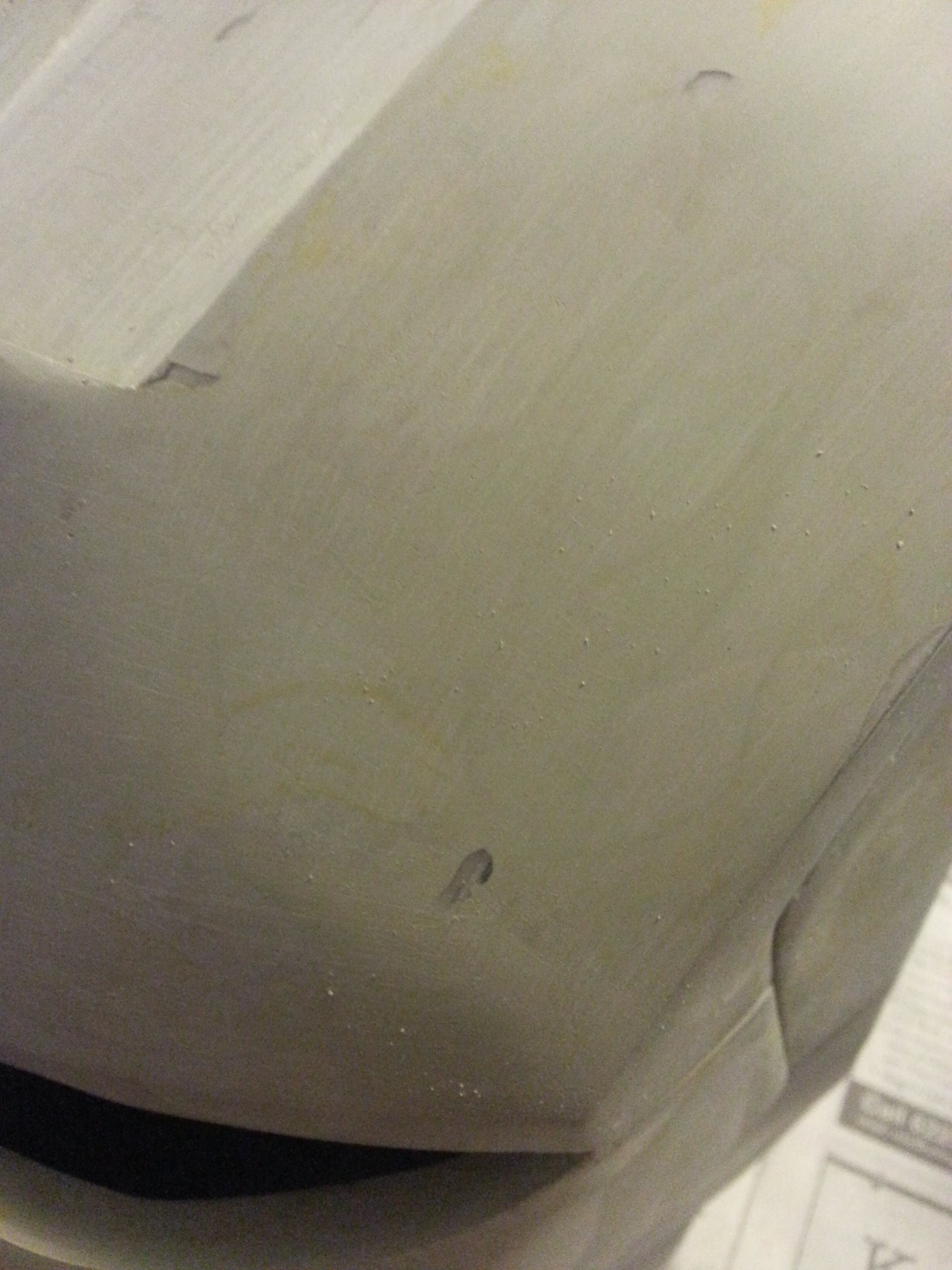

20141116_173259.jpg The bane of my problems... you can see the poor "bones" of the helmet
20141116_173307.jpg Here too.... I tried upping the sand grit to 220 but still scrape off a bit too much, tried 400 immediately but didn't help level the uneveness of the in between coats of filler...

You're going to burn through your cardstock eventually anyways, that's just the nature of skimming a resined pep. What you can do is get it to where you are mostly happy with it (this is all personal preference), and then spray a few decent coats of sandable primer/sealer over the top. After the primer dries, skim any holes or low spots with filler putty (usually comes in a tube like toothpaste), sand those down with 400, and shoot another coat of primer.
If you still have any areas where the 'tooth' or fuzziness of paper is showing through, skim those with filler as thin as possible and feather-sand them out. Then (you guessed it) spray another coat of primer/sealer on. It's all a lot of work, but it's just like your original skim coats; you only want to put a little on then take even less off.

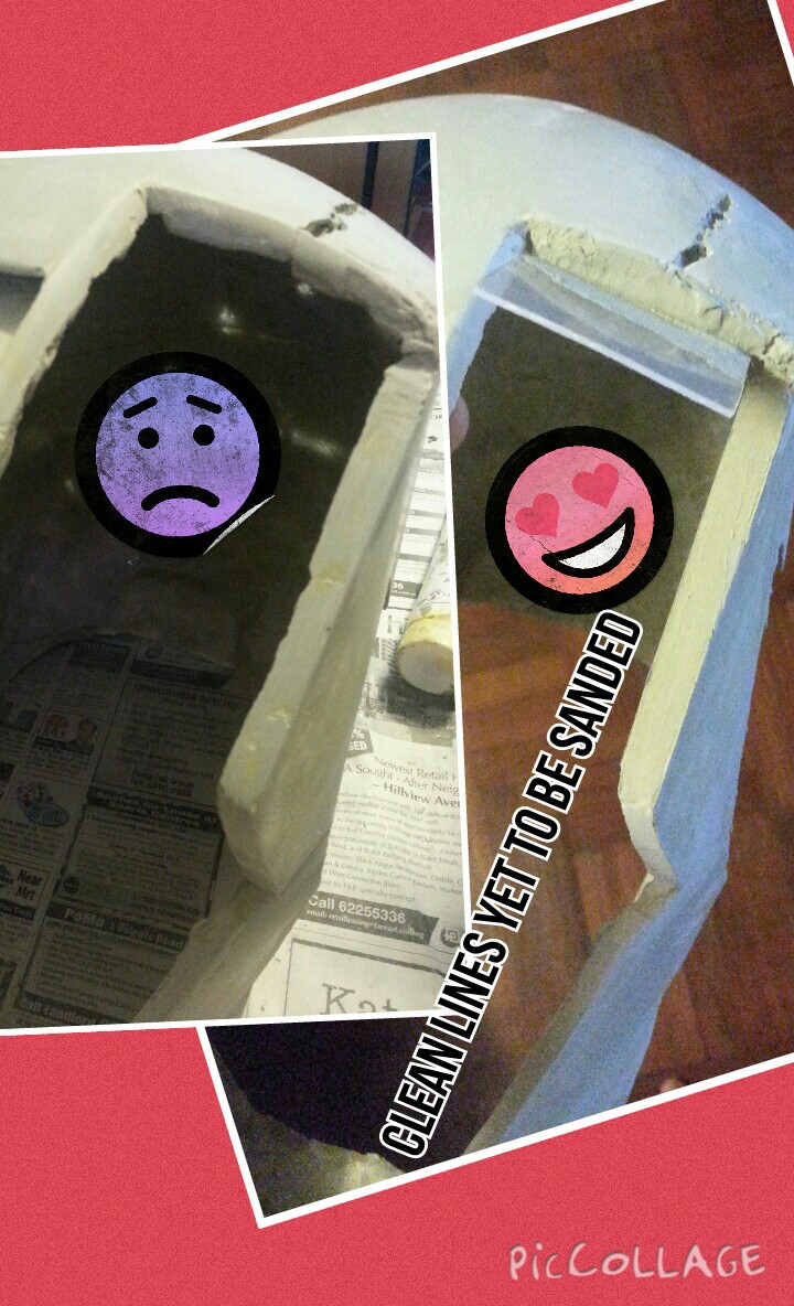

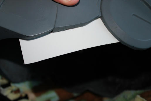

If you want uniform edges at your cutout areas, here's what I do to clean them up. Get yourself some plastic lids (like disposable tupperware stuff, ice cream containers, etc..), cut them down and hot-glue them inside the helmet to form a lip:
You can skim a small amount of filler along that back edge, packing the gaps between the plastic and the helmet with a small amount of filler to create a sharp corner. When the filler hardens, the plastic can be popped off and the back side skimmed lightly to build up the edge and give it strength. Light sanding to clean up and you're done.

Took laellee's advice and it worked like a charm, I may not have applied it perfectly, but the results came out almost perfect.
Collage 2014-11-18 19_05_11.jpg Plastic Pieces used as given advise by laellee (Thanks Brother)
Collage 2014-11-18 19_05_47.jpg The Lines came out almost perfect even before sanding!
