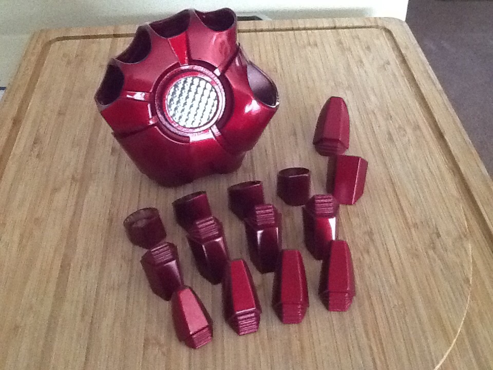

Has anyone come up with a really good way of attaching the fingers to the gauntlets?
I'm trying to figure out how to do this with a glove, but I am looking for suggestions.
thanks guys!
What are they made of? I've seen some people use piano or guitar wire, or elastic straps.
They are 3D printed, reinforced with smooth-on 65.
how did they attach the piano wire or straps? Just plastic epoxy?
I need them to stay aligned properly due to the close tolerances to my fingers. Also ease of getting them off and on is a factor of course.
I used elastic straps (picked up from local craft store, nothing special), and epoxy to attach ( Abb eliten method). I also used an inner glove and epoxied the tips of the fingers in.
-elastic band on the top side to make the fingers bendable.
-on both sides in the middel a string to keep them alligned.
(of course on the inside of the parts) :p
very easy and works great.
