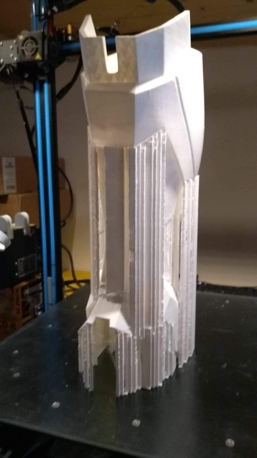

This print has been 'challenging' shall we say, its obvious no one has printed these files before and I've had a bit of toing and froing with do3d to fix issues with them, the gun for instance was paper thin and also missing a way to connect the top to bottom.
They have also not been designed with printing or wearing in mind, so I've had to do some pretty big mods to 1. get the thing to print, 2. get it so you can actually put it on
This has resulted in the chest section being printed 4 times :( that's a serious amount of filament and printing time wasted

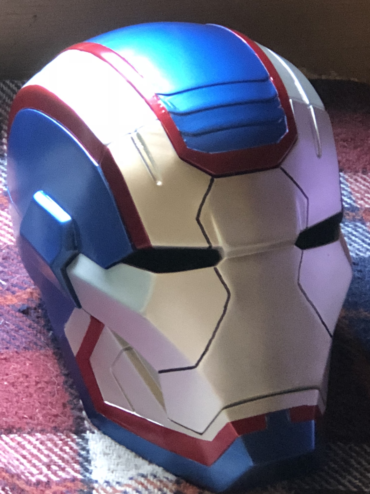

did some more painting at the weekend, think the colours are a pretty good match, didn't worry too much about the finish as this is the test helmet, and its not been clear coated.
It became clear while I was taping it up that it has a couple of accuracy issues, fine if you are painting it as a war machine mk2, not so fine as a patriot.

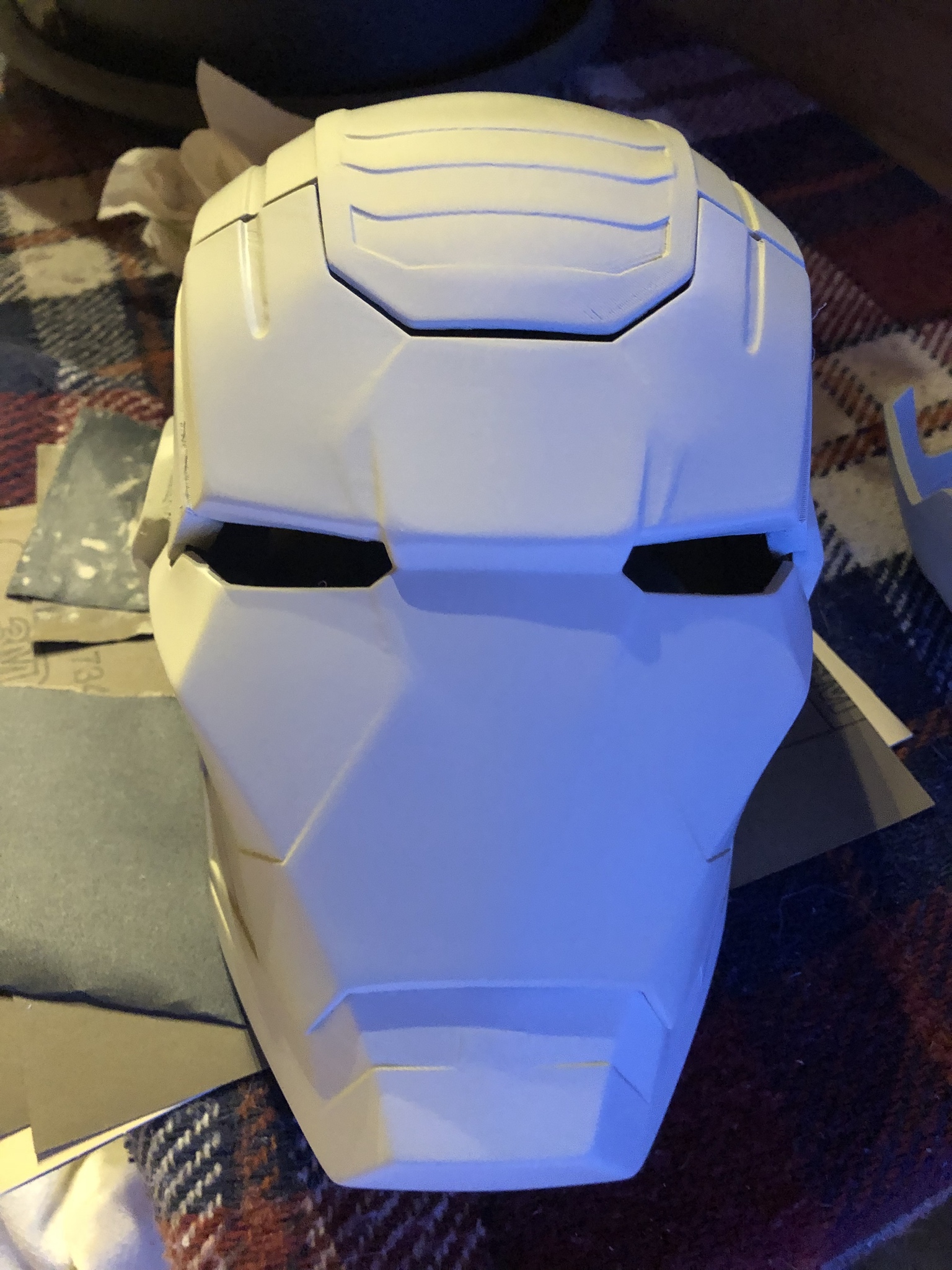

then it was back to sanding, filling, sanding filling
and laying down some paint
the 2nd helmet got some work too, not 100% happy with this, can still see some of the base silver between the red and blue, will fix this later, I'm not the best at taping off, stupid old knackered eyes.
the chest plate I'm pretty happy with, first time I've overlaid multiple colours on the same base
