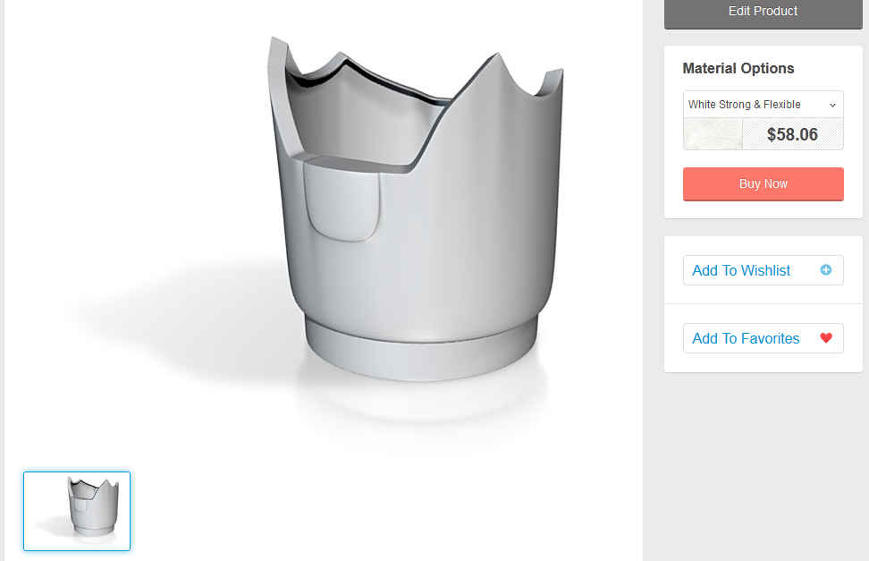

Strange, the inner forearm is priced higher than I think it would be. The full spine is only $68 as one piece but the inner forearm is showing at $100 and isn't that detailed a piece. Is it due to it's thickness, maybe?
Yes, I find that the thickness of the model has a LOT to do with the cost. If I can thin it or hollow it out the price drops significantly! I thinned the forearm piece down while trying to keep the cylinder inside for the outer forearm to rotate on. I will look at it again and see if I can trim anymore as the price does seem kinda high. stay tuned.
I was able to remove ALL the inside geo and get it from $184.74 to $58.06. MUCH better!

Elbow was $63.95... now it's $14.77
14.77 ?!! i think your model is either too small or not thick enough !!
my mk VII elbow has the minimum strenght thckness so it can be sent(2mm thick) without breaking and it costs 36.36 $
Size is right on, but you are correct, the thickness is only 1.27mm. My idea was to print as thin as possible and rondo or glass the back afterward to strengthen since all the detailed work was done. Are you saying they can't print less than 2mm??
Also: just did a test on a 2mm elbow. $27.25 as opposed to the $14.77 version that is 1.27mm thick.... dang, thickness =can save some $$$ ----- Shapeways says min thickness of 1mm, but 1mm is too thin for larger areas... wonder if 1.27 will work?
