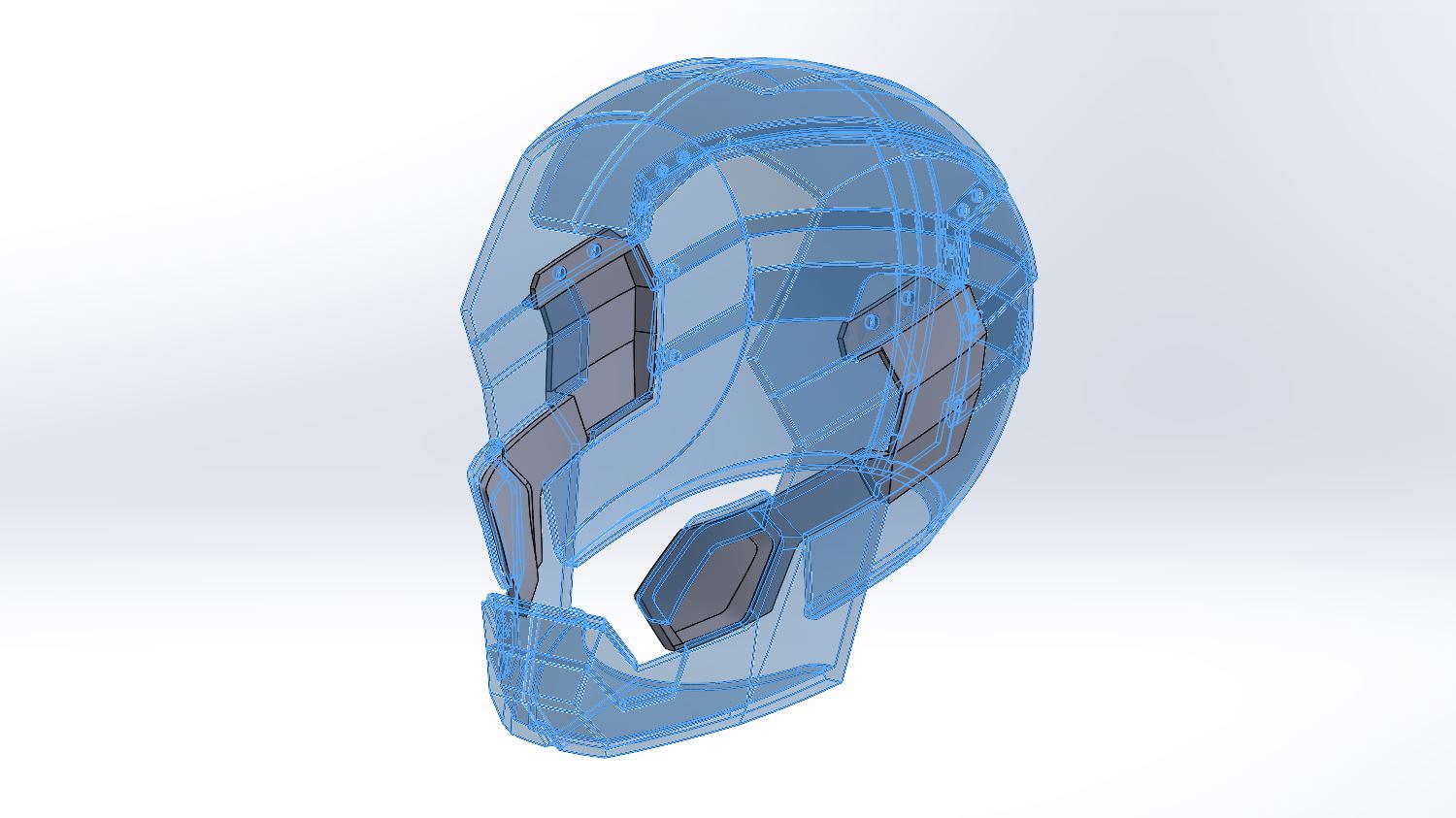

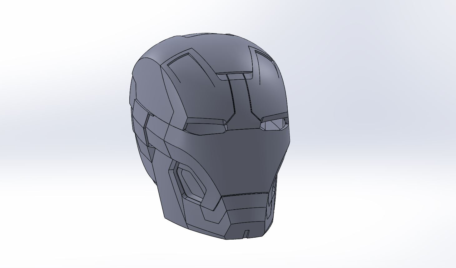

I was working on the helmet for easy 3Dprinting, I noticed that the inner cheek piece doesn't move when the jaw moves forward,.
Here's the result after some modifications to the helmet.

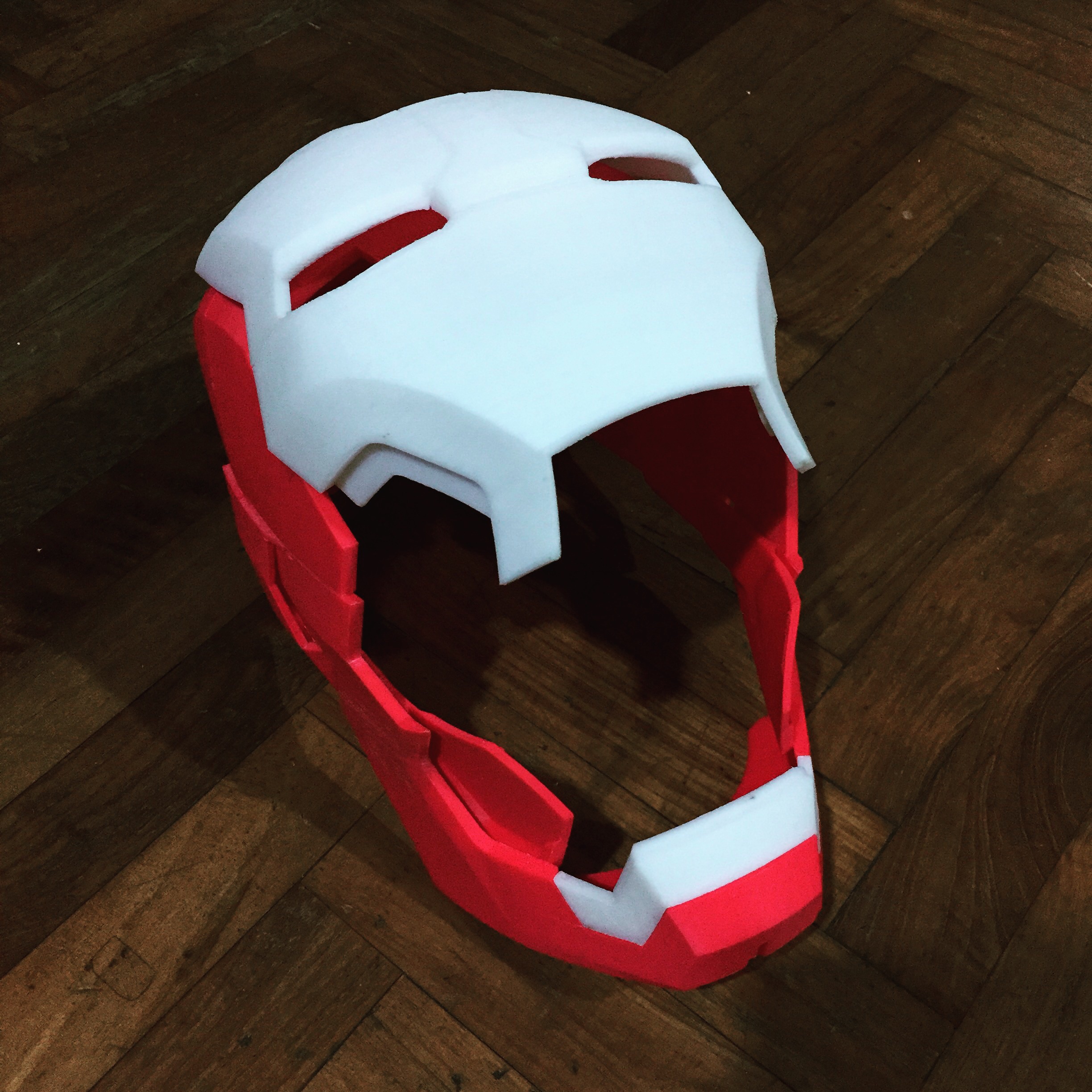

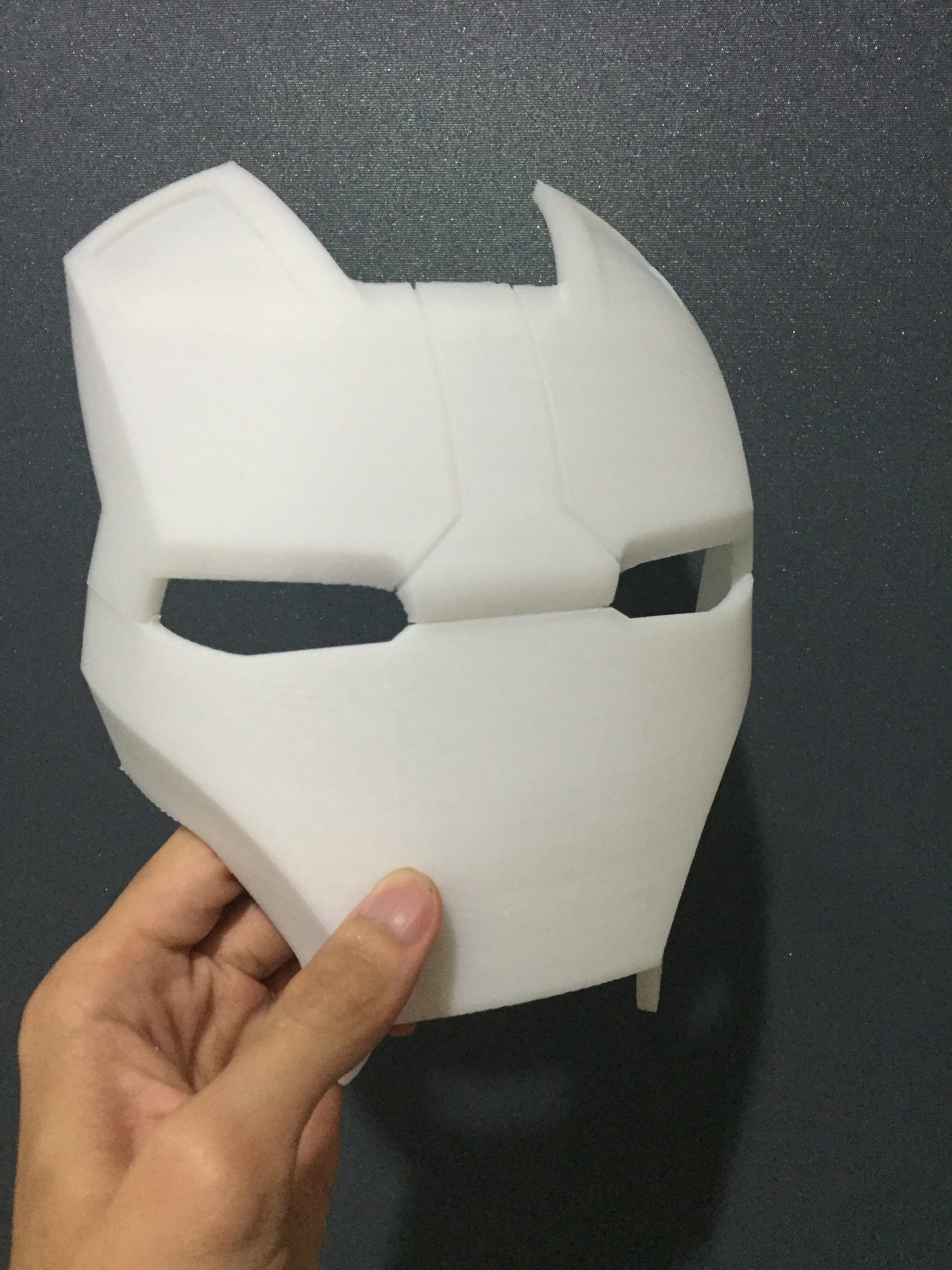

Some progress on the 3D printed faceplate!
It's designed in 2 parts to save material on support and for my small printer!
Stuck together w acetone after tht.
Here's the progress of the print so far!
Everything seems to fit quite well tgther, though there's still some gaps here and there...
The jaw movements seems alright. Will post a vid on tht soon!
Gonna start figuring out the mechanism to motorized it! *fingers crossed*

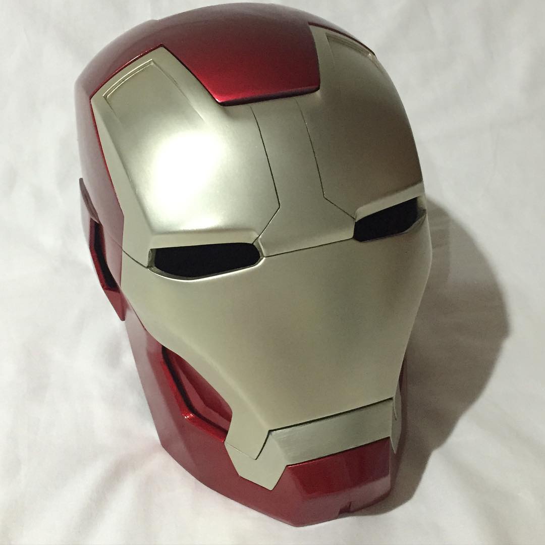

Here's an update on my progress. Finally done finishing and painting!
Moving on to electronics and the mechanism now!
