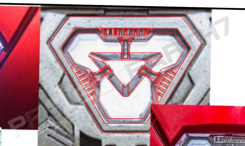

So it started from some reference I found on the net and some provided by the client.
attachment.php
I traced it via CAD to get accurate dimensions
attachment.php

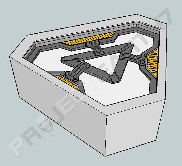

Then designed it... the thickness of the casing is important to prevent LED hot spot
attachment.php

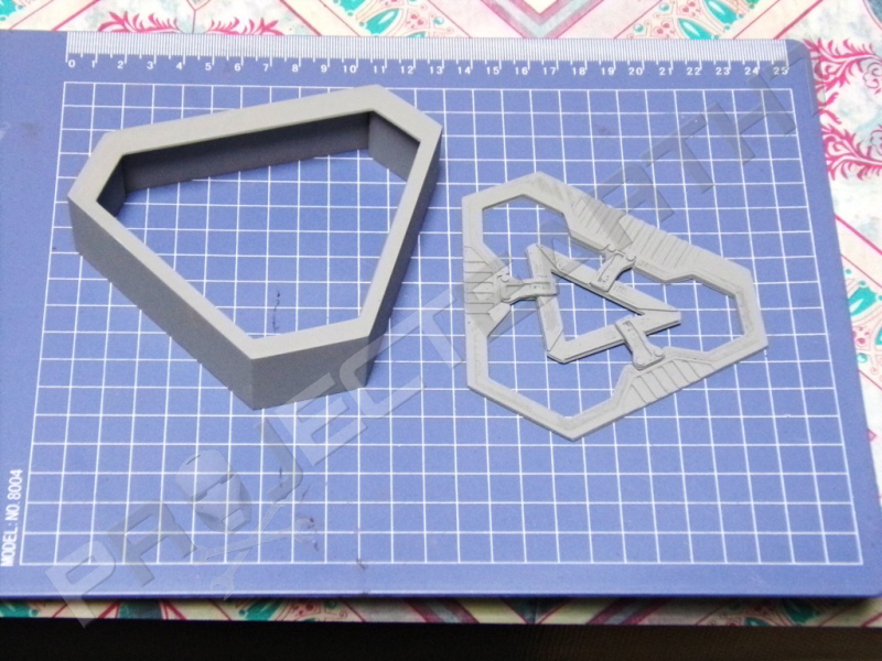

Made the parts...
attachment.php

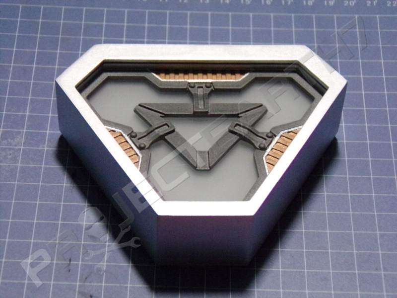

Proceeded to painting and assembly...
attachment.php
attachment.php
I used gun-metal paint color for the element to resemble real metal look
attachment.php
Clear acrylic glass on top
attachment.php
attachment.php

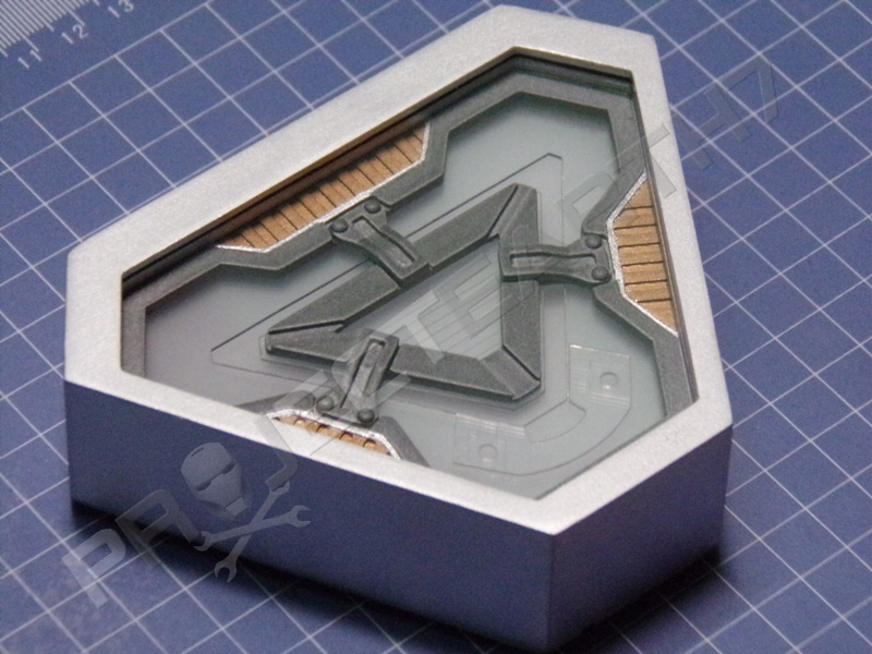

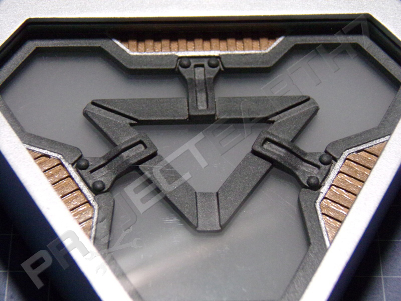

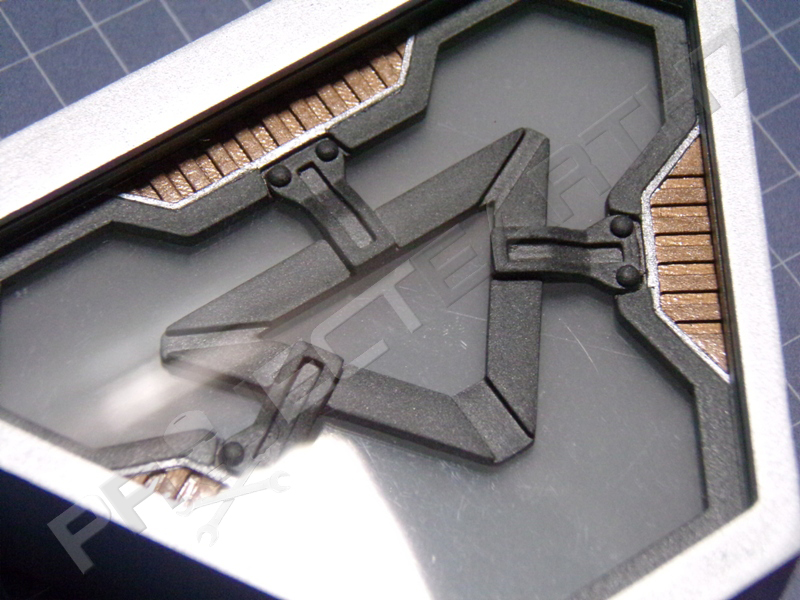

Digging into details on the reference photos I saw some layering which are a bit subtle but still gives the arc reactor more depth and intricacy... I tried to copy it using a thin clear acrylic and here are the results....
attachment.php
I cannot find a clear adhesive that will not affect the transparency of the acrylic so I just minimized the amount I put on it
attachment.php
attachment.php
Will proceed on the electronics shortly.... cheers!

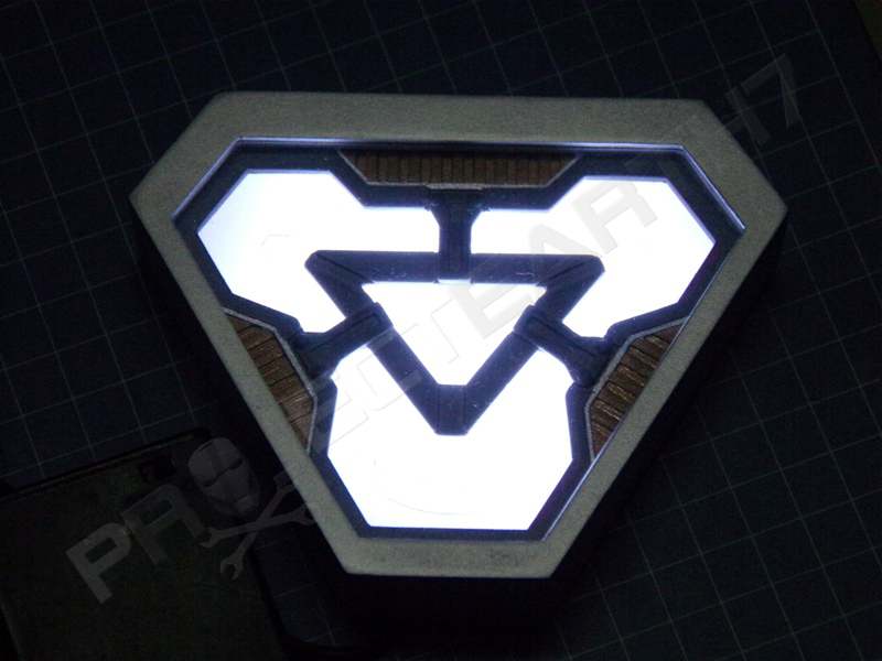

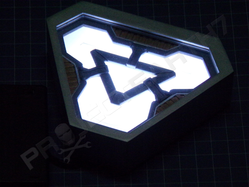

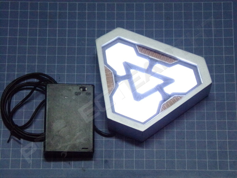

Here is the final result...

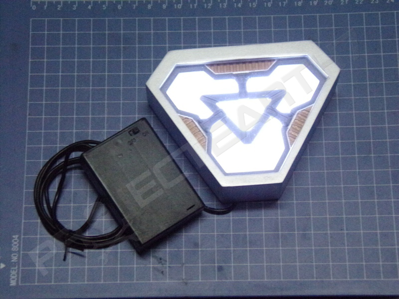

The electronics consists of 26pcs 5050SMD Super bright LEDs
attachment.php
attachment.php
Powered by 3 AA batteries
attachment.php
attachment.php
That's all folks.... should you have any inquiry, just send me a PM.
Keep building everyone... cheers!
