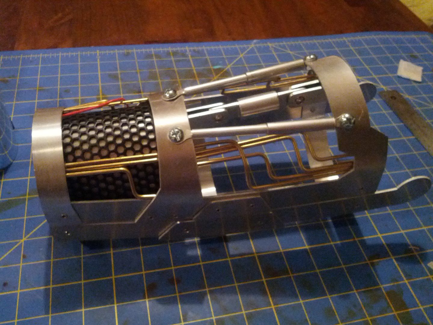

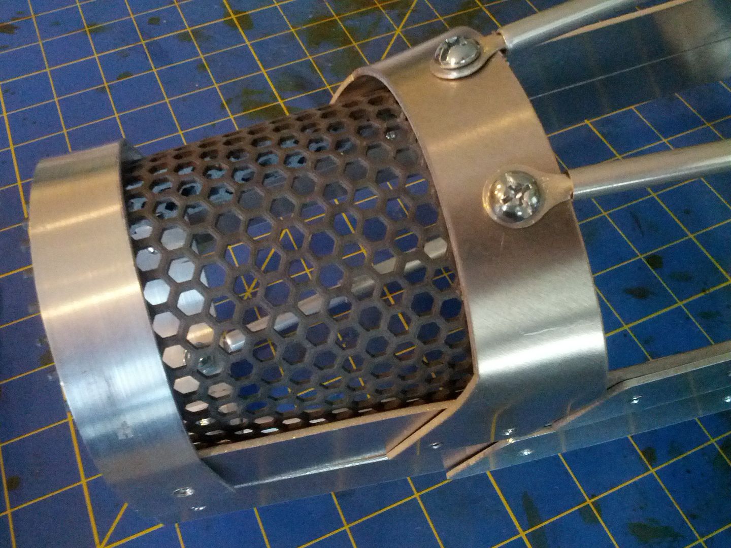

What are those small thin pistons, are they some sort of found item or were they scratch built?
Re: [Iron Man] Mk. II Flight Stabilizer Gauntlet v2 - COMPLETE!
The piston are scratch built using two diameters of aluminum tube and ring terminal connectors

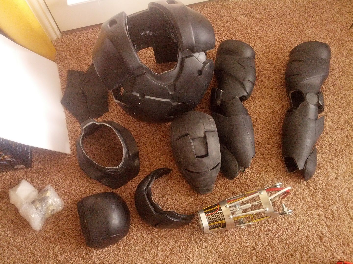

Well, the packages from Brad arrived today all safe and sound. Once I finish up the current flight stabilizer and get that shipped off, I can begin surface prep on the armor pieces to get them ready for paint.
I can't stress enough how awesome and clean these pieces are from Clinton :thumbsup

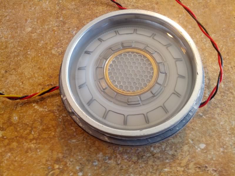

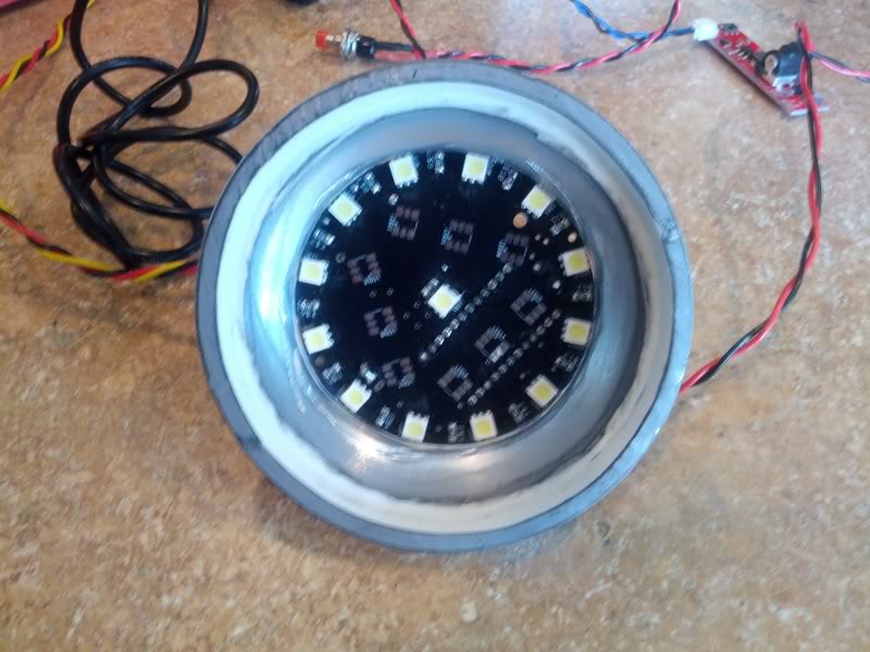

Brad also included an electronics package from Ryan (aka TheRealStark) which has LED boards for the eyes and unibeam, as well as a speaker that plays a "charge up" sound as the unit is powering up. I couldn't resist firing it up and seeing how the unibeam will look!

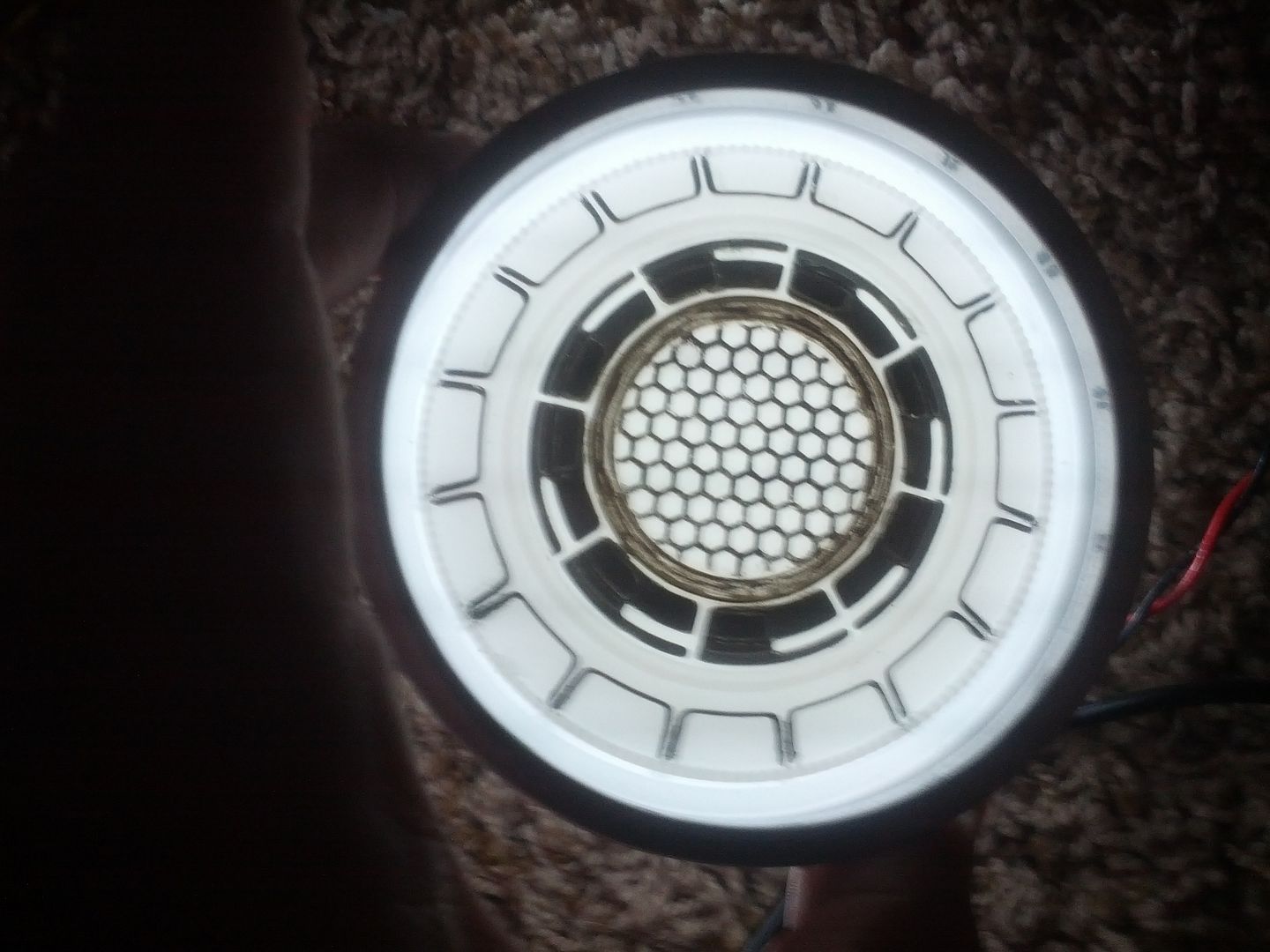

Daylight:

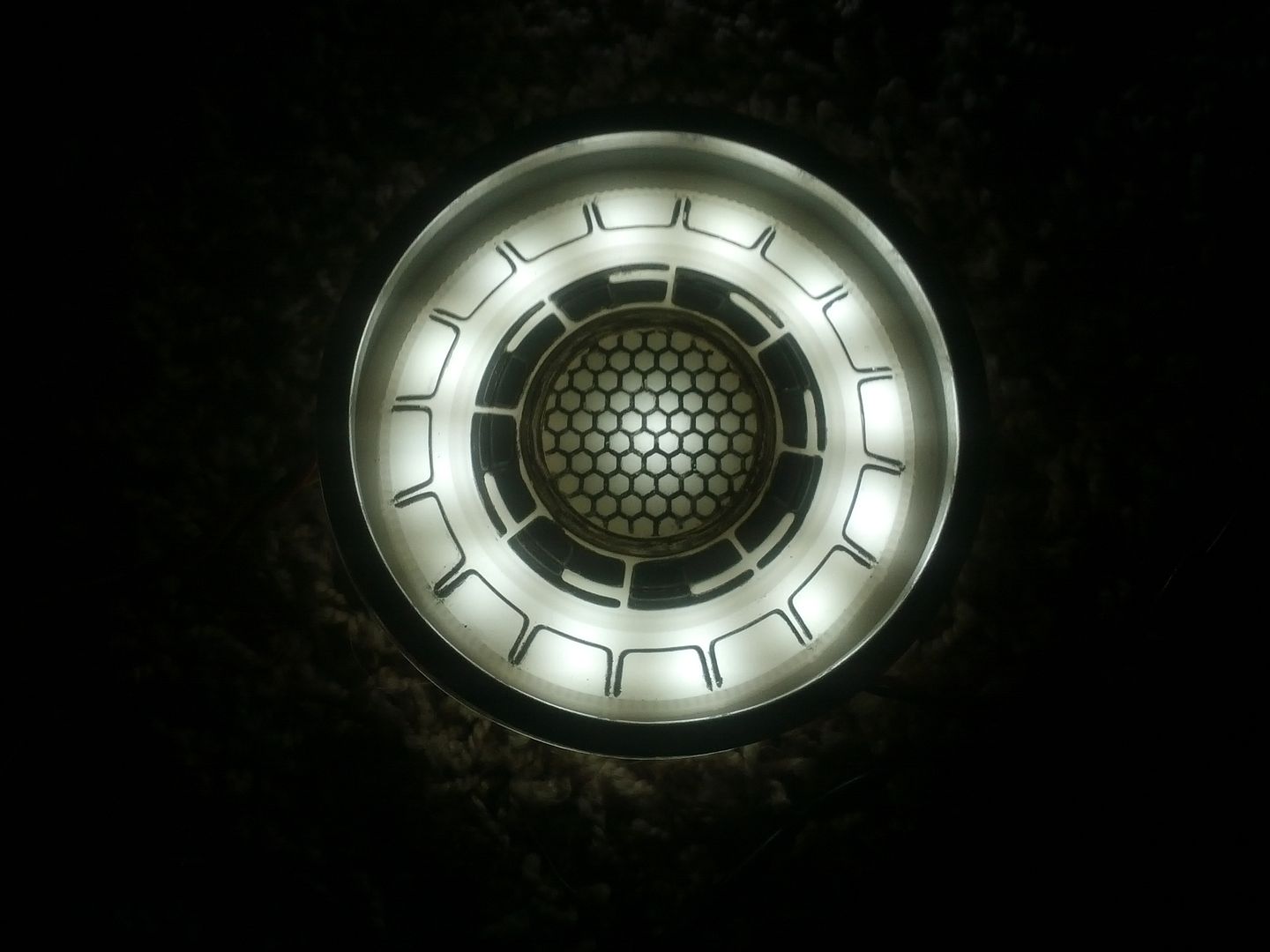

Dark room, unibeam plate directly above LED board
Dark room, unibeam plate an inch or so above LED board
Definitely like the light dispersement of the last pic, so I'll most likely build an enclosure to hold the unibeam plate above the circuit board rather than right on top of it. Can't wait to get this going! :D

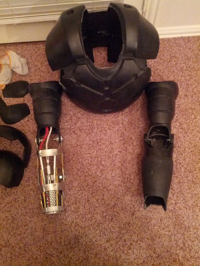

Just a quick update, I've gotten most of the parts trimmed up and ready for sanding. Yesterday I spent the afternoon doing some test fitting of the helmet and neck seal to figure out just how I'll have it attach, since the display will be hanging and not on a mannequin. I think I have a couple of ideas that I'll play around with, but any suggestions are welcome!

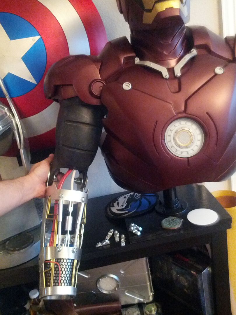

Couple more shots... Finished test fitting both arms. Now they're ready for some straps to attach to the shoulder bells, and then wet sanding and paint!

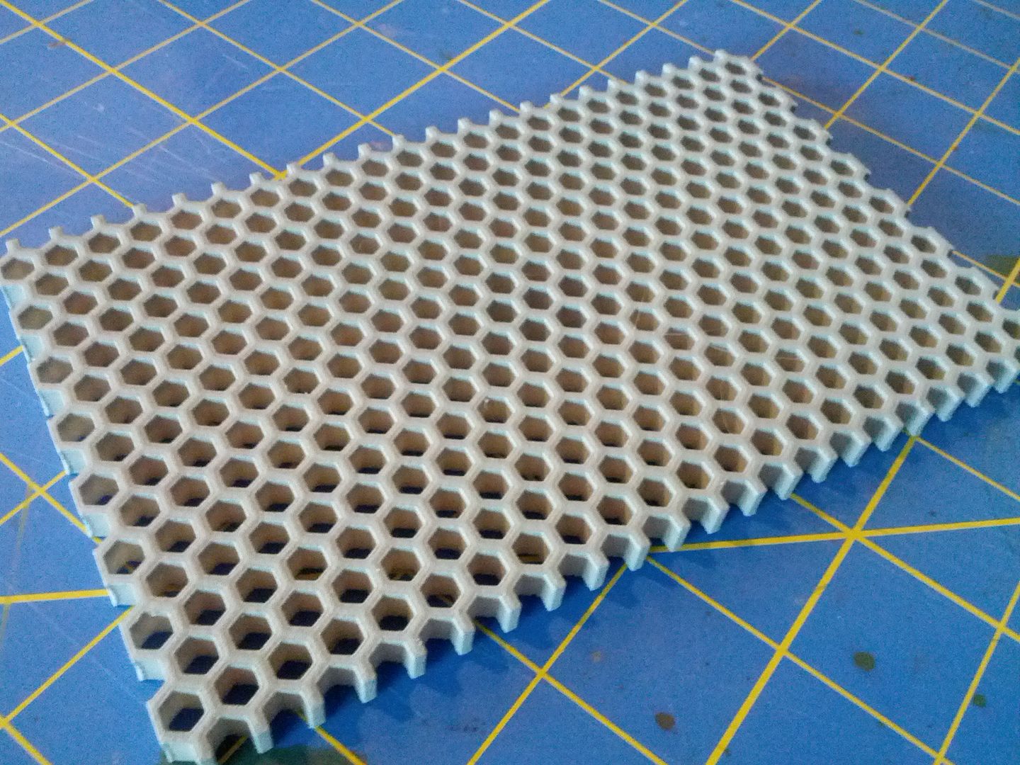

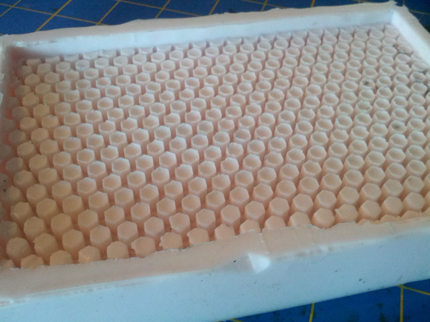

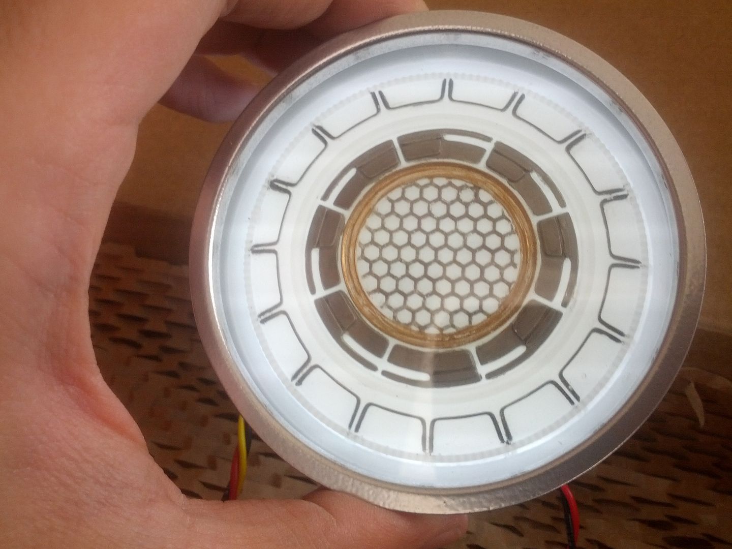

The first build I used a PC fan cover for the honeycomb mesh on the stabilizer, and it worked exactly the way I wanted it to. However, on the second build I couldn't quite get the mesh to fit in the way I did the first time around. Since that was the biggest piece I could find with that particular size honeycomb, I had a 3D model drawn up so that I could print it at Shapeways, then mold and cast it to make the proper size piece of mesh.
Here is the printed piece:
The mold:
And the first cast:
This was a pretty difficult piece to cast since the mold had a lot of small nooks and crannies, literally. Also, the resin I use has a quick kick of only about 90 seconds before it starts to set up, so there isn't a lot of time to pour and slosh it around for even coverage. I poured the first cast a bit heavy so that I could be sure to get the resin into every part of the mold, and then took it to the belt sander to lower the profile. Once I had a good thickness, I used a heat gun to soften the plastic and shaped it to the proper shape of the stabilizer:
Perfect fit! Now I just need to do a little fine sanding and prime and paint it. Then I can finally move on to finishing this second gauntlet and get it shipped off to its new home :)
On the armor front, I've actually gotten quite a bit done. The helmet has been trimmed and fitted with magnets, the torso has been completely cleaned up and is ready for paint. I have also drilled the holes into the shoulder areas of the torso to accept the eye bolts for hanging. The biggest thing I have left to do is figure out how to make the helmet stable on the neckseal once it is all assembled. I have put a couple of magnets into the neckseal where the back of the helmet meets it for alignment purposes, but they aren't nearly strong enough to hold the helmet in place. If I can find a box big enough for shipping, I may permanently attach the main helmet to the neckseal (already in place on the torso) so that it definitely won't go anywhere... Any ideas?

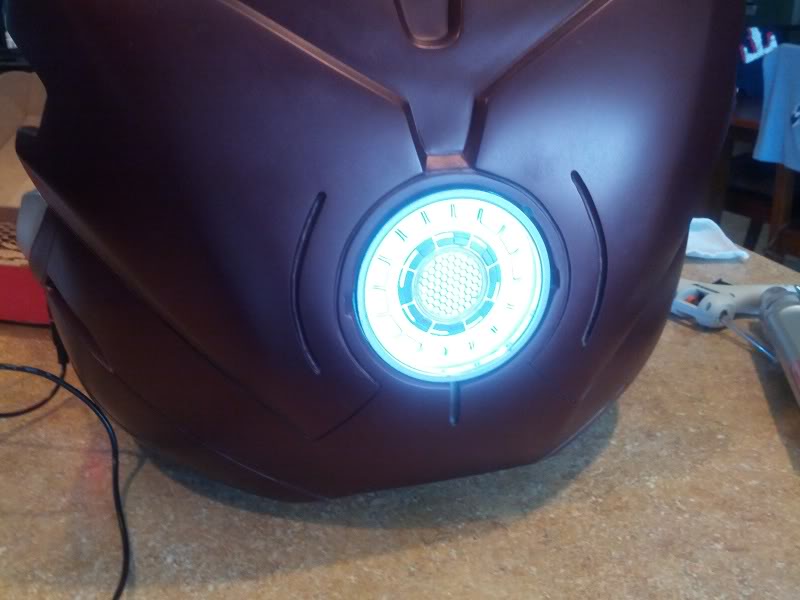

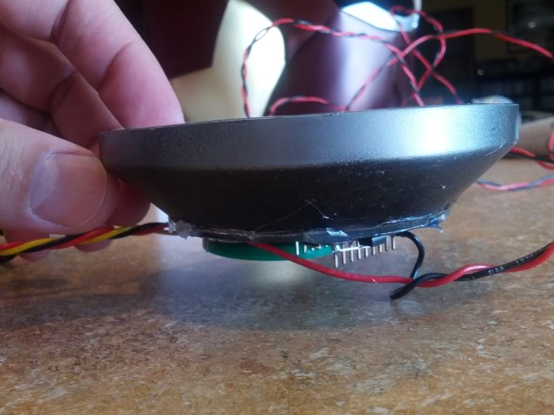

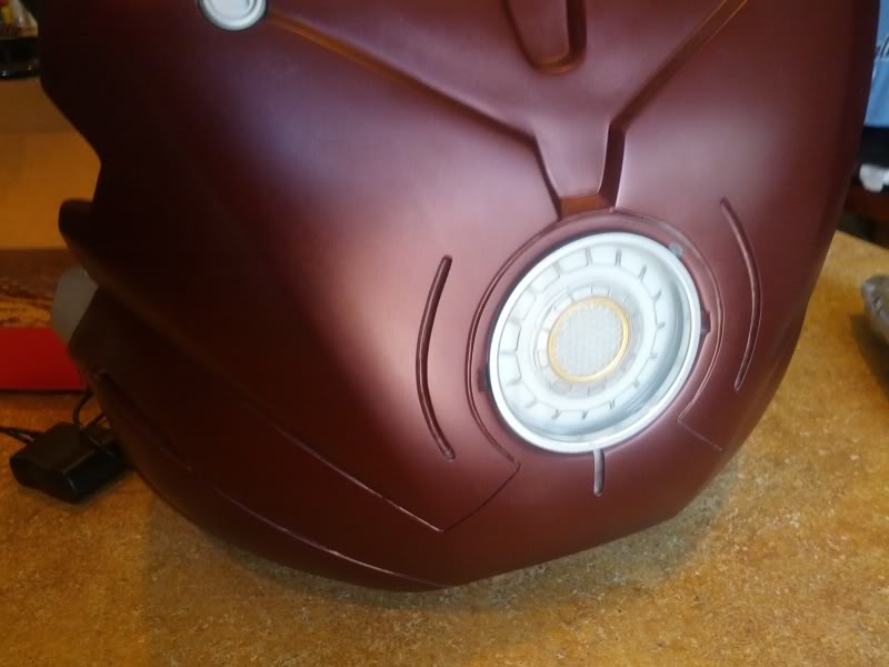

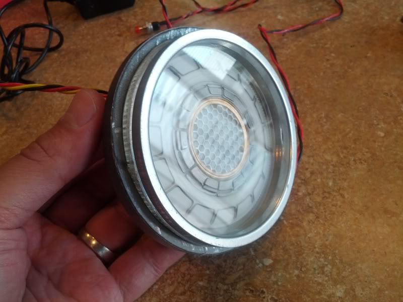

Today I finished up the unibeam housing. It consists of a PVC connector I cut down to size, some sanding and dremeling, and then gave the inside a nice silver paint job to help reflect and diffuse the light. The electronics board is attached to the back, the unibeam nests on top, and the clear acrylic plate and ring sit on top of that, forming a fully enclosed unit.
Here it is being test-fit into the chest:
And here is a quick video showing the awesome power-up and flicker effect TheRealStark custom made for the project!
The flicker you see coming from inside the chest is the eye circuit that turns on once the unibeam is "powered up". I'll be working on the eye housing next!

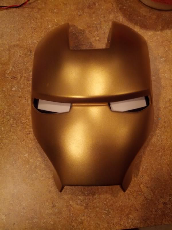

Got the eye details in place, along with the lense. Also built the housings for each eye circuit using styrene, then painted the inside bright silver and the outside black. I placed two sets of magnets on each eye box so they can easily be removed from the faceplate if necessary.
The eye detail:
And a quick video showing it all in place:
Now that I know everything works as it should, I'll seal the eye boxes up so there won't be any light bleed inside the helmet :thumbsup
