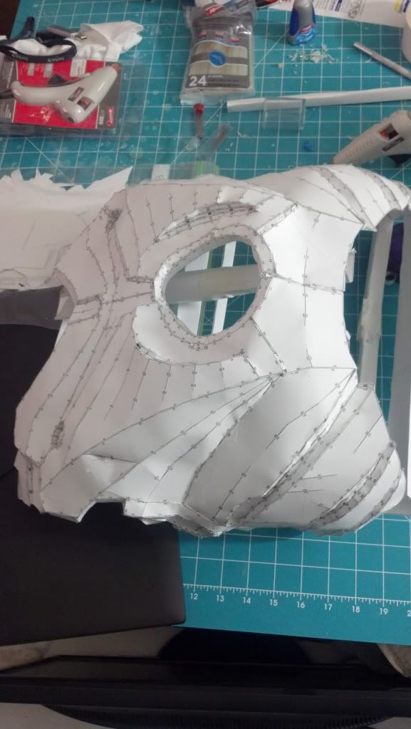

I just finished gluing and reinforcing the chest piece. I plan on hardening it with Smooth Cast 325. I've used it for other projects and really like it. This weekend I'm going to the Dollar Store and Home Depot to find some stuff for the Arc Reactor.

Did you use scribber first before folding? I think it helps to have cleaner folds.
If I am not mistaken, some folding direction is also wrong.
Check the paper weight also.
Hope it helps.
Thanks for the input everyone. The paper pep has a definite learning curve. I'm using 110 weight card stock, and hot glue. The hole is definitely a bit wonky, but I'm planning on modifying that anyway. And the scriber is a really good idea- I've been using the blunt side of the exacto knife which is... not ideal. lol.

You did hot melt on paper?
Paper is thin, and hot melt (as it sounds) is HOT.
I started using glue stick at first, but you need to find a good one that strong enough.
I decided to switch to PVA glue (White glue) and ended up using it for foam coats. I switch from paper to foam after one try.

I think you're right, the hot glue was causing the paper to warp. :facepalm
But I'm with you, after the first piece I made, foam seems the way to go.

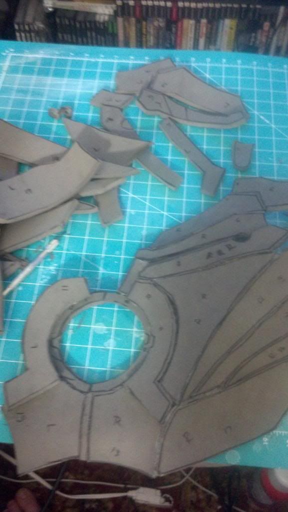

Thanks, this is very helpful! One thing I am still a bit confused on, and I can't seem to find the answer anywhere... there are dotted lines on some of the pieces (on the edge, not on the inner parts). What should I do with those? (Below, I've attached a photo of what I'm talking about)
Also, in Stealth's video, he says you should disconnect the dotted lines on the inside. Some of the pieces look really small when I disconnect them. Am I doing it wrong? Any help would be greatly appreciated!
I don't have the version of Mk 3 you have.
But judging from the picture it should not be connected
Green indicates neck lower armor
Red is side upper back panel

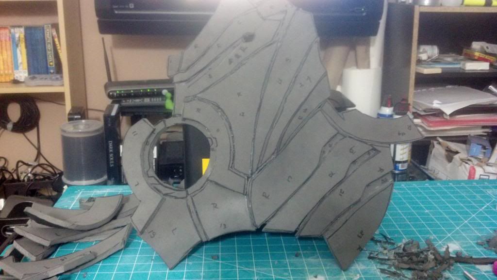

Well, okay...I feel kind of stupid. This is my second try and I'm still not sure I'm getting it. The first try I tried to combine some of the smaller pieces into larger pieces, and that didn't work out too well. So then I quit trying to be fancy and went straight from the templates, and it looks huge. I'm 5'10, and Dancin Fool's files are the standard 6', so I thought it would fit right, but alas, it seems made for a giant.
I checked out JFCustom's thread (thanks for the tip, IMIM2) but apparently it didn't stick... Any tips for foam working would be greatly appreciated! The pieces don't seem to fit together. You all have already been awesome help.

The seams look okay. You're doing good.
Do you have pepakura software near you when you glue the pieces together? Looks like you glued wrong pieces.
It is important to have the monitor near you so you can check and TEST FIT before gluing. The 3D side of the software can be rotated, zoomed or select certain area for confirmation, and it linked to 2D side. Use that.
Read JF's thread carefully, especially on the gluing tips. He was very detailed yet his illustration and explanation were so simple.
Take picture on what specific area you think you made mistake and share it. By doing that we help other people not to make the same mistake
