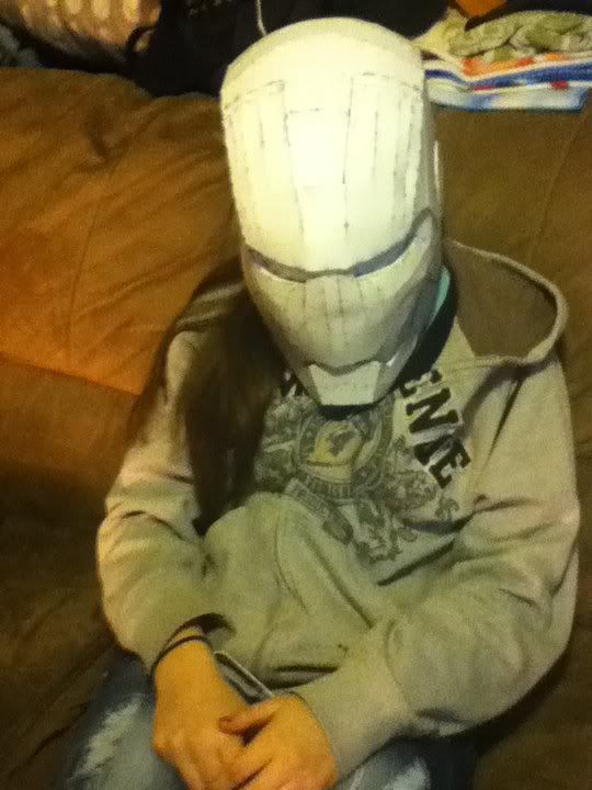

Just applied some Fibreglass. Will try and update with some pictures before I go out tonight. Only problem I have had is when I cut out the eyes. It slightly damaged the outside structure for the eyes itself. DANGIT! But thank goodness for the invention that is Body filler. As long as it keeps its shape and the fibreglass makes it strong I can always just use filler to fix it.
Slowly and surely this will be completed. Was hoping to have ALL the fibreglass finished today, but bad weather has left me being short. Oh well, glad to be still progressing at the rate that I am.

UPDATE 19/2/11
Here are some update photos!
Pictures are after my 3 layers of resin and last picture is the begining of my fibreglass. Was going to do some more today, was getting ready, was really excited, got dressed in my protective clothing, then remembered. I've ran out of brushes :( Oh well, I'll get some more soon and get this fibreglass finished. Guess I better start doing some more chores round the house so dad will get me filler and brushes :p
Also, Ironman taking a nap.

wow ... you got more done then I thought on the fiberglassing ... is it just the pic or did your bucket deform a little during the fiberglass stage ... that would suck hopefully just the pic ... but man keep going ... I am liking it so far
Re: Ironman Mk III - First Build - Pic Heavy (UPDATE 19/2/11)
Might be the angle that the photo was taken.
Although, there is the possibility that you are right lmao.
When I've got some more brushes I'll do one brush per side so I'm going to need 3 brushes in the slightest. I've also got the mentality that as long as it is tough and hits well and still holds the same kind of shape that the body filler will help it to look great again. It may take some more work that originally thought but that was to be expected when I first thought about doing this project.
You always have to look at the positives in life. The second you drop that positive nature is the second you start doubting. You start doubting and you don't want to do it. So keep head up and look for that positive. :D

you put so much resin on that thing! i bet its hella hard.
if you ever pep another helm you should consider rondo in stead of glassing it on the inside.

haah Rondo is a mixture of Fiberglass resin and Body filller and the body filler hardener,
once you have about a cup of it mixed together nicely, you pour it slowly into your bucket then pretty much slush cast it around in the helm and it hardens pretty quickly,:love
just an alternate route if you dont like glassing the inside lol.

Yeah, now that sounds good. Does the fibreglass resin come with like Fibreglass fibres in it? Sorry, sounds like a stupid question but I've never really had a keen interests in this kind of stuff before. I've just admired the suits and what not and wished I could make one.

Nah, both of them are separate.
I mean you can still go the Rondo route, but i would separate the faceplate before you harden up the inside too much, and if the faceplate has enough resin on it, it should be able to hold it shape, and you would just harden the inside of the faceplate after you cut it off.

Yeah, I'd love to do that. My biggest worry would be doing that and it crumbling apart or not being able to get it back on properly as I'm not thinking about doing hinges and stuff until I have finished the whole suit.

Yeah, I would definatley recommend rondo, you can fully harden a helmet in a few hours. It's so quick. Basically it's just mixing a bit of resin into the body filler to thin it out so once you mix in the hardener you can just paint the inside with it.
