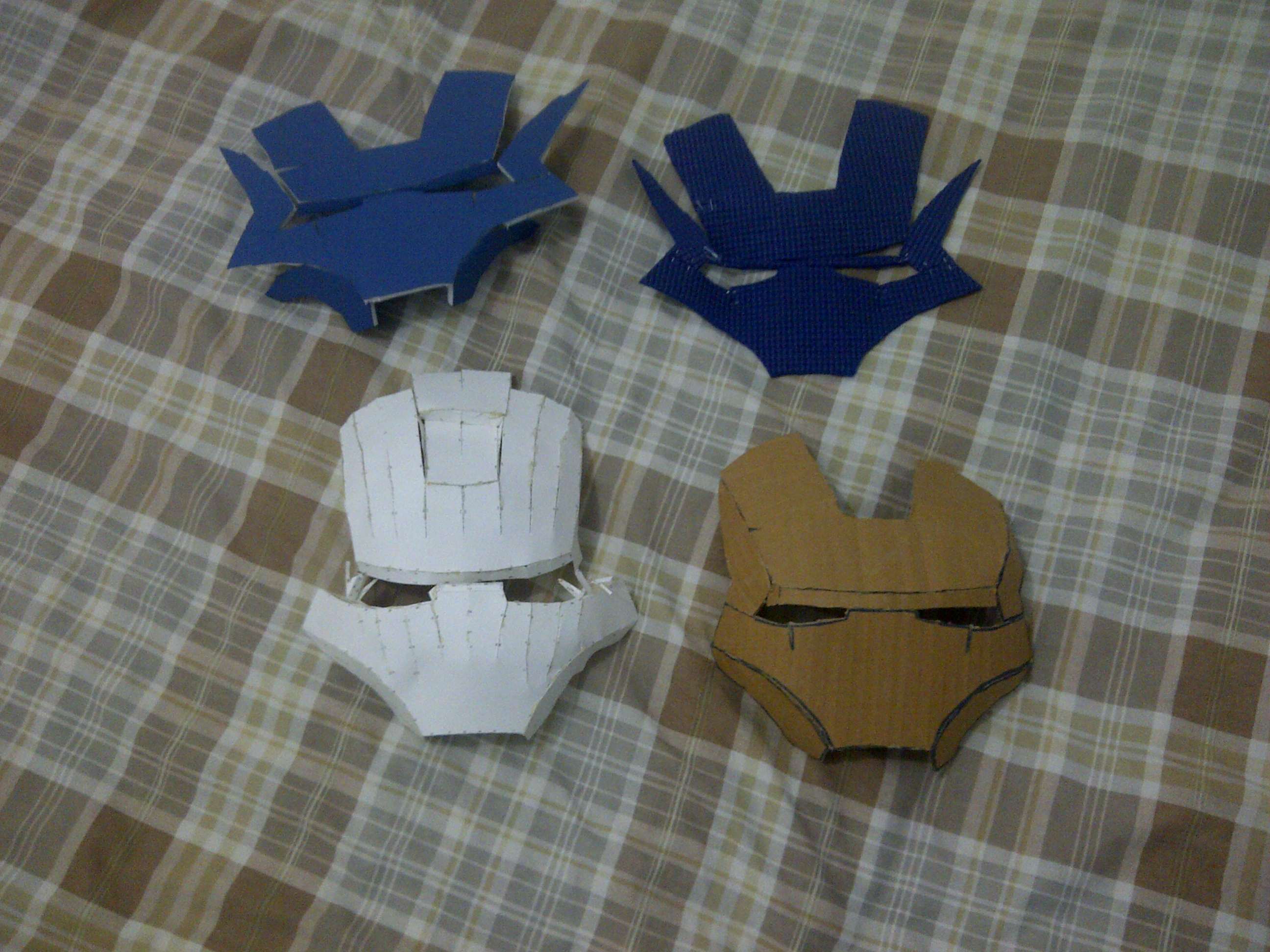

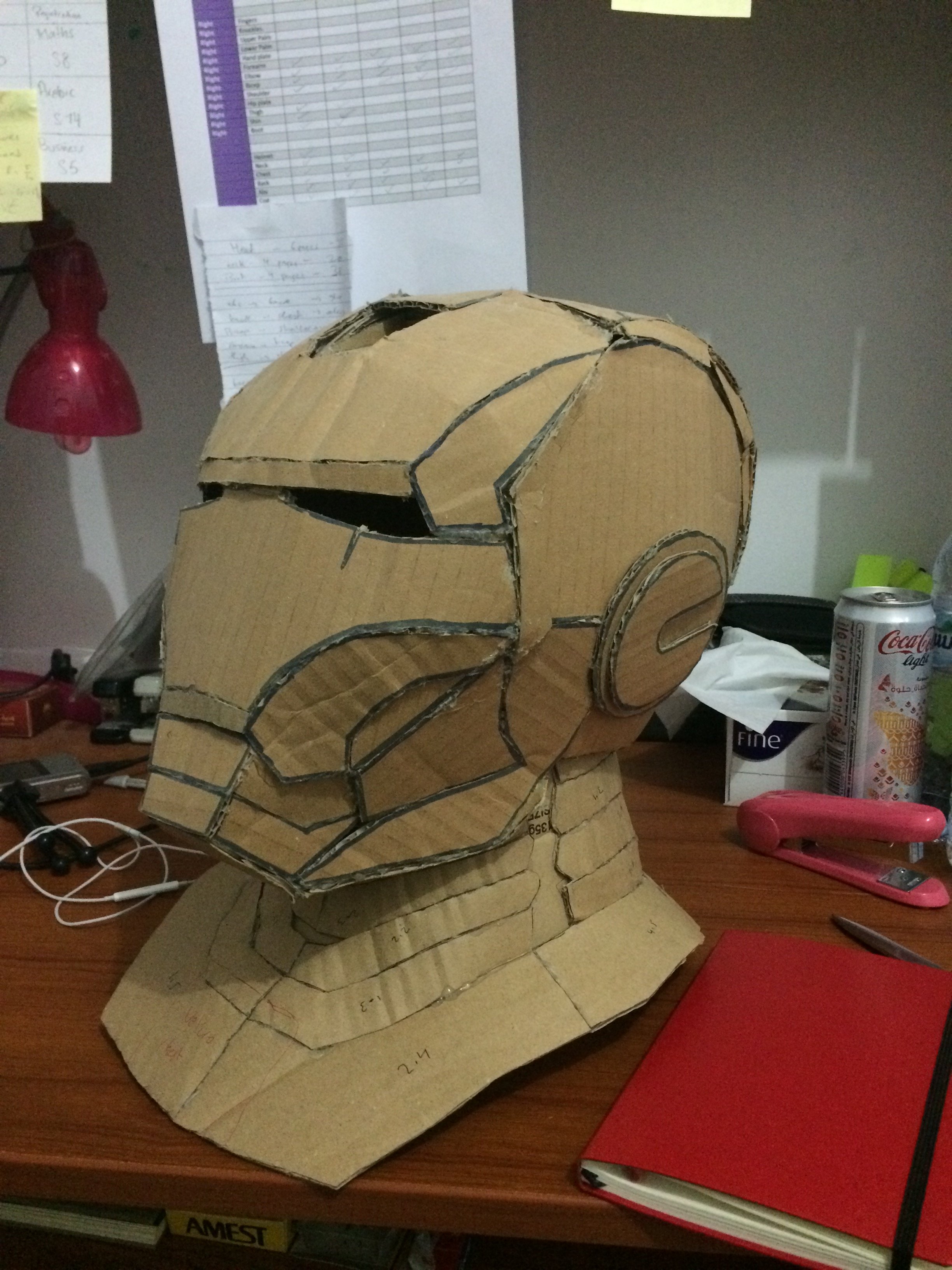

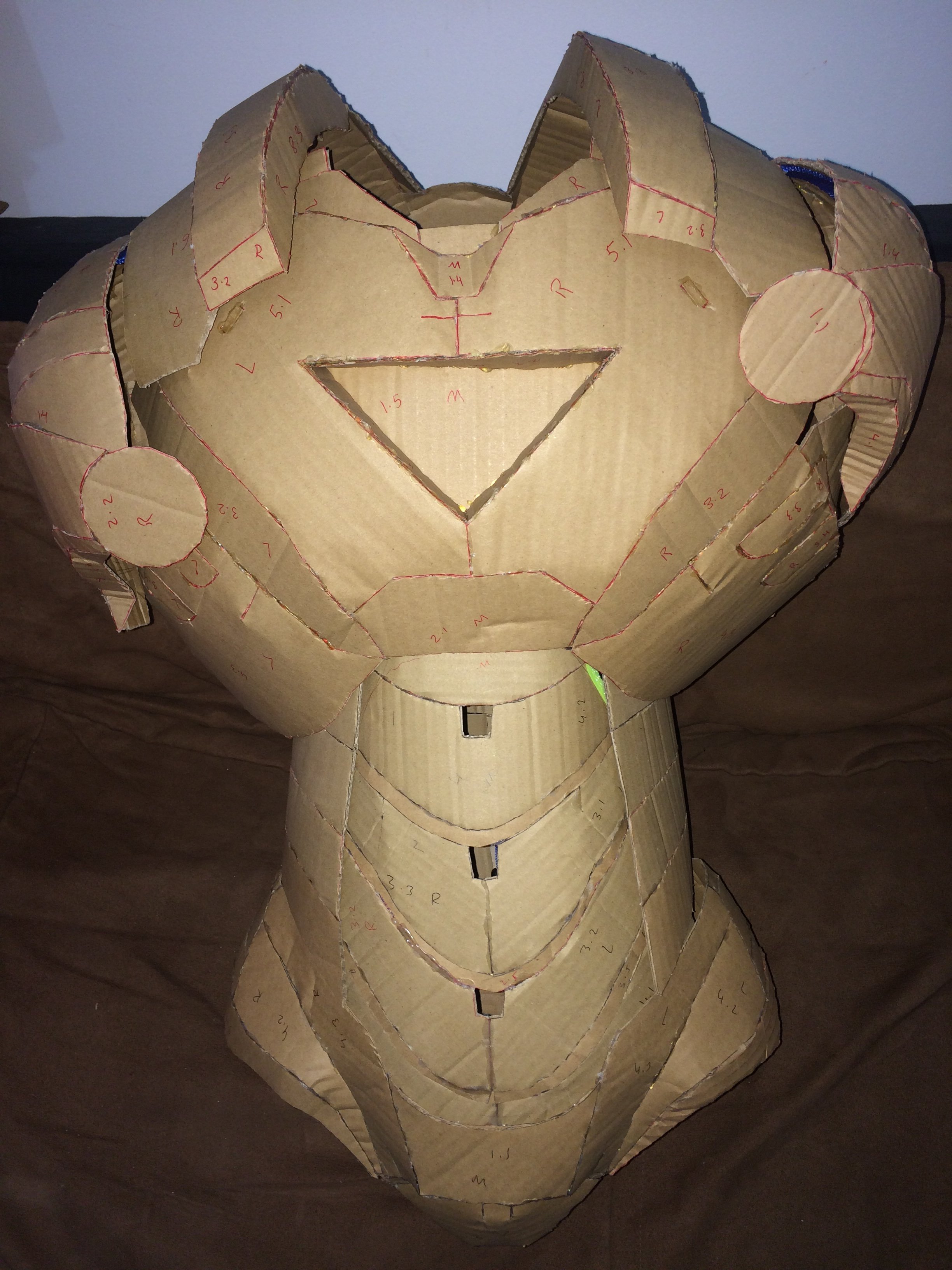

IMG_8146.JPGIMG-20130908-01369.jpgIMG_6196.JPGThis is what my mark 6 looks like now as i forgot to add photos. Both biceps and forearms have been completed and i'm currently working on another helmet and then ill start on the thighs. The picture of the faceplates is just to show which materials i used before settling with cardboard.
