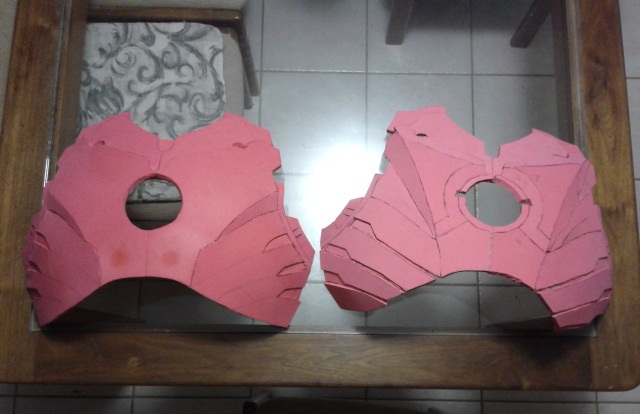

I then began my Iron Man project with A LOT of trial and error (As you can see in the first image)
I improved my technique with using the foam as when I began I was rather sloppy.
I have been using the 9mm foam on the pieces I wouldn't mind larger foam but I can't start other thinner sections (e.g. Neck, arms, abs) until I find a thinner foam but not at a ridiculous price!
So far I have briefly done both legs, thighs, pelvis and chest. When placing the templates onto the foam I usually join the templates all into bigger pieces (I am messy with glue) and then plan to later go over it and groove the extra detail.

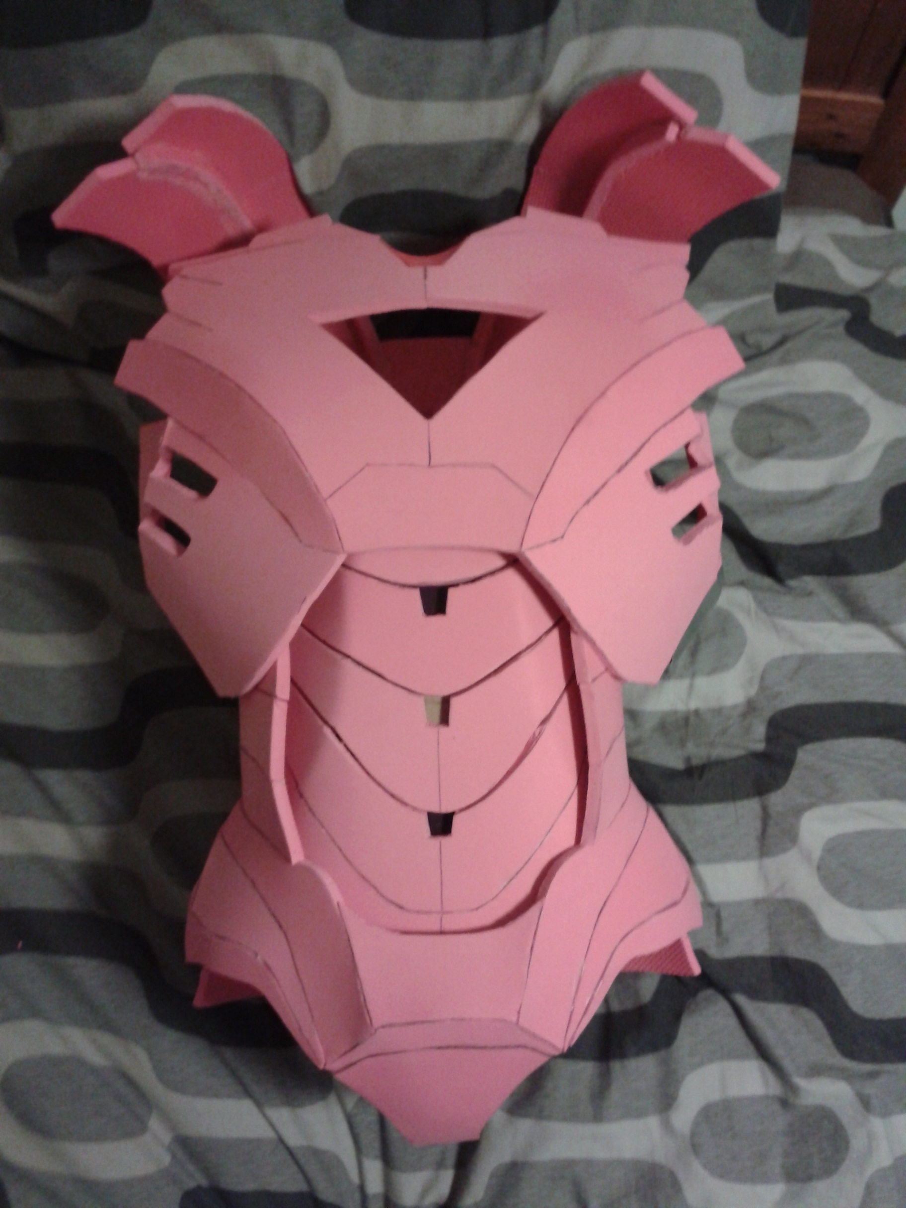

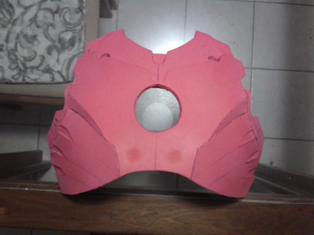

3.jpgNew Chest next to old.
4.jpgNew chest (Detail and extra work still needed)

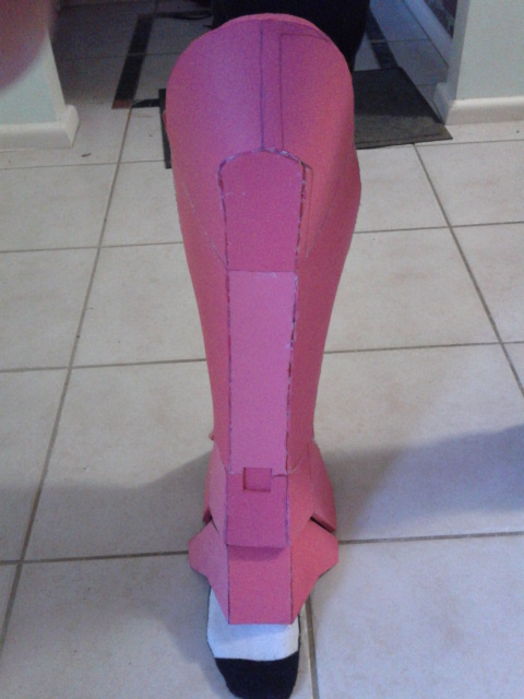

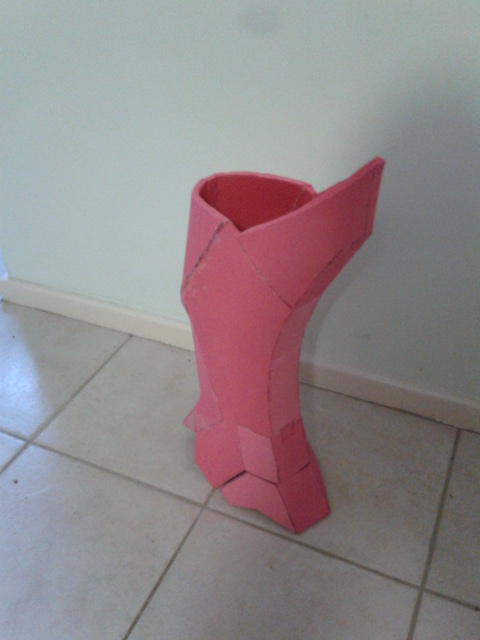

5.jpgLeg in progress
6.jpgLeg on (Hinge not added)
7.jpgLeg off (Hinge not added)

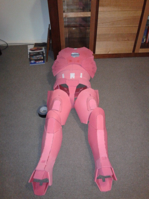

10.jpgChest, Hips, Thighs and legs (What's done so far)
Notes: Need to fix knee on one leg. Need to add little little drop in one Thigh. Need to finish Hinge joints and few parts on legs. Need to add grooves and detail to all (When all pieces are done)

Well I haven't been working on the suit as much as I'd like but usually 2 days a week and I manage anywhere between 1-2 pieces.. The first Shin and Thigh took me a day each but lets say 6hrs+ for thigh and 8hrs+for Shin. Then when it came around to the second thigh and shin I had a bit more of an idea what I was doing so about 5hrs+ each lets say..
I plan to use a hot knife to add the detail, I got the idea from Impact-Props.
Finished the abs yesterday but am debating whether to join it all as one piece or have it divided into two pieces.. I am using 9mm foam so I think it won't look neat enough to be in two parts.. (The prop used in the movie was latex and each section fell into the next giving the actor/stuntman better movement)
I have also just about finished the left arm..Just a bit more gluing 'Sigh'

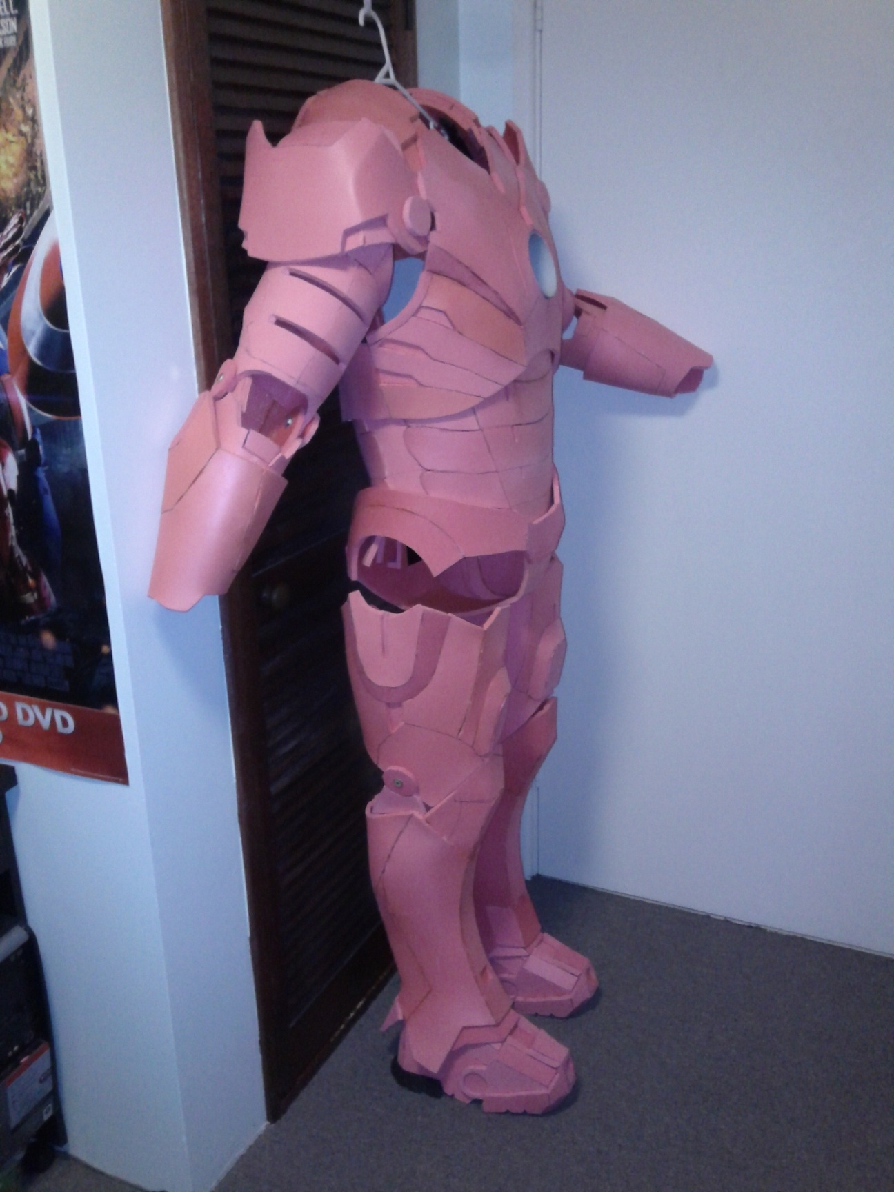

Just attached the back and chest together... I have to still add 1 of the dongles on the back and reshape on that's already added. After fitting on majority of the suit (All loose, not attached at all) I'm fairly happy, although the abs don't fit into the back correctly (I think it's because my whole suit is 9mm, and doing the 'step' technique where one piece sits above another makes one section in theory 18mm thick) So to fix this I may have to either take a tiny bit out of the abs as well as adding a little bit extra in between where the back and front join..
I have also made a harness made from straps and buckles which will join the limbs to the torso to keep it all in place.

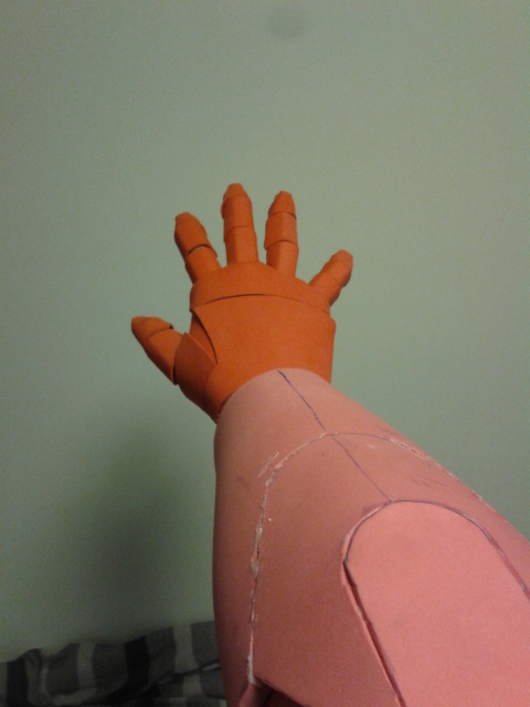

Right Hand (No LED Light) has been done, I still need to slightly adjust a few fingers but mainly just because of my big thumb and small pinki 'Ironic huh'

I was unhappy with the outcome on a few parts so just like several other parts I have redone them -
Abs: The abdominal templates were fitted to only fit 'against' the chest/back and not actually have excess that sat inside, I completely redid the abs and have reshaped it slightly as well as adding on extra levels.
Chest: I have redone the chest a total of two times now, my very first one 'which was a test and to get use to using foam' which I then replaced with a much more accurate chest but still with several flaws, I have just finished making the new one which I am much happier with!

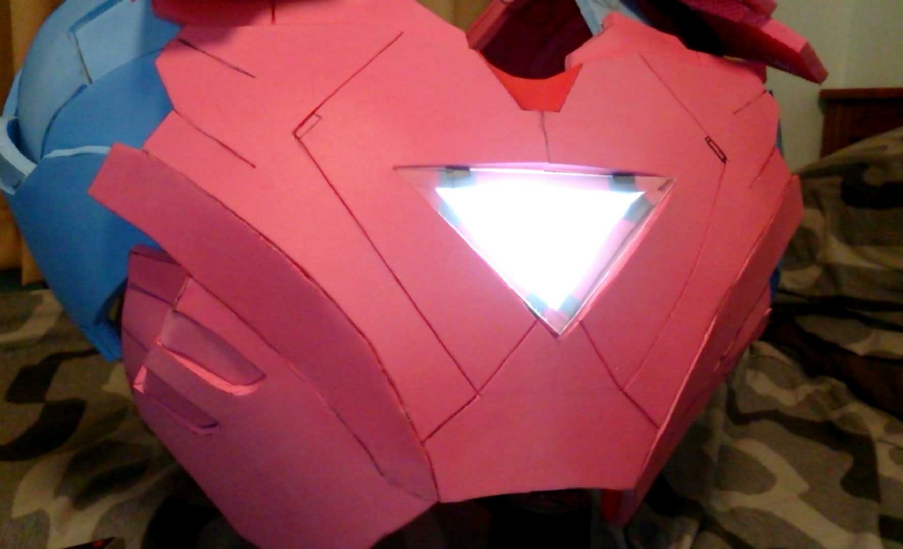

I have been working on the LED part of the Gloves and have found a perfect sized LED that only cost $1 on eBay, I am then putting over the top a clear (But foggy) Water bottle lid over the top to give it that glow effect and so you can't see each individual tiny LED. I am using a 9V D battery which will be attached into the forearm.

I've now finished both Biceps, I had to scrap my original one as it looked dreadful! So at the moment with progress, all parts have been made (Other than boots) But this does not mean I haven't finished fixing a few things here and there, I'm getting some Chicago Screws this weekend which will pivot the legs and arms. At the moment I haven't added the buckles and straps to join everything together...But I assume that won't take too long... I haven't added in the Shoulders yet as I need my Chicago Screws first so they can hinge and then actually be added onto the biceps.
Still need to add a section on the thighs with 6mm Foam.
Hi shadow,
First of all, I think you're very good at this foam thing, so congrats on the parts, they look really clean.
Now, I'm taking you have this build thread up for critic and comments .. and although your pep is clean, I think your parts are way too big on you. Biceps, thighs and the torso looks way out of proportions. That's my 2 cents .. do whatever you want with it! :)
I'd suggest working them out, 1 part by part, adjusting scale as you go .. and don't move up to the next before you figured it out! Same goes with the arms, do a full arm, then when you're happy on the scale, copy that on the other side.
Whatever you decide, keep up the hard work!!!

Thanks for the comments :) I was on the same boat as you with the sizing of the arms and other certain parts, my first thoughts when I recognized these were #1 I don't have too much meat on my bones haha, I'm rather tall but not wide :p and #2 I'm using the 9mm foam so that would make the parts slightly larger..
I am copying the templates for the scale of their print, I did not alter the scale at all, Dancinfool mentioned that the templates were designed for anyone 6 foot give or take either way (I am 6 foot and only 15yrs old!). I was hoping as I'm still growing and expected to get taller that I could have some room to still grow into the suit. I do plan to do a Mark 6 in future so it may be a good idea to slightly scale down the files to work for the thicker foam and my body build, for me all this is a learning process and I wish to gain more skill, knowledge and confidence with cosplays.
I’m happy with the scale of the torso section (Chest, abs, Pelvis) Although I have altered the shape and size of the abs roughly 6 times, twice since the last image was uploaded, I still feel it should be slightly skinnier :/ I’ve been doing all my hinging for arms, legs and shoulders and I’m prepping for painting before Chrissy! :D

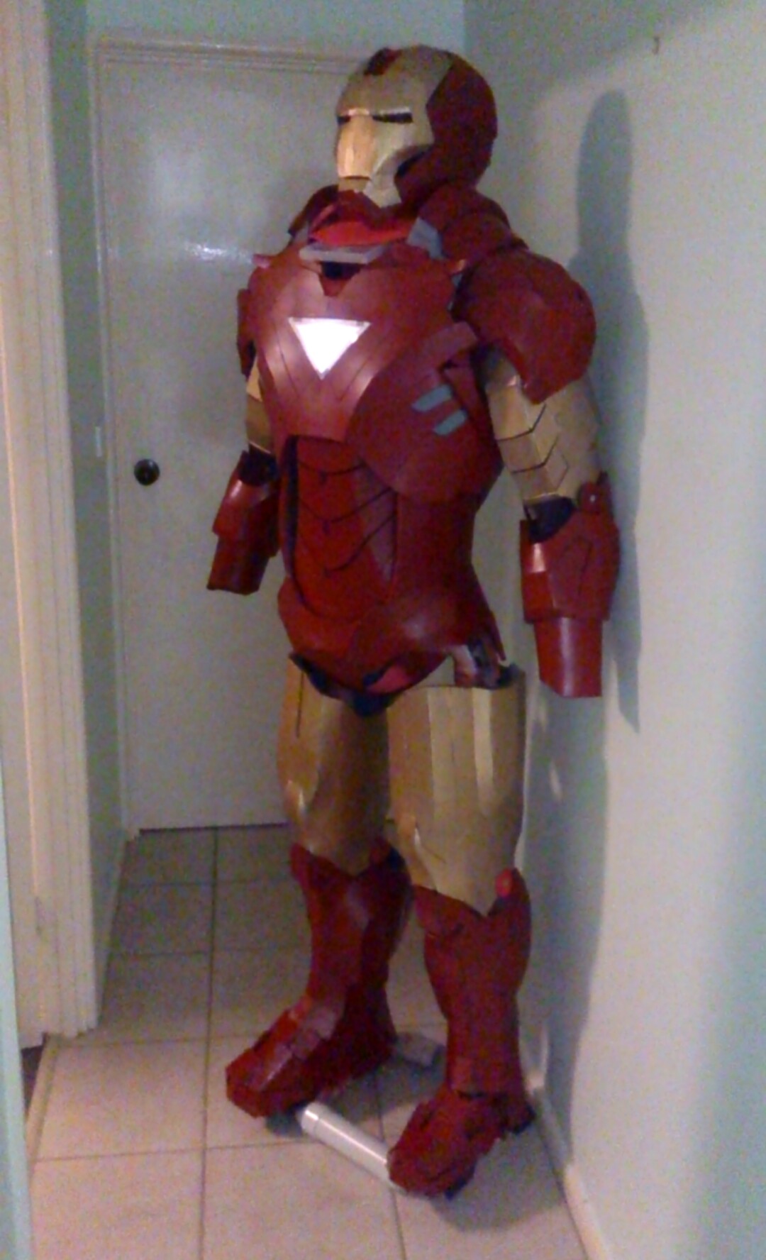

I am preparing to paint now, I just need a bit more spare time haha, I will first do 1-2 coats of plastidip as my sealer, add a primer then move onto my red and gold possibly followed by a clear gloss finish :)
I have just a few quick tweeks to make..
I need to reshape the shoulders a bit tighter and curved.
I need to re-cut a section on the thighs and re-angle them from 45' to 90' because it's making me look like I have fat hips :')
That's basically it, I did the boots a few days ago using a box I had kept with scraps that were a decent size and for scrap pieces it turned out alright, the boot was made from the 9mm which I thought would make it look far to bulky! But turned out pretty fair, still bigger than using 6mm but It's better than wearing Nike's with the suit haha. The back heels I used a black 6mm foam so It helps reduce the appearance of 'bulky'

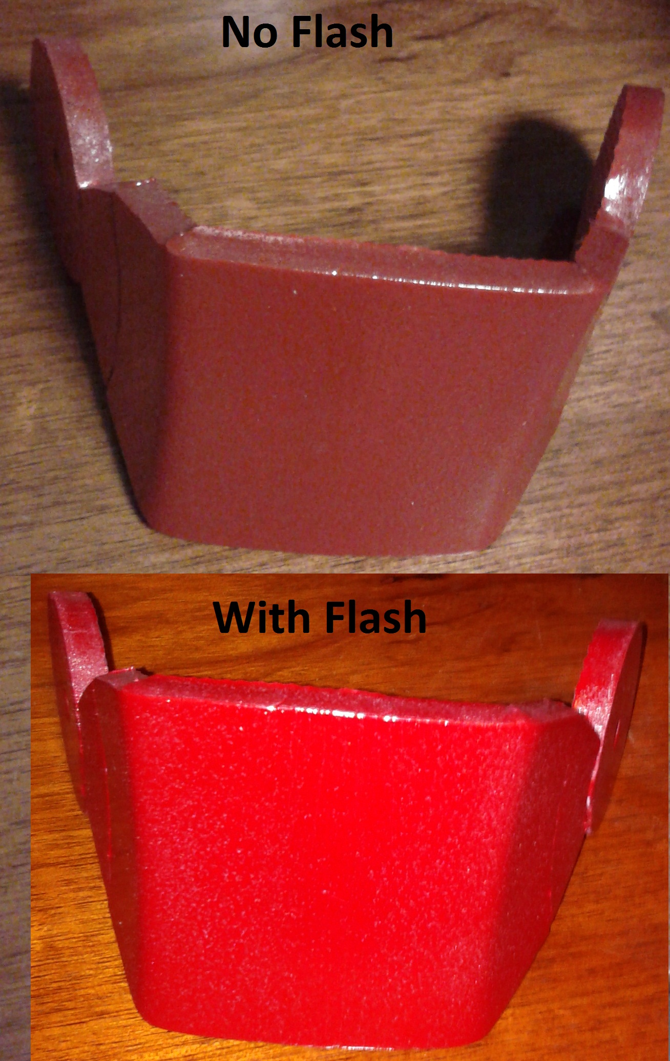

I got around to spraying some Plasti-Dip and testing some colours. I have sprayed 1 can of Red Plasti-Dip on several pieces, I went back to get more cans and they had sold out! Just my luck! More is meant to come in this week 'sigh'
I decided I will test out the colours I bought on one of the elbow pieces, the primer works well although I feel the Red I chose is slightly too dark :(
It looks rather dark in person but when I took a photo with the flash it looked a whole lot red'er..? When I go down to pick up more Plasti-Dip I'll have a look at a better alternative of paints.
I also constructed a working arc reactor made from a torch, PVC pipe (Which size matches the cut out of the foam perfectly!), a paper cone used to fill in the size of the torch to match the PVC, clear plastic from the back of a DVD case and finally I cut the bottom of a bottle of soft drink to use to hold in all in. This was simple yet very effective - I may make a photo of the construction.

Around two weeks ago after I FINALLY finished all the parts with the Mark 3 and all that was left was the PlastiDip (which I have now done 95% of the parts) the only thing left was painting.. I don't have a very open time schedule for this as I myself won't be doing either of the Red and Gold to begin with [I still have to practice a little more, that's why it was good I did the PlastiDip and doing the Primer for some pieces ;) ]
I did a fair bit of research on others doing the Mark 6 build (Mainly Stealth and Drack) along with several others, all used similar methods with some variations from each separate builder. I already have thought out how I wanted to attack this build...somewhat..
Just from the 2&1/2 weeks I've been working on it I've build the Cod Piece, Abs, Back and Chest (Insanely fast compared to the Mark3 plus the parts are much cleaner) I've joined the Abs and Pelvis together into one piece other than the abs plate itself which is removable for easier accessibility.
Unlike my Mark 3 build I'm making the Chest and Back connect with Buckles and Velcro for if I get around to it I'd like to make a Mark 4 chest that can interchange with this suit.

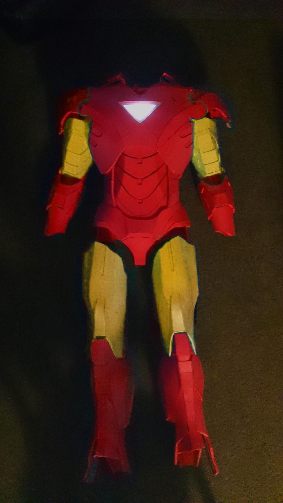

1395830769981.jpgMark 6 Chest after I started adding 'some detail'DSC_0030.JPGFull suitDSC_0069.JPGSuit test fit (Fits perfectly!)
Any comments would be appreciated! :) - If I plan to get better at this line of work I need to know the pros and cons of what I'm doing..
