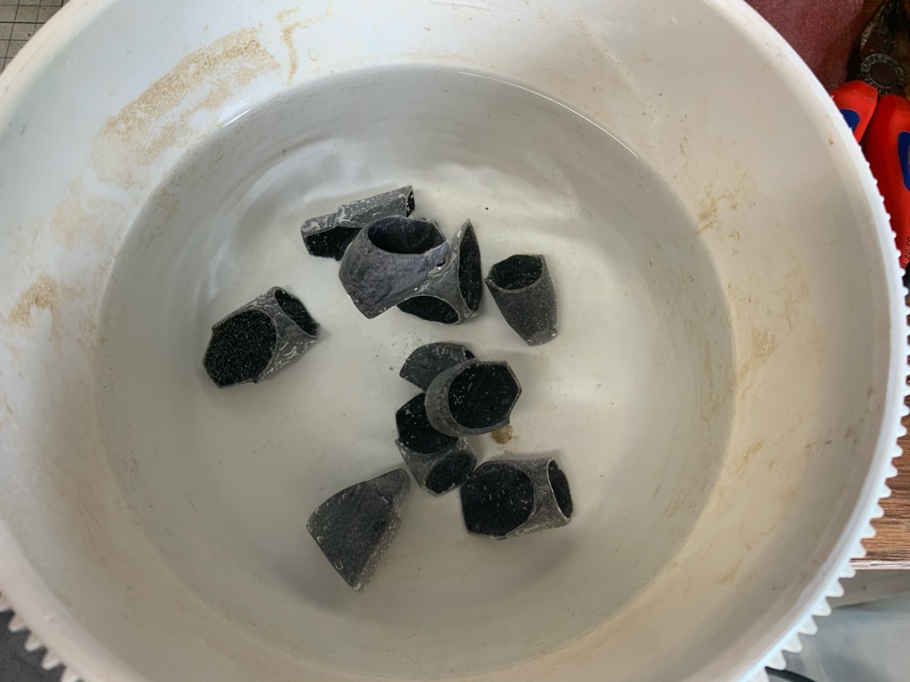

I then cleaned everything in water
...and fixed the pieces with some duct tape on large toothpicks

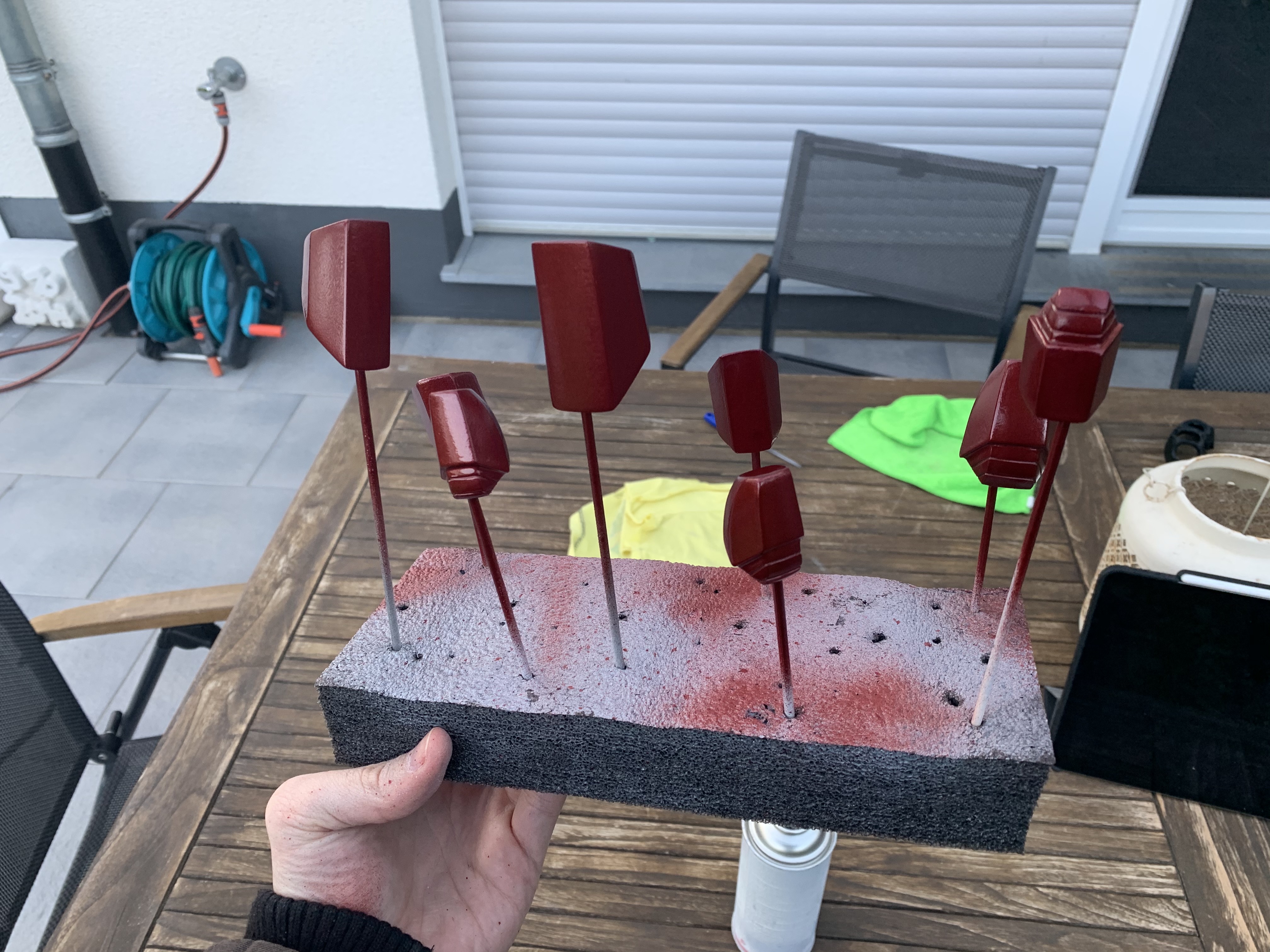

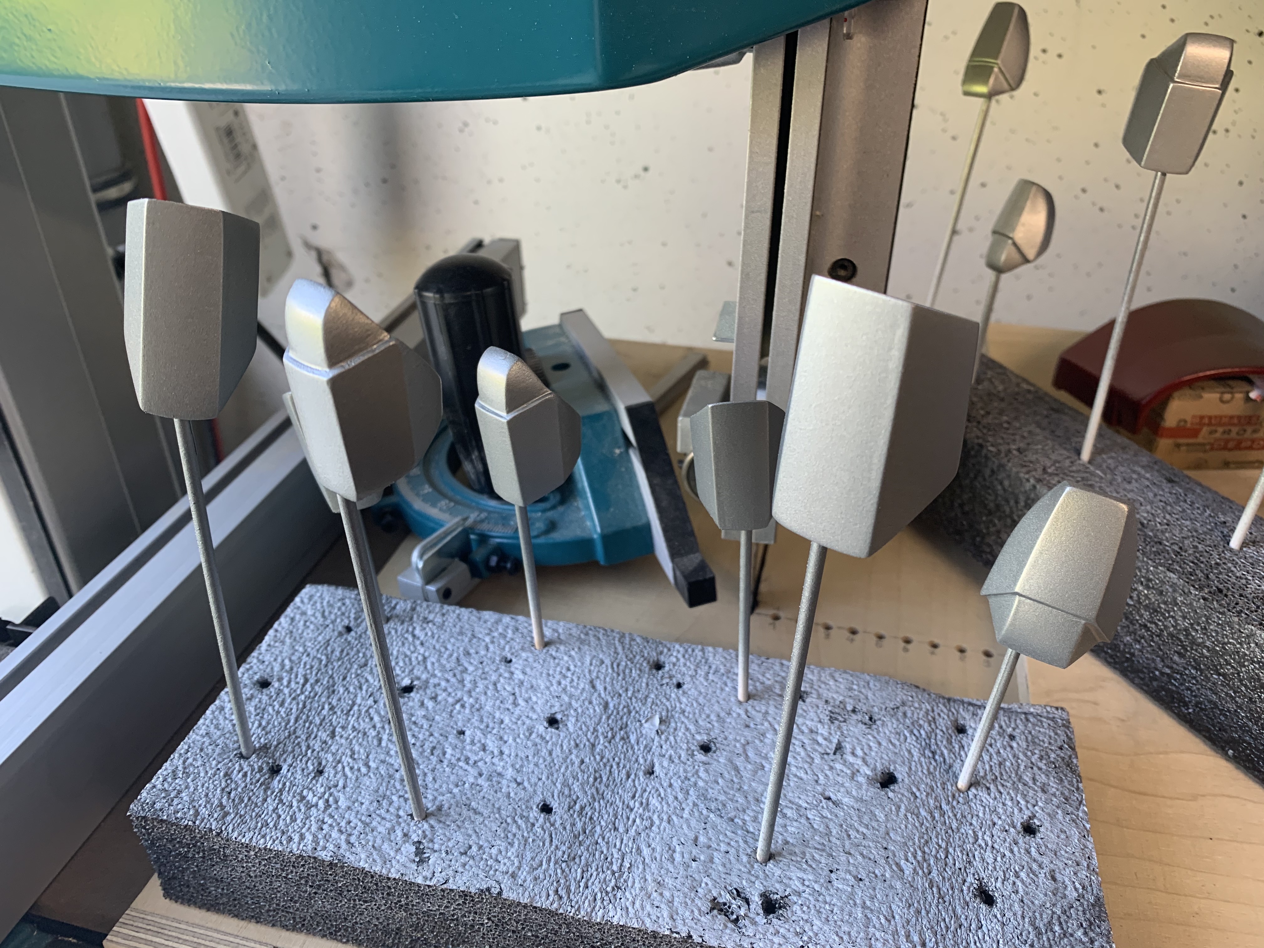

Some more sanding and a second coat:

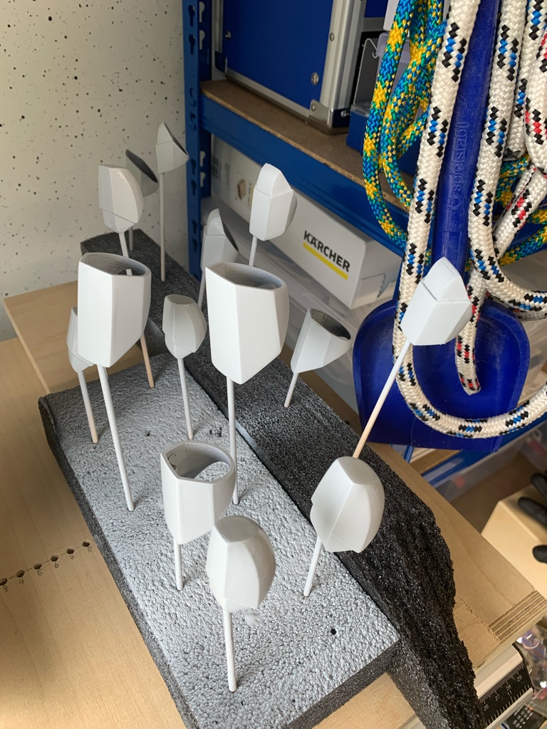

For the best effect, I always paint my parts silver first. That way the red and gold have a much better metal look later.

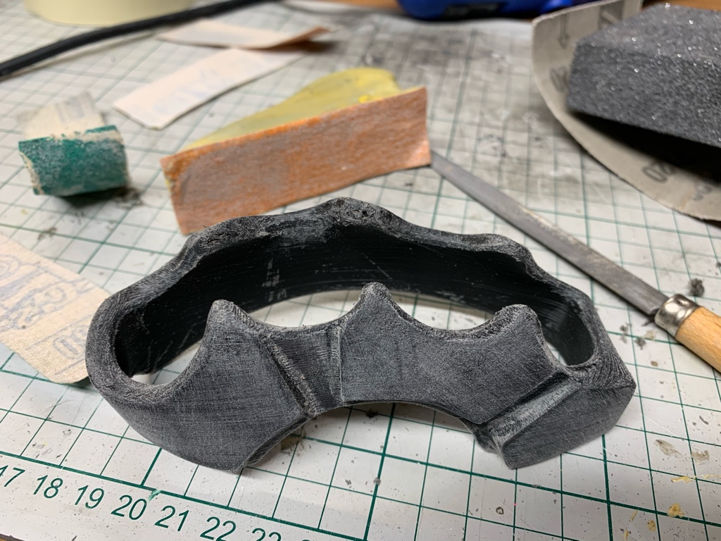

1. I sanded the fingertips with 400 grid paper before applying the first coat of Silver
2. Now I recognized that I missed some detail... I should have printed detail lines for the finger joints... so now I had to add them manually with a file:

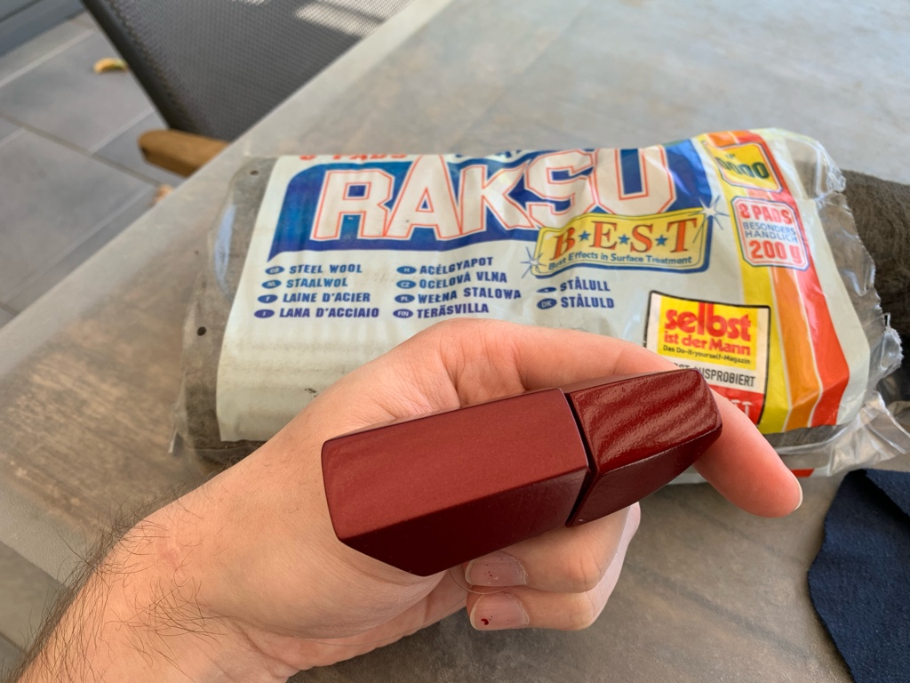

3. after fixing some errors I decided I can apply some color :)
The red is Multona 0412
