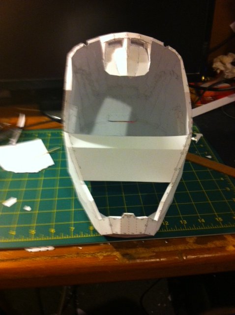

So, because I am apparently a glutton for punishment, I've decided my first full suit will be this beauty:
I'm hoping to document my progress here, if for no other reason than to help me keep at it to the end!

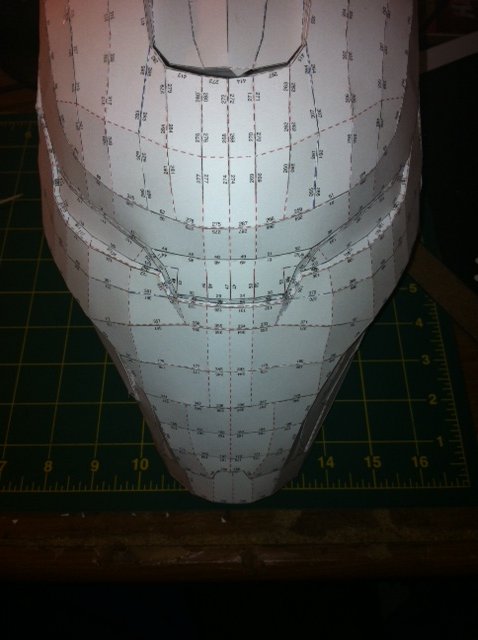

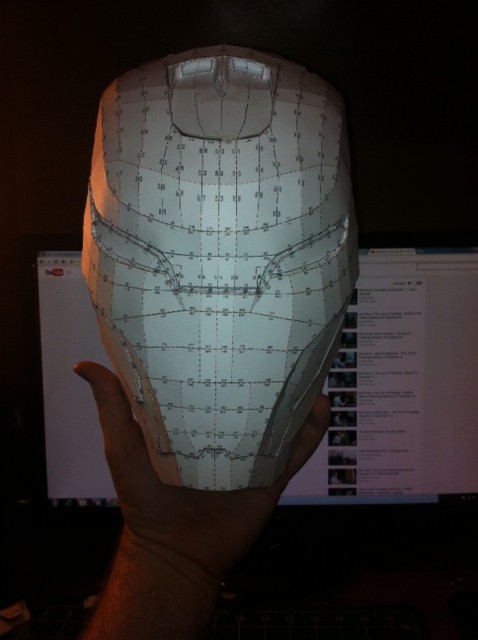

Since it's usually the most interesting part, I naturally started with the helmet:
and a little further on:
Those vents were a pain in the ass, by the way. As were those ridges around the eyes and the groove on the helmet, but I got em in!

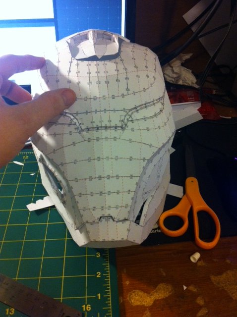

Now, when I put the faceplate on, it doesn't seem to fit quite right, but that may just be me trying to hold it on with one hand and take a picture with the other:
The plan is to modify the suit once built. Thanks to a horrible pun between my daughter and I, I'm planning on painting the whole thing heavy metal style, with spikes and stuff, and replacing the arc reactor with a speaker (probably with a light ring around the outside). The idea being that we can play some heavy metal music through the speaker...say...Iron Maiden? :D
Obviously going the paper route, but pondering going the smooth-on route instead of standard resin/glass/bondo. Any thoughts? I have to attach the face plate for hardening, then remove it later...do I just attach with masking tape before hardening? Will the tape being there interfere with the hardening process?

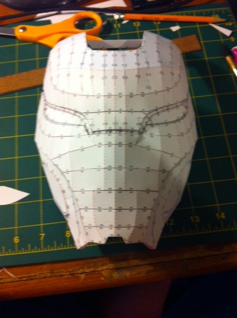

Iron Boobs...er...um...the chest!
Will probably just cover up the arc reactor hole rather than assembling the pieces that go there from the file. Some of those strips are less than 1mm wide with tabs on both sides; no thanks!
I hate the thin strips of pep so very very much. I deleted them from my cyberman build, and ended up taking a lot of time with bondo and dremel. So i think it depends on if you're going to trade off with some other technique to fill it in, or take the time to do the 1mm strips. For me I'll stick with the bondo...
cant wait a it to see the final product. Considering a similar costume for my daughter. Yours is coming along nicely!
Irishpanda
It's a bit of a catch-22...we do paper over foam for the extra detail, but that detail so often comes in the form of skinny strips of pep that feel like they will tear if you breath on them wrong. When you omit pieces like that and elect to add them later after bondo, how do you normally deal with the gap it leaves? Just slap some extra card behind it? Do you just connect the parts on either side of the narrow bit directly?

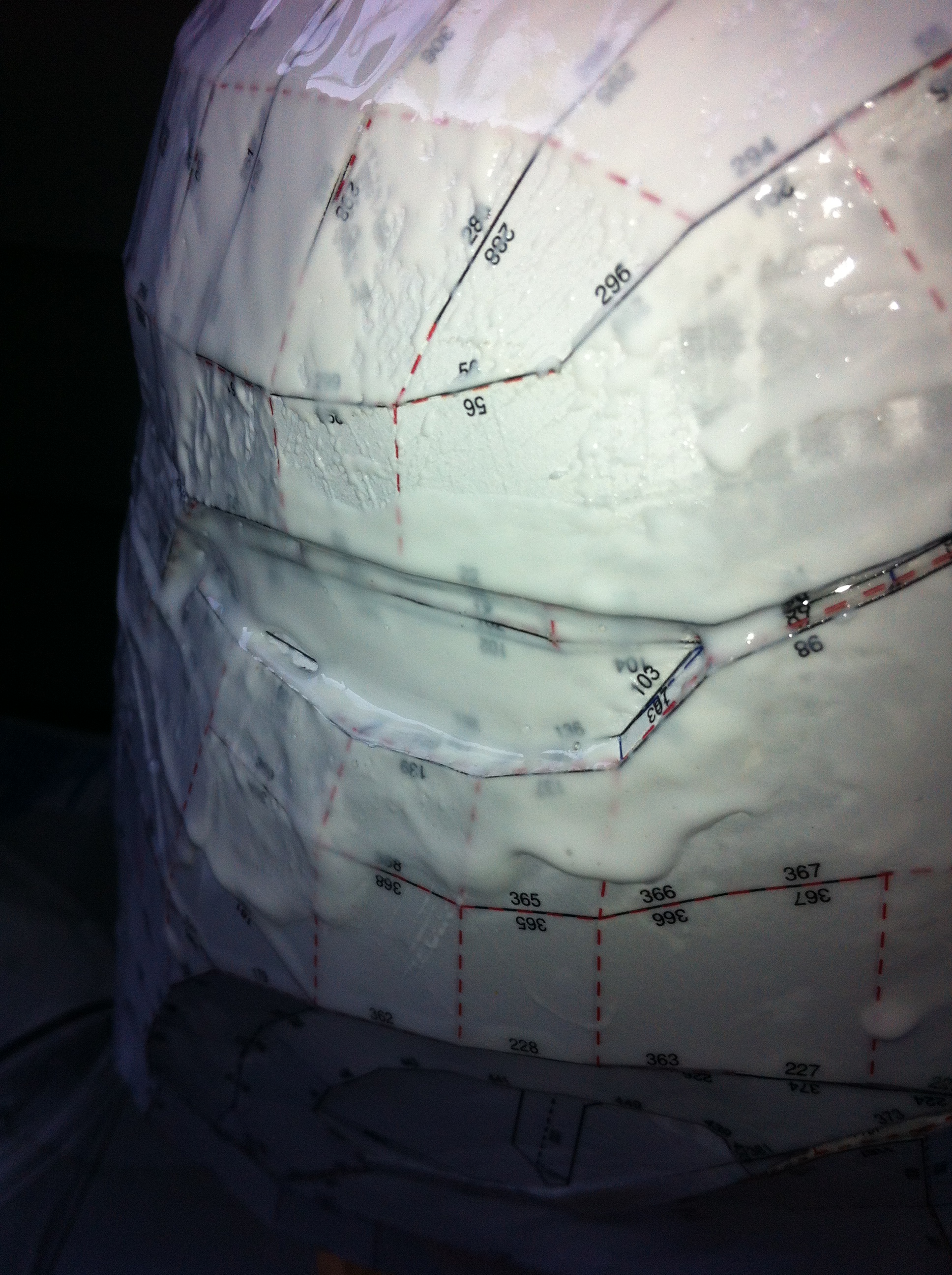

TIL that when Smooth-On says a pot life of 3 minutes, they are not kidding:

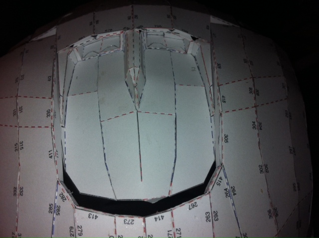

I was part way through my first small batch when it suddenly started gumming up there on the side. You really have to work fast with this stuff! If I do this again, I may just order some of the ROTO from the net, or at least something with a slightly longer pot life. I put a coat (though probably far thicker than was needed) on the outside so that I felt comfortable removing the supports on the inside. The big pitfall here was the edge where the faceplate attaches to the helmet. The pep file was made like many other helmets like it, with the faceplate separate, and both faceplate and face opening having a flat edge. This formed a ridge inside the helmet that was a bit of a pain to work around. Eventually though, I got the inside coated too. This thing is way heavier than before, but I swear this thing is hard enough it could stop a bullet! At least now if my cats knock the thing down, I dont have to worry about it getting destroyed now.
So what do you think? Did I overdo it? Should I just sand down what I have there, or bondo on top of it?
Mclabop
Fill in with a removable support. Card works, or if it can be shaped later just leave it open. It's what I did for parts of my helmet. Tho I still haven't gotten my vents sorted the way I want. So I need to go back and do that.

Well, support is no longer an issue, since I have plastic on the inside and out. Now I just need to smooth and shape. I'm assuming from here in it's just good old Bondo on top of this?
