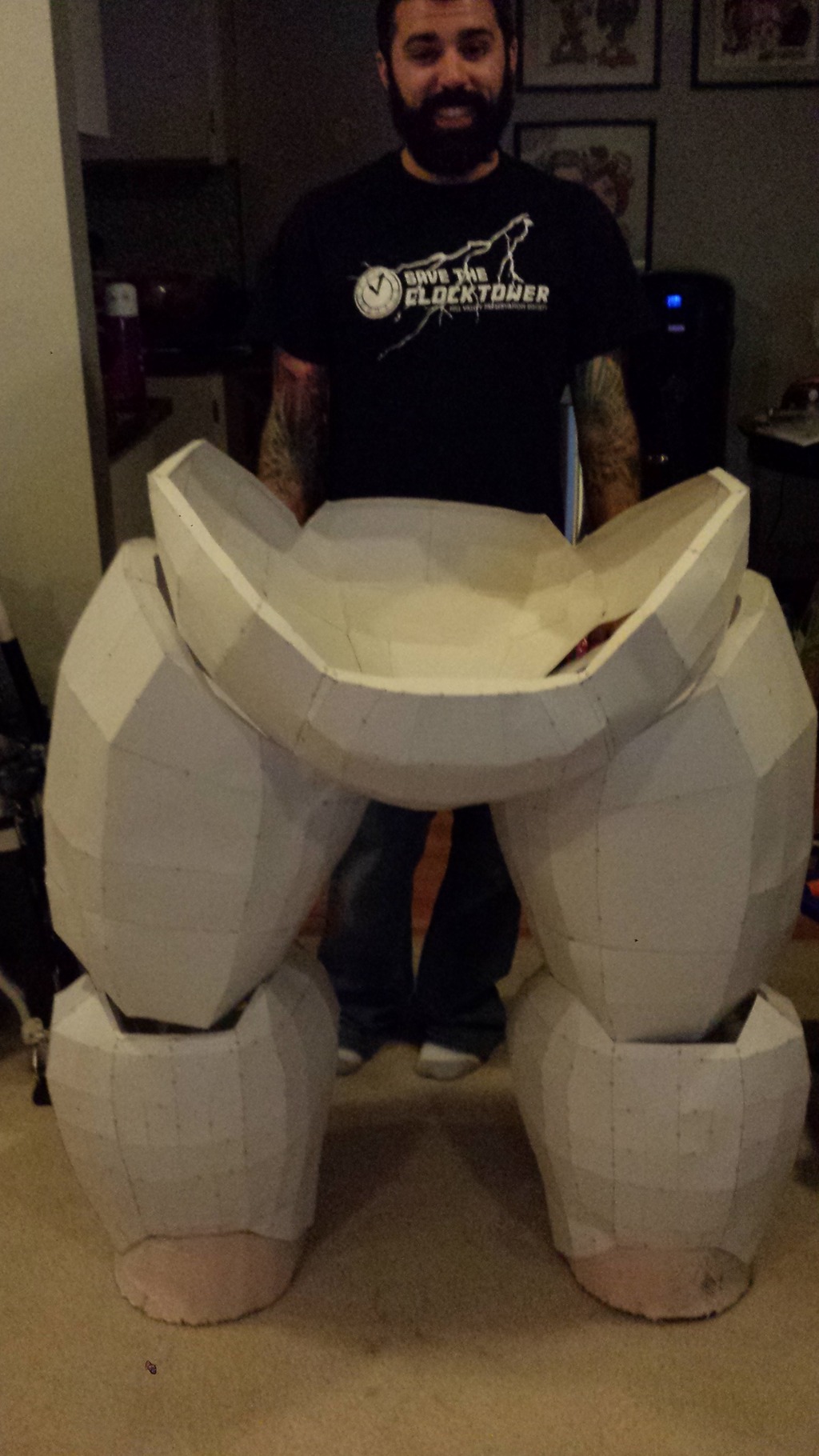

    Here are the legs and cod all pep'd out. I also have dry wall stilts to wear for this one. I will be 7.5 almost 8ft tall.

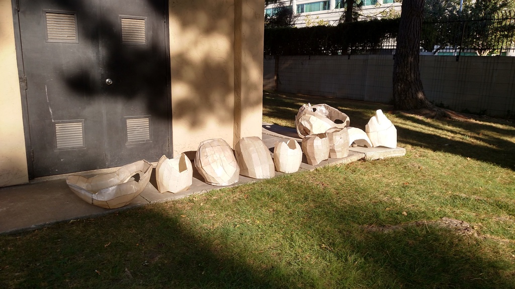

    About to fiberglass everything

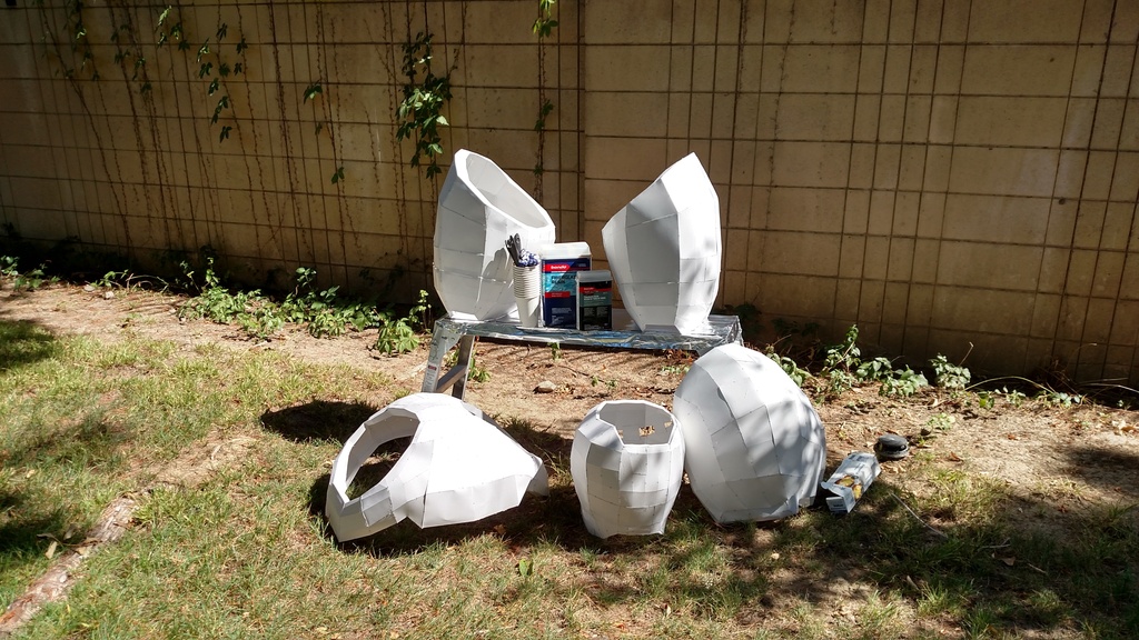

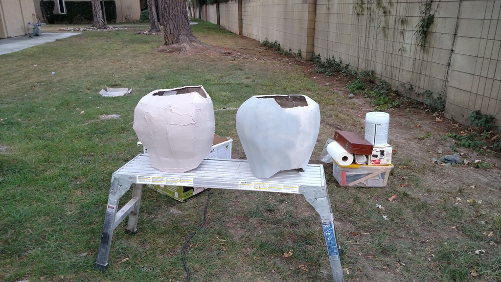

    Here is everything but the abs all fiberglassed and drying.
    Starting the bondo

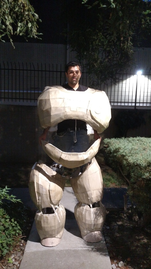

    Here is a quick suit up just to get the sizing for the abs
    And here is where I'm at now. I just taped everything together to get a feel for the real size. And I have my little helper there so you can really see how big it is.

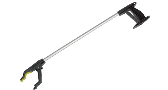

    This looks like it will be cool. You got any plans for the arm extensions?
    If not and you want something basic, I'd recommend using one of these litter collectors, and making appropriate modifications to the length and the claw to act as a 'skeleton' for the hands. I've been making plans in my head for a future build with extended arms and came up with this as a possible method for having reasonable control of both hands without spending too much cash.

    Turtlespoon, I have something similar in my head for the making the fingers articulate. To control the arms I was planning on doing something like they do at GiantCardboardRobots (You can see it easily in the banner pic) Since Baymax has big round joints on the arms it should work out well. I will post pics when I get to building that part and always welcome help/feedback!
