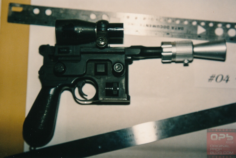

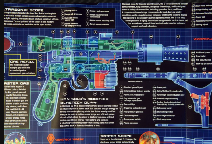

Blueprints of the in-universe blaster had to find a reason for that part to be on the BlasTech DL-44, so it was labeled the "power pack release lever."
Marcos22579
Yes, power pack release. The magazine plate holds the power pack in some way. I imagine it would eject the same way it does on a M-712.

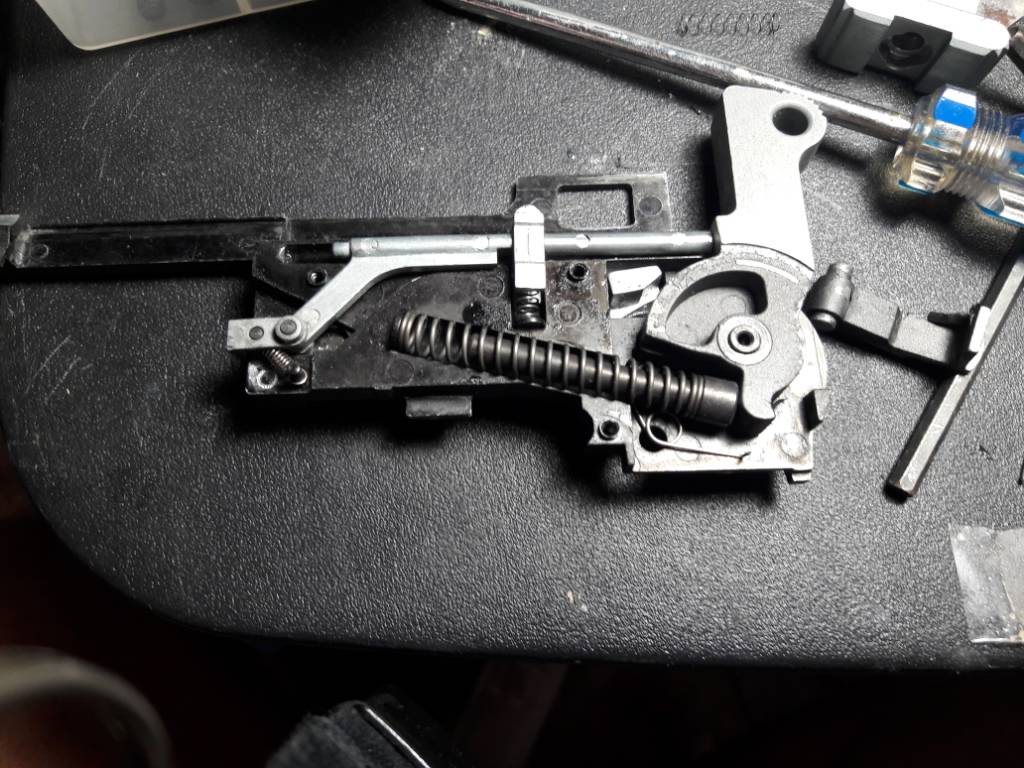

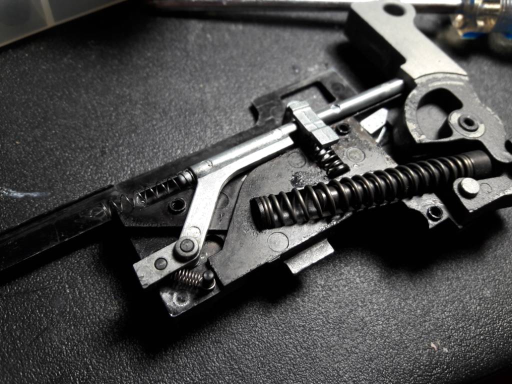

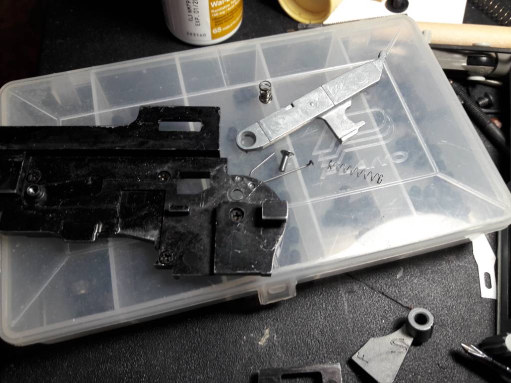

I disasembled my Umarex M712 blowback for the paint process of my DL-44 and saw that the trigger and bolt are contained on a two part frame held by some screws. Two compression springs. One for the trigger mechanism and a small one to return the bb feed to the original position. The bolt is a separate part with plastic front held together with a long allen screw and the bolt square thing wich name I can't recall. Two different compression springs inside the bolt. The main long one and a small for the blow back motion. I will look on my computer backup for pictures later today.

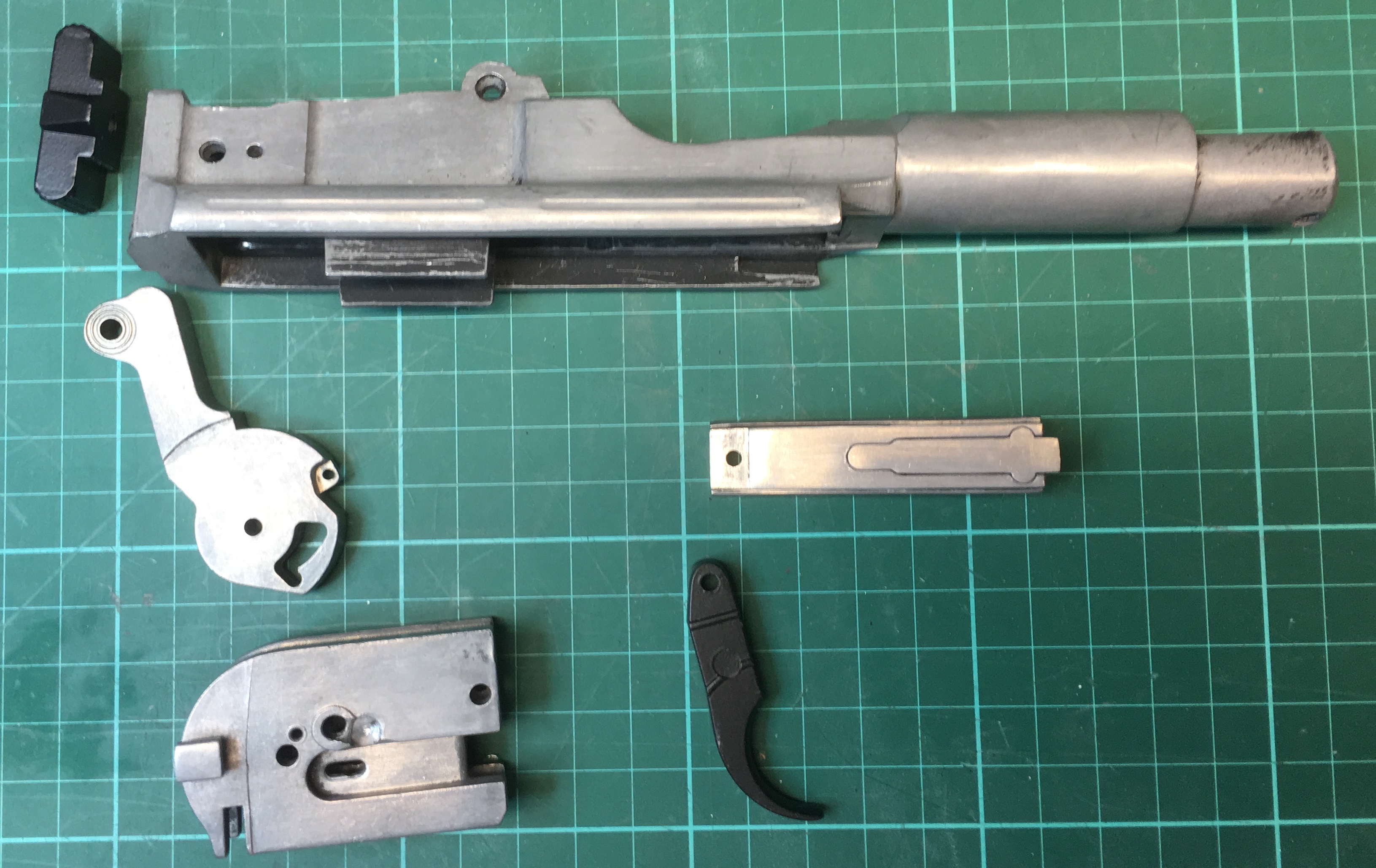

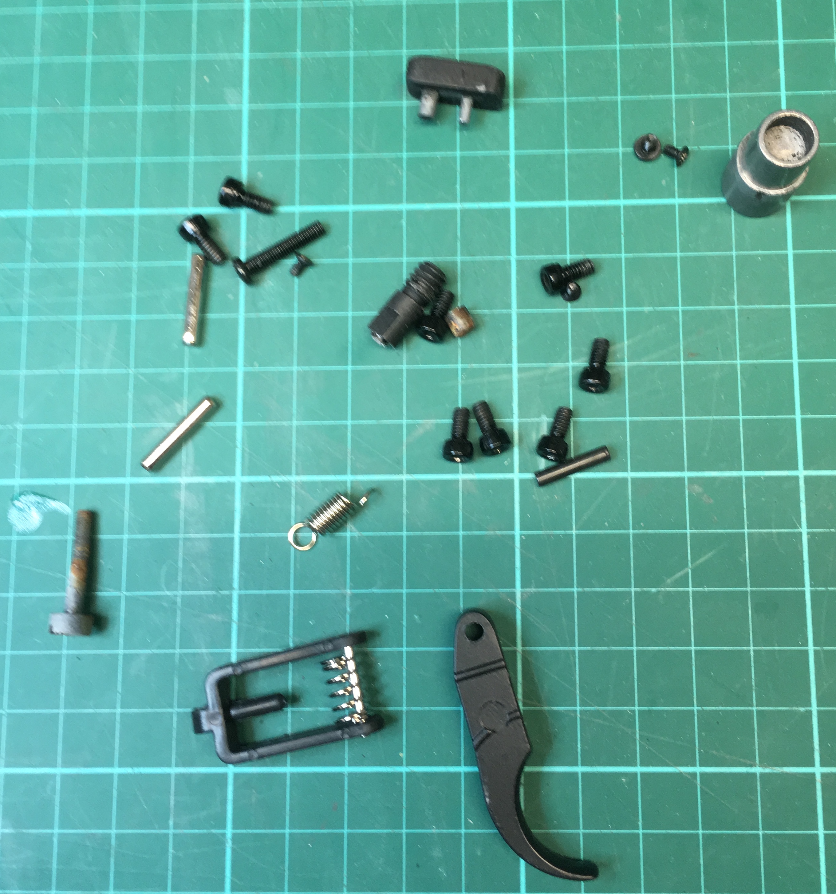

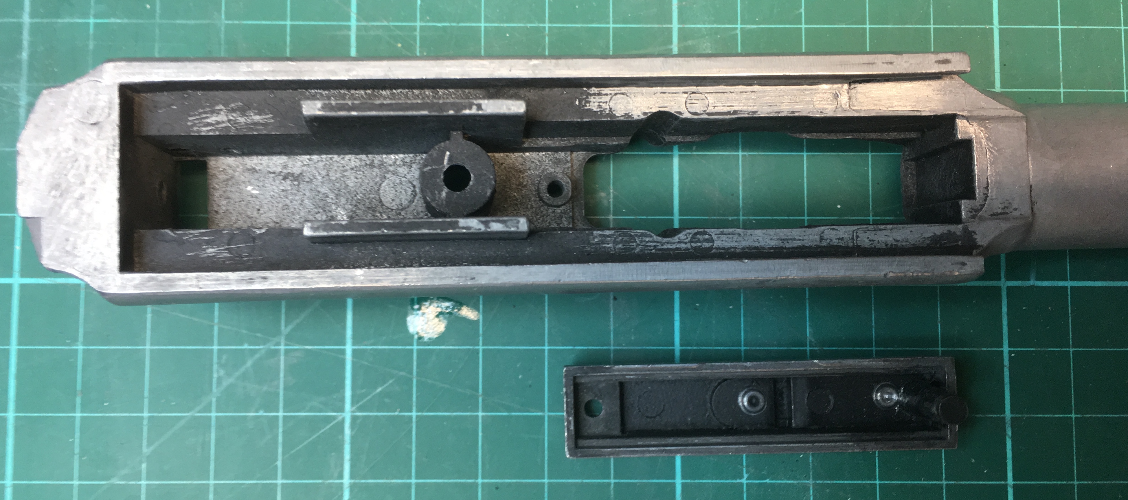

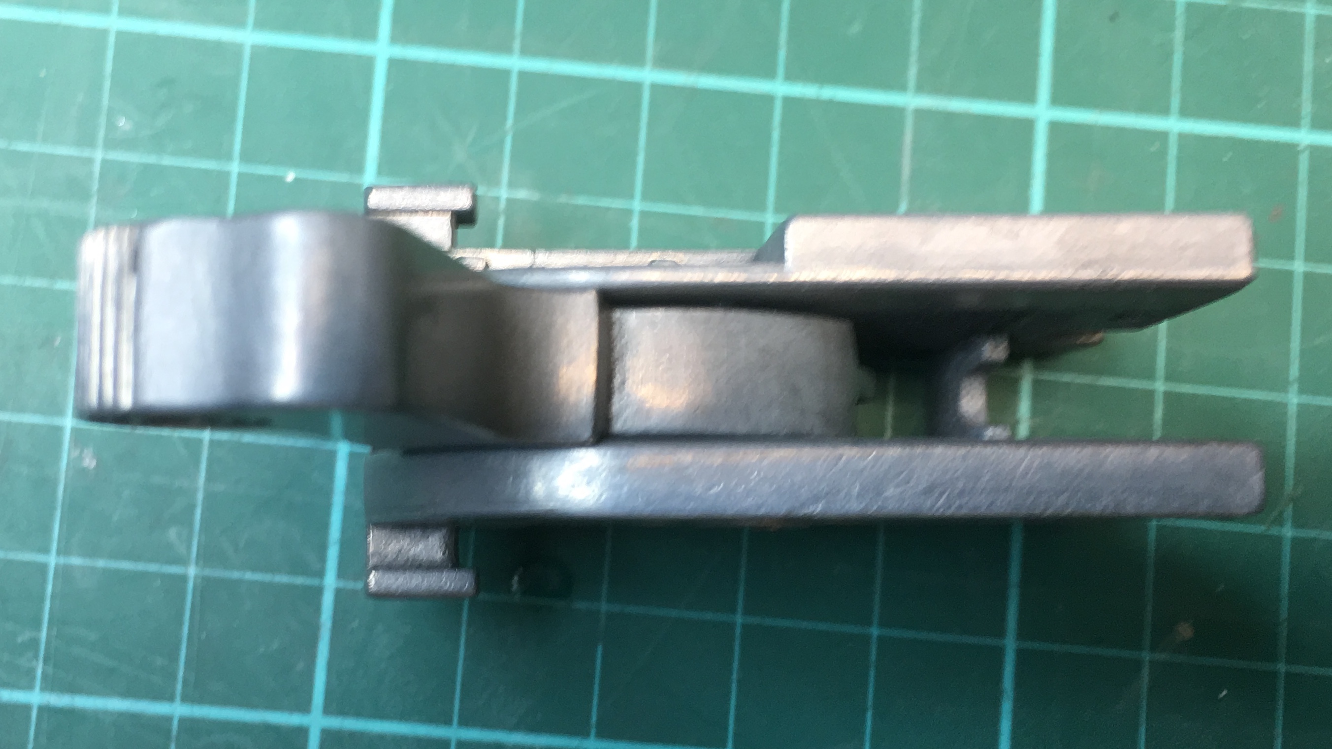

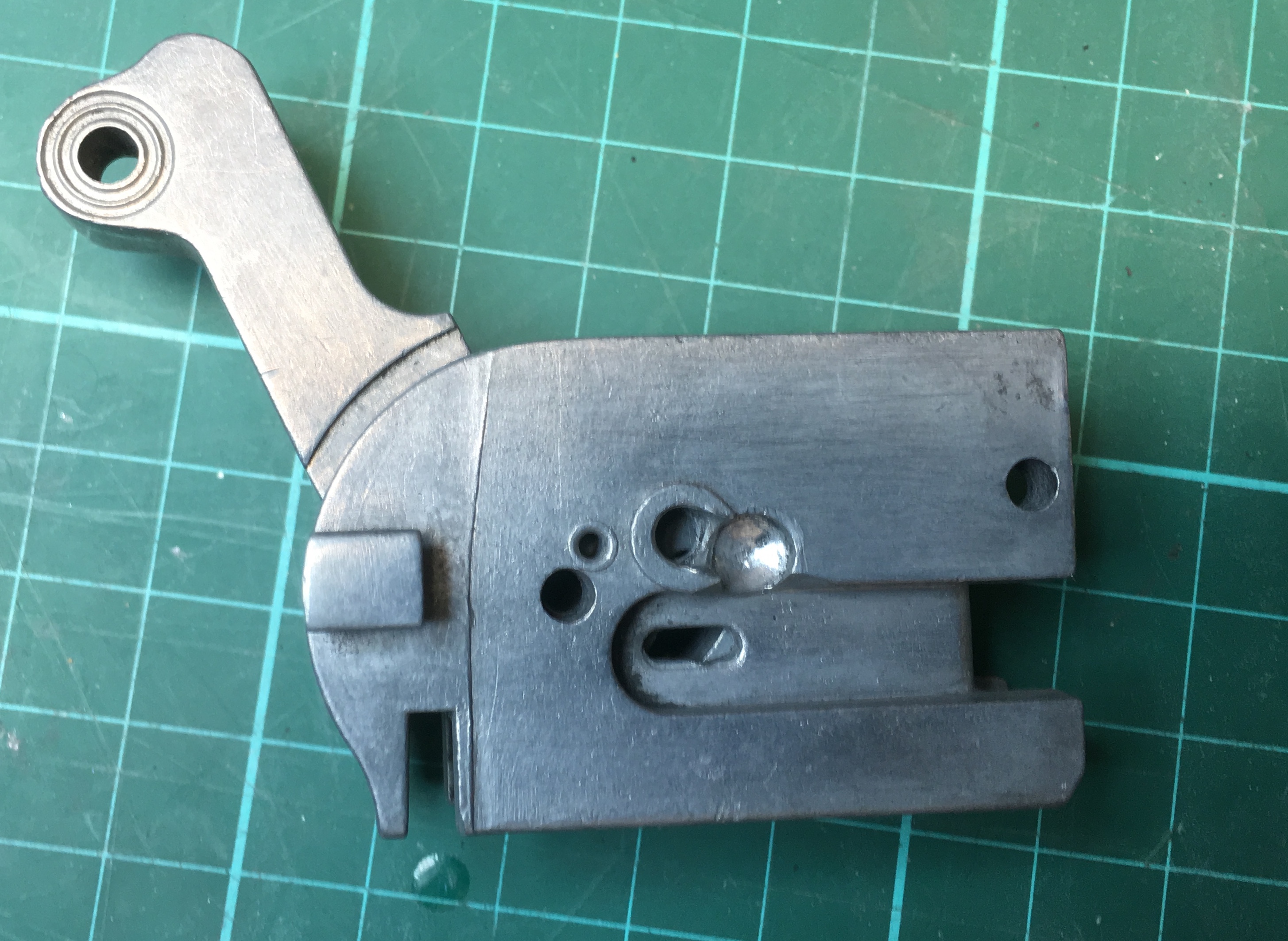

Here are parts from the Master Replicas Han Solo ANH Elite Edition.
I can't tell you how it goes together as don't have the frame with me.
I took it apart long ago, and the frame is still at the shop, waiting for the grille to be machined off.
As you can see, the trigger & hammer are movable due to springs and a piece of plastic.
The bolt is just 2 pieces as shown in the photos: just what we need to see, not a working bolt.

I don't like it that simple. I am used to the Denix bolt clacking sound and trigger.
Sent from my moto e5 plus using Tapatalk
Dann
It's definitely interesting to see how they designed it, but yeah, I'd also love to be able to pull the bolt back!
Still, it's definitely not a deal breaker, as long as the trigger and hammer still function, and they're built tough, with at least as strong a spring as the MGC, preferably stronger.

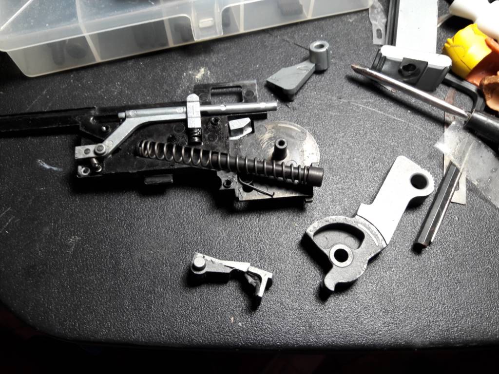

Here are my pictures of the Umarex M712 insides.
Way too complex. Very similar to the real gun in functionality and movement. It has at least 3 unnecesary movements because is a blowback action automatic.

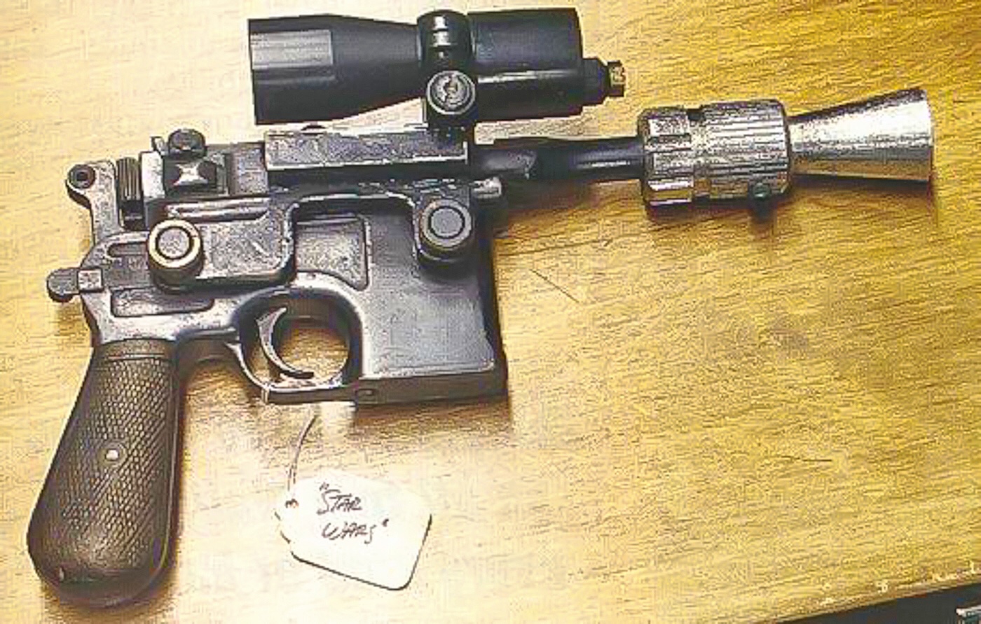

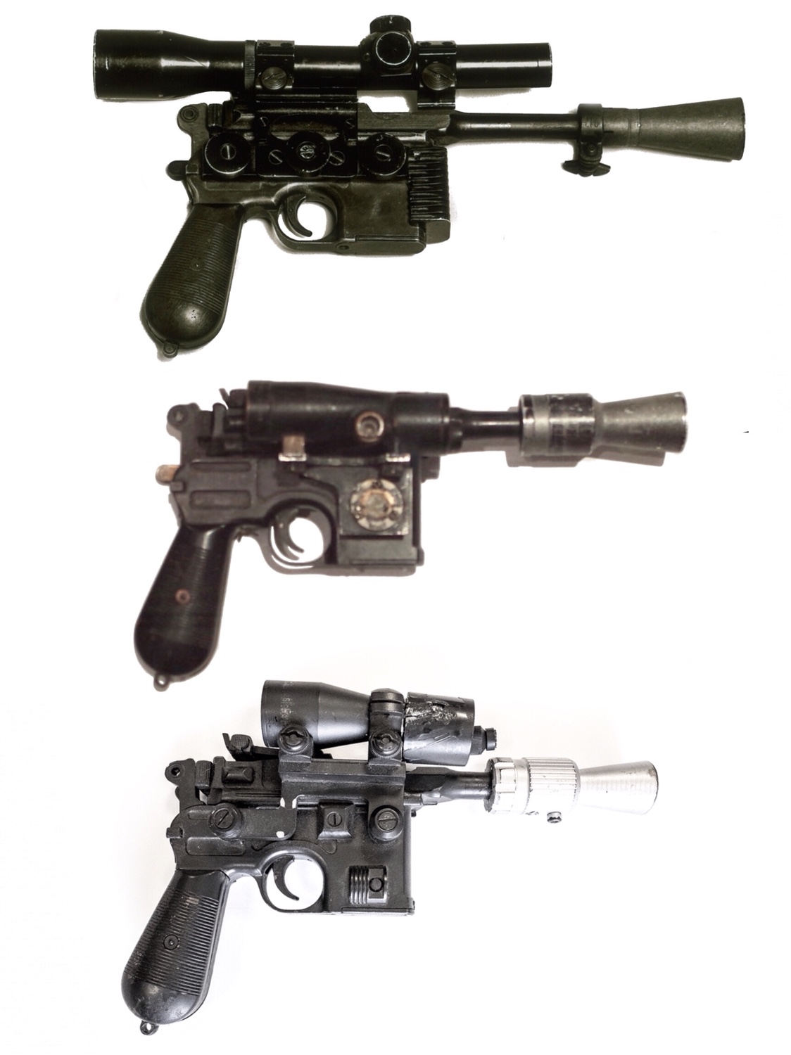

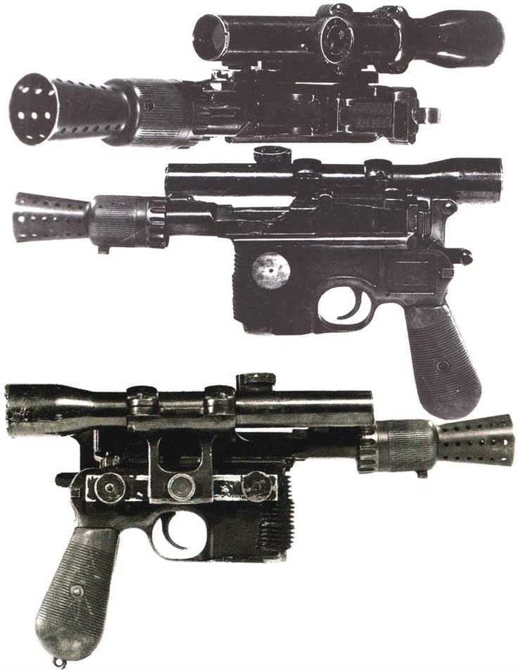

They used real live fire c96’s for the hero prop’s in all 3 original trilogy’s. For the hero prop in Star Wars specifically from my understanding they only built one and it was on a live fire c96 not an MGC..
So hopefully the goal is a real deal c96 replica as that would be epix
Davy Jones
Gotcha. I know both these guns were MGC replicas but the ANH blaster was a real gun. Which blasters in ESB or ROTJ were actual Mausers then?
chubsANDdoggers
This here is Luke’s bespin on a real c96..
And this I believe is the live fire from ROTJ (or someone’s duplication of it - not 100% sure)
I could be wrong but I don’t think there is a picture of an MGC bespin anywhere. I’m sure they must have built a few of them though..
These were the only MGC builds that I’ve seen..
