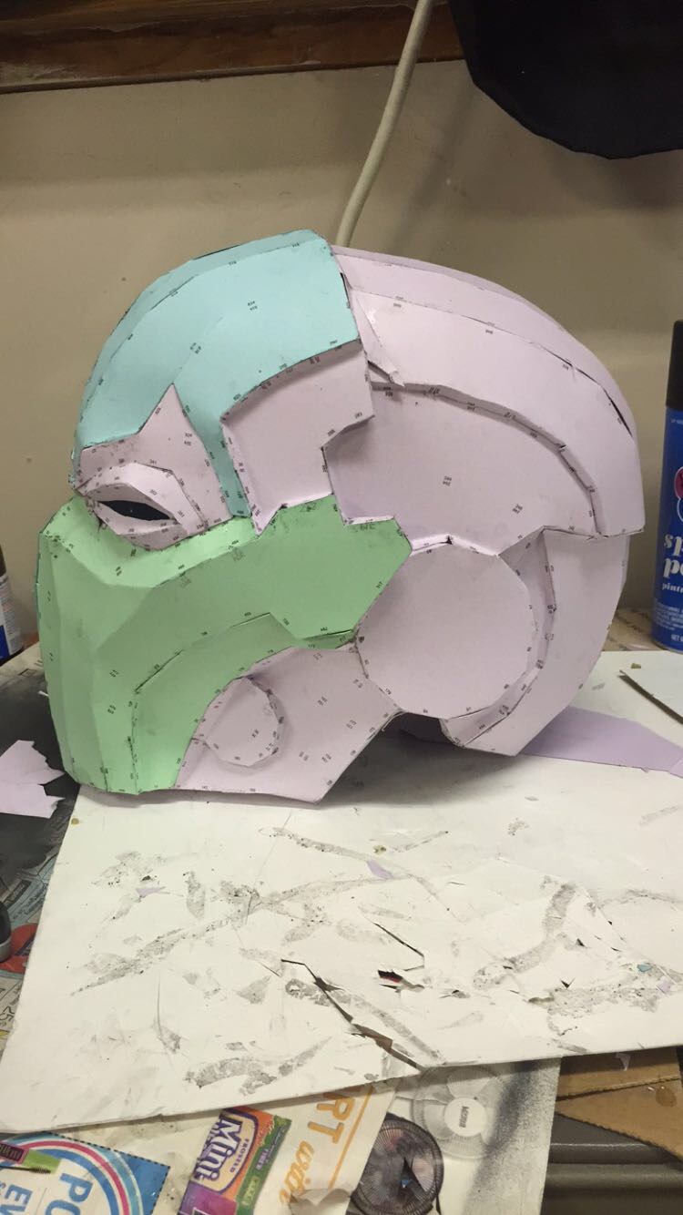

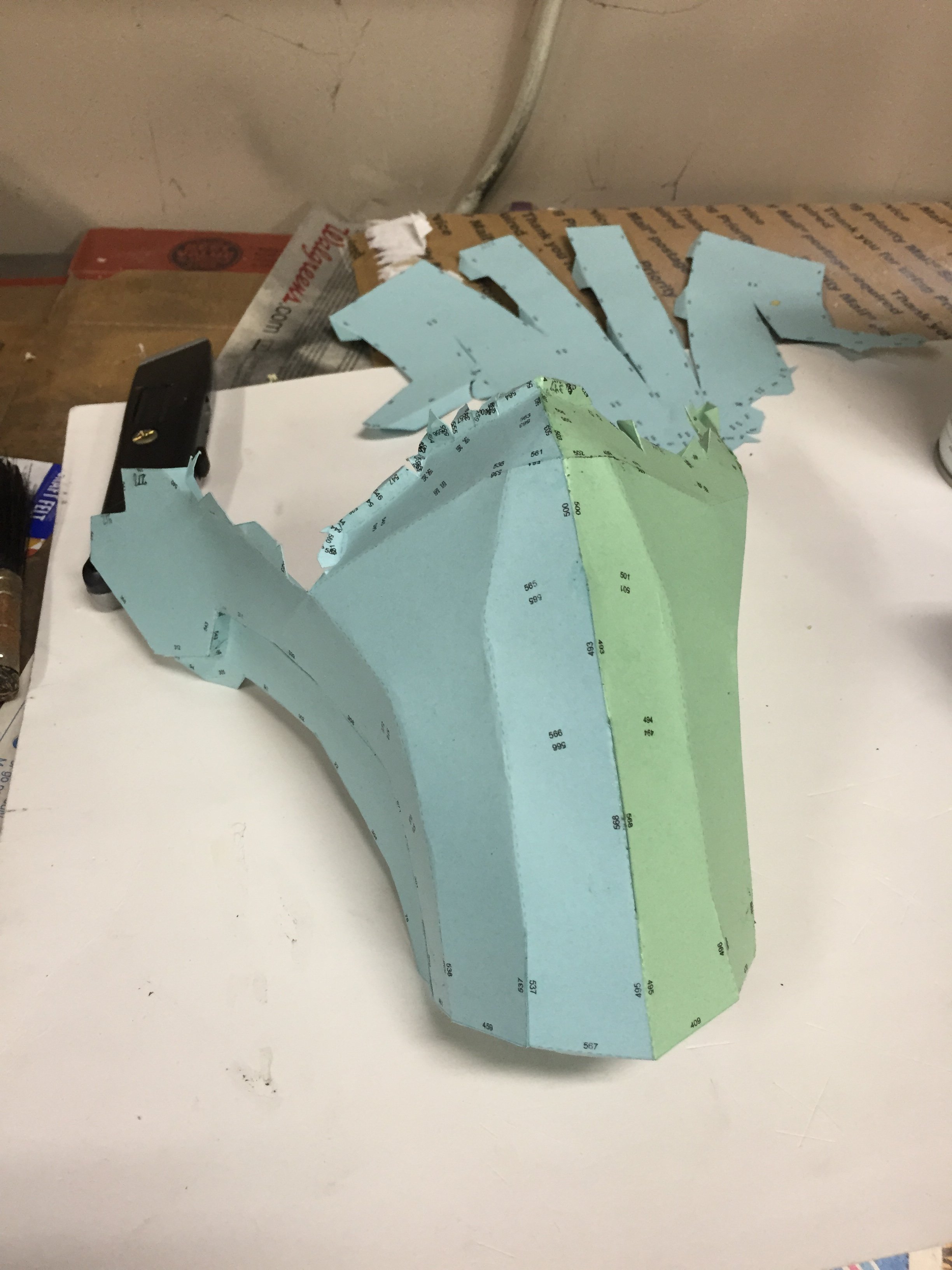

    So, because I started this project a few months ago, here are some pictures from that time frame, up until now. Note that I did not have plain white cardstock on hand, and as a result had to use multi-colored paper :p
    The final colors will be gray and black.
    IMG_3632.JPG IMG_3580.JPG IMG_3581.JPG IMG_3607.JPG IMG_3611.JPG IMG_3631.JPG IMG_3661.JPG

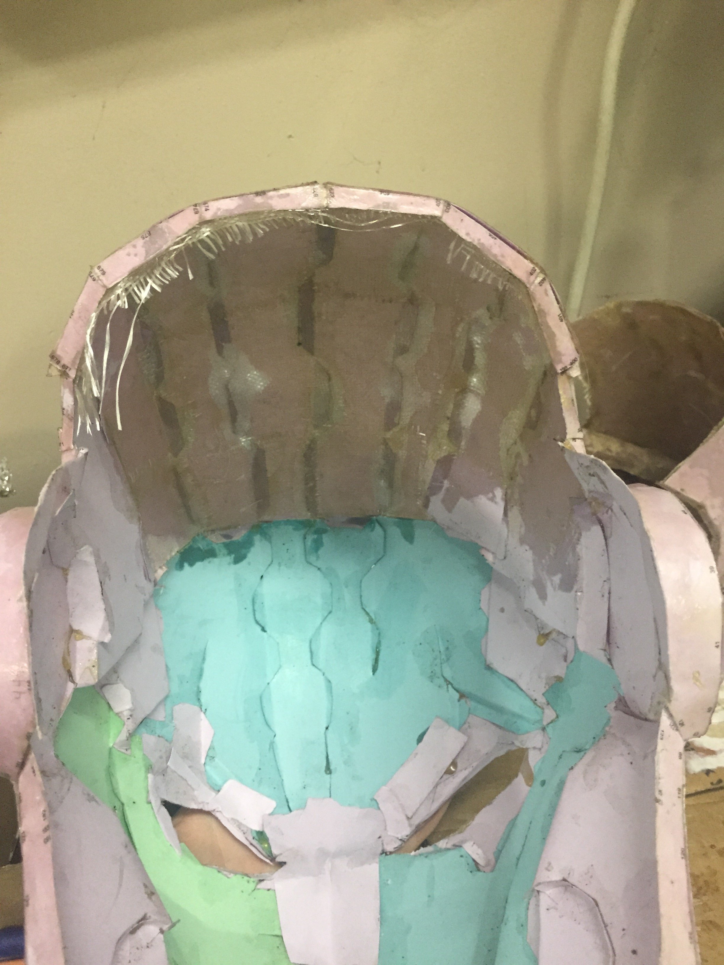

    This is when I started fiberglassing the inside. I made the back part of it come off so I could attach a hinge and straps for it later :D IMG_3711.JPG IMG_3737.JPG

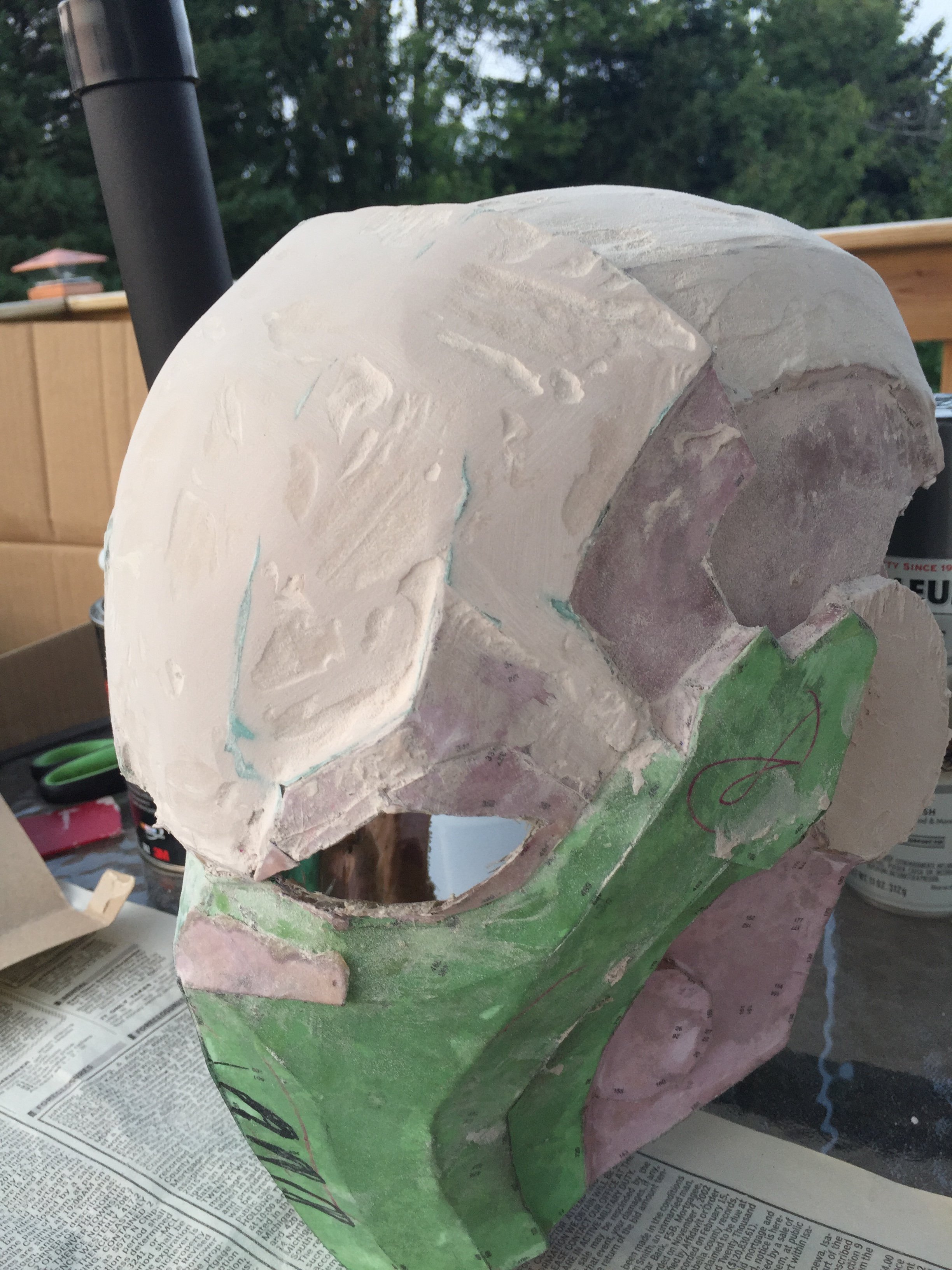

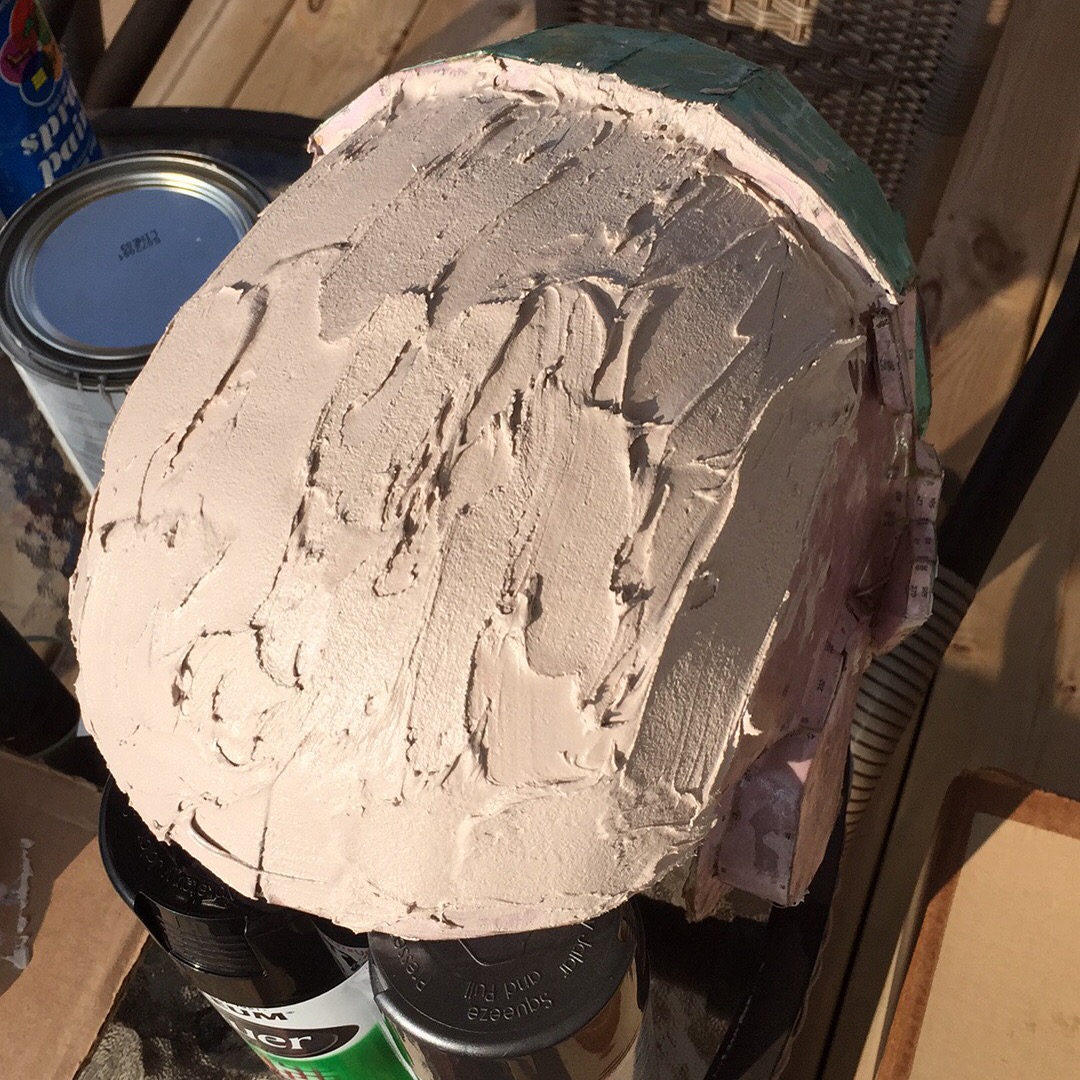

    And this is the Bondo / sanding stage. Can anyone tell me how to get rid of these "dents" in the helmet?

    more filler in the dents. You can use more bondo or a spot filler. It'll just be an endless cycle of filling dents, sanding it down and repeating until you are satisfied with the smoothness.

    Great, thanks! Is the spot filler necessary though? Because right now I only have the Bondo Body Filler.

    Keep using bondo if that's all you have. Spot filler is handy when you're down to small nicks dents or scratches since it comes in a tube and you don't need to mix a new batch of bondo.

    Ohh I see. I have some decent sized dents so thank you for the info :)
