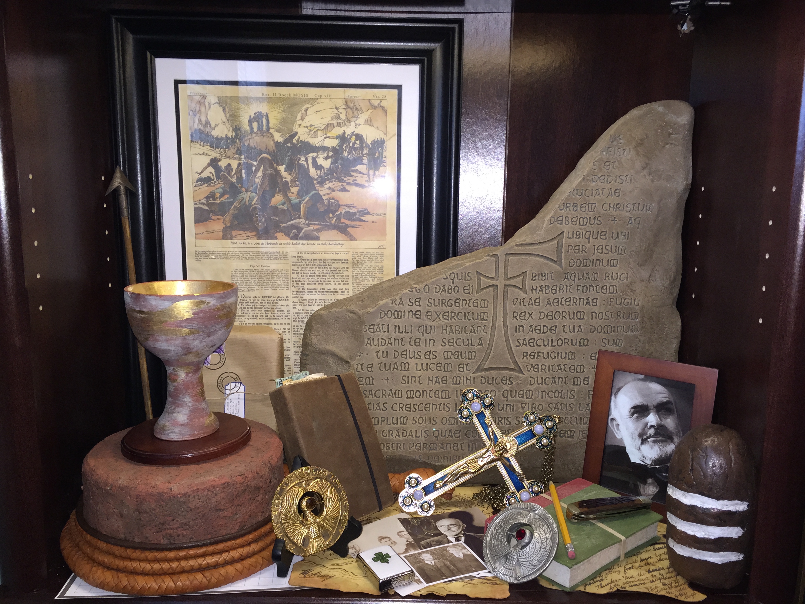

I made my Sankara stone (and the pedestal the grail is on) below with foam coated with spackle. Then when it was partially dry I used plastic garbage bags to pat the spackle down and shape it into more of a stone texture. It looks pretty good. It's not screen accurate, but it's close enough to get the point across.
For my stones I used some Balsa wood from the hobby store. Worked pretty well but I like LTsmash's method. Has more of stone look than the balsa does when sanded smooth. I say give that technique a go. And thanks LT for the idea :thumbsup
That sounds like a great idea! Love the display- is the tablet made from spackle and something else?
Mechanized2400- I hadn't considered using balsa or any other kind of wood. If the block of styrofoam doesn't work for me, I may try your idea next. Thanks.
No, the tablet is one of Peter's. The only things I made were the Sankara Stone (because I'm kind of meh on Temple of Doom but I wanted something from it to display) and the pedestal.
