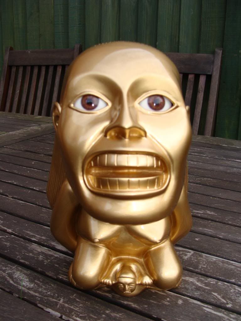

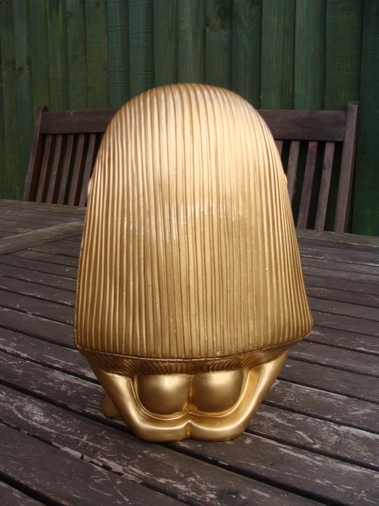

Got my Indy fertility idol through this week from Ozymandius, man these are great. I couldnt afford the metalized version unfortunately. So opted for a raw one to paint myself, I used Rustoleum gold and gloss clear coat.
The acrylic eyes really make it pop
Im pretty pleased with the results....
did you get the hollow two piece cast and complete it yourself? That's what I ordered. I'm playing around with various finish ideas, and leaning toward gold leafing it.

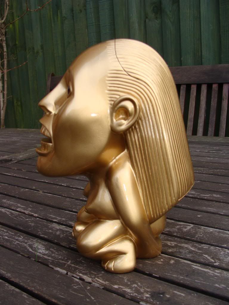

It is a hollow cast but was in one piece, with no base in. So had to cut the hatch in the hair line to get the eyes in as close as I could see the film ones were done and also gue on and fill the base hole with some abs sheet so its solid now.
Its a great piece

Mate yours turned out awesome, I did look at getting the eyes in without cutting. But wanted to go as accurate to screen used as poss which meant I just had to put in the hatch in. I may even gof ro moving eyes at a later date, as they are held in by a strip of abs sheet and can be popped off.
Did you seal the bottom hole in your base?
Not yet. I wanted to fill it to add some weight, then seal the bottom. Just haven't gotten around to it yet, mainly because I haven't decided what to fill with.
Your eye placement is great as well. I had to estimate the pupil size I needed and I believe mine is a bit smaller than yours. I had to center the pupil a bit more on mine. Also, the eyes are the same, the shadows and reflection makes one look a little lazy.

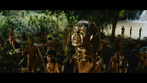

Here's a blowup of a YouTube clip. Would you agree those are brown eyes?
Yup defo brown eyes in that picture mate, the close up hero is obviously brown eye'd, and I read somewhere that prop store said the one held up by Ballak out side the temple is also brown eye'd. I wonder if someone has the blue ray wether they can do a screen grab.
I think the gold eye'd ones just dont look right to me, be nice to know one way or the other, either wy if there was agold eye'd one then t would only be a rough stunt version

Of course, I'm happy to. Belloq's looks golden-eyed to me, though.
(Right-click open in new tab or window, then click again to get the full 1080 size)
