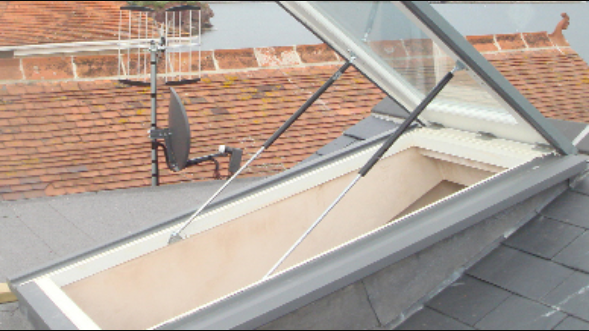

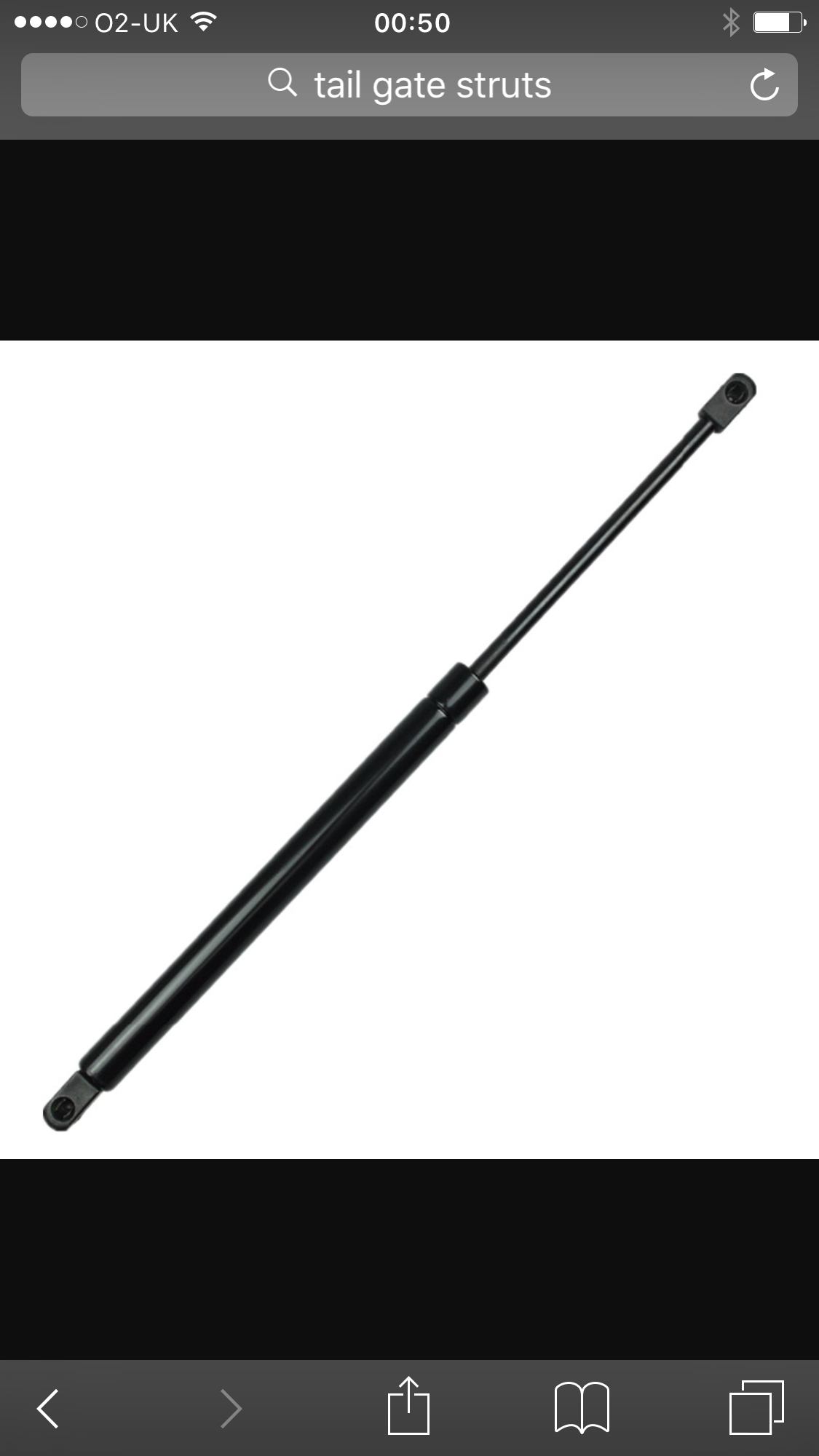

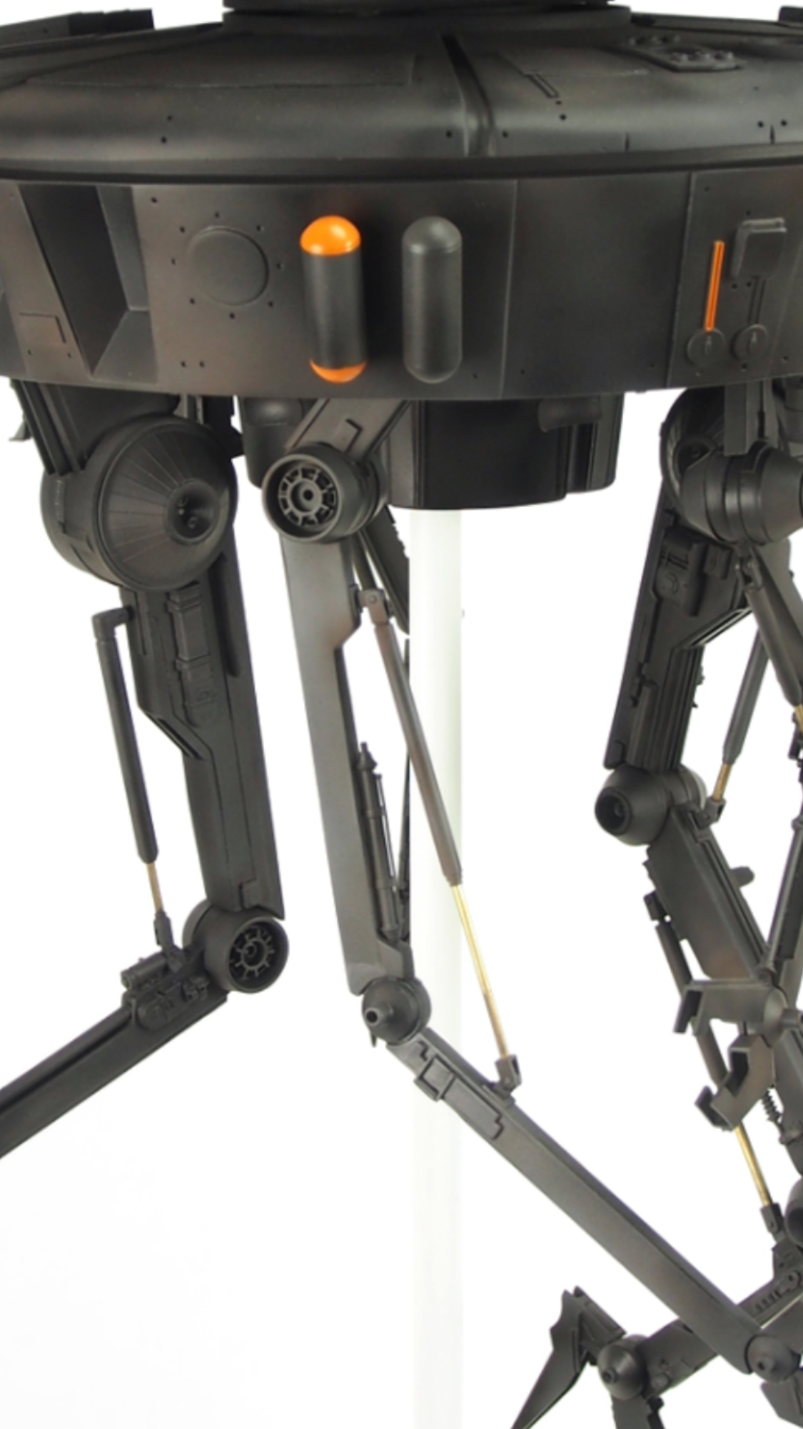

I was looking at the hinge point to the legs and the piston / struts look familiar
Caravan window struts / window struts or tail gate struts

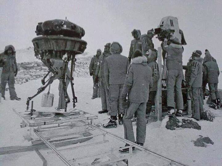

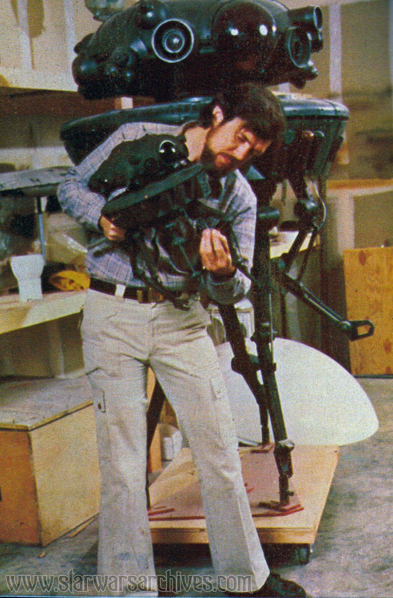

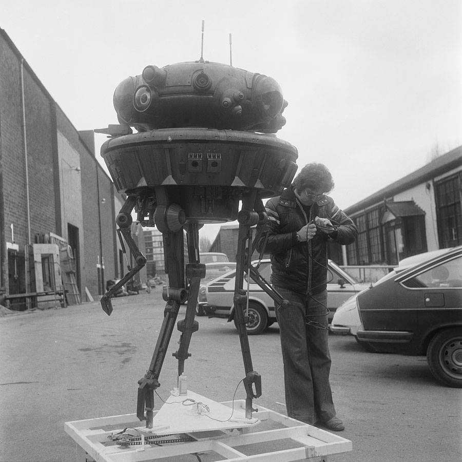

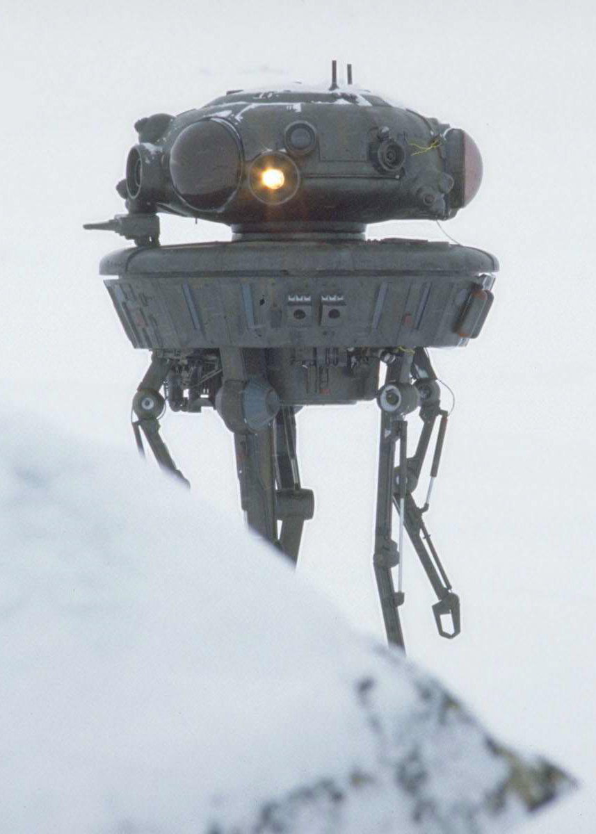

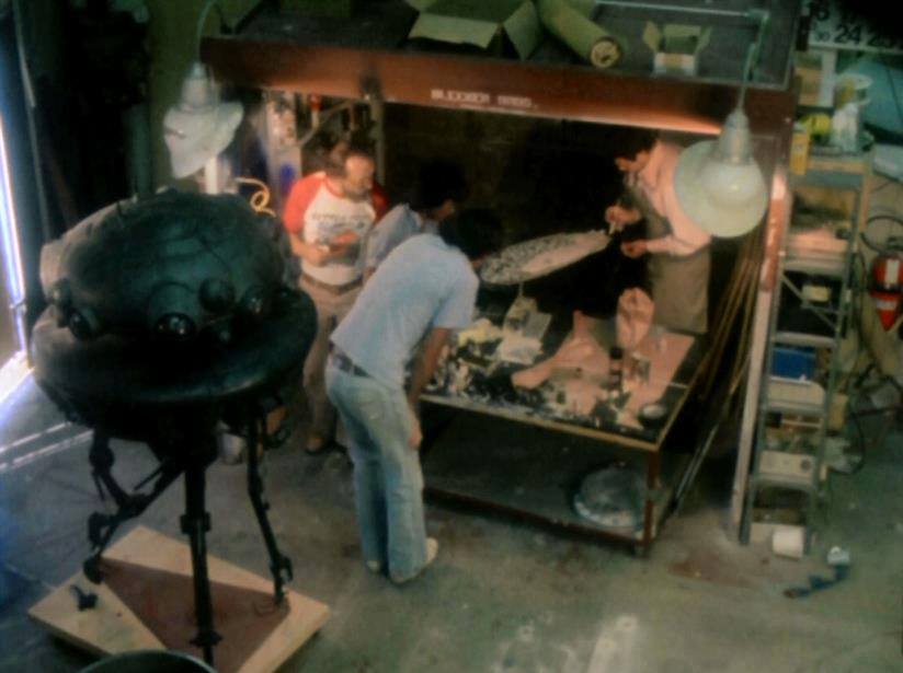

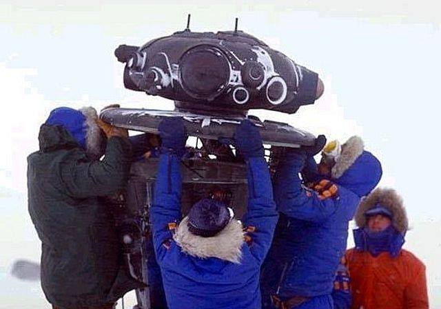

Now some pics of the screen used probot:
Probe Droid duo.jpg Probe Droid filming.jpg Probe Droid Hoth 01.jpg Probe Droid life-size 2.jpgprobe droid screenshot 01.jpg Probe Droid studio.jpg Probe Droid team.jpg Probe Droid wide1.jpg probedroid3.jpg
