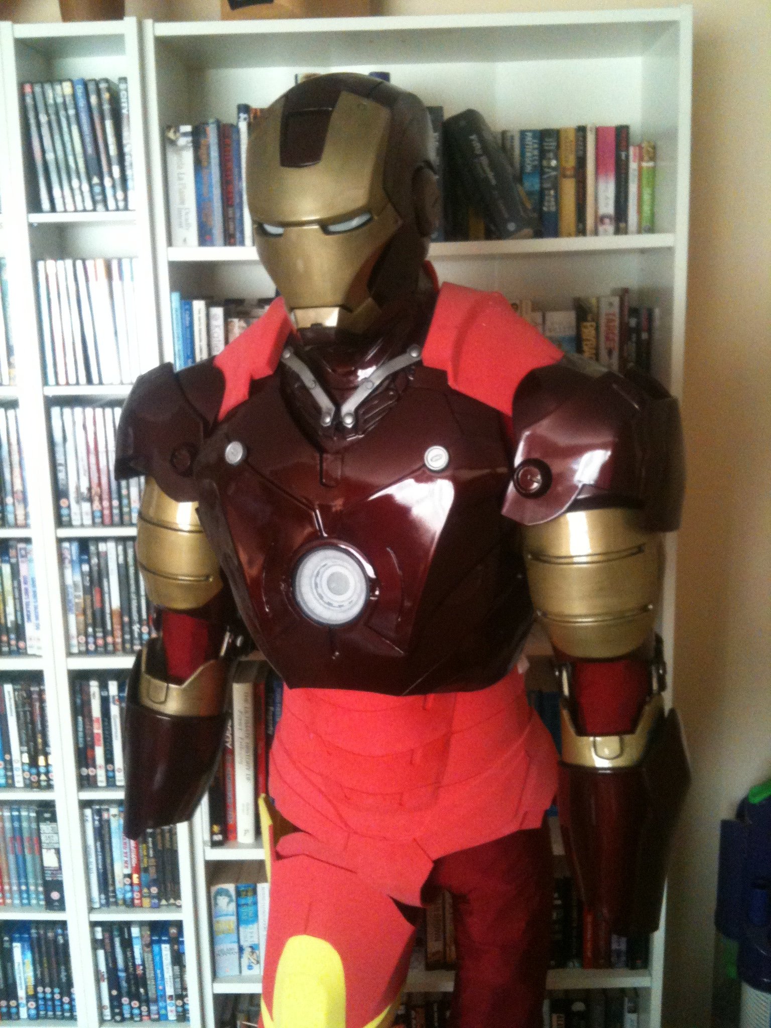

Well been laid low with 'Man-Flu' recently but finally got the chest piece painted. Still need to flat the clear coat and weather it but its getting there. Was the most difficult piece so far mainly due to trying to keep it in the correct shape :( Anyway here's a crappy iPhone pic with it all loosely on the mannequin. ( enlarge the pic to see it properly)

Awesome ! Congrats on completing the chest dude, looks really really good. :0
Cheers bud'

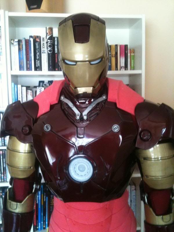

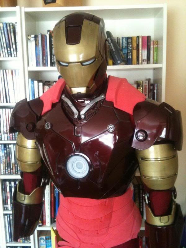

Okay I've got the chest pretty much done (gotta repaint the chest bolts) so here's a couple of shots.

Amazing work. Hard to make a foam mk3 look movie accurate as the mark 3 has more rounded parts. As far as foam goes, yours is the most accurate I've seen. Good job!!!
I've been following this build for a while now and i have to say that i refuse to believe my own eyes....they see foam at the start and then..."ooh shiny"....i'm not having that, it's gotta be some sort of metal or something....it can't be foam...it's just can't;)
The final pic of a full suit is going to be a work of art
keep up the amazing work mate
I can hardly believe this is foam. If I hadn't seen the original pictures, I'd be certain this was pep/fiberglass. Good choices on the color as well. Love the darker red on the Mk3. Simply and utterly amazing work. Subscribed and eagerly awaiting seeing your completed suit.
