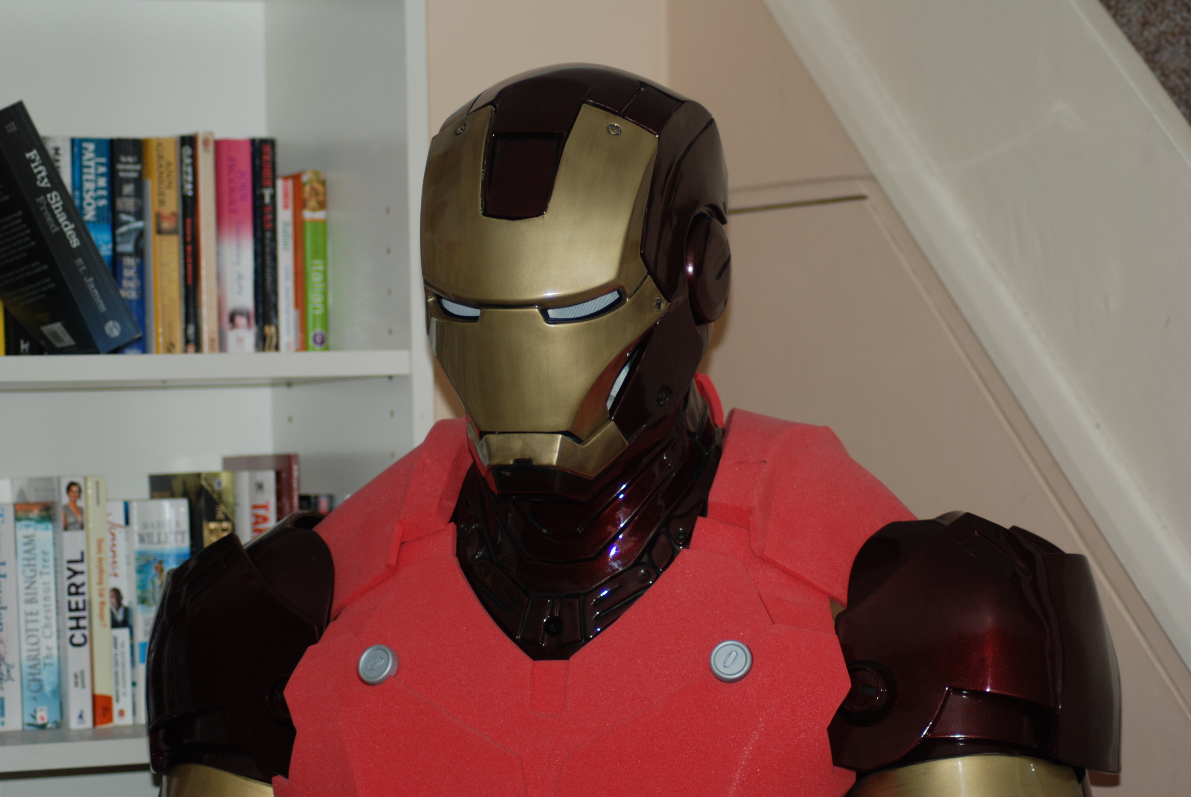

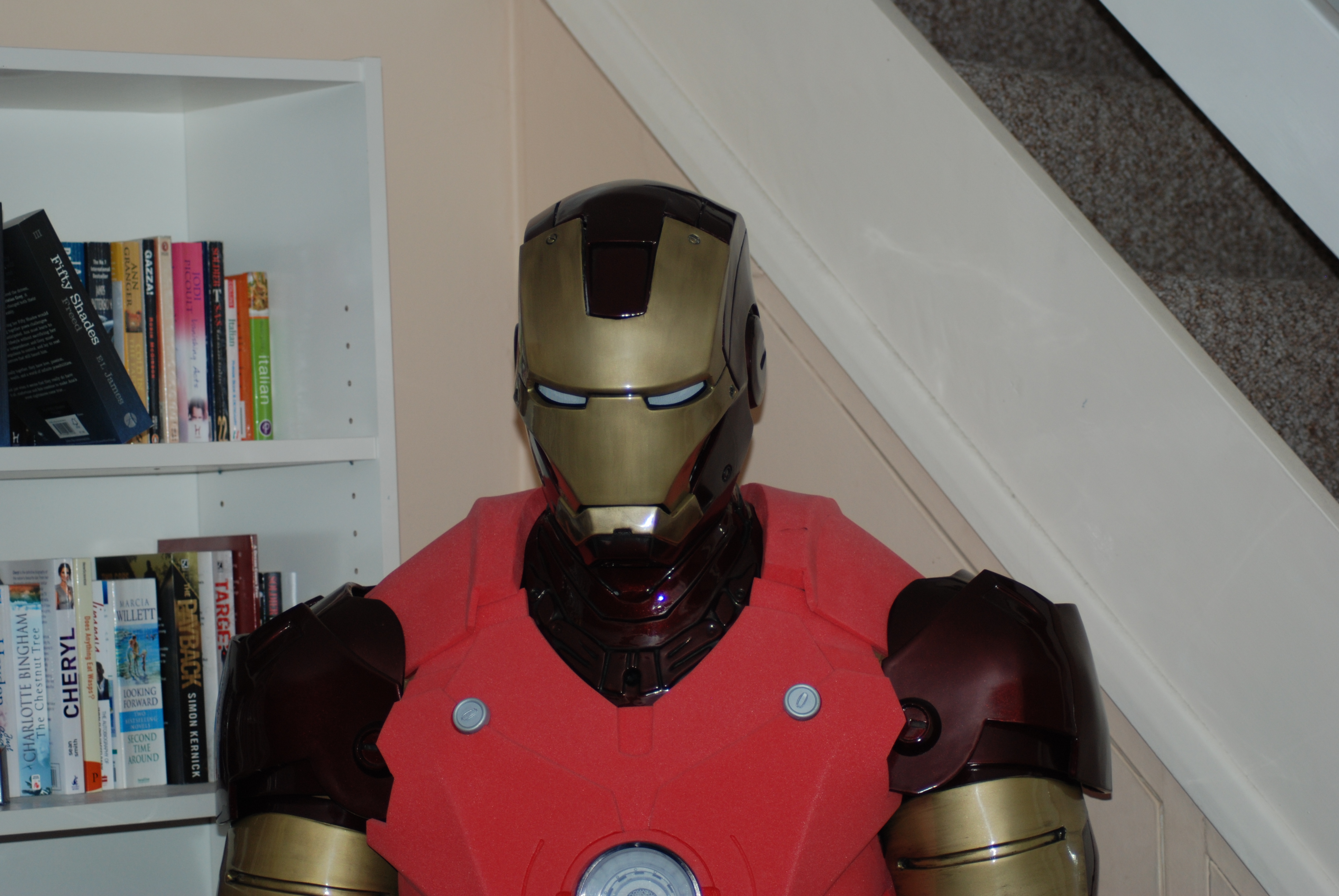

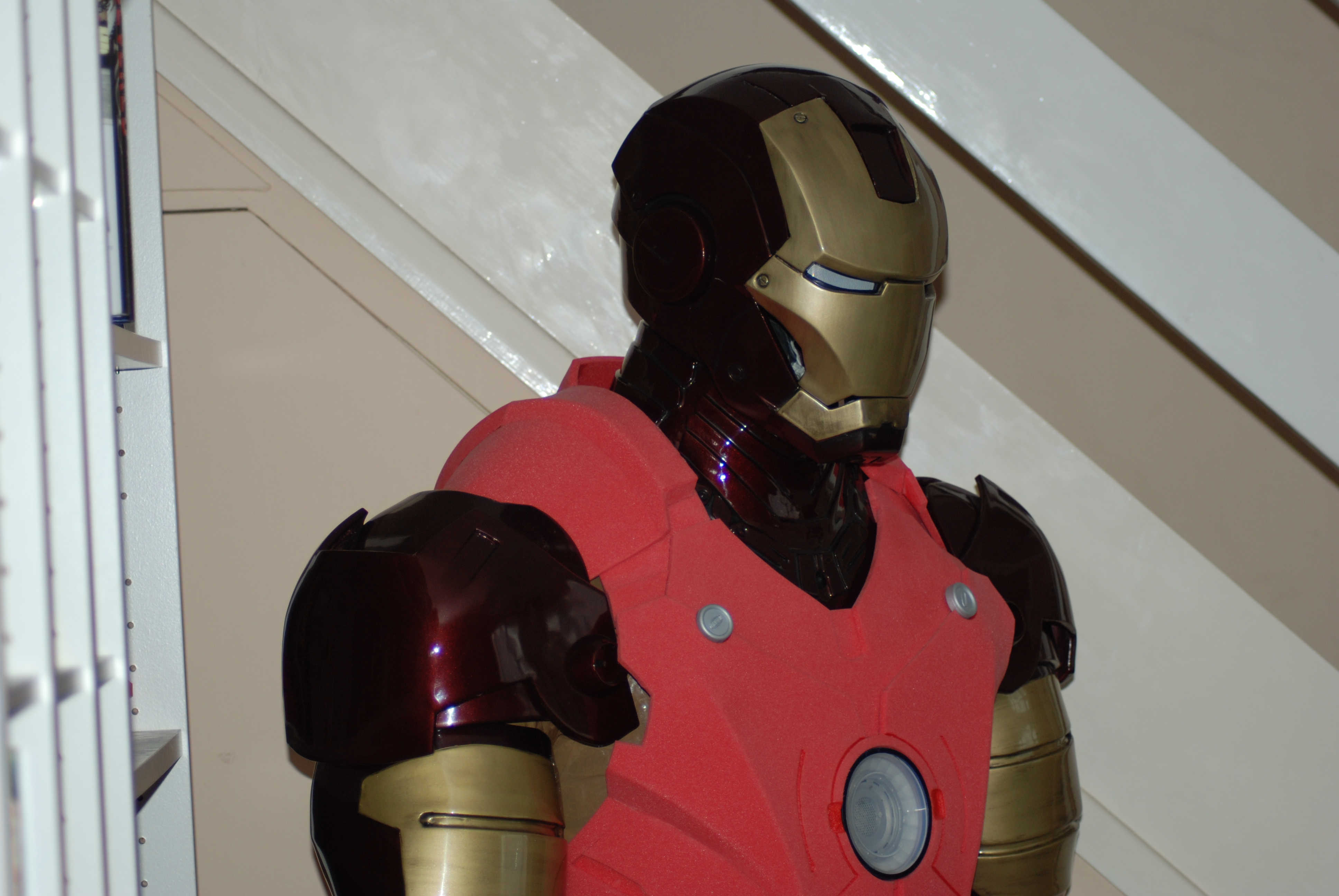

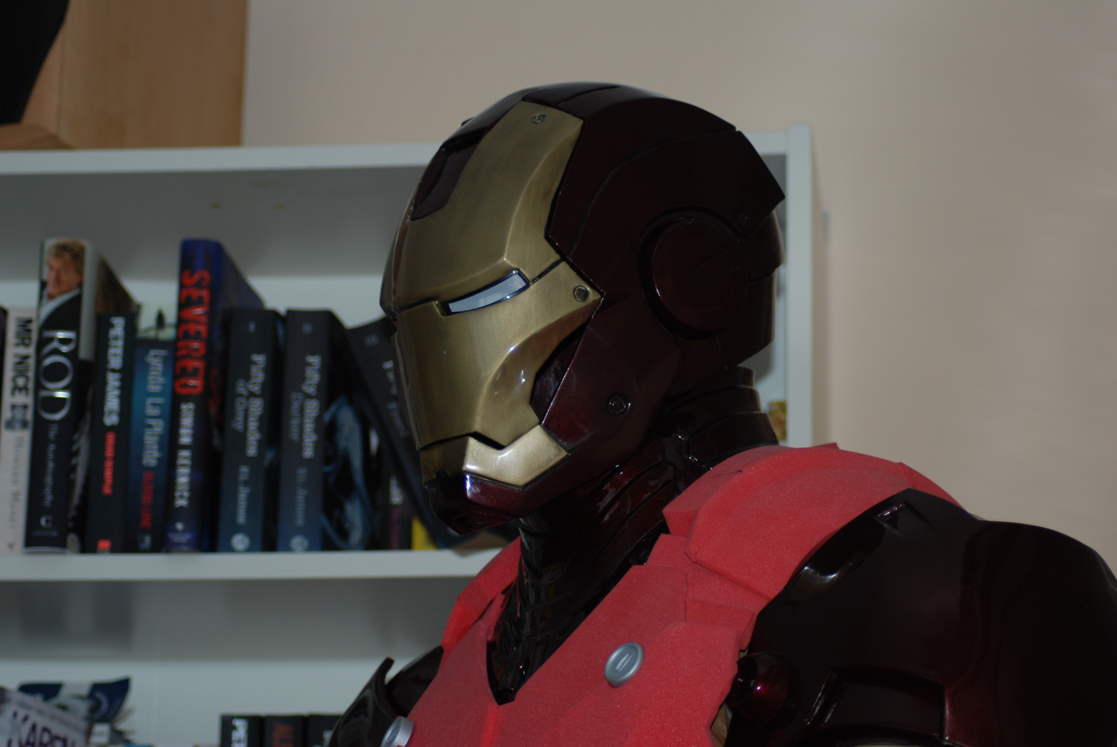

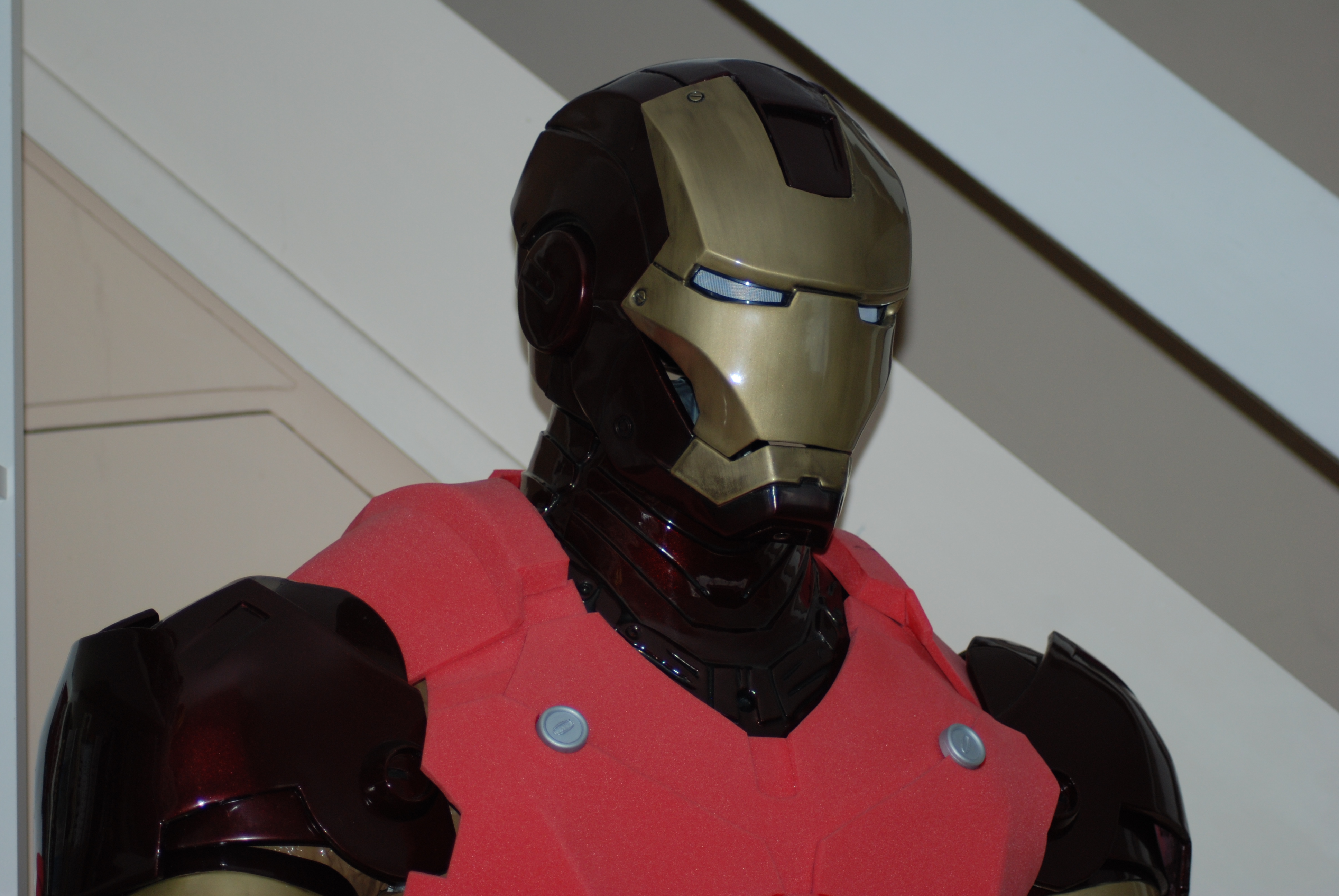

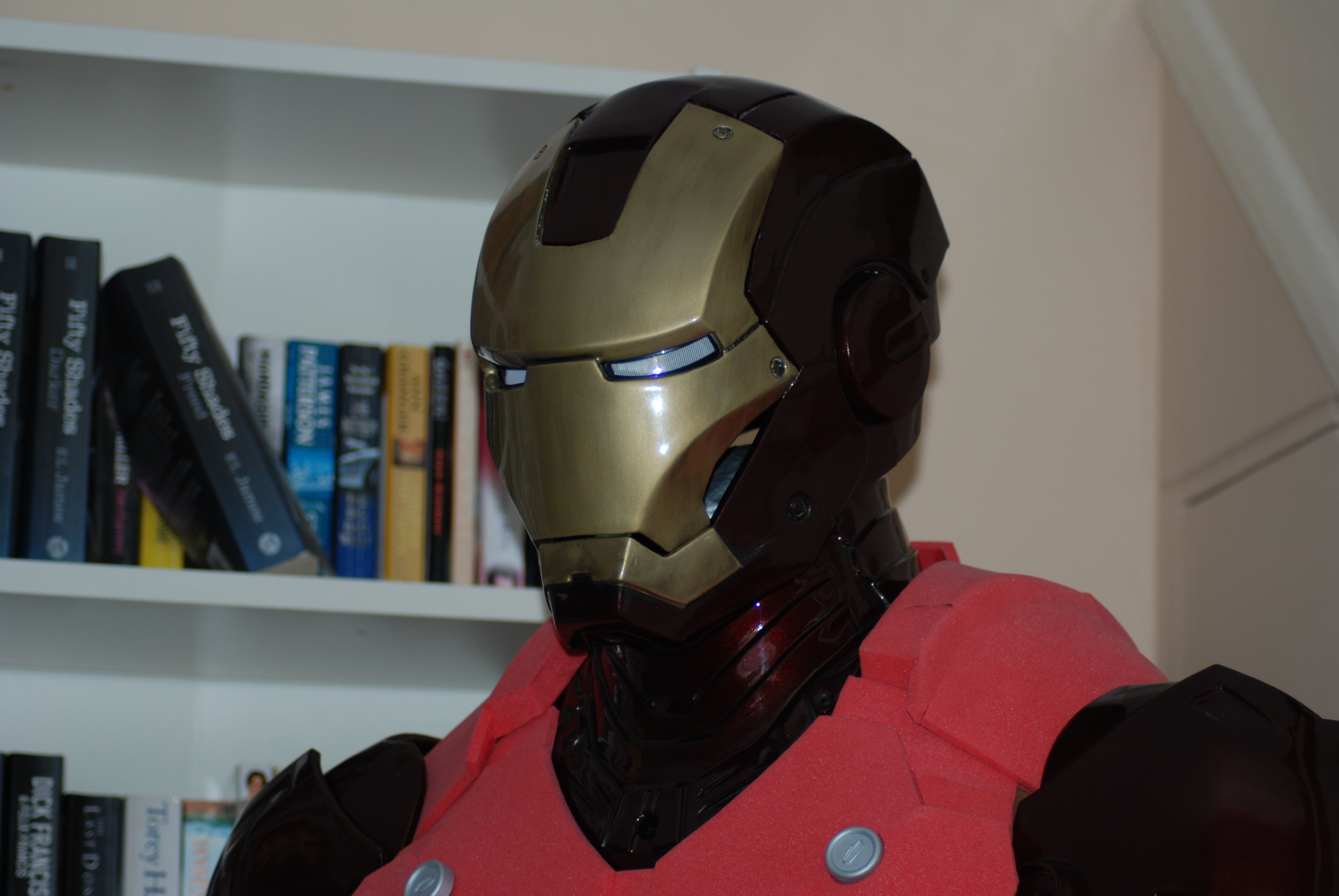

Okay, finished up the neck seal (still working on collar bones) and picked up a new Nikon D80 camera so what better to take pics of than ol' shellhead.
