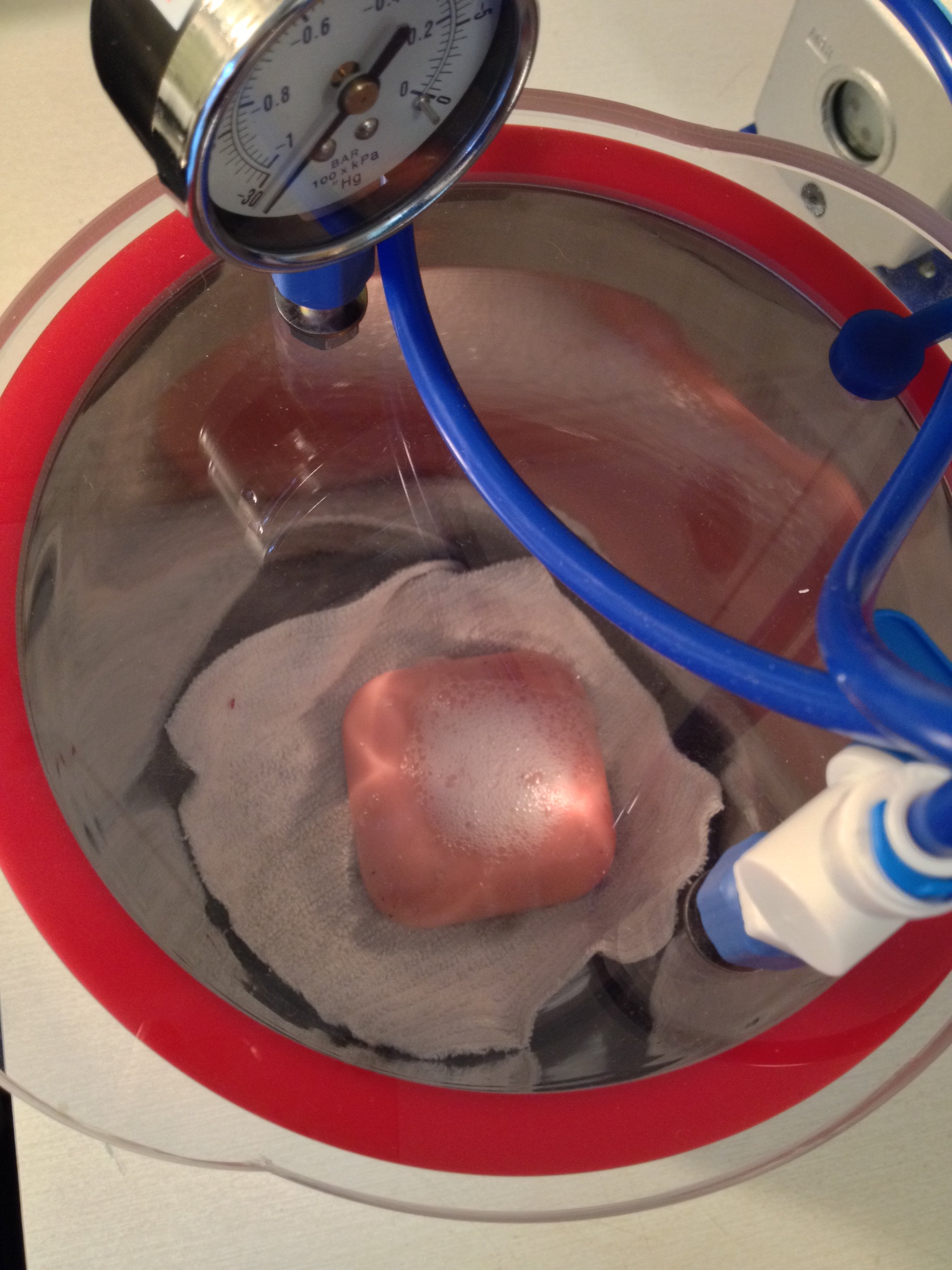

I am using Crystal Clear 2-part resin from Smooth-On and found that it always had tiny bubbles in it when fully cured without the vacuum chamber. I recently bought a chamber and when I put the mold with the resin in it, it first bubbles up like boiling water, then calms down a little, leaving a frothy layer of bubbles on the surface of the mold, whichdoesn't seem to dissipate. Am I doing something wrong?

Looking at your images, it looks like you did not have the vacuum strong enough. You need -30 inches to actually pull the air out. When you re-pressurize, any small bubbles still left will crush under the re-introduced pressure.
