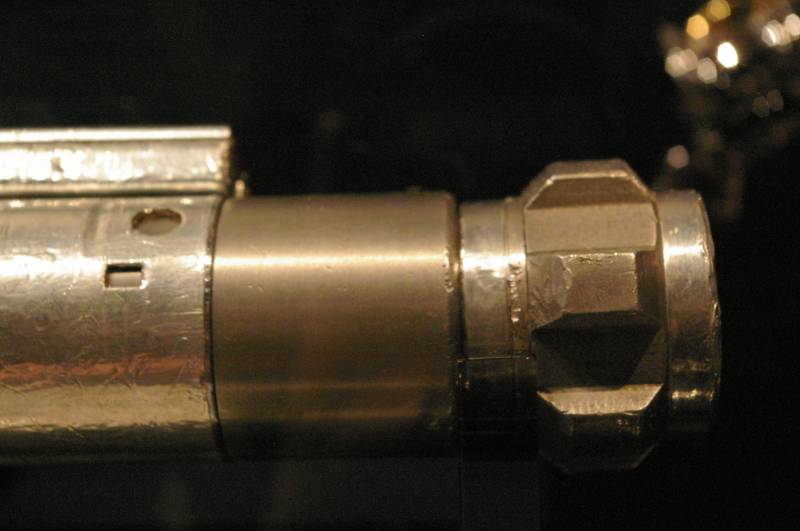

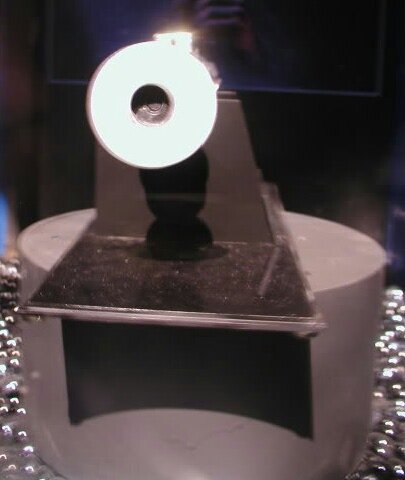

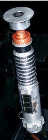

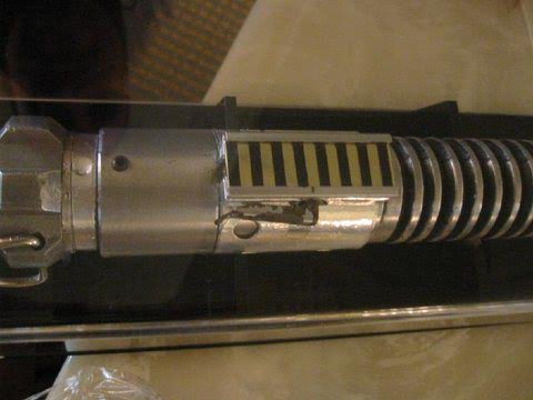

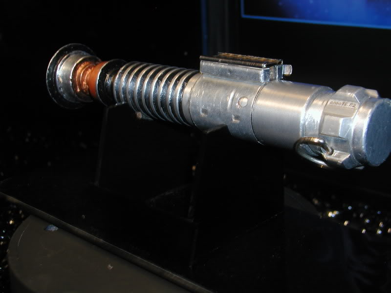

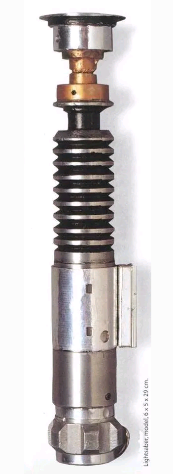

Hey guys,
I'm moving forward on my Luke/OWK shared stunt replica, and I need any high res reference pictures that you have. There are one or two details, that I need to nail down, so anything you have to share, please post here.
Please note, I'm not looking for replica pictures, or any photos of the hero or v2. Just the shared stunt prop listed here on POSW http://www.partsofsw.com/ob_luksab.htm
Thanks for all your help.
Dan

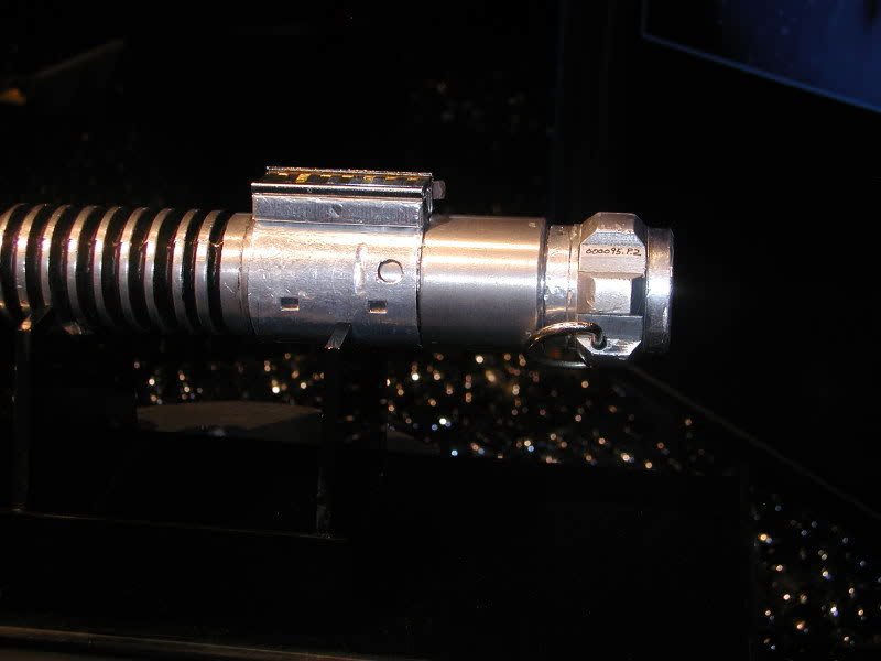

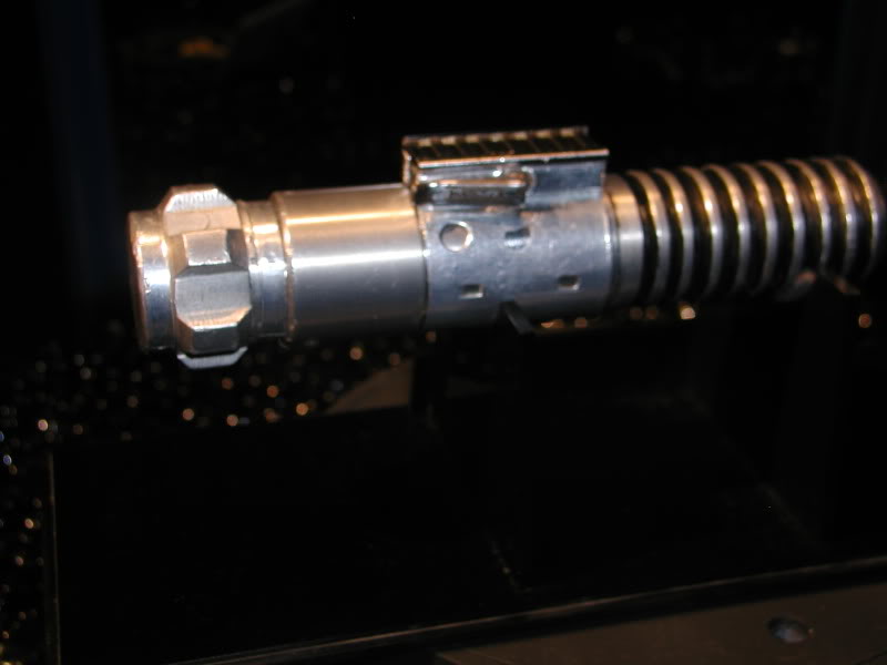

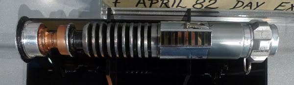

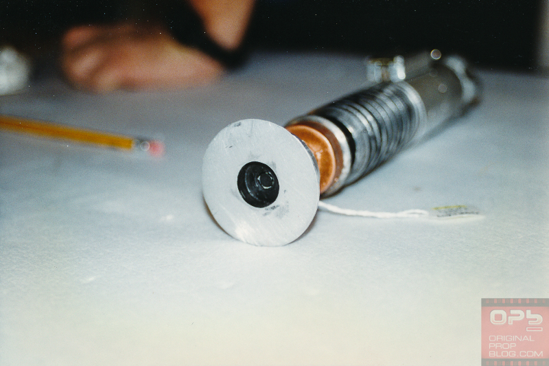

This is the saber that was cast from a wooden master, correct? Do we know what metal they cast it in?
We don't know. But, when I look at the current state of the saber, the contrasting tones in metal between the aluminum tape and the saber body makes me think that it was not aluminum. To my eye, the color looks a little bit darker than the aluminum tape.

I've got a couple different quotes. One company has offered to spin cast this saber as a one piece item. But this would leave the inside hollow reducing the considerable weight of a solid pewter part.

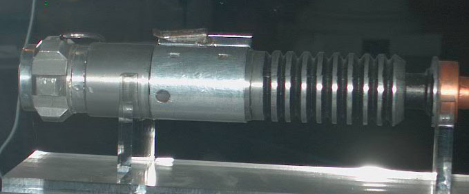

Well looking at the original prop, there appears to be dents all over the pommel. So, thats one of the things that leads me to think it was a fairly soft metal.
Just to be clear, Im not opposed to aluminum casting. And Im getting quotes for that too. Ive been to a couple foundries who have shown me some examples of there sand aluminum sand casting and plaster mold casting and Im trying to compare all these to get the right finish
I am fairly agreeing with you highly about the pewter casting because it does seem like it dented up very easily also you can see the seam line in it and most metals don't have seen Lions so they've most definitely probably did some kind of two piece mold and I most definitely interested in this run and cannot wait to see the finished results.
