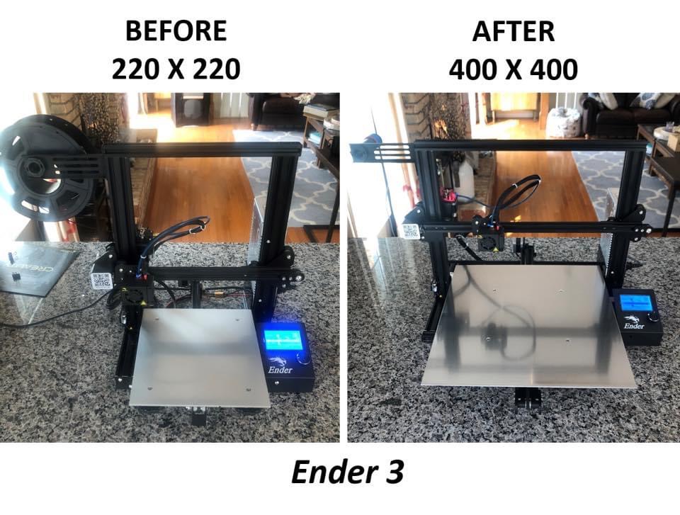

I have an Ender 3 with the Ender Xtender kit. I’m currently working on a 4 foot Jupiter 2 with it.

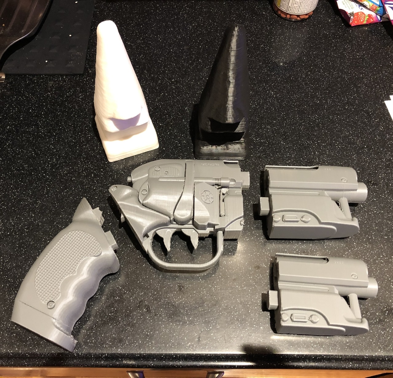

I reprinted the Bladerunner blaster successfully (glue stick, 65 temp bed, 205 temp extruder). Issue was I printed the three pieces at once and thought that I had resized all three pieces in Creality Slicer. Nope - discovered that only the barrel was 90%. Everything else was 100%.
So I reprinted just the barrel at 100% to have one massively oversized gun. Lol. I’ll reprint the 90% pieces at another time.

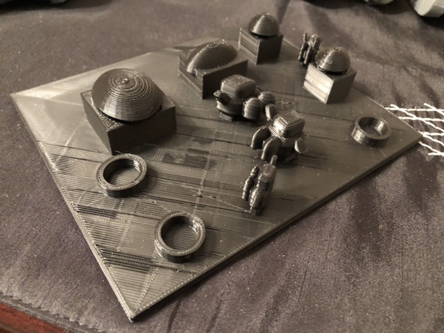

My eight year old son modeled in Tinkercad a small space diorama and we printed it.

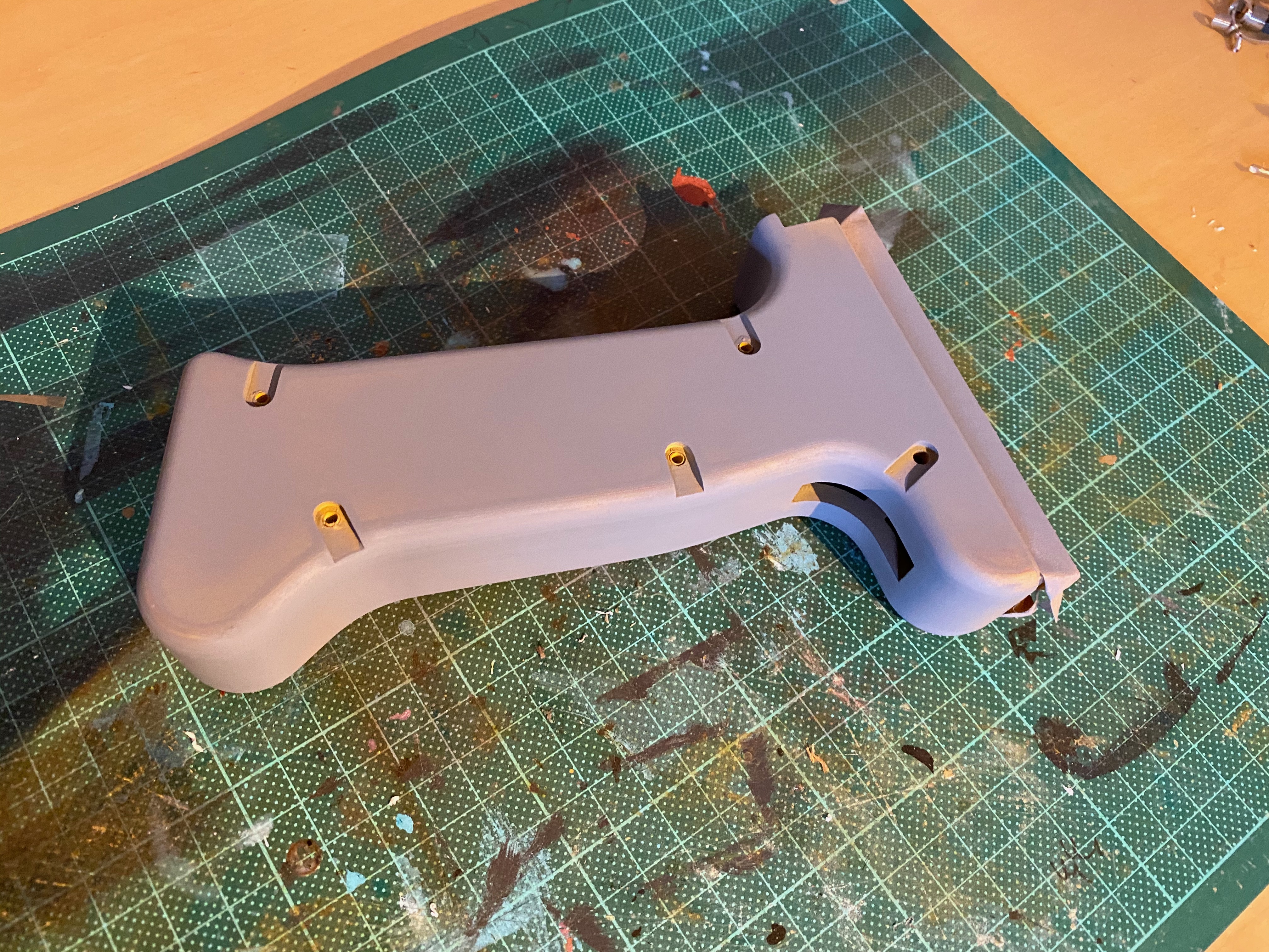

I have dabbled with little models (mostly from Thingiverse etc) but started on some projects of my own. The aim is to build a helmet based on the Alien: Covenant spacesuits. I have the components printed, but felt the need for a bit more practice assembling and preparing the prints.

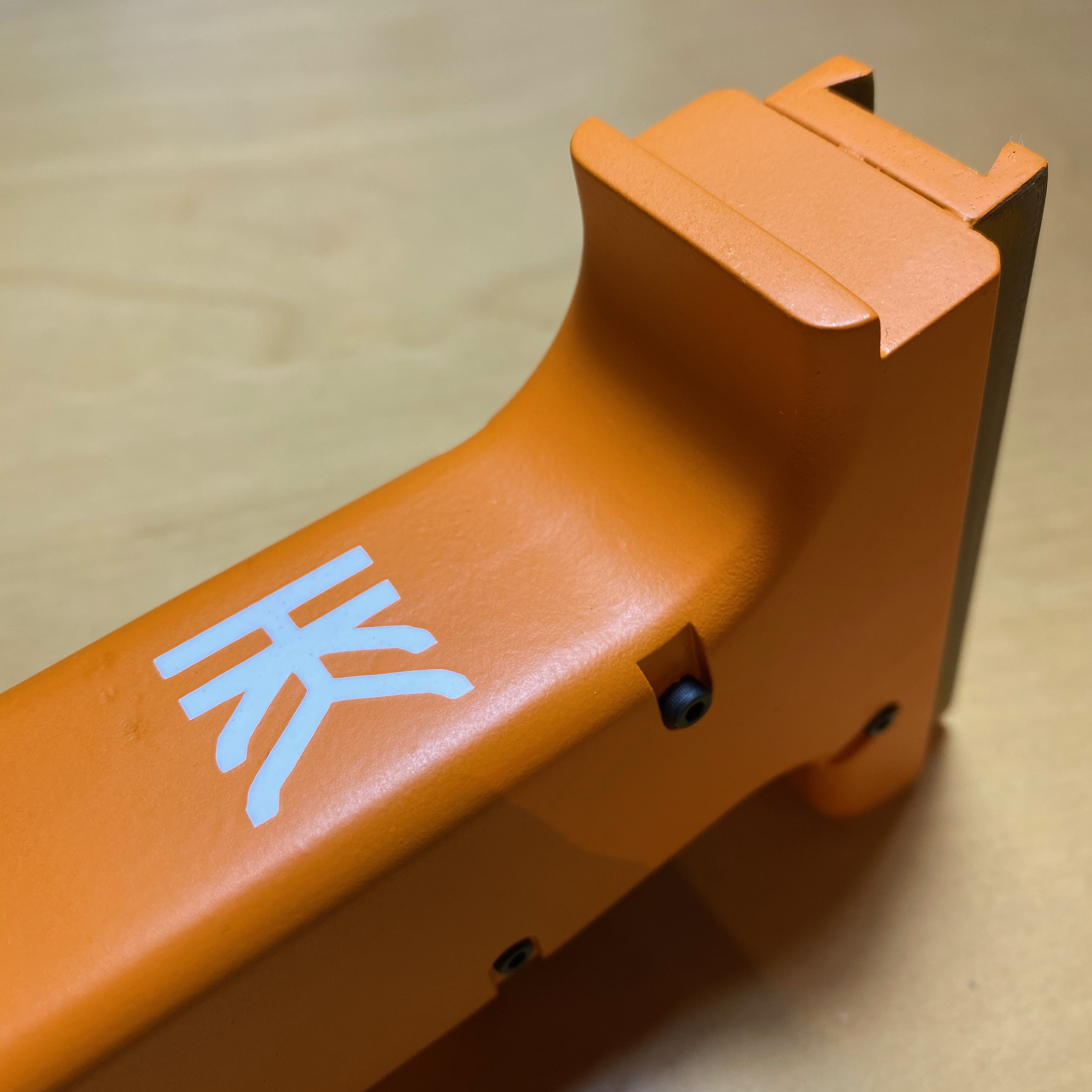

Here's a tool of my own design, strongly influenced by a piece on Artstation by YoungKwon Yi. Intended as a cyberpunk-style welding tool. The images are after the usual fill/prime/fill/prime to get rid of the print lines:
