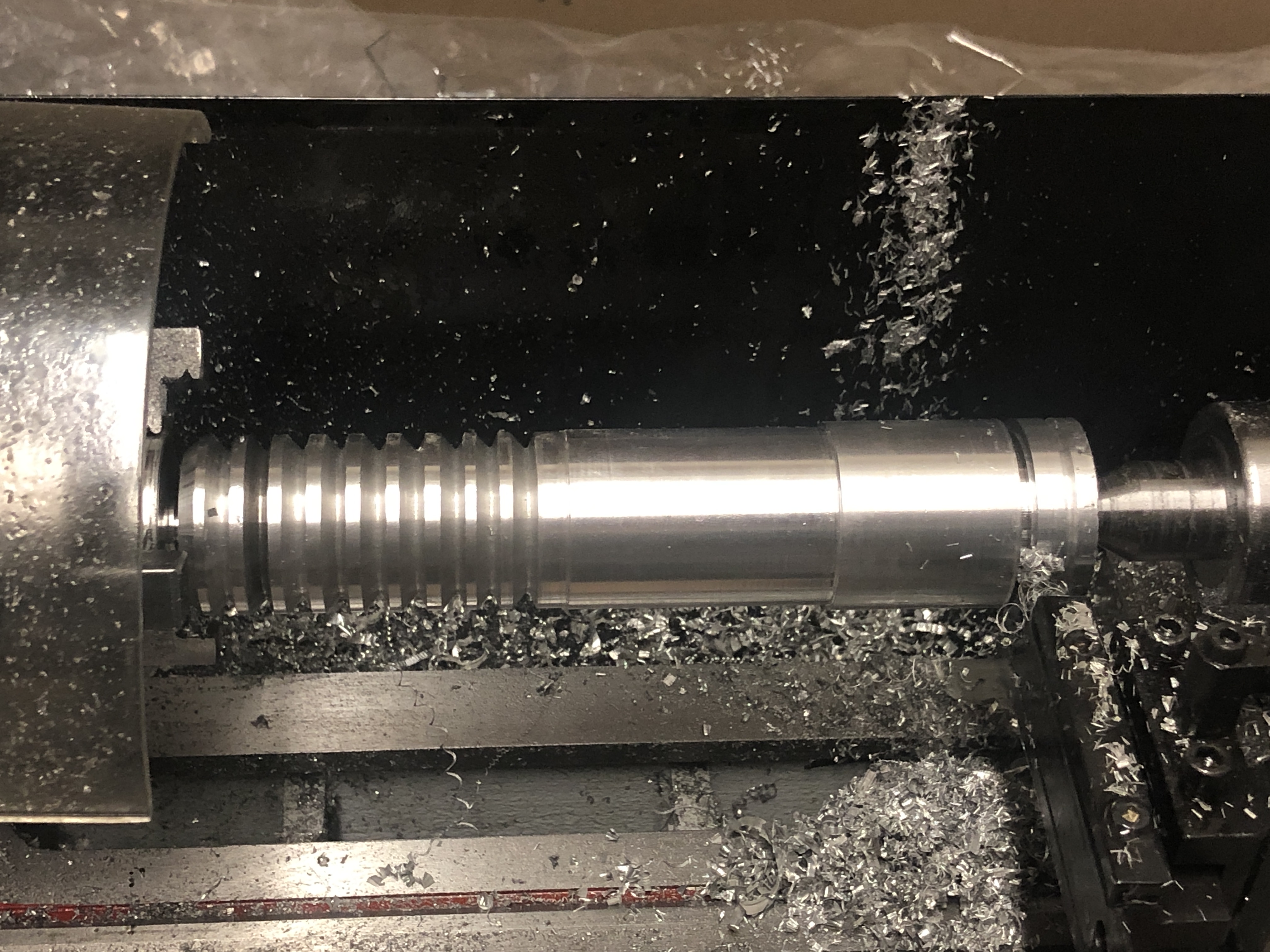

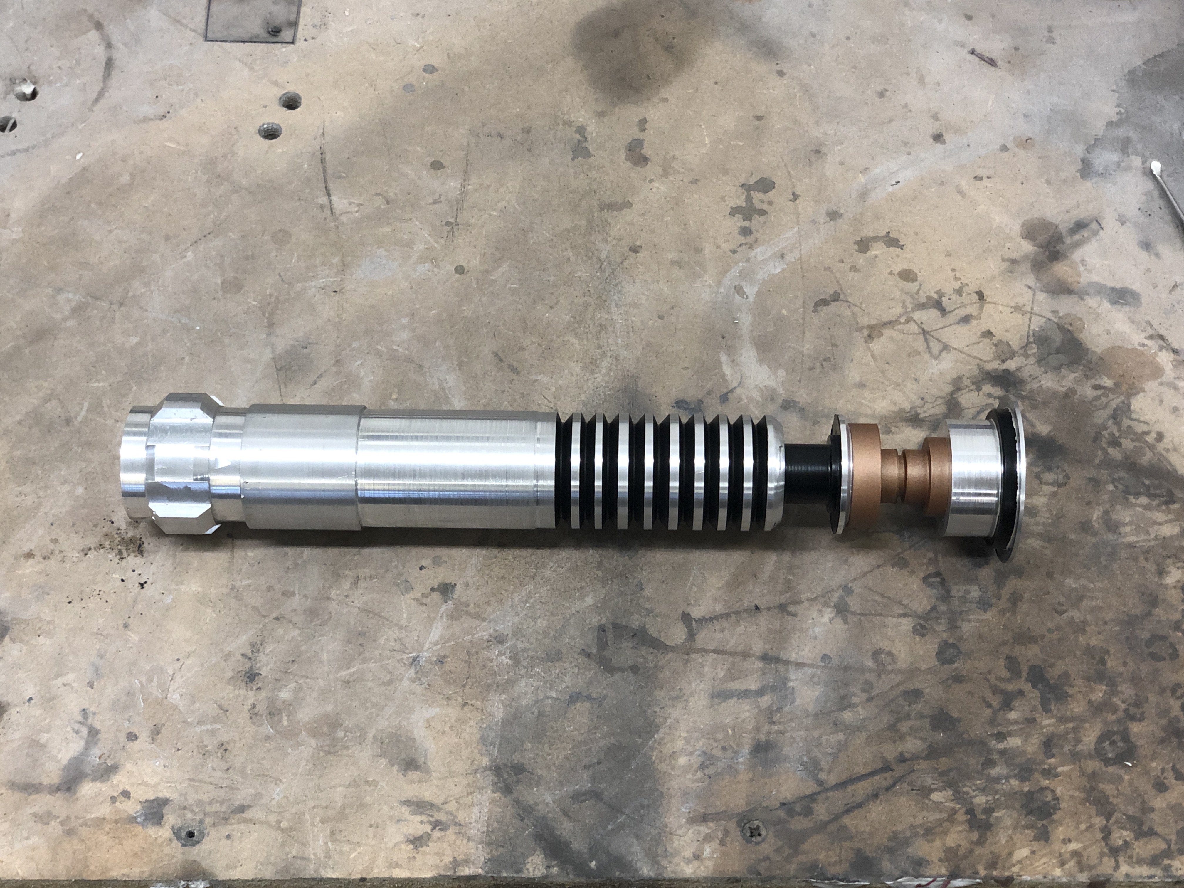

I've always liked the Luke stunt saber from ROTJ, rather than the V2 that everyone seems to go nuts over, so I thought I'd have a go at that. I have a resin eFX saber that I used for basic measurements although I imagine when it comes to doing a final version (because obviously first attempt isn't going to acceptable to any kind of SW nerd) I will probably use a combo of the resin saber and reference pics.
Now, I bought a lathe that was described as being 300mm between centres, and quickly found that once you add a live centre to hold longer work or a drill chuck that is reduced appreciably. Never mind, I never intended to do the whole thing in one go. I've had to make some of the tooling myself from high speed steel for the handle grooves, but I'm finding it fun. Here's where I'm at so far. More coming over the holidays!

that's a very nice start for a first time with a lathe. I want to buy one too and I hope I'll manage too.
Good luck for the discovery and don't hesitate to share more!

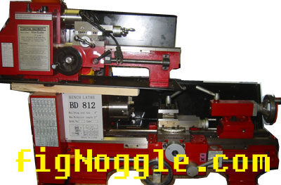

IMHO..... the HarborFeight 7x lathes are not worth much of anything.. unless you plan on doing very small/short parts..
While it extremely overpriced now (used to be WAAAAAAAY cheaper) their 8x12(14) version is (again IMHO the most entry level lathe anyone should spend their money on)..
Its a lot more rigid/heavier than the 7x's..
I consider the 8x still a hobby/benchtop version..
here is a comparison pic of the two:
bookface
All of that. I suspect that while mine didn't come from Harbor Freight (we don't have them here), it's probably exactly the same lathe manufactured in China and re-badged for whichever store sells them locally. I got the 7x12 as the next size up (8x20) was 2.5 times the price. It does OK. The tusks are absolutely fine, the lightsaber was kind of a bear. I'd never try and produce them for sale on this lathe, it's just not up to it. On the other hand, it's better than no lathe at all, and if you're prepared to take your time then you can produce some good work.

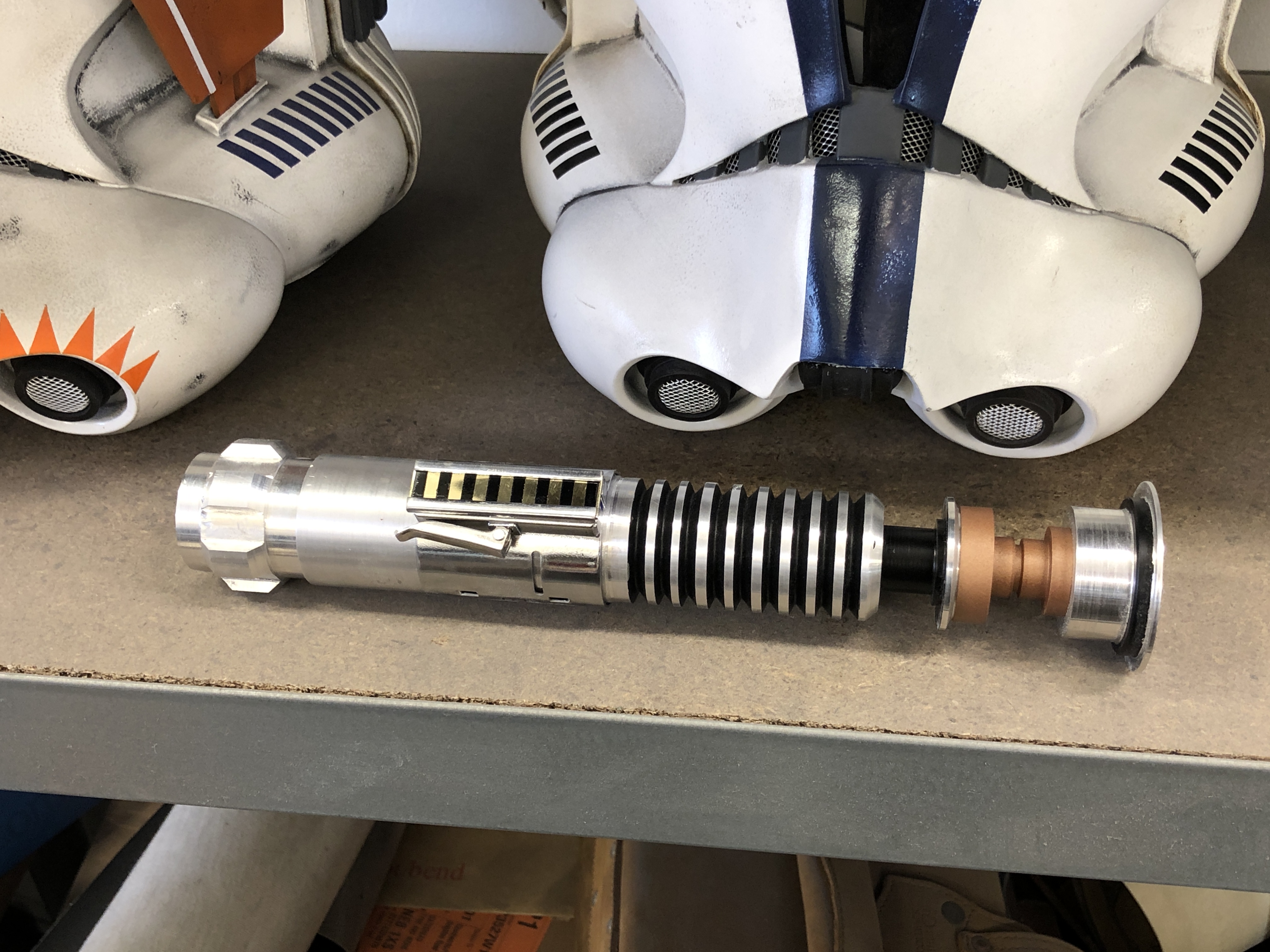

How'd you end up doing your pommel?
Fortunately I already had a mill drill so I lathed the basic shape and used an 8mm end mill bit to cut out the cubes. They're not quite right though, will need some thought on how to accurately get them to taper slightly.
