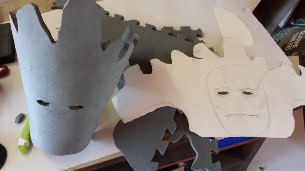

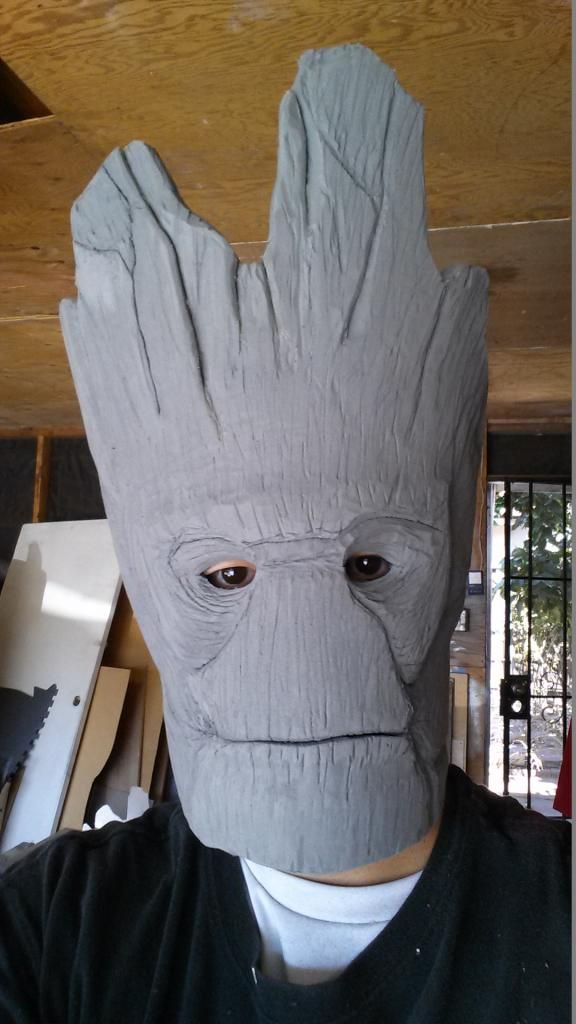

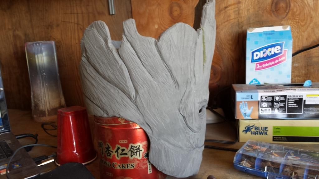

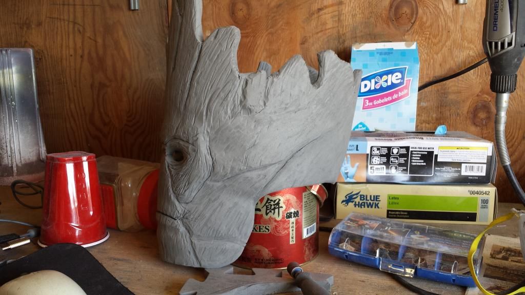

( Calen Hoffman's amazing Groot cosplay has inspired me to do one as well. I am shooting for a Halloween completion, but it may be tight since im working on a Gundam Project for May alongside and school starts soon. Only got the head mostly done so far. Used an EVA foam sheet, and went nuts with a dremel. It is very freeing to do a character that is not symmetrical and random with his texture so I don't have to "care" about exact detail)

I am Groot..( Put a base brown on the head. going to have to play around with shading and then add the green fuzz)
It's looking great. Can't wait to see how you detail it. I found black washing and dry brushing work really well, but you've got to get the colours right. I'm just starting to work on V2 of my Groot mask as I wasn't happy with the first one I rushed. Can't wait to see how it looks with the detail. :)
